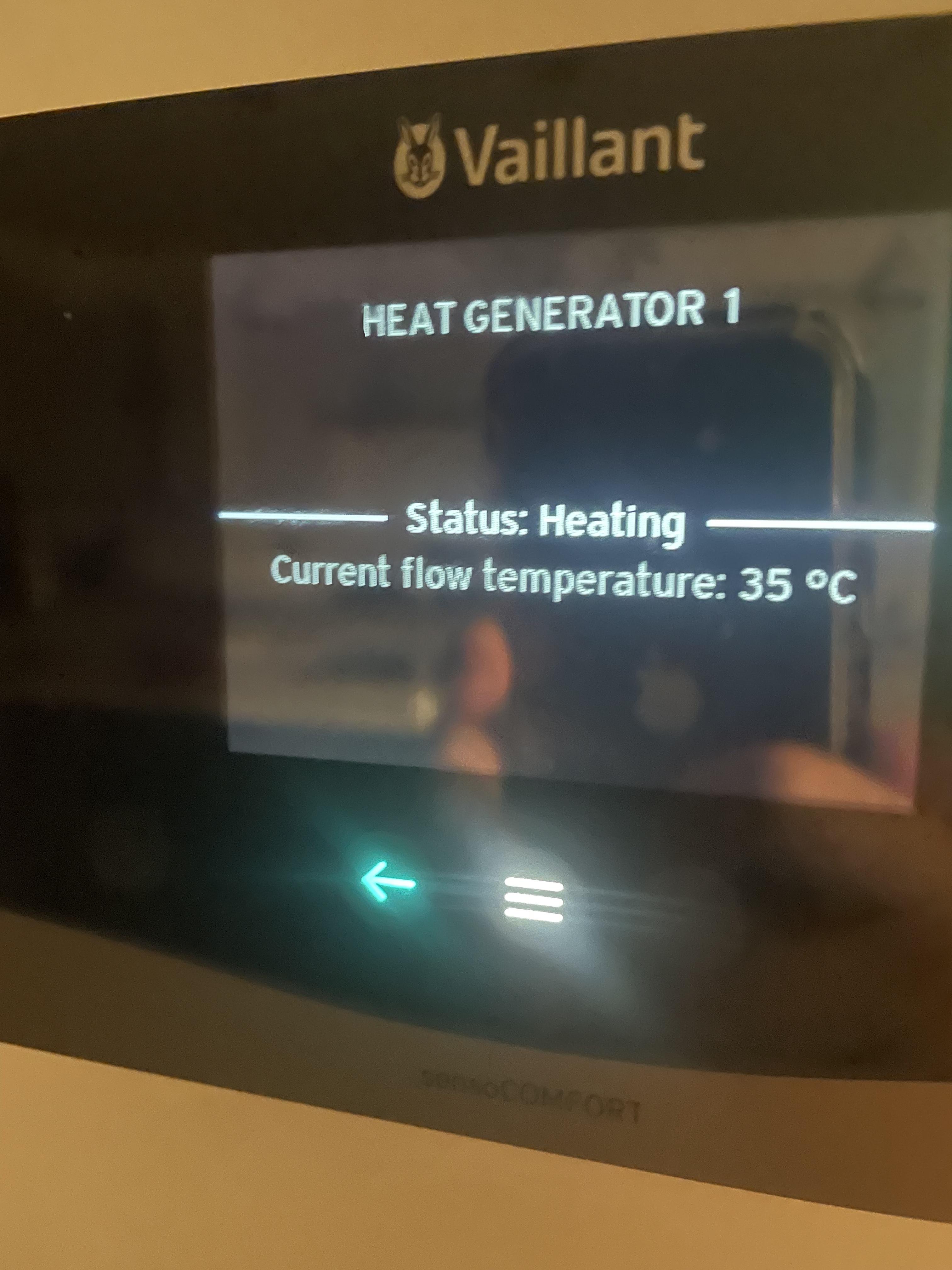

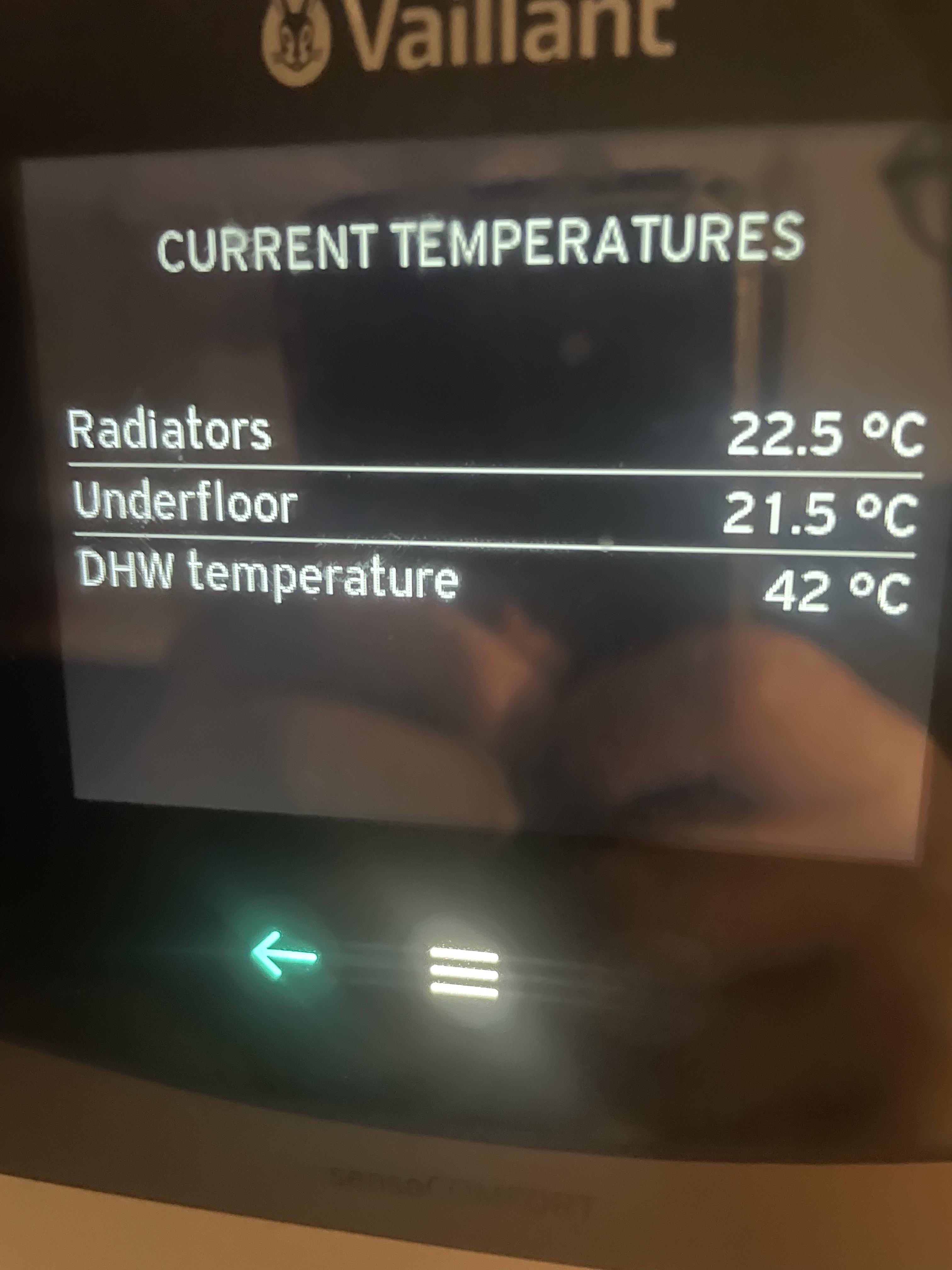

I read back on a previous thread in April where we were discussing this and you said your house is split into 12 different zones... is this true? that's insane.. so you have 12 different thermostats?!
This is how my boiler is running today, constantly on at low temp. I recently range rated the boiler down to 8kw, meaning @ 30KW It's insanely oversized.
Looks like you in perfect shape to move to a ASHP 🙂. Not make any sense in your case with £7.5k grant?
