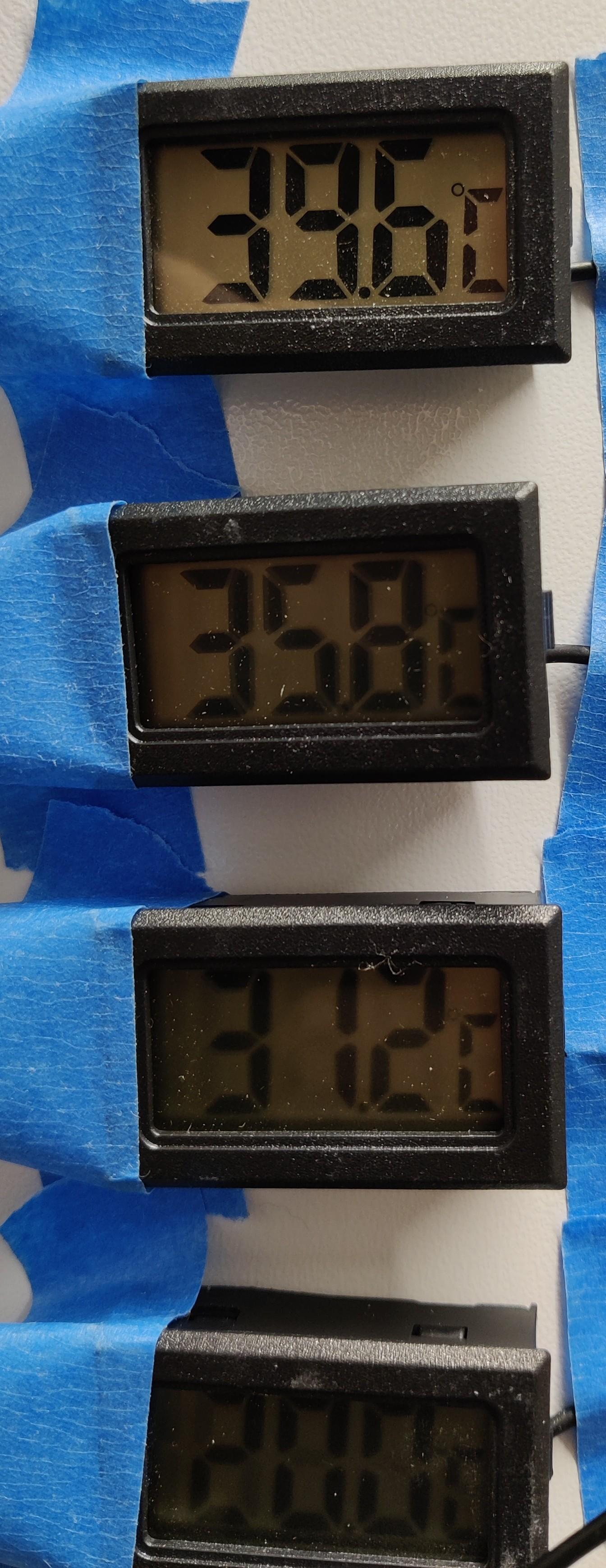

JohnMo Posted January 26, 2024 Posted January 26, 2024 My attempt. Cheap eBay sensor with a 6mm probe. Drilled 4x 6mm holes in casing of the UVC down to 50% height. The 3rd one down coincides with the height of the secondary returns. There is about 4 deg under read compared to the thermostat pocket. But all good enough to get an idea of the hot water left in the cylinder. Especially good for a slim line cylinder. Night before temporary mounts with tape. Showing level of hot water (bottom gauge reads 20 degs) 1

marshian Posted January 27, 2024 Posted January 27, 2024 On 26/01/2024 at 23:21, JohnMo said: My attempt. Cheap eBay sensor with a 6mm probe. Drilled 4x 6mm holes in casing of the UVC down to 50% height. The 3rd one down coincides with the height of the secondary returns. There is about 4 deg under read compared to the thermostat pocket. But all good enough to get an idea of the hot water left in the cylinder. Especially good for a slim line cylinder. Night before temporary mounts with tape. Showing level of hot water (bottom gauge reads 20 degs) Expand I did similar but only top and bottom

JohnMo Posted January 27, 2024 Posted January 27, 2024 On 27/01/2024 at 00:06, Adsibob said: How do you do this without causing leaks in the UVC? Expand The cylinder consists of 1. An outer metal jacket/casing - decorative cover. 2. Then insulation 3. Then the cylinder. I drilled in item 1. Then with a drill bit in fingers removed the insulation until I touched the cylinder 3. You don't drill into item 3. The probe butts but against the cylinder wall and you get a slight under read.

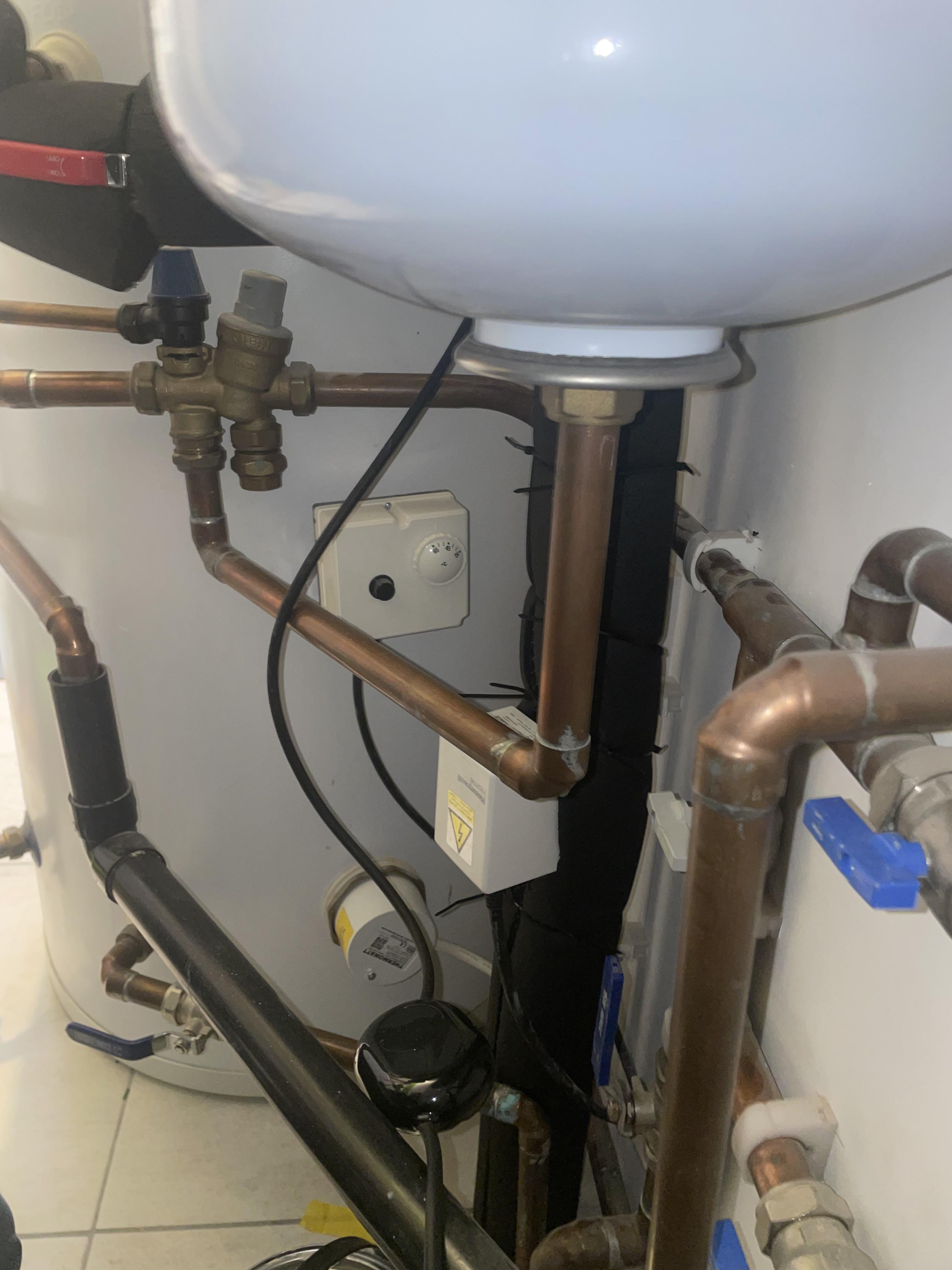

ProDave Posted January 27, 2024 Posted January 27, 2024 @Adsibob can you post a picture of your cylinder please. It SHOULD already have a thermostat, that is a safety requirement and part of G3 for an unvented cylinder to ensure it cannot overheat, so I don't see why you are only timing the boiler to come on for set periods. Have you actually tried leaving the hot water on all day and just letting the thermostat do it's job?

Adsibob Posted January 27, 2024 Author Posted January 27, 2024 On 27/01/2024 at 09:43, ProDave said: @Adsibob can you post a picture of your cylinder please. Expand yes, as mentioned above it does has a thermostat. I use this to choose the water temp. The thermostat is a bit difficult to read, but it’s about 55C. On 27/01/2024 at 09:43, ProDave said: It SHOULD already have a thermostat, that is a safety requirement and part of G3 for an unvented cylinder to ensure it cannot overheat, so I don't see why you are only timing the boiler to come on for set periods. Have you actually tried leaving the hot water on all day and just letting the thermostat do it's job? Expand I time it for two reasons: 1) I can control the periods of heat loss to when it doesn’t matter (eg when we are asleep) 2) in winter I can heat the cylinder at the same time as running the central heating, to get better efficiency from the boiler. Questionable whether this makes a difference though, given the Veissman boiler is very efficient and modulates to 1/17th of its max output.

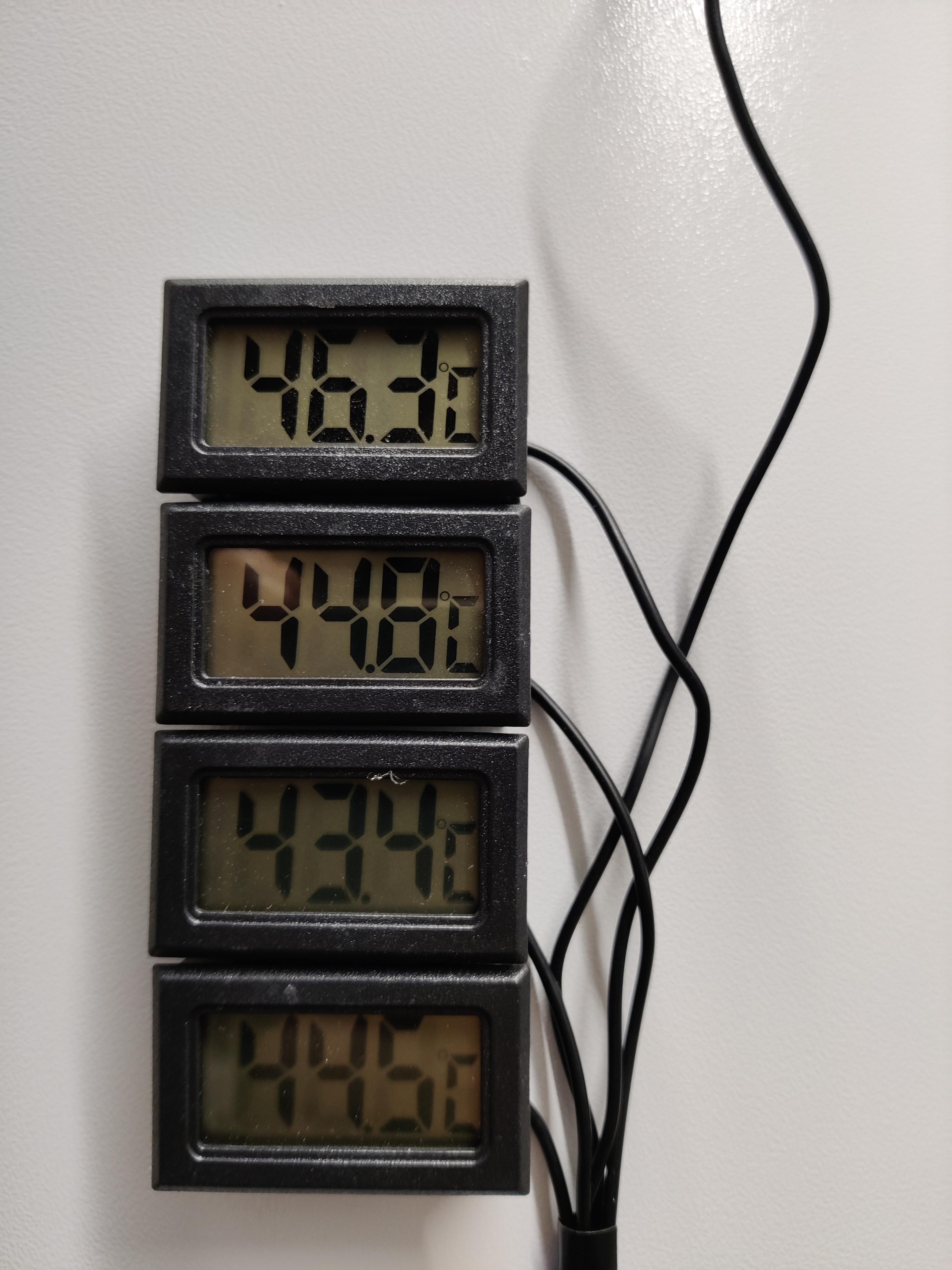

marshian Posted January 27, 2024 Posted January 27, 2024 On 27/01/2024 at 00:31, marshian said: I did similar but only top and bottom Expand Forgot to add a Picture
marshian Posted January 27, 2024 Posted January 27, 2024 You could use something like a Sonoff Temp Sensor 3/4 of the way up the tank - set the temp set point to just below your target tank temp and then use the switch facility as an output signal to fire HW as you would be about to run out of HW at that point?
