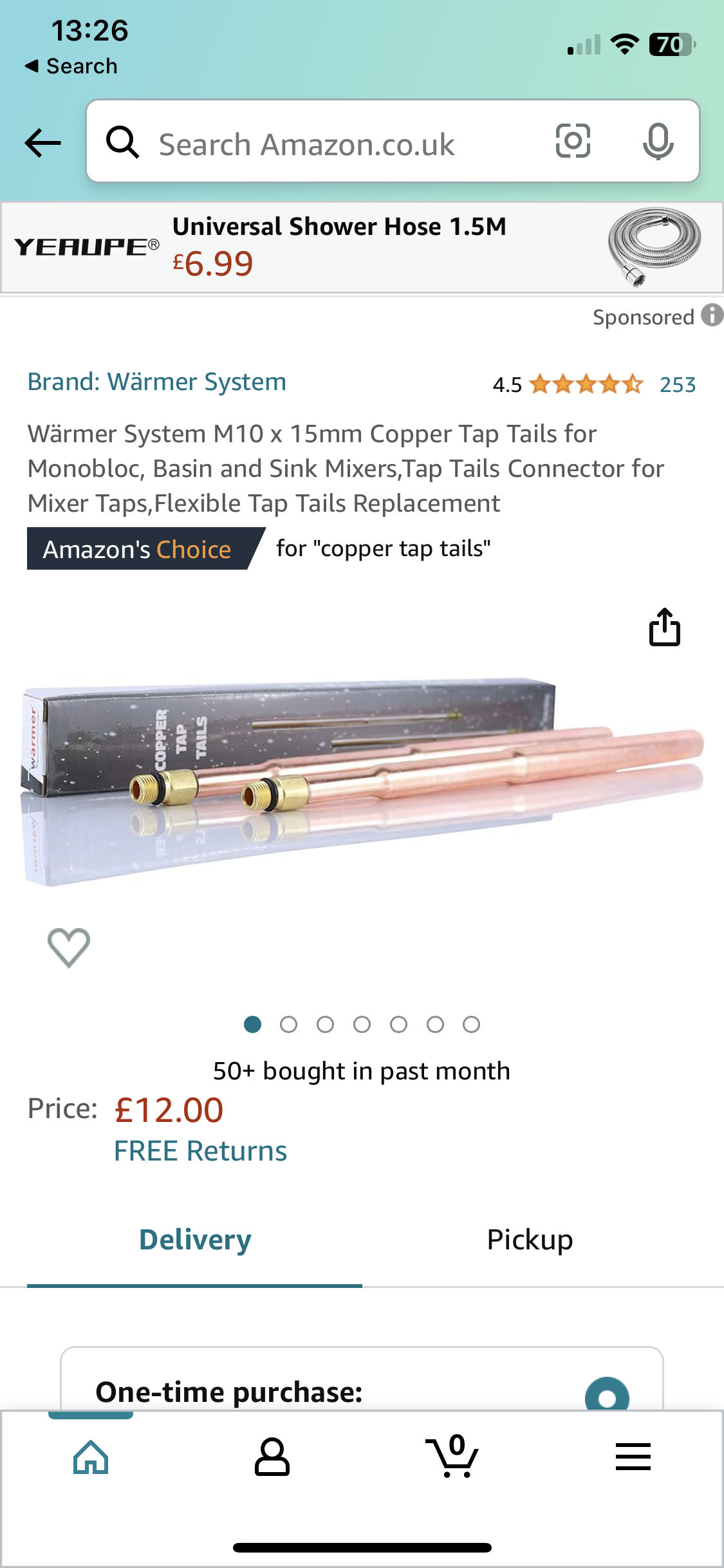

Pocster Posted January 22, 2024 Author Posted January 22, 2024 (edited) 1 hour ago, Mike said: No doubt poor installation can be a problem, particularly with DIYers, but it wasn't apparent in those I saw that had failed. They'd just split somewhere along their length. I imagine that each time the tap is turned off there's a shockwave that runs through the pipe which stresses it. Repeat enough and it may eventually burst. None that I'd buy. So those copper rods then ? . Is the connection end ‘ standard ‘ I.e simply fits in a Hep2o connector . Unfortunately I can only do this on the kitchen taps ( others are to restricted and must be flexi hoses ) like these ? Edited January 22, 2024 by Pocster
markc Posted January 22, 2024 Posted January 22, 2024 Yes the straight end is 15mm copper so will go into hep20 1 1
Pocster Posted January 22, 2024 Author Posted January 22, 2024 1 hour ago, markc said: Yes the straight end is 15mm copper so will go into hep20 I’ll give ‘em a whirl 👍

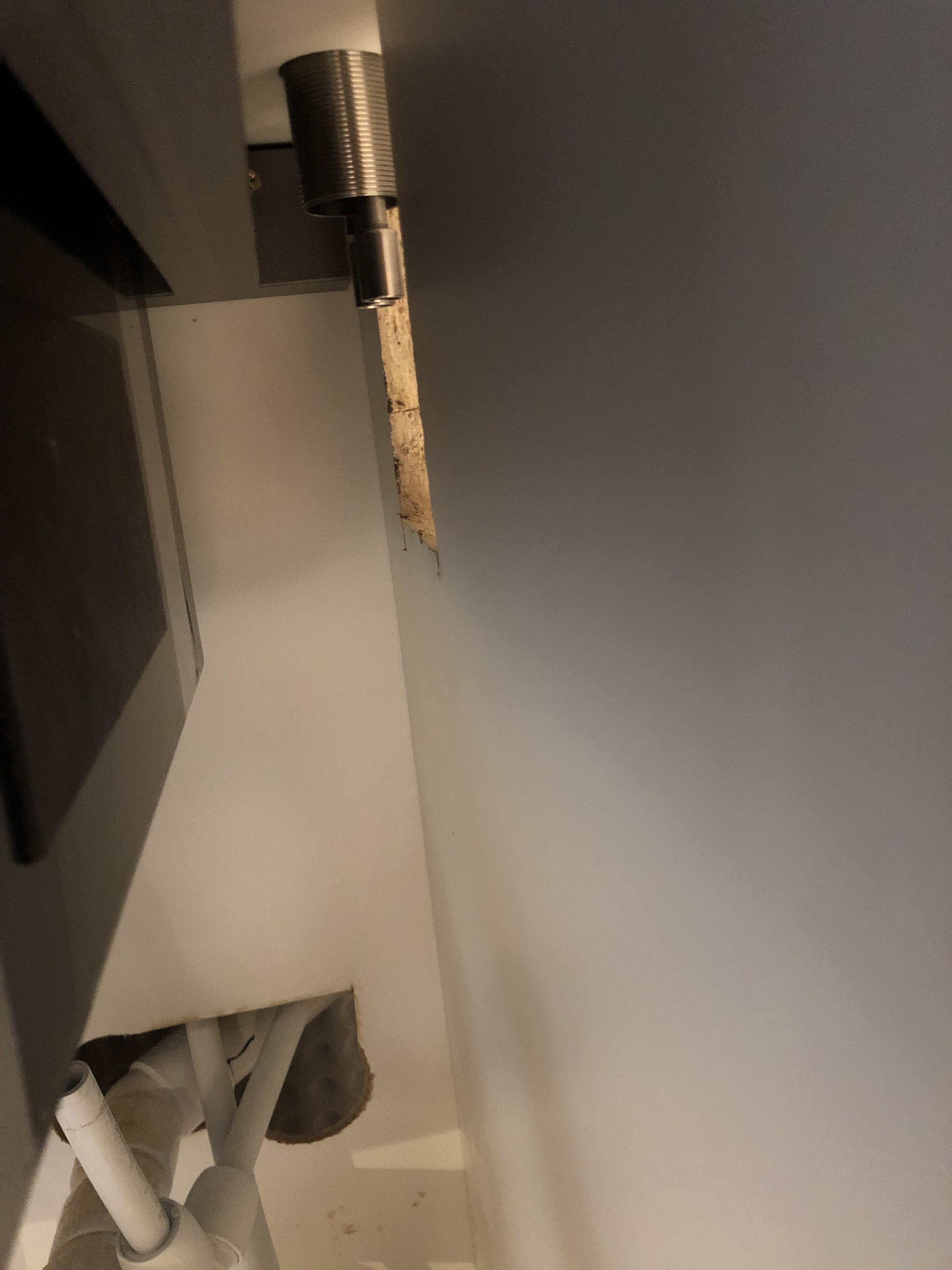

Pocster Posted January 22, 2024 Author Posted January 22, 2024 (edited) 2 hours ago, markc said: Yes the straight end is 15mm copper so will go into hep20 One issue I’ve got is by bad luck ( or incompetence ) those copper tails I assume have zero bend . As you can see my tap inlets are just inline with the cabinet side . Once I add the Hep2o fitting I’m going to be straining them . Do I worry ? . Or just cut that slot down much further in the unit so copper tails and Hep2o have a bit of room ? I.e no strain on the copper as nice and vertical . Needless to say no issue if I use flexi’s Edited January 22, 2024 by Pocster Bum

markc Posted January 22, 2024 Posted January 22, 2024 1 hour ago, Pocster said: One issue I’ve got is by bad luck ( or incompetence ) those copper tails I assume have zero bend . As you can see my tap inlets are just inline with the cabinet side . Once I add the Hep2o fitting I’m going to be straining them . Do I worry ? . Or just cut that slot down much further in the unit so copper tails and Hep2o have a bit of room ? I.e no strain on the copper as nice and vertical . Needless to say no issue if I use flexi’s You can ease a bend into them, don’t try to bend the 15mm bit even with a spring or you can distort the end that’s going into the hep20. Gently bend the thinner section/s. If you have a small tube bender even better 1
Pocster Posted January 22, 2024 Author Posted January 22, 2024 10 minutes ago, markc said: You can ease a bend into them, don’t try to bend the 15mm bit even with a spring or you can distort the end that’s going into the hep20. Gently bend the thinner section/s. If you have a small tube bender even better Now I saw this on YouTube . But … all sounds like work and possible failure . Cutting a chunk out the unit is ‘safer ‘ I think
markc Posted January 22, 2024 Posted January 22, 2024 2 minutes ago, Pocster said: Now I saw this on YouTube . But … all sounds like work and possible failure . Cutting a chunk out the unit is ‘safer ‘ I think Not as hard as you may think, drill a hole in a piece of timber, 20-25mm thick and then use drill to bell the hole (get rid of the sharp edge) put tube through hole and lever gently … old sparkles way of bending conduits etc.

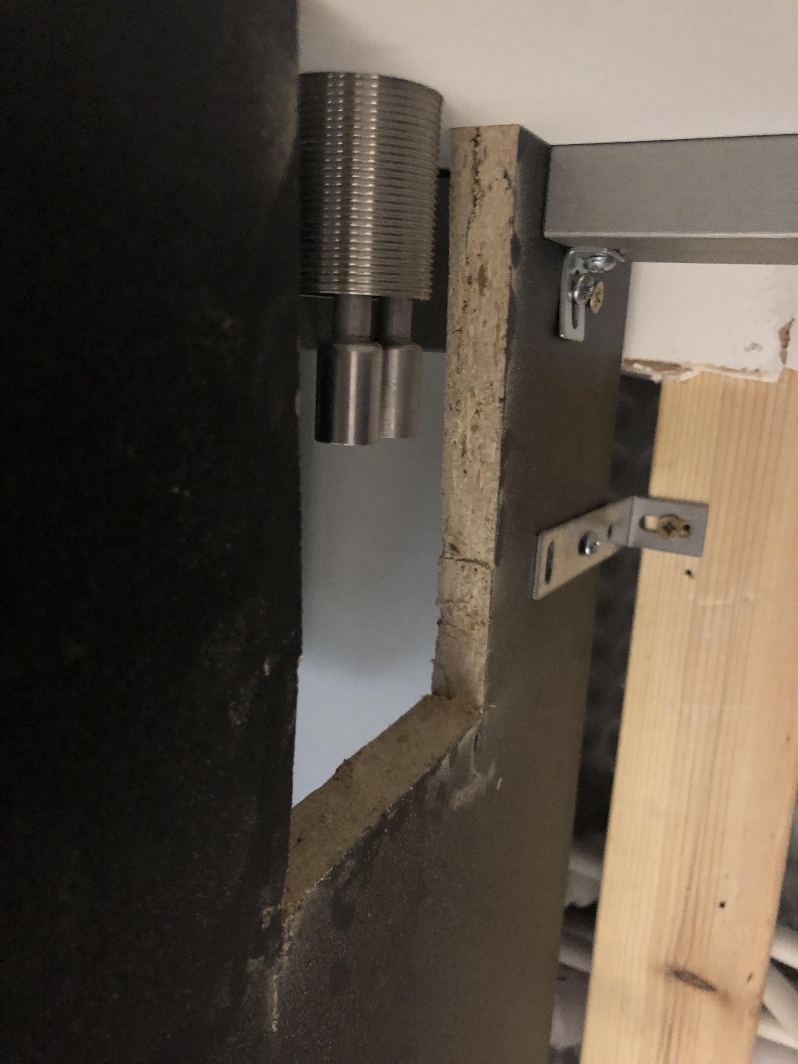

Pocster Posted January 22, 2024 Author Posted January 22, 2024 (edited) 14 minutes ago, markc said: Not as hard as you may think, drill a hole in a piece of timber, 20-25mm thick and then use drill to bell the hole (get rid of the sharp edge) put tube through hole and lever gently … old sparkles way of bending conduits etc. Hmmm . But I’ve really got to S bend the top haven’t I . A bend to pull the copper across away from the cabinet then a bend to get it vertical again . Space is tight there with the sink . I’ll (expletive deleted) the unit apart skill required = negligible 👍 Edited January 22, 2024 by Pocster
