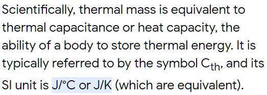

SteamyTea Posted January 8, 2024 Posted January 8, 2024 4 minutes ago, joe90 said: thermal mass Find a derived SI unit for it and I am happy to change my mind. 5 minutes ago, joe90 said: thermal mass (sorry) will store heat but needs heating so will absorb heat out of the house but keep heat levels more stable Stable at a lower mean temperature for the same energy input. Did the calculations on that years ago. Ideally what you want is an airtight box made from insulation. Then clad it in your favourite coating. If a brick/block is 100mm wide, that is 100mm less insulation.

MikeGrahamT21 Posted January 8, 2024 Posted January 8, 2024 40 minutes ago, SteamyTea said: Find a derived SI unit for it and I am happy to change my mind. 🤣 enjoy!
Gone West Posted January 8, 2024 Author Posted January 8, 2024 43 minutes ago, SteamyTea said: Find a derived SI unit for it and I am happy to change my mind. Everybody knows what it means though. https://www.greenspec.co.uk/building-design/thermal-mass/ https://www.designingbuildings.co.uk/wiki/Thermal_mass_in_buildings 1
joe90 Posted January 8, 2024 Posted January 8, 2024 4 minutes ago, Gone West said: Everybody knows what it means though. Except steamy and Jeremy 🤷♂️ 3

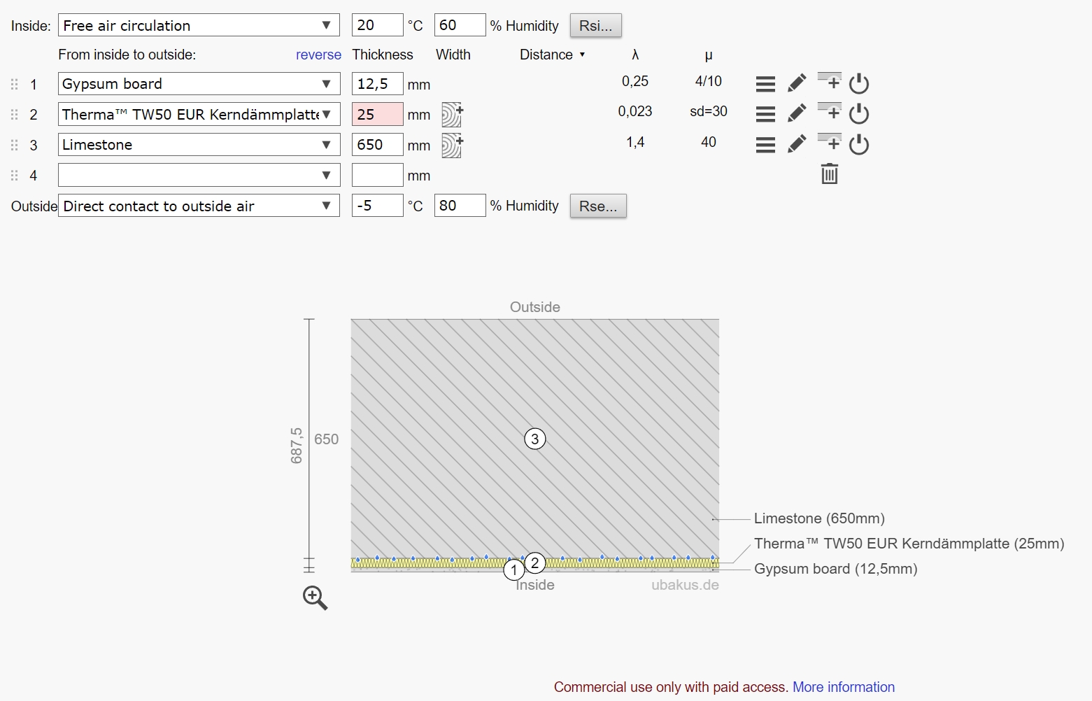

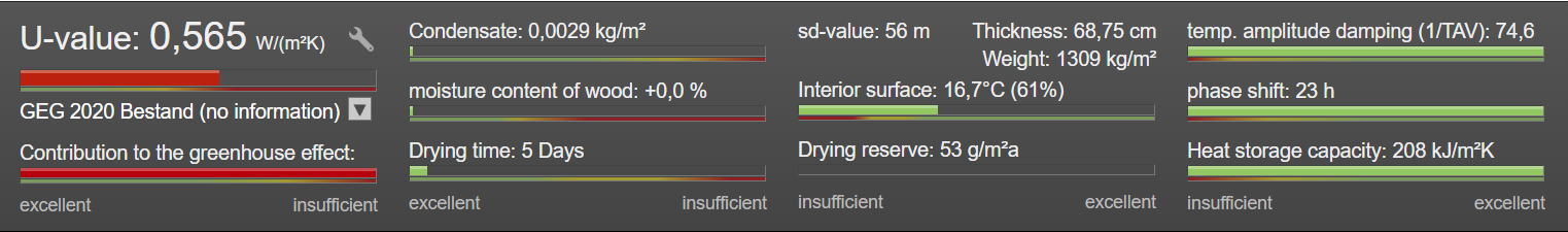

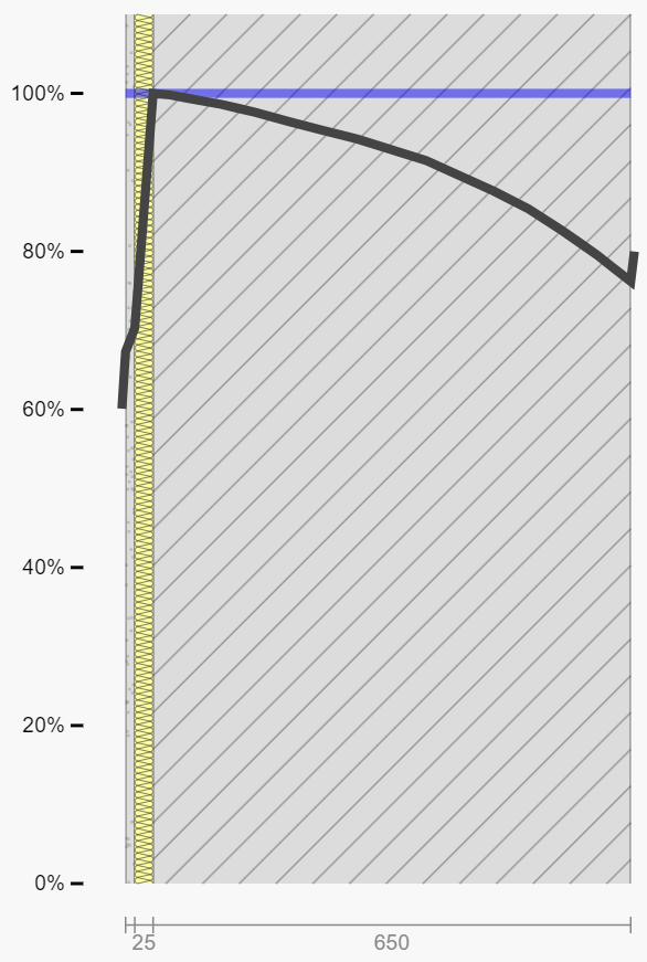

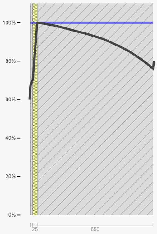

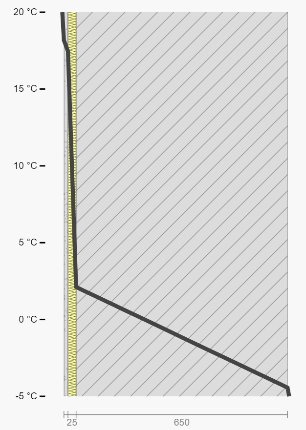

IanR Posted January 8, 2024 Posted January 8, 2024 (edited) 39 minutes ago, Gone West said: Yes, it's the "may/should" bit, I'm not sure about. If the thermal mass is hidden, am I going to end up with an old wall that becomes cold again. Even without "rising damp", it's a condensation risk. It's a good improvement in U Value 1.5 -> 0.565, but moisture collects between the PIR and Stone wall. Temp on the left and humidity on the right. But, the condensation may not be an absolute risk. It shows from 1° and below it's a risk, but it doesn't consider how long the temp needs to be below 1° for it to stabilise. The 650mm wall has a 23hr decrement delay, so it's got to be down at that temp for over a day before the inner face could drop below dew point. Edited January 8, 2024 by IanR 1 1

Gone West Posted January 8, 2024 Author Posted January 8, 2024 1 minute ago, IanR said: But, the condensation may not be an absolute risk. It shows from 1° and below it's s risk, but it doesn't consider how long the temp needs to be below 1° for the for it to stabilise. The 650mm wall has a 23hr decrement delay, so it's got to be down at that temp for over a day before the inner face could drop below dew point. Thanks, that's really interesting. Food for thought.
