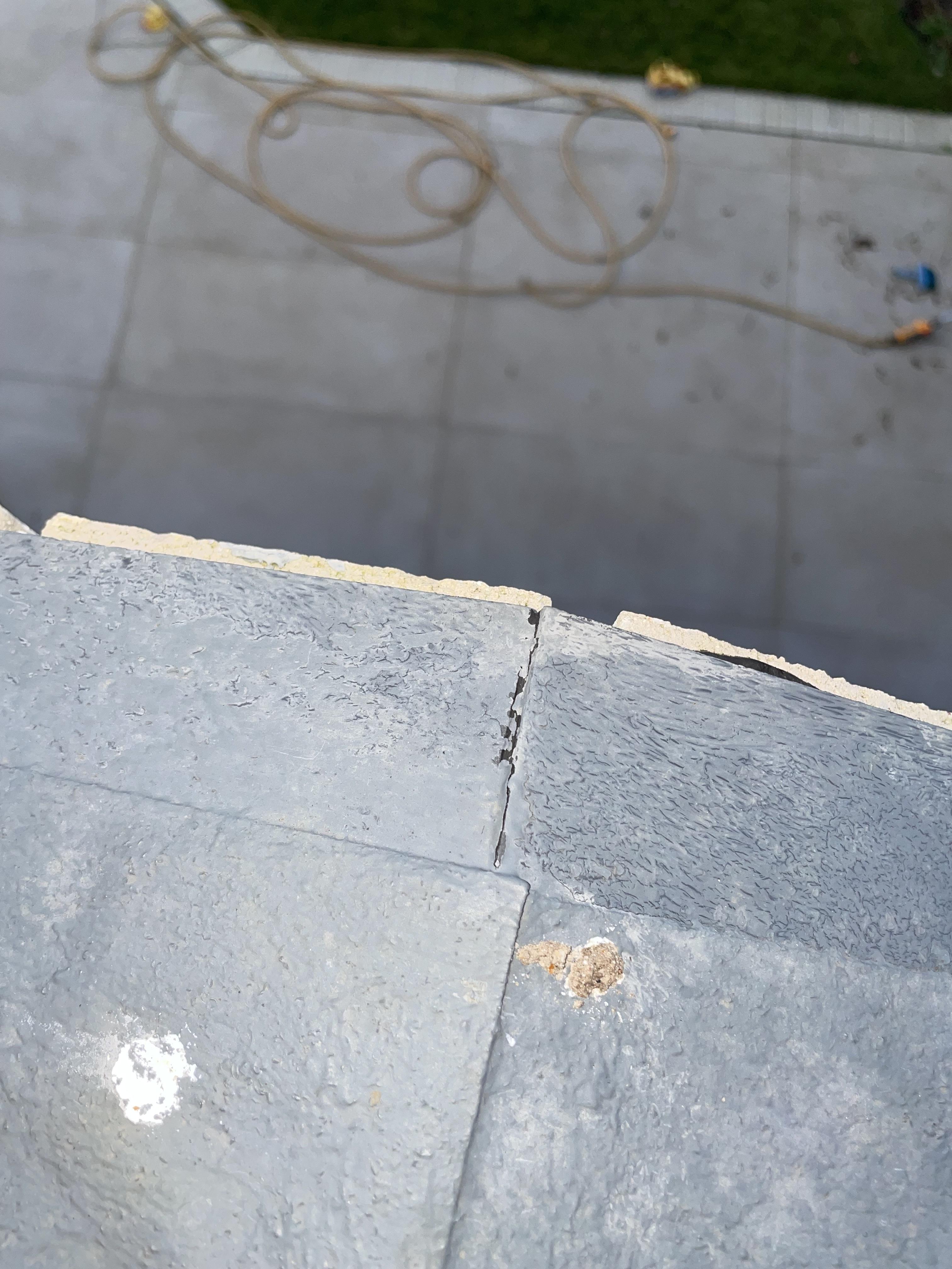

Adsibob Posted January 6 Author Share Posted January 6 (edited) So I have a few ideas about what is causing the water ingress. I’m 99% confident it’s a poorly specified parapet wall, that, to make matters worse, was built worse than that spec. There were many to be two DPMs but neither travels across the full width of the brick wall, only two thirds of it. Then on top of that, a plastic capping has been laid, but the tiles don’t overlap each other, so there are grout joints between the tiles which have now cracked, allowing water through. Finally, the tile capping doesn’t overhang the brick (let alone have a drip profile. I keep flip-flopping over what to do (still lots of anger messing with my thoughts). I have 6-9 days of dry weather during which I’m going to let it breathe, but I really need to figure out what the plan is. Long term, i will install an aluminium coping or capping that is properly specified. I may also put in lots of additional weep vents to let more air into the cavity, or swap a couple of bricks with air bricks temporarily. But in the short term, I need to decide which of the following two plans to execute: PLAN A: Cover the top two or three courses of bricks of the parapet wall (on both sides) with a DPM and clamp it to the parapet with some simple Irwin clamps which I picked up today - this should immediately fix the water ingress (I hope!) but has two potential downsides: 1) it won’t let those rows of bricks breathe, and as these are very damp and quite mouldy, the mould will get worse - I can possibly clean off the mould first, but it is so damp it may just grow back, encouraged by the shade provided by the DPM 2) it is perhaps not going to give me accurate evidence of the exact source of the leak, because several components of the wall will be covered at once; and 3) there is a small chance the clamps could damage the roof membrane which returns up the rear side of the parapet, causing even more problems. PLAN B Apply sealant to the cover the cracked joints (and even the ones which don’t look cracked) in the tile capping and also apply sealant all along the small width of brick that is exposed. This should give protection in respect of two of the three concerns about the parapet, but doesn’t solve the lack of overhang issue. The advantage of Plan B is: 1) it gives a more accurate result, as I will know that if this solves the issue for the next few months, we know the exact cause, whereas if it doesn’t then it is some other aspect of the parapet that is causing the leak. 2) it lets the wall breathe 3) no risk of damage to the roof membrane Edited January 6 by Adsibob Link to comment Share on other sites More sharing options...

Adsibob Posted January 7 Author Share Posted January 7 Thanks guys, all good suggestions. I think I need to get my hands dirty and do this myself. I’ve only used a sealant gun twice before, but both times it was fairly easy, so I reckon I could do Plan B myself. I will mull on this over the next few days of dry period and see if I feel the same way. It still beggars belief that of all the professionals involved, they thought this was an acceptable way of leaving the top of a parapet wall: This is the apex. Cracked grout between two tiles. Every joint is like that. Two tiles don’t even cover the brick, let alone overhang it. Then membrane does not cover the tiles fully! Link to comment Share on other sites More sharing options...

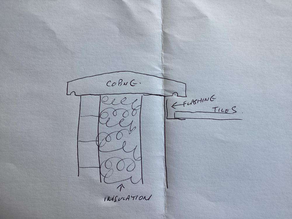

joe90 Posted January 7 Share Posted January 7 @Adsibob I am still at odds knowing what exactly you have and how the membrane covers the wall, usually a parapet wall is like this. Link to comment Share on other sites More sharing options...
Adsibob Posted January 7 Author Share Posted January 7 (edited) It is a bit more complicated. This is a single skin brick parapet wall, because only the outer wall of the cavity wall rises up to form the parapet. In this way, the roof space was maximised to allow more green (seedum) roof. So the membrane which is under the sedum was overlapped up the parapet wall and over the single brick, but not fully over, due to a mistake in my view. Then over that brick that was partially overlapped with membrane, some plastic tiles were layed and over those tiles, another layer of membrane, but again not fully covering the tile. Edited January 7 by Adsibob 1 Link to comment Share on other sites More sharing options...
joe90 Posted January 7 Share Posted January 7 3 hours ago, Adsibob said: due to a mistake in my view. Oh yes, an ally or GRP single skin copping would fix that for sure. First example I found. https://www.aluminiumrainflow.co.uk/product-page/skyline-91-120mm-wall-width-level-coping-3m-length?gclid=Cj0KCQiAtOmsBhCnARIsAGPa5yY6uN-wvzTSnJtv8_ofO-PsREM2XXOWFL9_3G5VAOwJ8GZ6fHzhYFYaAqTQEALw_wcB Link to comment Share on other sites More sharing options...
SteamyTea Posted January 8 Share Posted January 8 This detail worries me. What is to stop water from getting under the tiles when they adhesive/grout fails, and what is to stop water building up and over flowing the top of the flashing when the drain fails? This must be why parapets are so hated. Link to comment Share on other sites More sharing options...
joe90 Posted January 8 Share Posted January 8 Sorry @SteamyTea my crayon assisted drawing was only a ref to the coping stone to try and understand the OP,s problem as we have no drawing of what he actually has (a picture speaks a thousand words). @Adsibob actually has no tiles. Link to comment Share on other sites More sharing options...
SteamyTea Posted January 8 Share Posted January 8 59 minutes ago, joe90 said: a picture speaks a thousand words It can, or make for more confusion. Possibly why I am not sure what is going on in this thread. Link to comment Share on other sites More sharing options...
