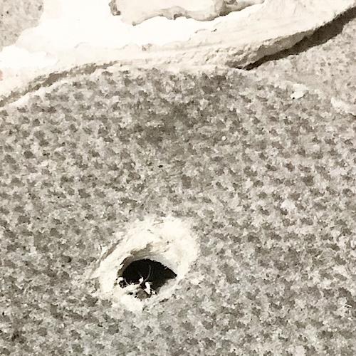

Cut some holes on plasterboard without realising it’s asbestos cement board while doing some DIY at home recently.
Vacuum up a small amount of asbestos cement dust up (less than a handful at most) off the carpet
Immediately wiped the carpet area down with wet wipes & wet rags thoroughly.
Is this sufficient enough or do I need to go further with cleaning of the carpet, perhaps steam cleaning?
I’m thinking of disposing the vacuum cleaner as it’s most likely contaminated or just replace the filter?
Washed my clothes already or is it better just to dispose it?
Also, I didn’t wear a mask, so definitely inhaled some of the dust as well!
The more I look into asbestos & stuff, the more frightening it gets, I’m having nightmares now thinking about it!
Completer DIY disaster, kicking myself for not doing more research on older houses having asbestos material in its construction.
I am very worried now, any advice?

What age is the property? Are you 100% sure it’s cement asbestos? Would have been a notable difference from cutting plasterboard, much harder and brittle.
Photos?
House built around 1970’s to early 1980’s
It was hard to cut with textured pattern on one side

The plasterboard material I cut into is dense, hard, can’t really see flakes or fibre on the cut edges
I’m certain it’s asbestos cement board

It does look like asbestos cement board (can see the hairy fibres next to the hole), but only one way of knowing and thats to get it tested.
From memory (and i'm sure someone will confirm), this type of asbestos is one of the few which the body is able to expel if it got in, its not a hugely dangerous version like the insulation asbestos.
You need long term exposure
drilling a few holes won’t kill you, relax a bit.

Just dump the vaccum filters / bags etc and wet wipe clean. No harm in getting the carpet shampooed. No need to replace! Remember the risk from asbestos is direct inhalation of fibres. Cement bound is far less risky, as even the liberated fibres are still attached to cement particles.

Do get the test done.
Hoover thoroughly, bin the bag, 10min wipe down... Move on!!
