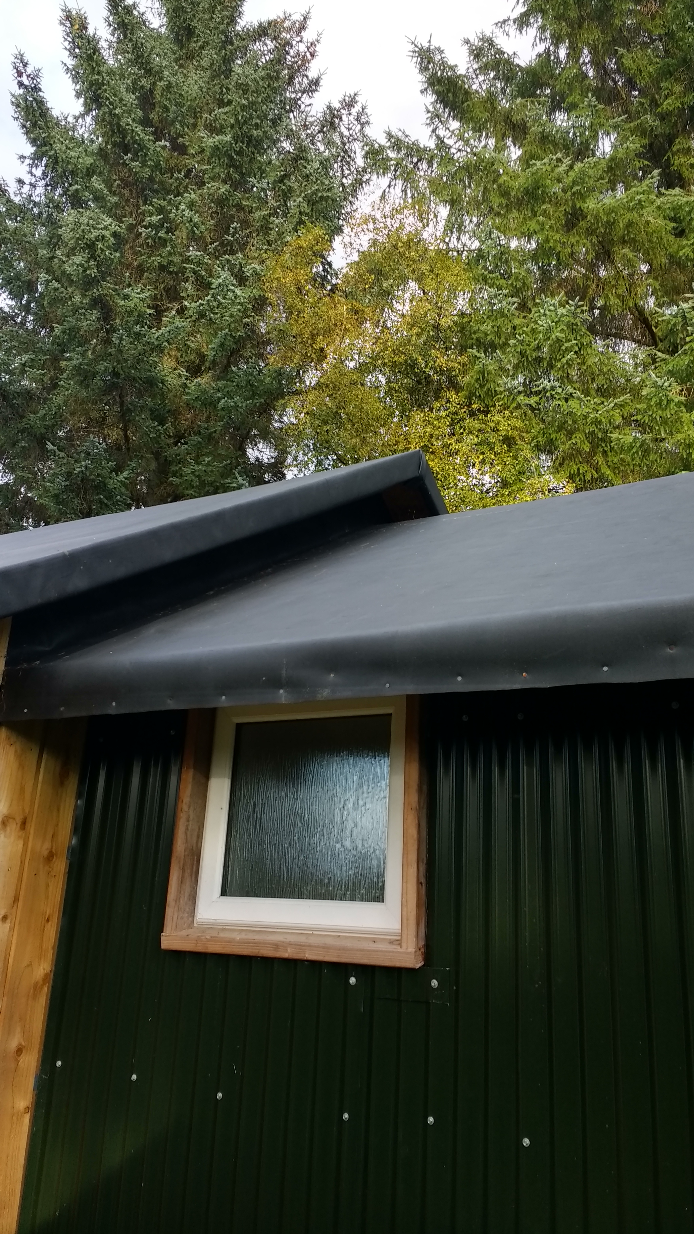

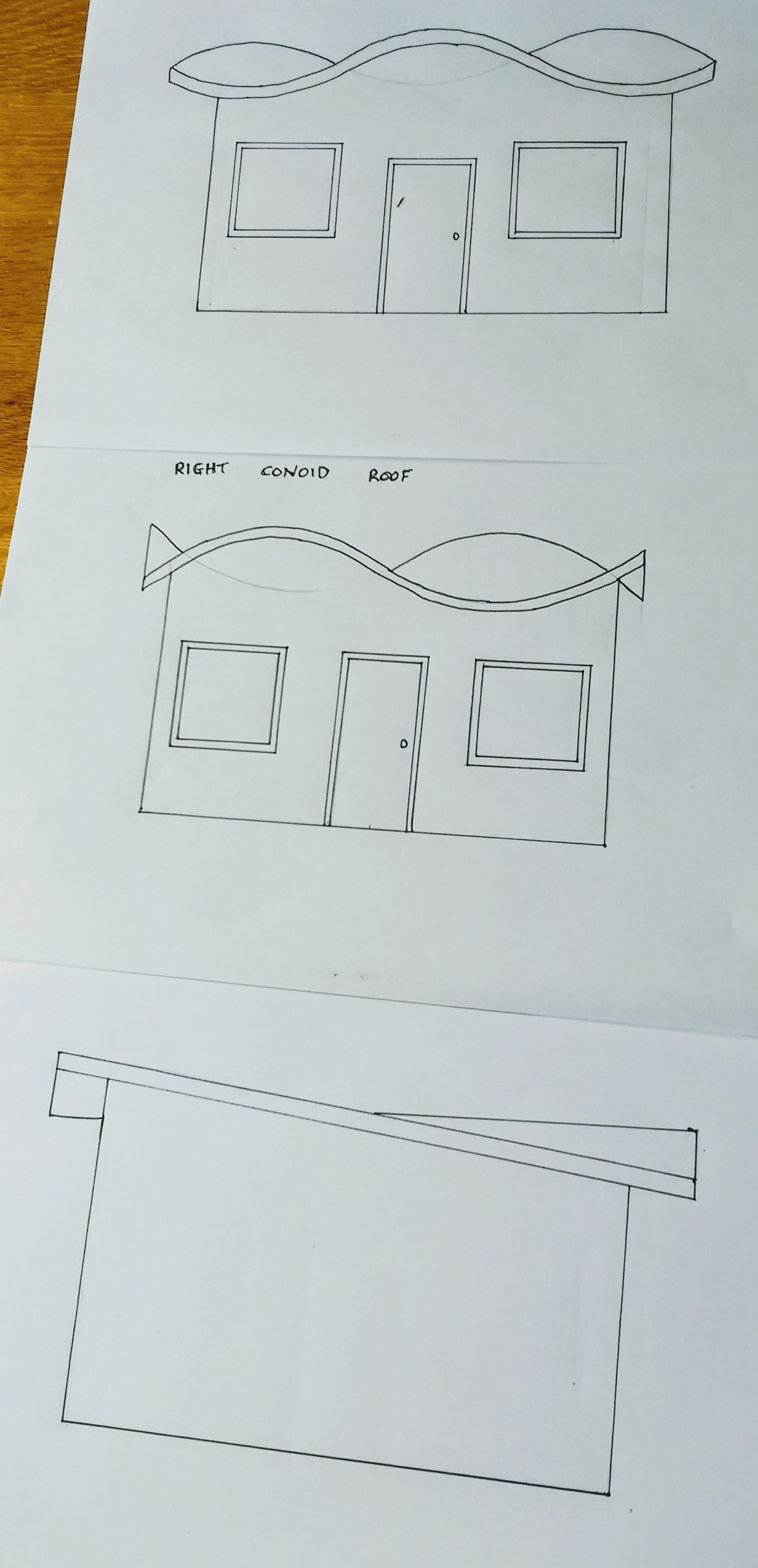

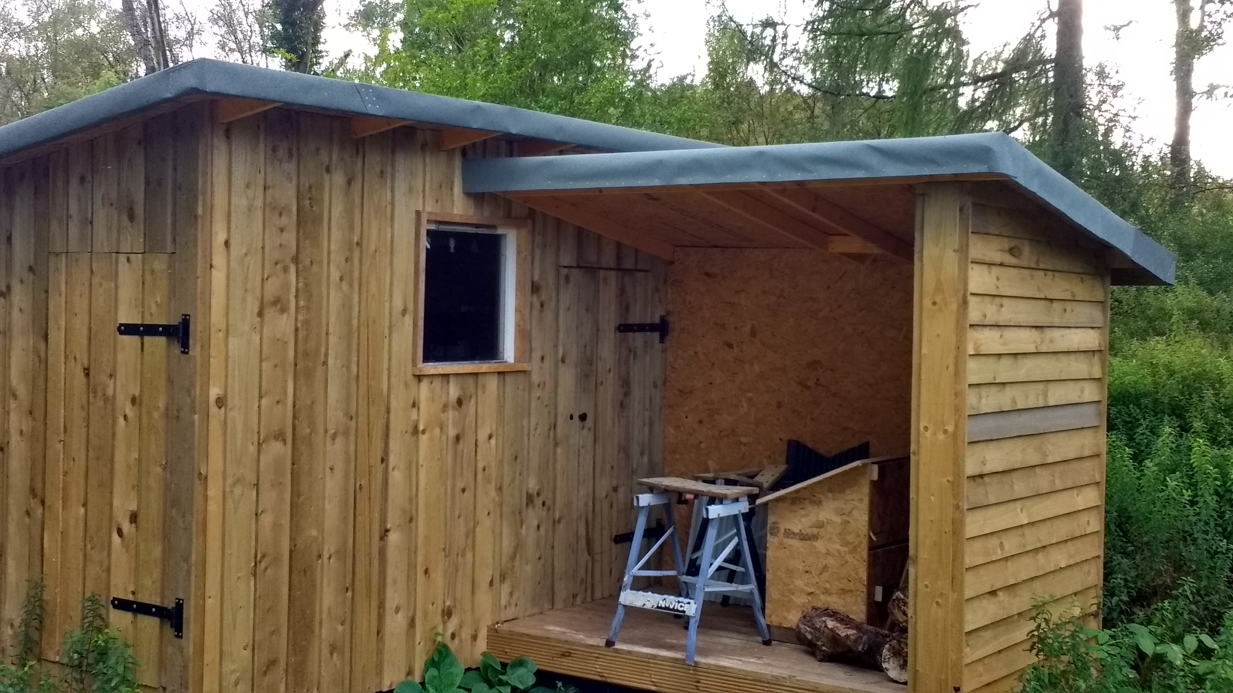

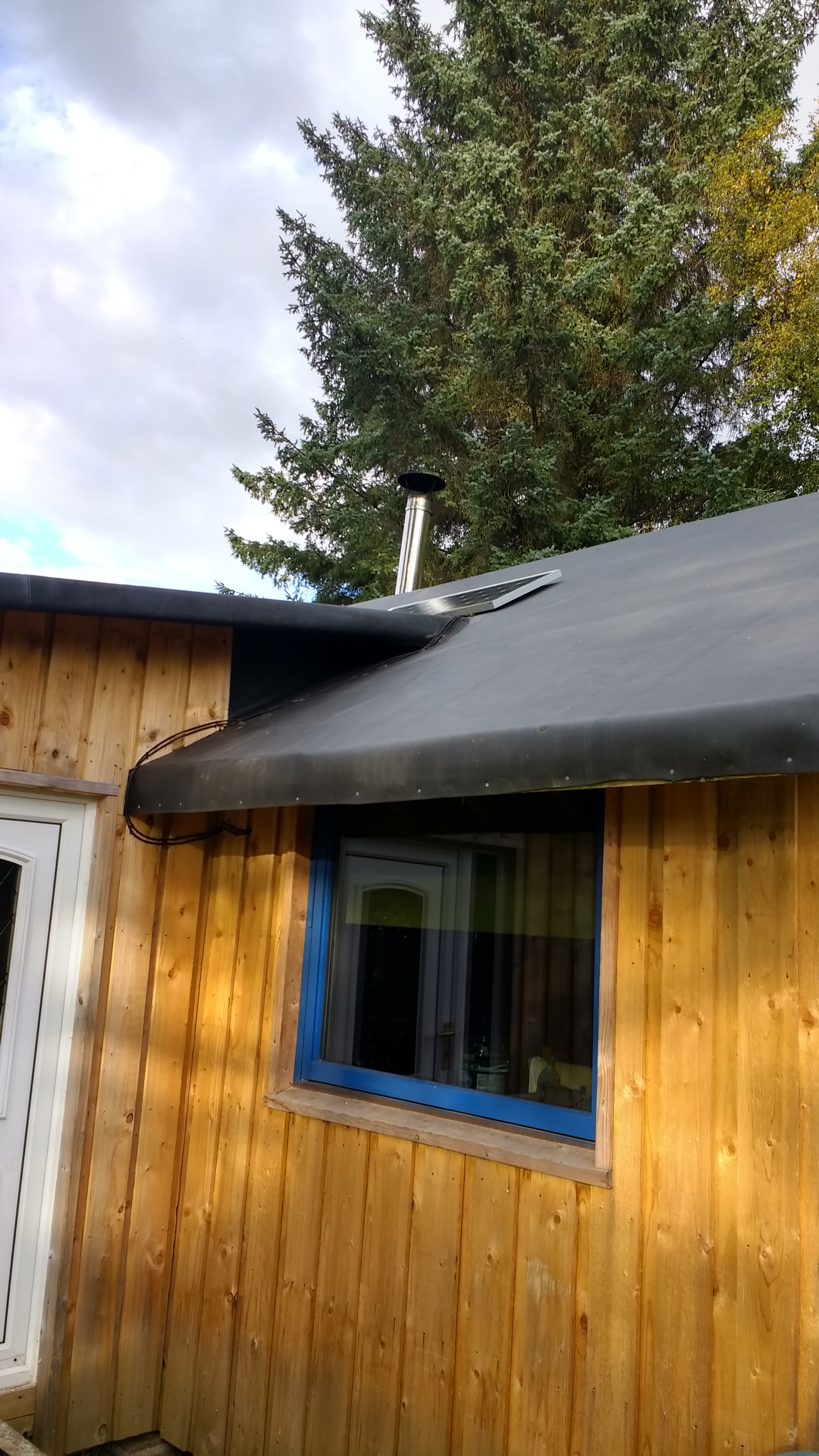

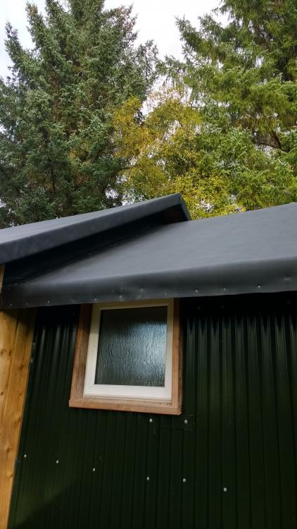

Tennentslager Posted September 17, 2017 Posted September 17, 2017 MmEPDM is easy peasy and as it's all one piece you can be pretty confident of staying dry! I believe it's the liner for most green roofs but that's a whole other proposition with much beefier supporting structures. Don't be shy with playing around with some design thoughts re the roof...could be a big statement for a small building. If it's a plain mono roof why not have the run corner to opposite corner? I had fun with my shed roof and think it works. I saw your post when I was up at the hut so took some pics of the roof. This one shows the EPDM lapped up to complete the gable join. Just stuck on to fresh OSB with contact adhesive. Another junction here using a jointing strip. Really easy, if you've repaired a cycle puncture before, EPDM is a skoosh. Finally, look up the school at Sagrada Familia to see the fantastic offset wave roof by Guidi...would work well on a little building? 1
Crofter Posted September 17, 2017 Author Posted September 17, 2017 The sketch that I'm working to is very utilitarian at the moment- minimum cost design. A 16x16ft box, 8ft high with a 4" fall across the roof. Corrugated steel cladding on all surfaces. It's a fairly brutal look, but stick a grass roof on there and you might get away with it. Alternatively setting the front wall back a foot or two could help, but it complicates things quite a bit and you lose floor area.
Tennentslager Posted September 17, 2017 Posted September 17, 2017 4" fall isn't much...2400 one side and 2100 the other would be better. 12" fall in old money ??
