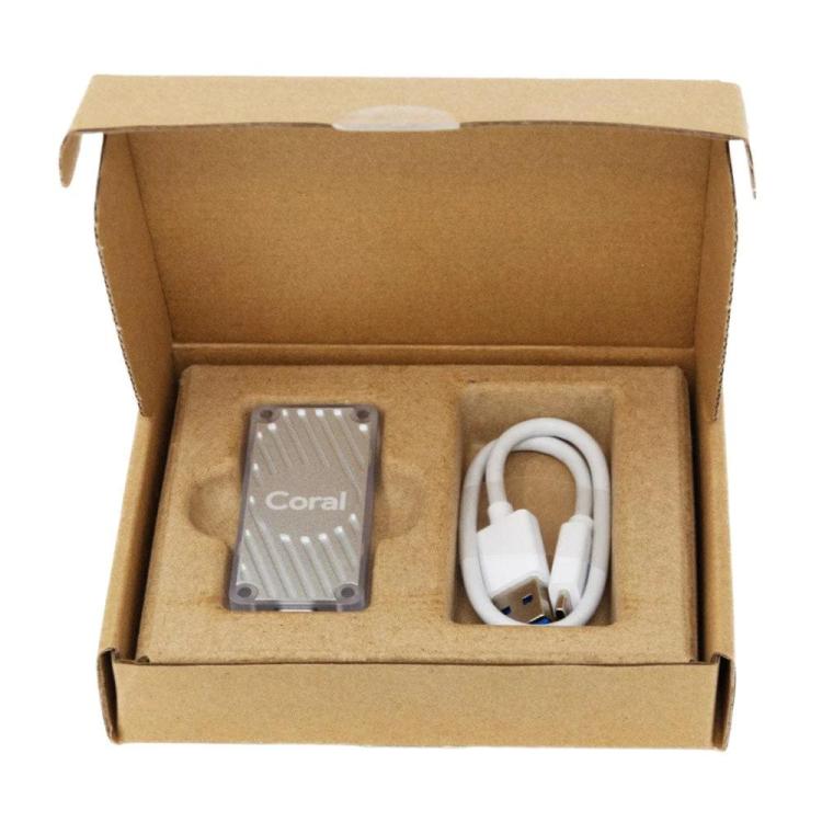

Pocster Posted December 12, 2023 Posted December 12, 2023 Anyone got one ? . Wondering if it’s worth it ? In theory ; performance vs cost it should be .

joth Posted December 13, 2023 Posted December 13, 2023 Yes definitely worth it if you're planning running Frigate, saves masses of watts to offload image detection from the main CPU Thankfully USB version available again now. I got mine during the post pandemic chip shortages , and the PCIe format limits how and where I can run it. 1

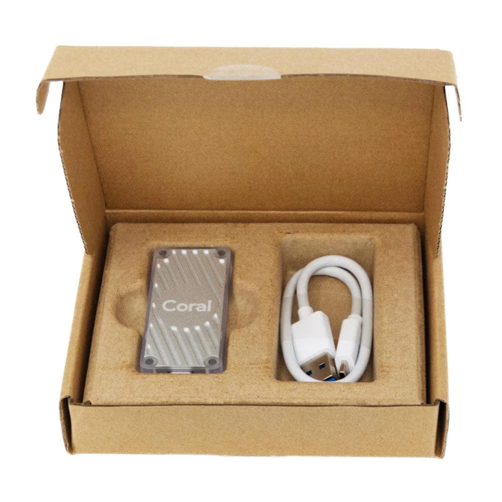

Adrian Walker Posted December 13, 2023 Posted December 13, 2023 34 minutes ago, jack said: Someone mentioned this on here ages ago. I looked into it at the time and you couldn't get them anywhere. I have used this - https://thepihut.com/products/coral-usb-accelerator 2

Pocster Posted December 13, 2023 Author Posted December 13, 2023 1 hour ago, SteamyTea said: What do you use it for? Object recognition. So instead of masking in your nvr and having false triggers ( cat , windy day etc ) you can actually recognise a ‘person’ for example with a certain degree of accuracy. Google coral tpu video or something . You’ll see tests . 0.8Tflops of processing can be given to a meagre raspberry pi for example .

Pocster Posted December 20, 2023 Author Posted December 20, 2023 Gave up with farnel . Went to Rs - loads in stock . Been playing today - at best I’m only 79% person . Frigates a barrel of laughs to use isn’t it …… 🫤😊

Pocster Posted January 30, 2024 Author Posted January 30, 2024 8 minutes ago, TerryE said: I am still not sure of whether doing the smart postprocessing is worth the hassle. I might get around to doing something like this as a project some day. I’m still experimenting with person detection on tpu . It’s been pretty good - no birds , spiders , weather false triggers . I few false triggers ( SWMBO put some drying clothes over a step ladder - was flagged more of a person than me ! ) . I use it internally which means triggering lights can cause a noticeable delay ( upto a second ) . A strategically placed motion sensor ( to get the light on instantly) and then person detection to keep it on seems to be working perfectly !
