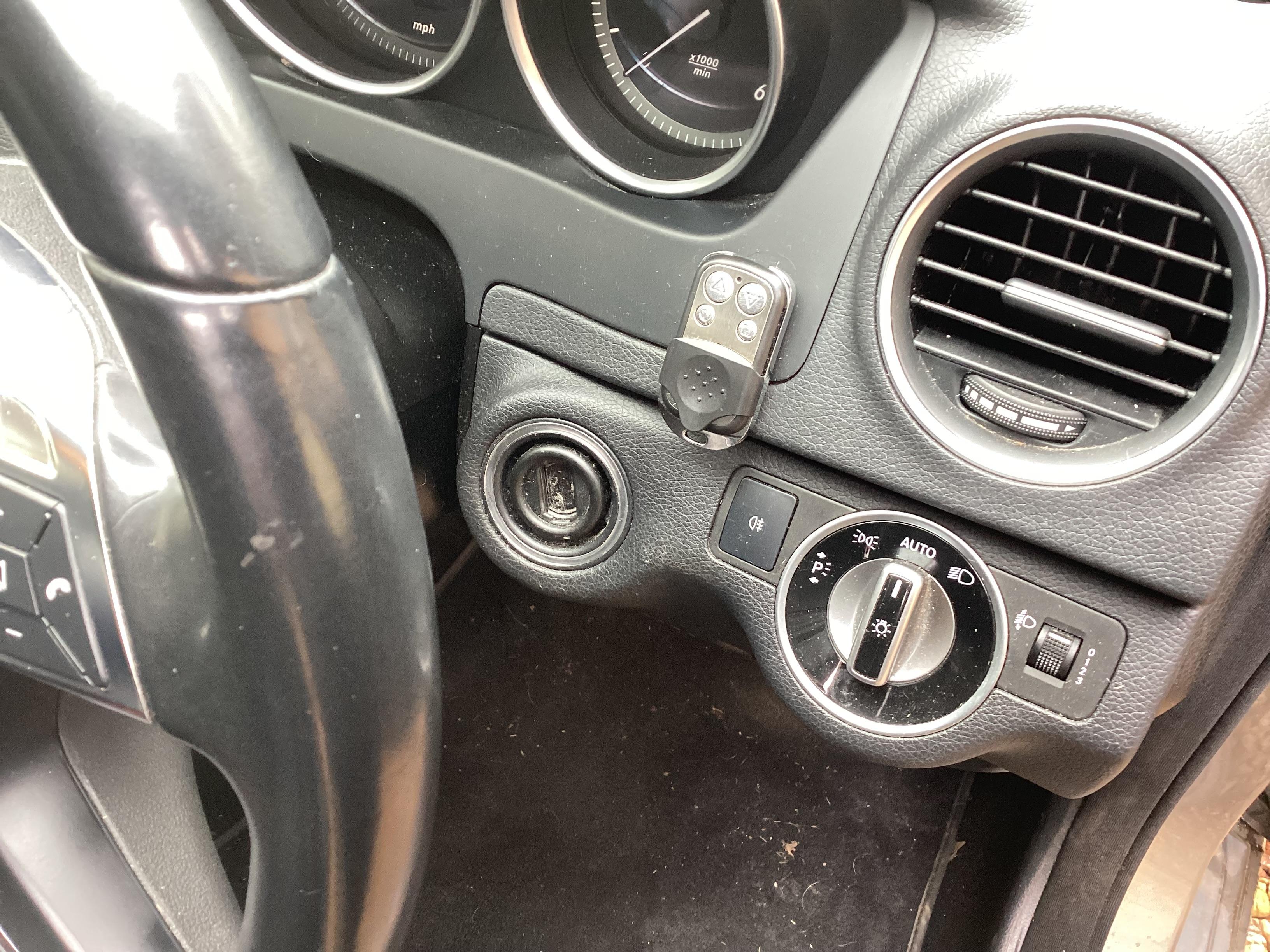

joe90 Posted May 3, 2024 Posted May 3, 2024 One of my gate fobs stuck to the dashboard of my car, easy…… 1 1

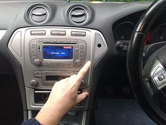

Onoff Posted May 3, 2024 Posted May 3, 2024 I removed a dash blank and got my lad to copy and 3D print it to take a push button. then you take a fob apart and solder the push button to it with a couple of wires, 1

SteamyTea Posted May 5, 2024 Posted May 5, 2024 On 03/05/2024 at 22:33, Onoff said: I removed On my steering wheel I have 17 knobs, and one behind it. It looks just like yours. Just leave the (expletive deleted)ing gate open like the postman does. You got more knobs and slots on your radio.
