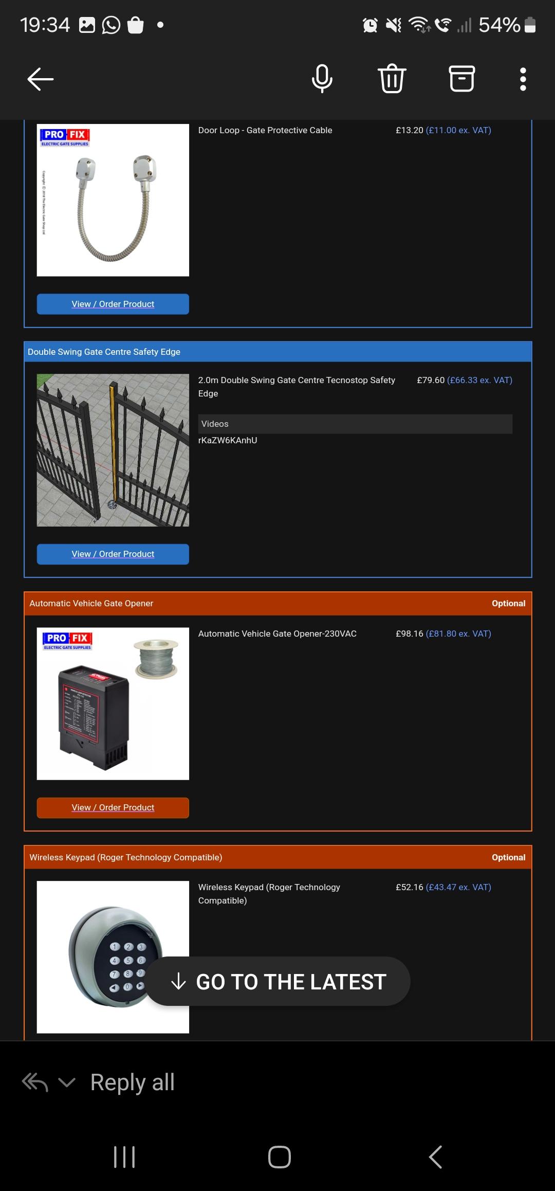

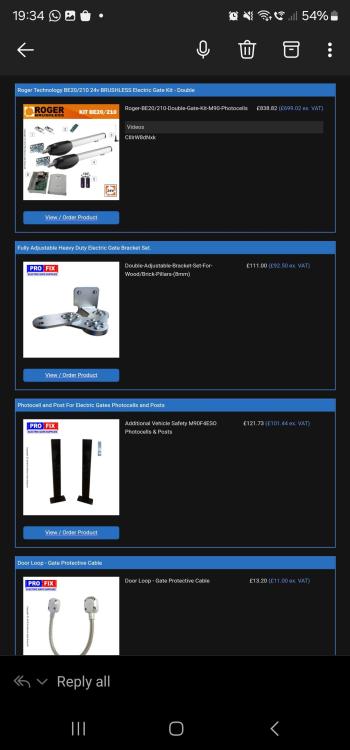

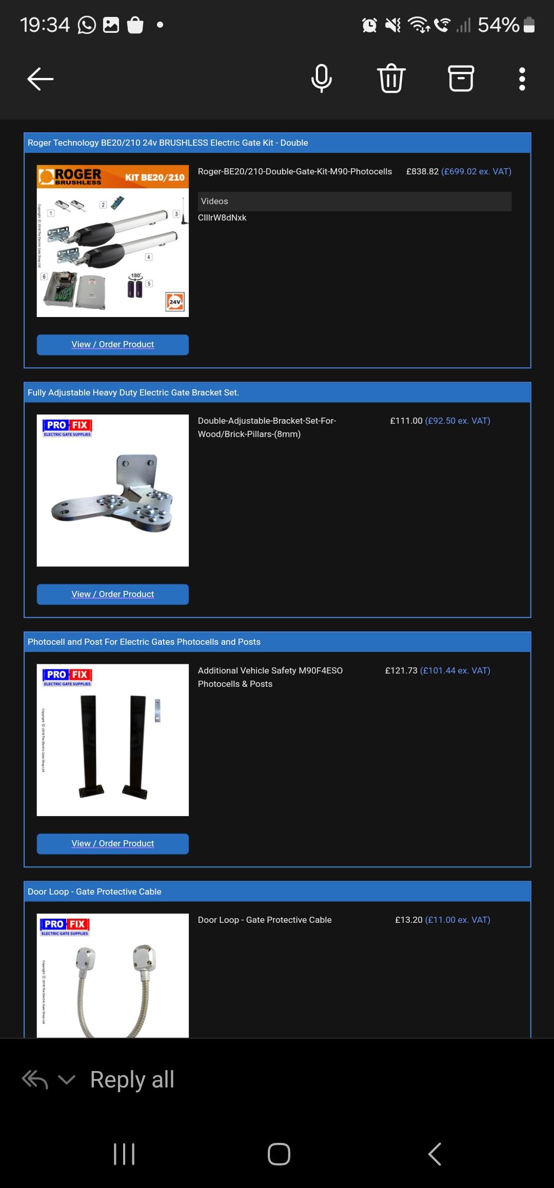

canalsiderenovation Posted Thursday at 14:06 Author Share Posted Thursday at 14:06 Me again . . . Almost 8 weeks and our gates are coming on Saturday after I had to raise a credit card dispute with Charles and Ivy for not providing the goods with Charles and Ivy to get our gates. After two weeks of non communication when I sent screen shots of the dispute and surprisingly less than an hour later I got a phone call to arrange delivery! I contacted this company @joe90 mentioned for a quote for automation and they haven't come back yet. Thr other option is to buy a kit online and get the builder to quote for fitting. I'm confused as to what we need. This company recommended the kit below but then other things (in blue) like photocells, door loops and safety edges and I'm not sure whether we need them or not! https://www.theelectricgateshop.co.uk/Roger-Technology-BE20-210-24v-BRUSHLESS-Electric-Gate-Kit-Double Another company recommended the 4ti which comes with blinker lights and photocells and the blurb also says we need gate stops too although we are on slight a slope into the drive so I'm not sure how effective they will be (not sure the stops are high enough). Do we need gate stops? I'm completely confused if we need all the extra stuff and if we need everything in these kits. Can anyone advise? Our total gate opening is 3900 and doors will open inwards. We have brick posts and the electric is all there ready for the gates. We are not having any intercom, video etc due to shocking Internet even on ethernet, wifi etc Link to comment Share on other sites More sharing options...
markc Posted Thursday at 14:15 Share Posted Thursday at 14:15 Photo cells on the outside are a good idea to prevent gates closing before you get out of the way. A gate stop in the centre gives the gates something positive to close against and reduces rattling and wind movement. sensing loops are not needed at home, they are to auto open gates when you approach from the inside. Crush sensors are used in public areas but I’ve never had them on my gates. a beacon is an easy fit even afterwards and I always use because it gives a positive signal gate is or should be moving … easier to see as you leave and especially at night. 1 Link to comment Share on other sites More sharing options...
canalsiderenovation Posted Thursday at 14:38 Author Share Posted Thursday at 14:38 19 minutes ago, markc said: Photo cells on the outside are a good idea to prevent gates closing before you get out of the way Thanks, silly question but do the gates automatically close? I thought you'd have to press the fob to open them and again to close them rather than the gates just determining when they should close? 21 minutes ago, markc said: A gate stop in the centre gives the gates something positive to close against and reduces rattling and wind movement. So it sounds like we need one in the centre then. Are the two gate stop posts necessary then? 22 minutes ago, markc said: a beacon is an easy fit even afterwards and I always use because it gives a positive signal gate is or should be moving … easier to see as you leave and especially at night. We have just had outdoor lights fitted on the brick gate posts and nearby garage so lighting isn't an issue to be honest. Link to comment Share on other sites More sharing options...
Mr Punter Posted Thursday at 14:49 Share Posted Thursday at 14:49 I would recommend FAAC for the automation kit. Most of the kit knows when there is an obstruction and will stop. I wouldn't get a builder to fit it unless they have done them before. Will you have a keypad and intercom as well? 1 1 Link to comment Share on other sites More sharing options...
markc Posted Thursday at 15:28 Share Posted Thursday at 15:28 You can set gates to auto close after a time, but even with ones you close with a remote etc. the photo cells are a good idea as it is easy to click close and then someone tries to get in before they close or you click to close and then something prevents you clearing the gate area, most closers sense an obstruction but the edge of a gate will make a mess of a car door before it opens again. gate stop posts are often placed just inside the posts but then they are easily hit as you turn in with a car etc. I much prefer a low centre stop (hinged so you can flip it down if very low ar needs to go out or in). 1 Link to comment Share on other sites More sharing options...

joe90 Posted Thursday at 18:05 Share Posted Thursday at 18:05 (edited) Yes to all above, I have photo cells to stop the gates hitting anything in their way when they close, I have a fob with a button to open and a button to close. Gate stops give the gates somewhere positive to close too (but don’t make them too high or you might catch a low exhaust). I don’t have a beacon (OTT in my opinion for a house) but I have wired in LEDs on both gateposts that come on in the dark as I have no street lighting and want the posts visible in the dark. i have also wired in a secret button so if family turn up when I am not here with a fob they can let themselves in. I keep one fob stuck to the dashboard and one in the house. Edited Thursday at 18:08 by joe90 1 Link to comment Share on other sites More sharing options...
saveasteading Posted Thursday at 18:35 Share Posted Thursday at 18:35 3 hours ago, canalsiderenovation said: do the gates automatically close you can have anything you want really. NB with sliding gates there have to be pressure stops in case a child sticks an arm through and gets crushed. I've tried to avoid this cost on the basis of them being non-automatic, ie supervised. but it seems that can't even be by fob, so needs a button at the gate to be pushed It doesn't apply to swinging gates. 1 Link to comment Share on other sites More sharing options...
Onoff Posted Friday at 05:51 Share Posted Friday at 05:51 11 hours ago, saveasteading said: It doesn't apply to swinging gates. "Pressure stops" as in rubber safety edges. The legislation applies to swing gates too. I think one of the unfortunate accidents was where a child leant through a closed swing gate to reach the button the other side. The attached sets it all out. documents8a.pdf 1 Link to comment Share on other sites More sharing options...

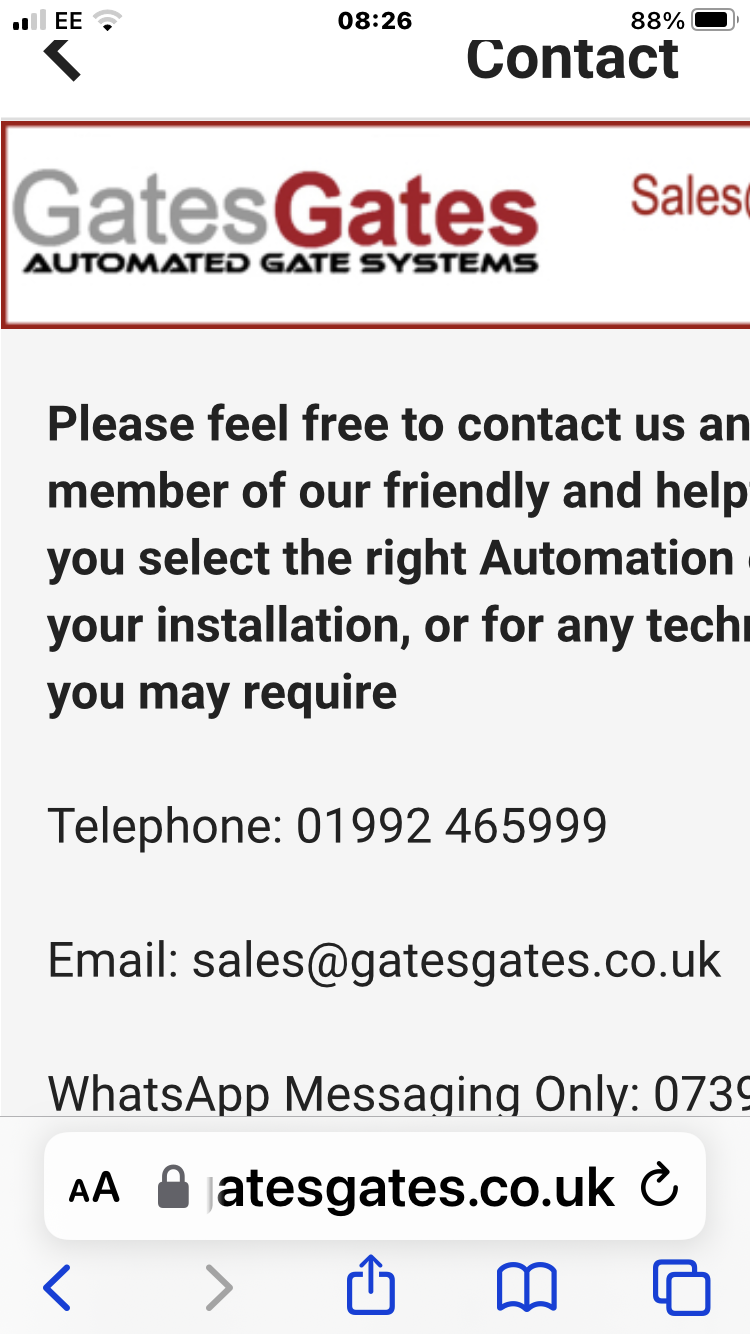

bassanclan Posted Friday at 22:24 Share Posted Friday at 22:24 In a similar situation looking at quotes etc. Parts looking like £1250-1500 of fully installed £5000. My cheapest quote so far is from GatesGates as recommended by @nod on another thread 1 Link to comment Share on other sites More sharing options...
nod Posted 17 hours ago Share Posted 17 hours ago Some our quotes where ridiculous With quite a few gate companies not wanting to get involved I couldn’t believe how simple the motors are to install Everything colour coded and numbered a digital fault display helps you out also Link to comment Share on other sites More sharing options...
canalsiderenovation Posted 17 hours ago Author Share Posted 17 hours ago 11 hours ago, Onoff said: Do you work in HR per chance? Nope prison service 🤣 have done HR qualifications though so I know the lingo 😏 Link to comment Share on other sites More sharing options...
canalsiderenovation Posted 17 hours ago Author Share Posted 17 hours ago (edited) 8 hours ago, bassanclan said: In a similar situation looking at quotes etc. Parts looking like £1250-1500 of fully installed £5000. My cheapest quote so far is from GatesGates as recommended by @nod on another thread Crikey that's more expensive (£5000) than the actual driveway gates and pedestrian gate.... was that for just getting the parts for automation and fitting them? The electrics is all there it's just getting the kit and getting them fitted. Edited 17 hours ago by canalsiderenovation Link to comment Share on other sites More sharing options...
canalsiderenovation Posted 17 hours ago Author Share Posted 17 hours ago @nod do you have the gates gates contact details. Google is coming up with a few suggestions. Link to comment Share on other sites More sharing options...
nod Posted 17 hours ago Share Posted 17 hours ago 6 minutes ago, canalsiderenovation said: @nod do you have the gates gates contact details. Google is coming up with a few suggestions. 1 Link to comment Share on other sites More sharing options...
