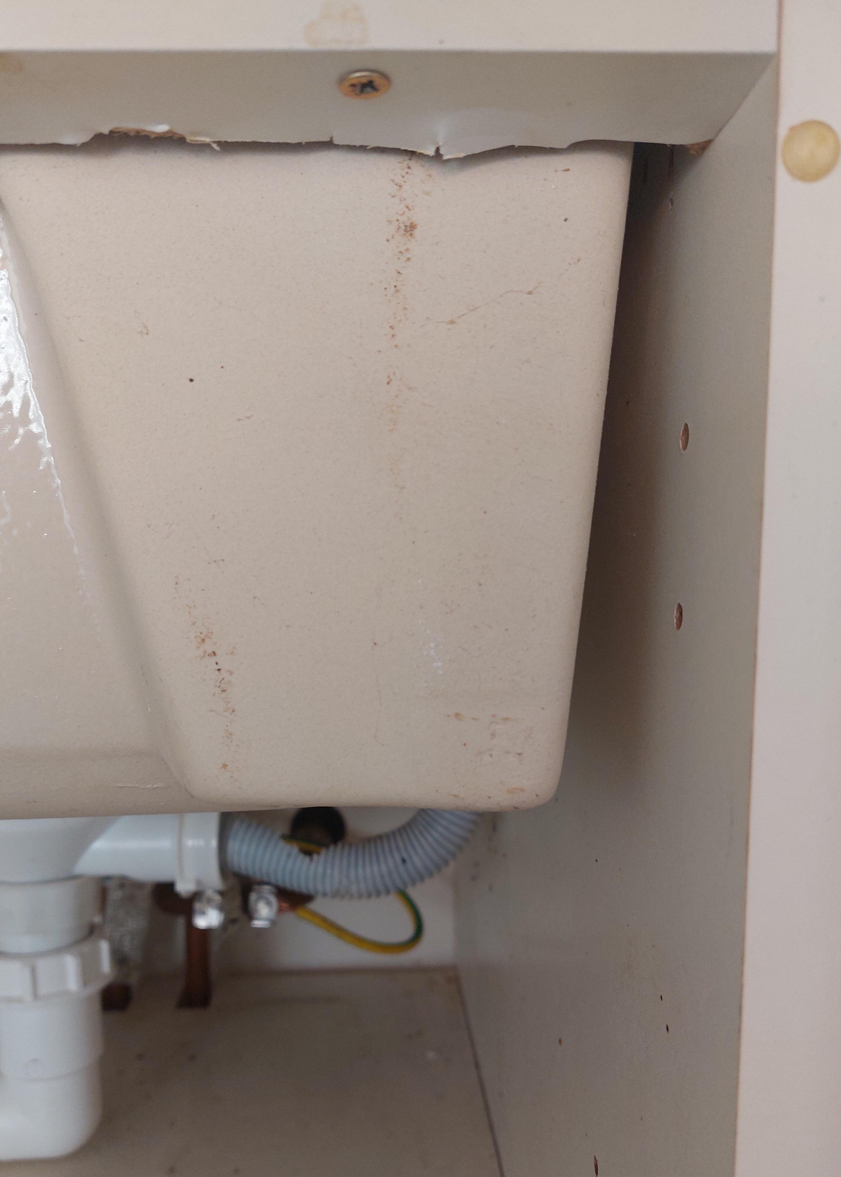

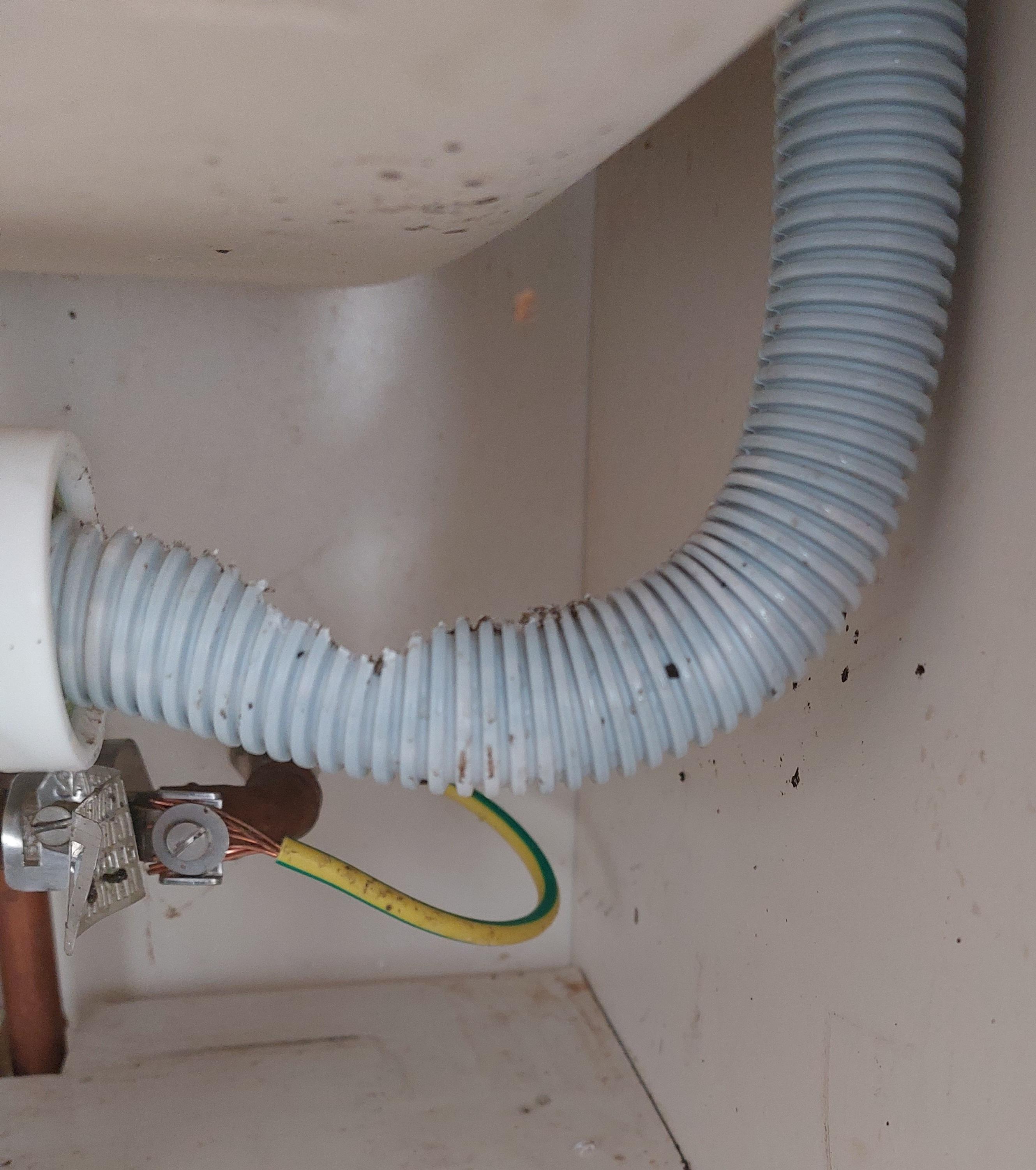

saveasteading Posted December 1, 2023 Posted December 1, 2023 The mice have been at this overflow. As an overflow it is never used, but a surge from the sink reaches here and the cupboard is soaked. I don't see that access is possible between the sink and unit, to change the pipe, even if it is a standard thing. What do you even call that pipe? A flexible drainpipe? Any suggestions please?
saveasteading Posted December 1, 2023 Author Posted December 1, 2023 3 minutes ago, Conor said: Duct tape?! I think I'd still need a basin under that.
Kelvin Posted December 1, 2023 Posted December 1, 2023 Could you cut the pipe and fit some plastic drainage pipe slid inside the flexible pipe and sealed. 1
joe90 Posted December 1, 2023 Posted December 1, 2023 Yes they are a nightmare (usually fitted to sink prior to installation, try this, I am sure you can make a joiner with one of these bits or similar https://www.ebay.co.uk/itm/186143700881?hash=item2b57077791:g:AkMAAOSwDblik 1
Russell griffiths Posted December 1, 2023 Posted December 1, 2023 Go and get a washing machine drain hose joiner, I believe they are more or less the same diameter, use the joiner as a splice. Or cut that and pull it around a bit and stuff it back in the trap. 2
saveasteading Posted December 1, 2023 Author Posted December 1, 2023 For now I have found an electrical conduit which pushed inside the existing. It's dripping into a jug, but not pouring, and I might bodge it with gunge and tape before the other ideas.
ProDave Posted December 1, 2023 Posted December 1, 2023 Once you have repaired it, wrap it in copper tape. That's what we did in the previous house to stop mice chewing the dishwasher hose. (new house is mouse proof) 1

joe90 Posted December 1, 2023 Posted December 1, 2023 (edited) 1 hour ago, saveasteading said: Or do they just chew anything to see what might be inside? Oh yes, even wiring in a classic car 😱( ask me how I know!). might this fit to join the pipe https://www.screwfix.com/p/flomasta-outlet-hose-connector-17mm/37103 Edited December 1, 2023 by joe90 1
