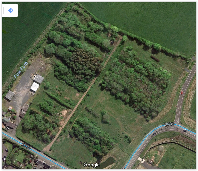

Simplysimon Posted September 15, 2017 Posted September 15, 2017 i had some trees, now i don't. a digger and a day = 50 cube of timber. everything to the left of the track apart from the brownish rectangle which is a stand of firs is gone apart from a few random trees. plots are called the hawthorns, bloody sharp thorns clearing up.
