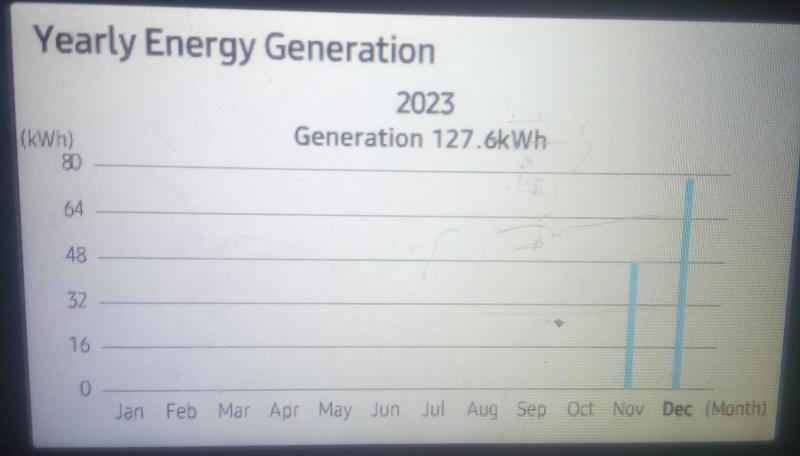

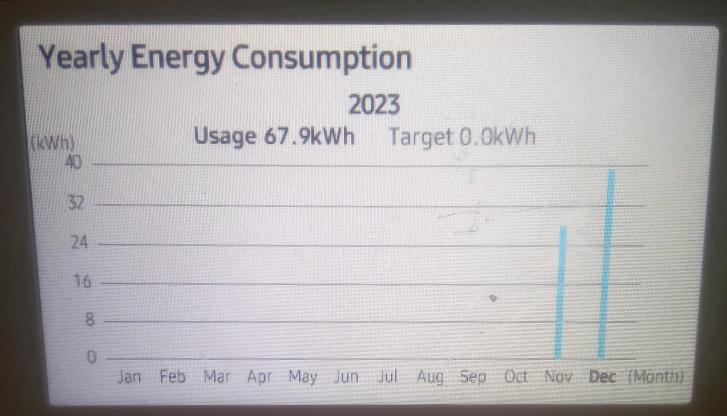

PhilT Posted December 8, 2023 Share Posted December 8, 2023 (edited) 1 hour ago, SuperJohnG said: Out of curiosity how is everyone getting accurate CoP figures? Manufacturer's own software is pretty good. I have found input to be spot on based on verifying against meter readings. Not sure if it's possible to get any better than a calibrated software estimate for output, but mine looks reasonable compared to expectations (heat loss calcs etc.) Edited December 8, 2023 by PhilT Link to comment Share on other sites More sharing options...

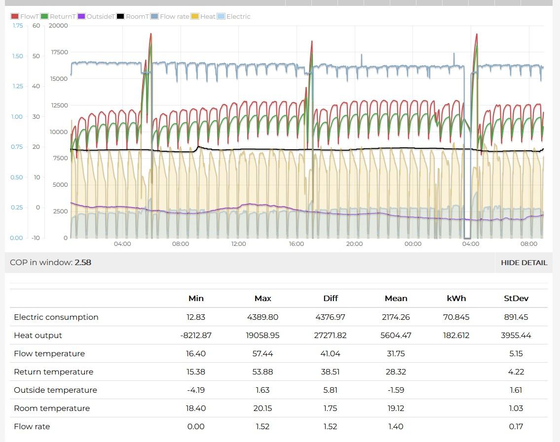

billt Posted December 9, 2023 Share Posted December 9, 2023 14 hours ago, SuperJohnG said: Out of curiosity how is everyone getting accurate CoP figures? I'm using the Open Energy Monitor heat pump monitor. https://shop.openenergymonitor.com/level-3-heat-pump-monitoring-bundle-emonhp/ The full kit is expensive, but I like to know what's going on and I'm not too sure that the readings given by the heat pump are accurate. It is very helpful when setting the system up. If you want to look at other systems there are quite a few online at https://heatpumpmonitor.org/ 1 Link to comment Share on other sites More sharing options...

SuperJohnG Posted December 12, 2023 Share Posted December 12, 2023 On 08/12/2023 at 21:47, PhilT said: Manufacturer's own software is pretty good. The Vaillant Arotherm unit doesn't give you the COP? it only provides info on energy yield as a total, then it gives power consumption for heating and DHW, but you can only figure out an overall COP not individual. My COP was 2.74 last month. 1386kWh yield, 505 kWh power consumed. Seems like the COP isn't great. The WC I haven't messed with (largely as I don't know how) but it's fairly simple with no buffer, ASHP straight to the UFH which is a single zone. Link to comment Share on other sites More sharing options...
