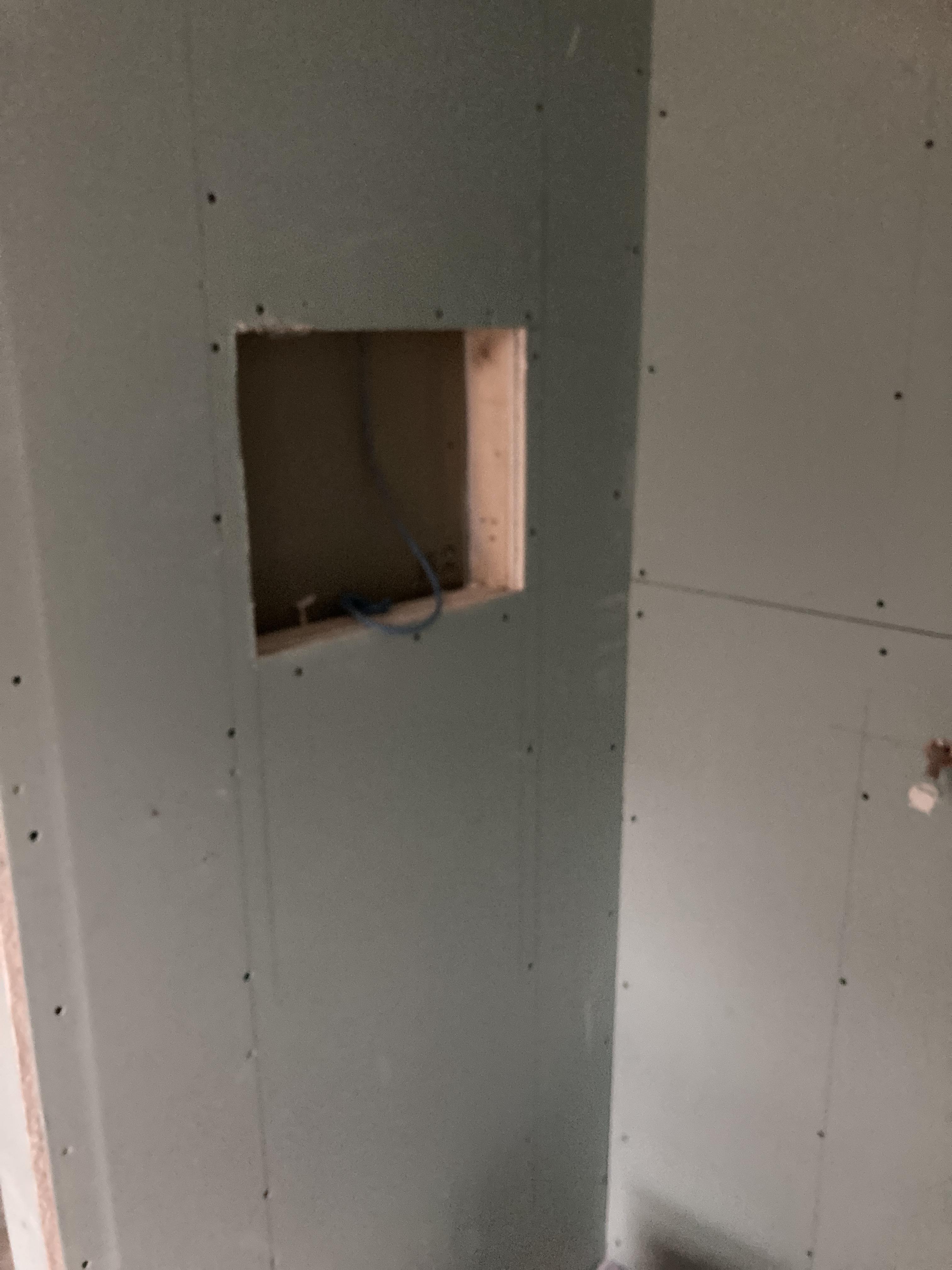

Hi, I am looking to fit a wall niche into a shower for shampoo etc.  I like the idea of the ready made niche lining kits that you tile over. Anyone used one before and can recommend what to go for?  I have never fitted one before so I am a bit clueless.
The recess part isn't a problem as I know there is a hole in the wall that has been previously tiled over at that location - I just need to chop it out and line it with something before tiling.
Posted
Is that a normal depth stud wall or have you doubled up so it’s still stud behind shelf back. Often wondered how tough it is at this point I wouldn’t want anyone punching a hole through.
Posted
Yes 70 mil
Plenty deep enough for a shampoo bottle

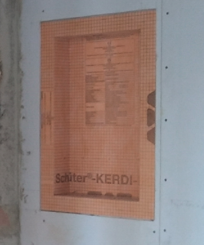

Mine is going into a solid wall.  The bathroom was converted from an old cupboard many years ago.  The cupboard had an internal window to bring in light from the hallway, so I am going to use this blocked off window to create part of the niche to save having to chop into the wall. I will just have to put noggins into two edges of the cavity.  So has anyone used a moulded tray to line the niche and if so which one and how was it?
Cheers
Posted
This one - this is as far as it's got, but no problems so far.
  • Like 2

Posted
Thanks. Is that a flanged one or flush? I can't tell and I am not sure which to get. I think I want flush as its a solid wall.

Posted
It has a 13mm flange that's been recessed to sit flush with the surface of the plasterboard. The tanking system will then run over the flange to make it watertight. In a solid wall you could chip back the plaster to recess it similarly, or you could form the tanking into the recess as long as it's properly lapped all round.
In the past I've just created a recess, then rendered / boarded and tiled it. This time it will be sitting below a rain shower getting very wet, so needs to be full water proof and I chose pre-formed for ease.
BTW, slope the tiles a little to avoid water pooling at the back.

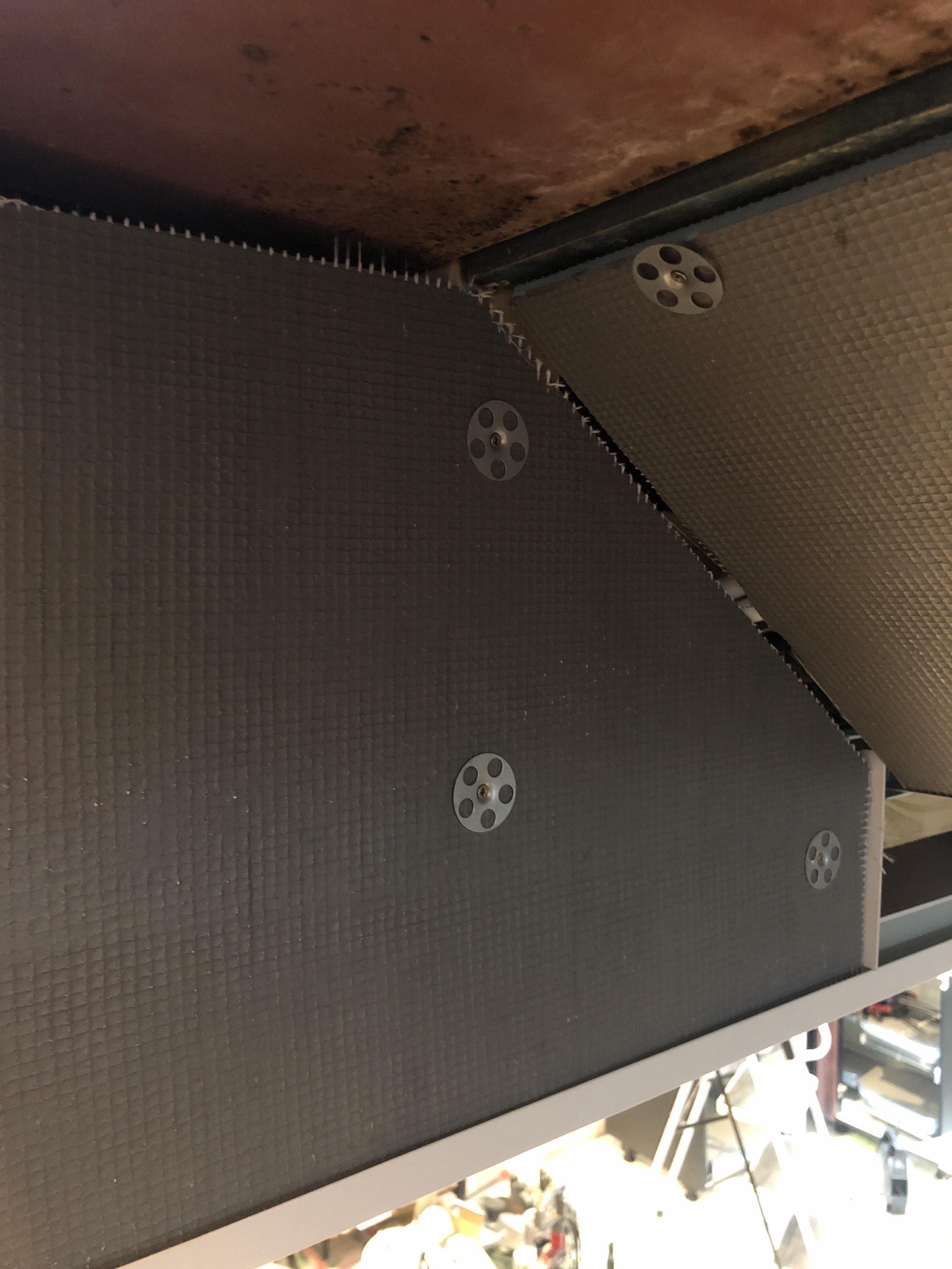

It’s funny all BM’s recommend hardi board . I went with this ditra type board . Light weight and easy to cut . Of course you’ll need noggins for bathroom fixings . Tile adhesive sticks to this board like sh*t . In the shower used their ‘tape’ , glue and paint on joints .
p.s obviously not my shower cubicle ! The boards dead useful for other things
