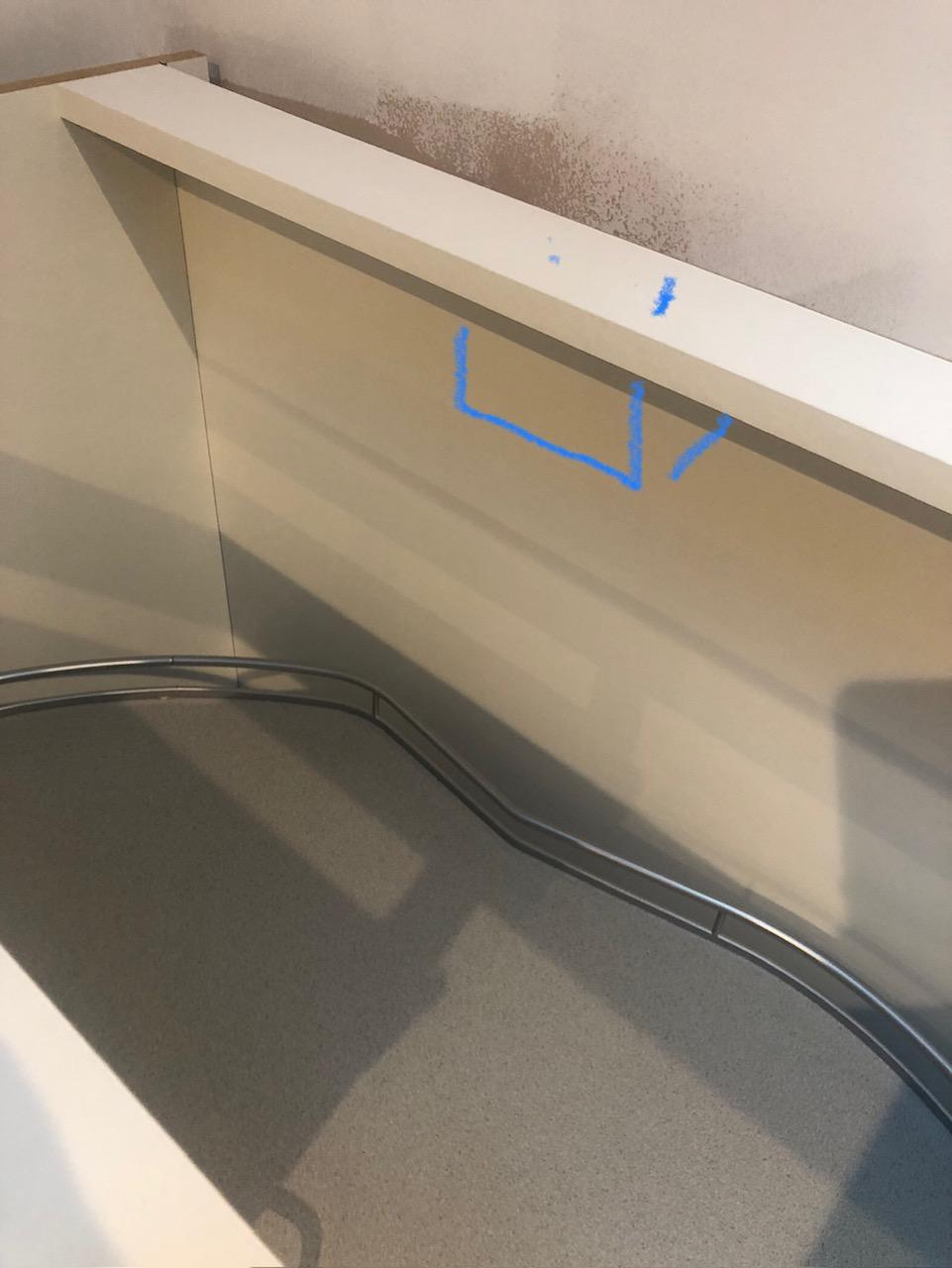

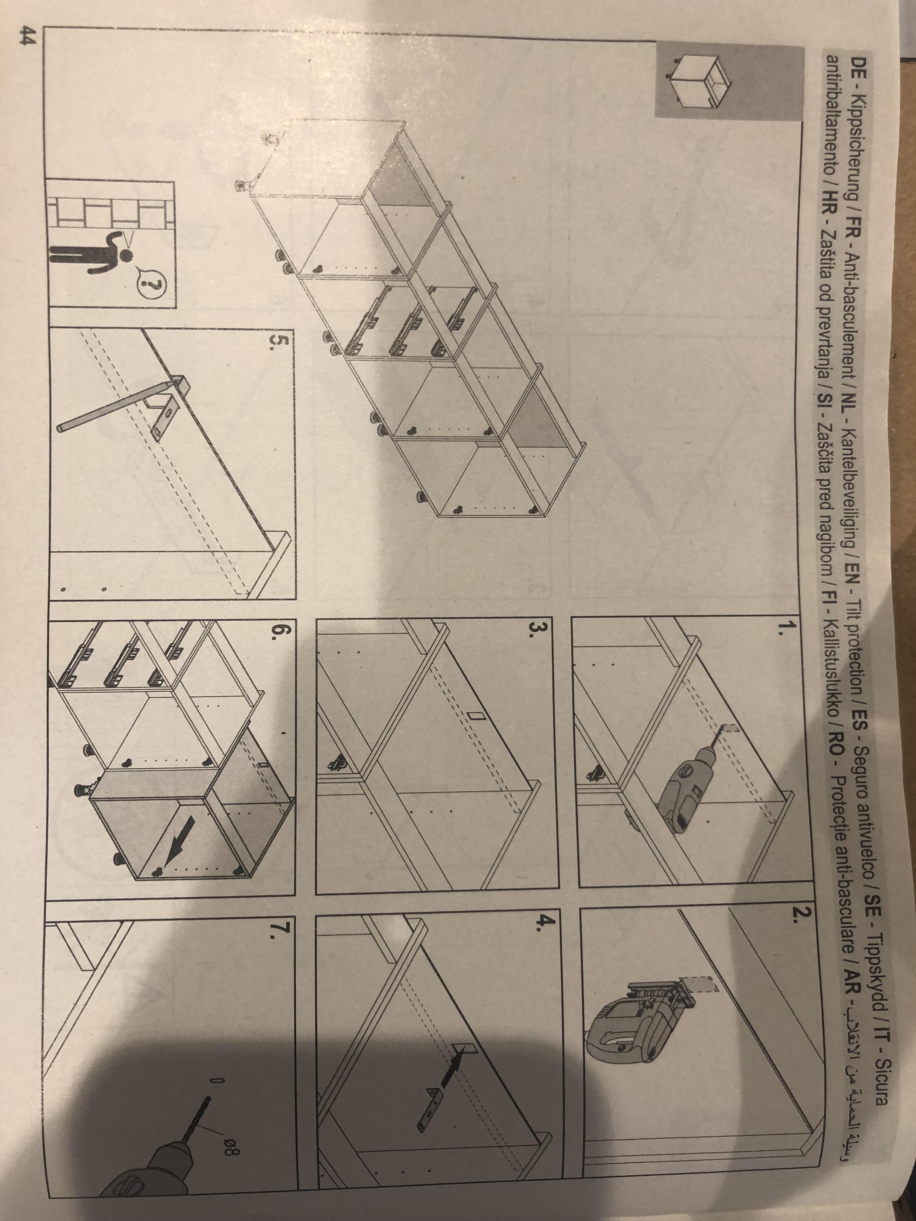

Pocster Posted November 13, 2023 Posted November 13, 2023 Instructions suggest cutting a hole in the ‘cardboard’ back and inserting a L bracket . Seems a bit crap too me . Really want to screw the unit through the back direct to wall . But as back is cardboard - no good . How do I fix this rock solid to the wall ? . This is a corner unit so obviously could fit if the adjacent wall - but what about a row of floor units ??

MikeGrahamT21 Posted November 13, 2023 Posted November 13, 2023 12 minutes ago, Pocster said: Yeah I know . But I’m happier if all bolted to the wall . How about a modesty block into the top strut, and then a long screw or 2 (depending which way you install it) into the wall?

Pocster Posted November 13, 2023 Author Posted November 13, 2023 9 minutes ago, MikeGrahamT21 said: How about a modesty block into the top strut, and then a long screw or 2 (depending which way you install it) into the wall? You mean?

MikeGrahamT21 Posted November 13, 2023 Posted November 13, 2023 (edited) 52 minutes ago, Pocster said: You mean? Yeah on that piece. You could also use the CLS Timber idea, and make a huge modesty block, running full length of unit, screwed to the cross member (or even better, down through the cross member) and then all the way through into the wall with bolts. Unit would still be the weakest component, but you'd have a good job breaking it Edited November 13, 2023 by MikeGrahamT21 1
Pocster Posted November 13, 2023 Author Posted November 13, 2023 11 minutes ago, MikeGrahamT21 said: Yeah on that piece. You could also use the CLS Timber idea, and make a huge modesty block, running full length of unit, screwed to the cross member (or even better, down through the cross member) and then all the way through into the wall with bolts. Unit would still be the weakest component, but you'd have a good job breaking it I could indeed - that’s a good plan . I did forget to mention it’s a studded wall - so naturally I want to fix to that not pb .

ProDave Posted November 13, 2023 Posted November 13, 2023 29 minutes ago, Pocster said: Guys , problem isn’t fitting to the wall - problem is a decent fitting off the unit . Screw the discussed L shaped bracket to the wall into each stud, and then down through the L shaped bracket into that cross bar at the top of the unit. What is so difficult?
crispy_wafer Posted November 13, 2023 Posted November 13, 2023 (edited) screw short side of the bracket to the wall 1st then push cabinet back to wall screw long side of bracket into side of cabinet using an angled driver, Edited November 13, 2023 by crispy_wafer 1
Pocster Posted November 13, 2023 Author Posted November 13, 2023 24 minutes ago, ProDave said: Screw the discussed L shaped bracket to the wall into each stud, and then down through the L shaped bracket into that cross bar at the top of the unit. What is so difficult? Nothing . You were just going on about ‘ proper ‘ way of noggins which suggests fixing to the wall is an issue - which it isn’t . My post was for clarification…
Russell griffiths Posted November 13, 2023 Posted November 13, 2023 Screw through that bloody great brace at the back of the cupboard, not the cardboard shite. Fook me do I need to come and do it for you. 🤦🏻♂️🤦🏻♂️ 1
