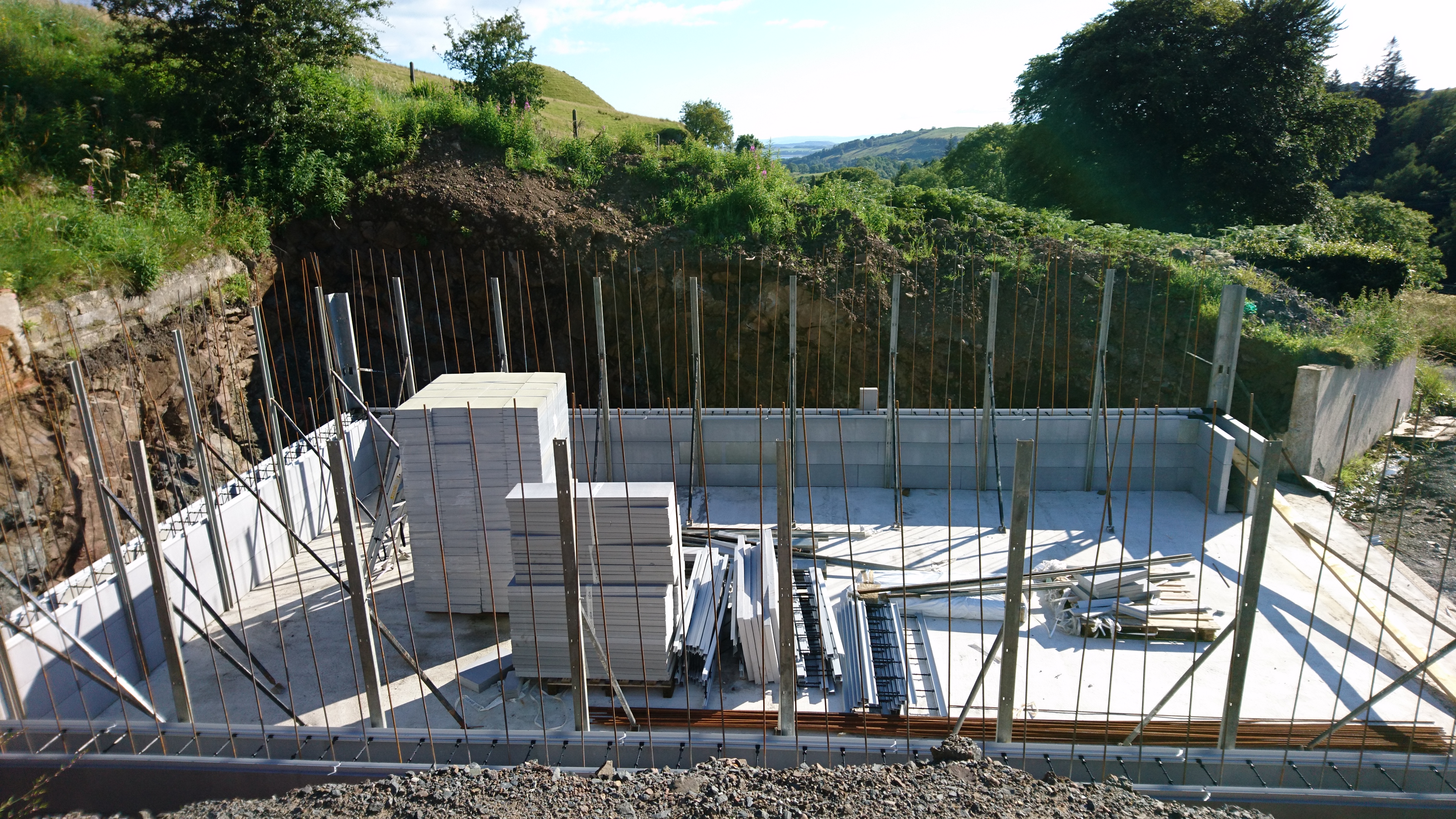

I did the Nudura 1 day course and wanted to build with it.  At that time the SE prelim drawings specced 200mm thick walls with modest rebar content.
....but things escalate and I end up with wall thicknesses ranging between 225 & 350mm plus a maze of steel.
Nudura do vibrate, Polarwall seemingly not.  I struggle to understand how the icf companies determine those differing approaches, particularly where waterproof additive is involved....Sika for example will turn up unannounced to check a pour and would likely not issue their guarantee on wp concrete if it wasn't properly vibrated.
Anyway, my point is that it's another complexity to choosing icf....can the final specced design accommodate (i.e. literally fit) a poker.
If concrete needs vibrating, you don't want to not have the process achieve its purpose.

4 hours ago, Triassic said:
Is there a specification for vibration? How much is too much?
No idea but this is where the expertise of the crew is key - our guys vibrated a lot, both dropping the poker into the mix and running it up and down the formwork, especially internal corners  - we had window formers for light wells and these needed extra attention to make sure the concrete flowed around them well and didn't leave any air pockets.
When the formwork was struck, you could see the quality of the pour - virtually no 'marshmallow/popcorn' effect anywhere on the internal or external faces.
For me one of the few downsides of ICF is not being able to see the resultant quality of the pour.
They also had two pokers on the go, both to speed things up but also for redundancy in case one failed.

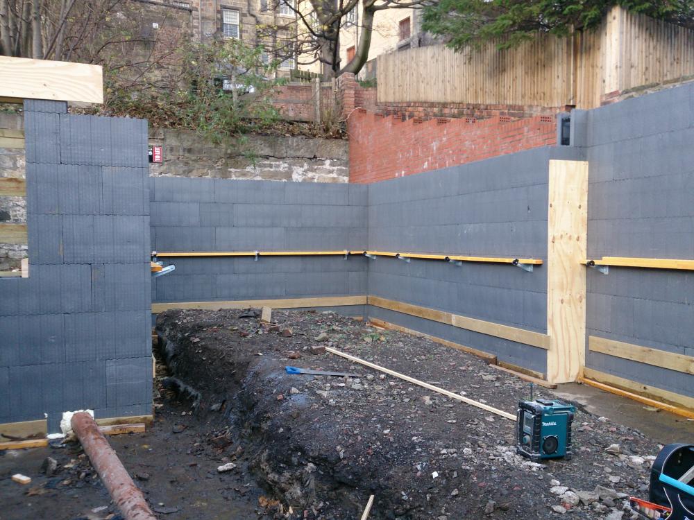

Precisely this...ok out of the ground maybe but in a basement situated such that there's 1 chance only, i got scared off icf.  Gutted about it, would have loved to build with it instead of handing over such a large part of my build to a specialist...spoilt some of the dream.
Look into how you'll get a waterproof guarantee on icf basement, that's actually a guarantee worth having, without installing a cavity drain inside (my quotes for this alone were circa £25k)

As far as I understand it up until a few years ago the concrete alone might have been deemed waterproof enough......but then damp leaky basements were the norm too.
its all a risk tolerance thing really.
If you were to need to fix ICF how would you even trace the point to fix?  Your fix could end up being a cavity drain (possibly same with most systems....blocks, rc, whatever).
Not needing a guarantee is a big help......so long as you really don't.

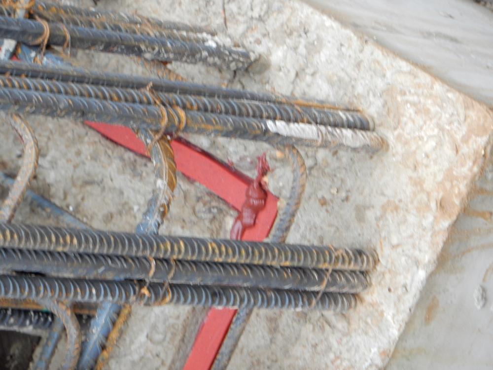

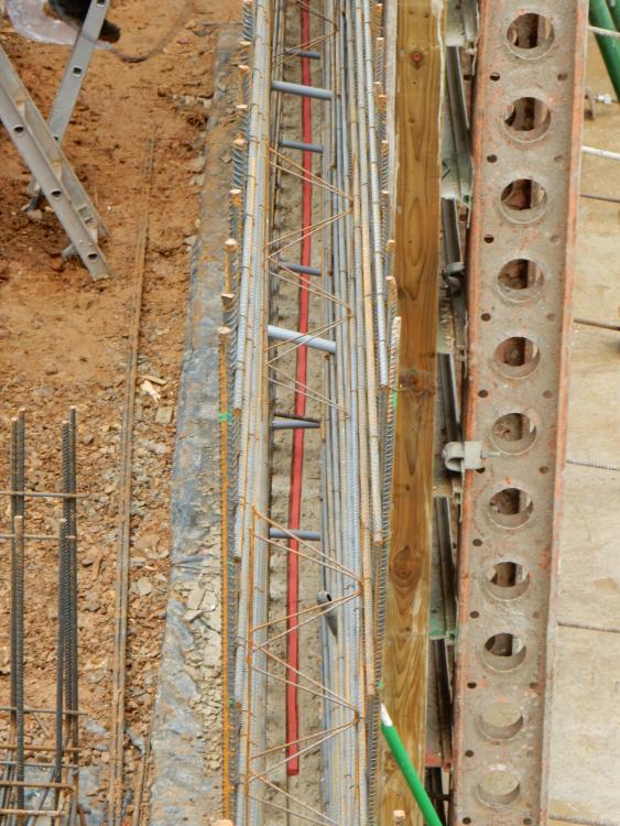

On 13/09/2017 at 21:33, najem-icf said:
I'm afraid I would have to disagree with your comment "it's the joins between blocks where you'd have issues" - almost all ICF blocks available in the UK are installed break-bond - meaning the joins are held together very comfortably.  I have installed a few photos to demonstrate this.  At most you will get water seepage but concrete pours will not cause any issues. Where you have vertical stack joints (ie a vertical line of joins) you would ply this up as shown on the photo (right hand side) using the grey block - this will keep everything together during the pour.
While the ICF itself will not allow moisture to travel through it, we still have to comply with BS8102.
BS 8102 defines 3 ways of water-resistant construction:
   A Barrier (Membrane) protection
   B Structurally integral protection
   C Drained protection
Two are recommended at minimum - three is best case if possible.  We normally use the A and B to comply.
The remainder of your post is absolutely bang on the money.  Just one small thing to note - I always recommend the use of a waterstop at the junction where the wall meets the foundation/slab.  The best products I have seen for this are from Kryton.  Waterproof concrete that is ordered from the plant are guaranteed so long as no water is added on site - leaks will become apparent very quickly after the concrete has cured.  We have not had any issues with water ingress in ICF so long as a waterstop is used.
This is my first post here - apologies if I have not followed etiquette - we all gotta start somewhere :)
No problem, I'm no ICF expert so my joins comment was just a supposition.
Waterproofing strategy does depends on the local conditions, we were ok to use B only.
Our slab was poured with a 100mm kicker for the walls and the waterstop strip was laid on top on this (a groove was precast to receive it) - thats what you can see in the second picture above.
Our whole concrete & water stop system was from Sika and came with a warranty with regular inspections. They even provided an expanding rubber washer to plug the holes through the formwork where the rods holding either side of the formwork ran.

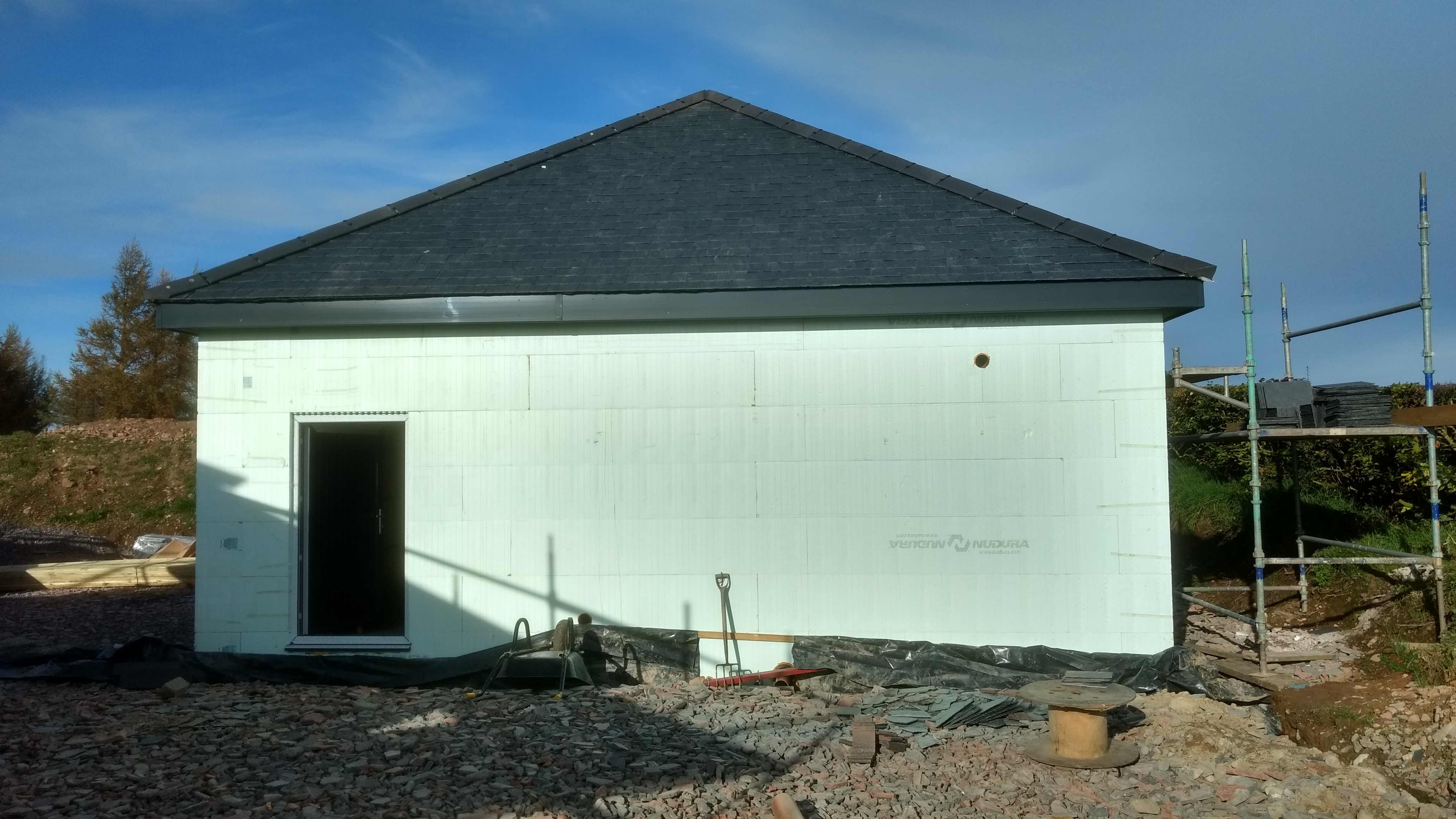

21 minutes ago, Triassic said:
Well the ICF quotes are in and the  Amvic 330(200 core) ICF system is looking the like the front runner at this stage. Has anyone got an xperience of the system they'd like to share, things like customer support, ease of use, problems etc.
Well, since you ask, and you appear to live not so far from us,  you are most welcome to come and see my installation. PM me @Triassic: we're around all the time.
Ian
