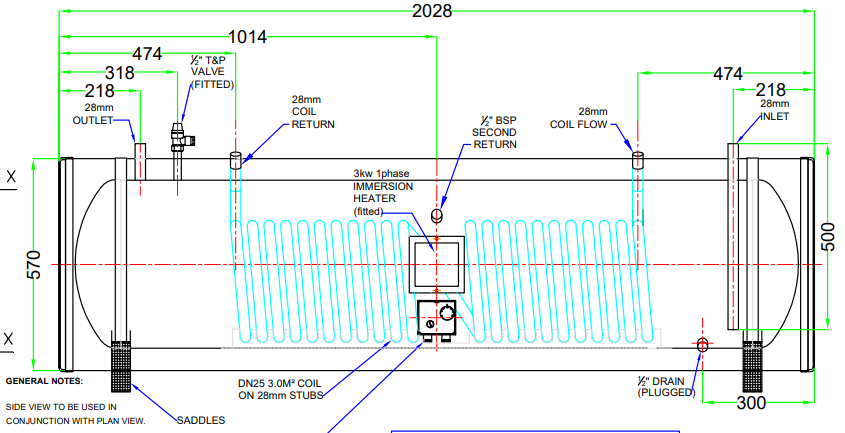

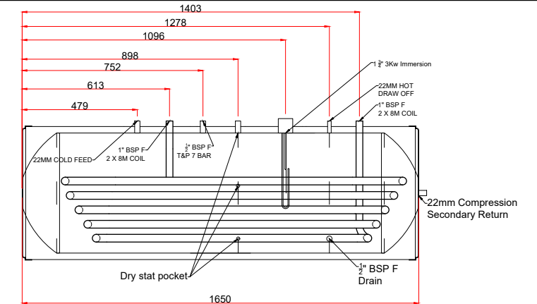

Horizontal cylinder or Sunamp?
Alexx
I've been quietly reading lots of topics here about Sunamp as I was considering it an alternative for energy storage in my loft eaves. I should be able to get a horizontal cylinder to fit, just checking this at the moment with a mock up cardboard.
The idea of Sunamp is great, but it seems the execution is poor. From what I can see it seems a bit of a beta/alpha product released to the masses with a "network" of installers and with little end user support when things go wrong. I can't find much on youtube about people showing their own installations, which leads me to believe no one does it.
So back to my original plan, I can get a 300L tank in the loft, but everyone says for a heat pump, that is a no go. From what I can see, I just need a cylinder with a large coil made specific for a low temperature system, and perhaps a de-stratification pump. yeah, 300L horizontal won't be the same as a 300L vertical, but I have no other option.
Any thoughts? Should I avoid Sunamp like a plague?

Horizontal cylinder should be okay, at least you are lifting it up into the loft empty.
A sun amp weighs a LOT.  Best of luck lifting that into aloft and making the loft string enough.  I have heard of people struggling to get one up an ordinary staircase, let alone somehow up into a loft.

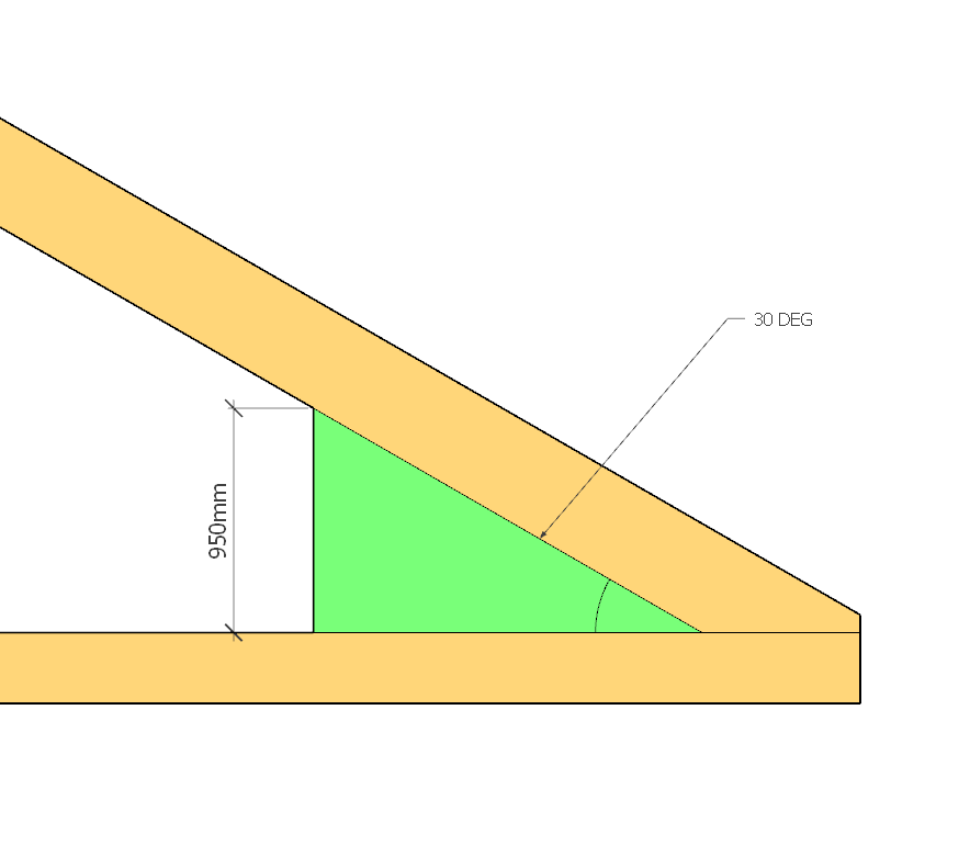

Slope starting from 95cm from floorboard, then going down at around 30 degrees, I'll take some pictures and post here once I do the cardboard mock p. It will just fit a horizontal, it would not fit any type of vertical. My idea is to store at 55c max or just go to that temp from time to time to kill legionella, 300+ litres, de-strat pump, the largest coil possible, the small feet possible to keep the cylinder in place without increasing the height.

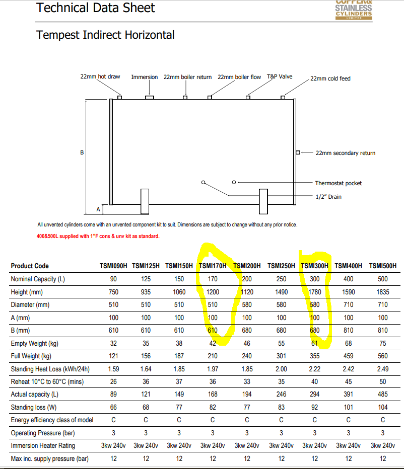

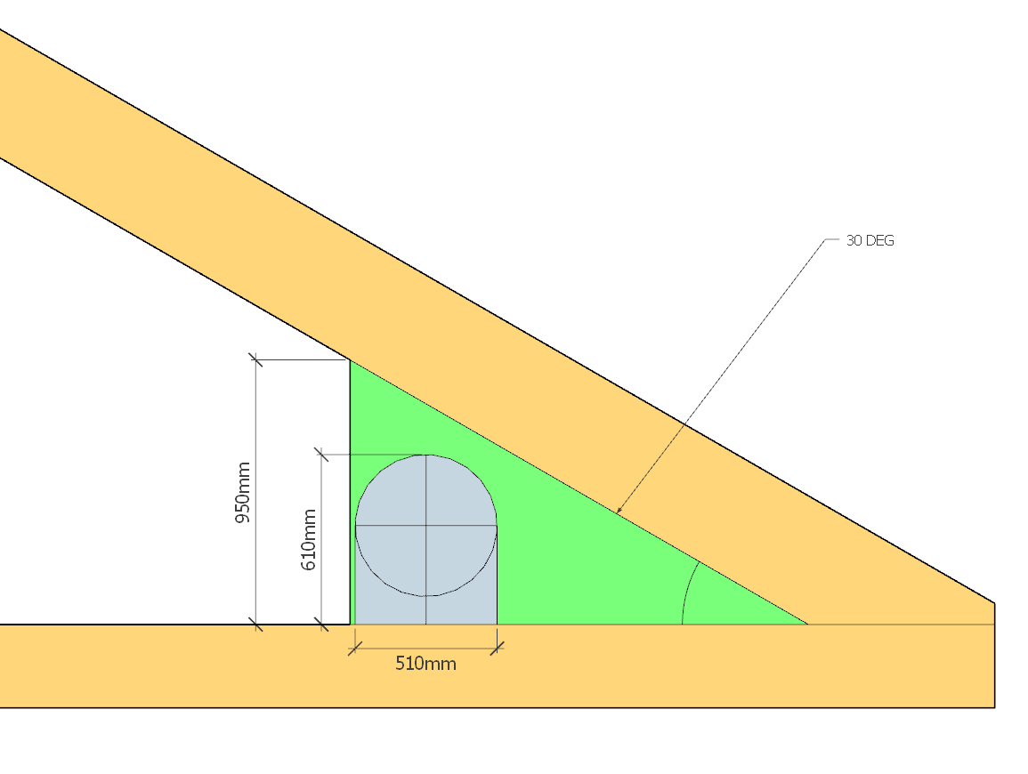

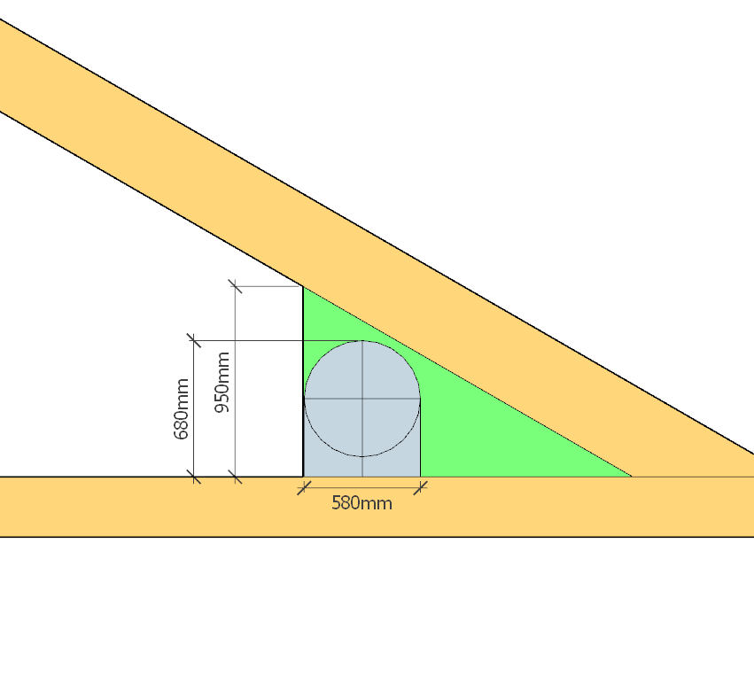

Is this green area what you mean by 95cm sloping away at 30 deg?
Looking at the tempest website then their 300l Heat pump horizontal cylinder should fit just about. There won't be much to spare if you need to stay inside your 950mm line for fittings however.
The 170l would be better size wise but you may need a pair of them
I'm sure all cylinder manufacturers can alter the position of ports as necessary anyway.
I've been checking several models, they can customise the cylinder a bit and get the immersion heater on the side of the body, or even the dome. The rafters are 27.5 degrees.

So I've got some additional technical details so far:
Telford:
Fabdec
The guys from Joule so far have been useless, not technical details, all calls I make always end up speaking to someone that has zero knowledge. I get promised the "email" that never comes with all technical details for 3 days already, after 5 phone calls.
I'm leaning to Telford so far as the standard horizontal heat pump cylinder is around £820 + VAT, I'm just waiting to confirm the cost to get the immersion heater on the side instead. Fabdec coil design does not seem that large to me, but I could be wrong. I just wish the coil could go further to each end of the cylinder.
Joule gave me a cost of £2800+ but I found it for around £1800, but still without any tech details, I can't consider it.
I'm now waiting for a few others like UKCylinders, World Heat cylinders, newawk and macdonald, then hopefully I can make a decision and buy it.
