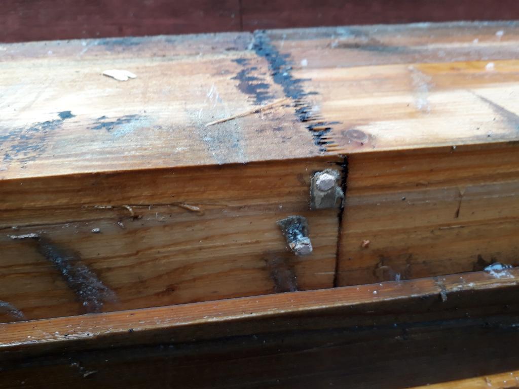

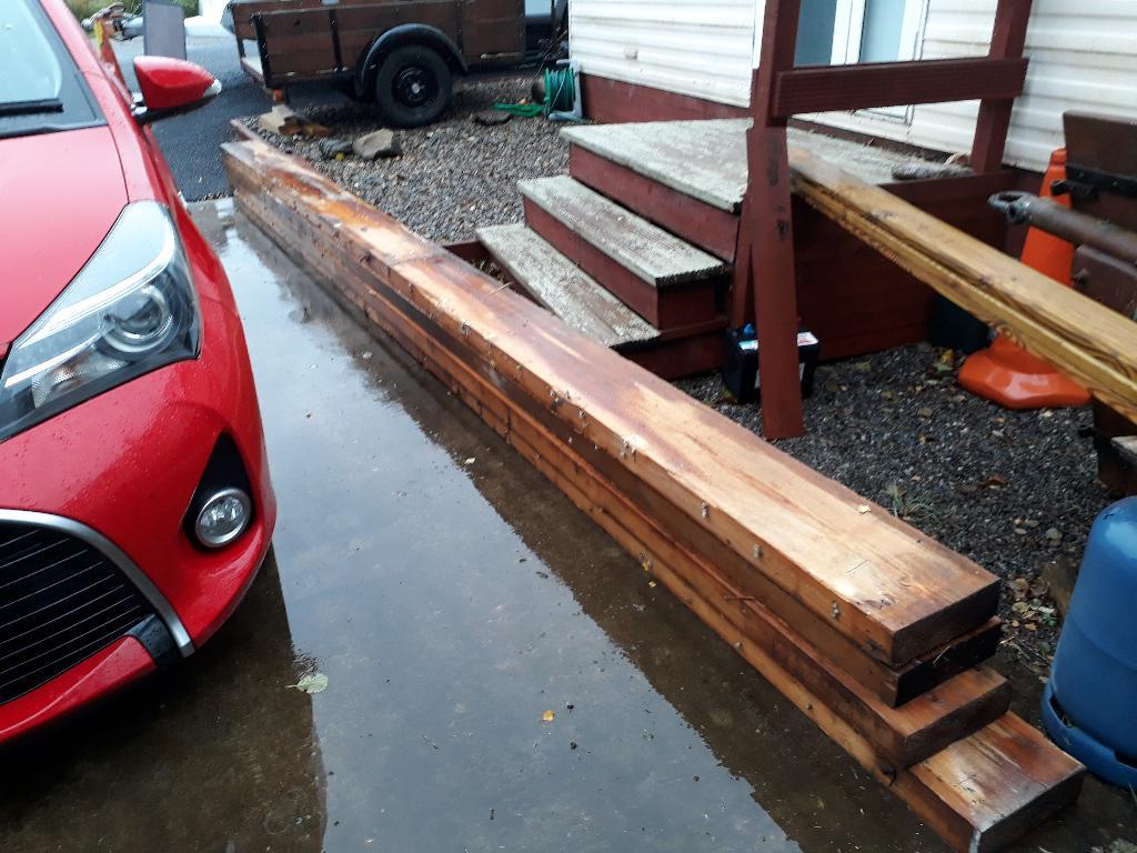

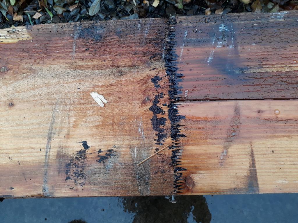

ProDave Posted October 7, 2023 Share Posted October 7, 2023 I got these from my neighbour, who in turn got them from an office unit they dismantled. They were spanning the ceiling in that. 10" by 3" timber joists 6 metres long. Quite old, but were used indoors and dry (until removed) Each has a scarf (I think that is the name) joint at about mid point. No markings found yet so say any grading. 7 I would like to use them for my car port that I would like to have a 6 metre span. That's why these 6 metre joists caught my attention. The car port will be 6 metres square, roofed in box profile steel sheet. I want to keep the span open, the side joining the garage can have as much support from the garage as it needs. the opposite side can have multiple support posts as can the back. Initial thinking is to use these 4 big joists to span side to side, which would put them at 1.5 metre centres, and then span front to back with something smaller. Thoughts please? Particularly about those joints, would I be wise bridging those with something like a steel plate bolted on? Link to comment Share on other sites More sharing options...

saveasteading Posted October 7, 2023 Share Posted October 7, 2023 My thoughts. These precision scarf joints are amazing. But I don't know that they are ever used structurally. I've smashed some up and they failed elsewhere than the joints, but that's not proof of being strong as joists. If there is no need for proof, and it isn't an inhabited space, then I agree to add some extra splicing. Steel plates will look deliberate but will cost about £30 each. Nail plates will do but may look crummy. Plywood will do too, but should be longer. Lots of nails. Link to comment Share on other sites More sharing options...
SteamyTea Posted October 7, 2023 Share Posted October 7, 2023 Finger joints, which those are, are used structurally. They won't fail in normal usage. Link to comment Share on other sites More sharing options...

SteamyTea Posted October 7, 2023 Share Posted October 7, 2023 43 minutes ago, ProDave said: worry about their integrity when wet Finger joints are usually bonded with an adhesive. The 'fingers' are used to massively increase the contact surface area. The angle allows for self locking of the joint. Link to comment Share on other sites More sharing options...
TonyT Posted October 7, 2023 Share Posted October 7, 2023 Leave to dry and sit them on breeze block at either end to check the defelction Link to comment Share on other sites More sharing options...
joe90 Posted October 7, 2023 Share Posted October 7, 2023 I think that’s a finger joint not a scarf joint, not sure of its integrity structurally, really depends on the glue used I guess. The SE in me says put it on blocks either end and jump up and down on it in the middle 🤣 Link to comment Share on other sites More sharing options...
markc Posted October 7, 2023 Share Posted October 7, 2023 The joint will be stronger than the timber, look at any trussed rafter, glulam beam or other structural timber and you will see the joints. In the mill knots are cut out leaving timber lengths from 500mm (ish) that are then jointed and run together to make a continuous piece that is then cut to the pack lengths for shipping Link to comment Share on other sites More sharing options...

saveasteading Posted October 7, 2023 Share Posted October 7, 2023 I'm interested, having never seen this advertised other than as furniture. Youd think it would be commonplace to reduce waste. Can't see anything definitive yet. This one thing contra. Finger-jointed lumber and timber can be fabricated to have 75% of the strength of clear wood Link to comment Share on other sites More sharing options...
SteamyTea Posted October 8, 2023 Share Posted October 8, 2023 (edited) 7 hours ago, saveasteading said: Finger-jointed lumber and timber can be fabricated to have 75% of the strength of clear wood As SEs over engineer for safety, it is probably well within tolerances. Below is a scarf joint. It works on the same principle of increasing the contact surface area as finger joints. Edited October 8, 2023 by SteamyTea Link to comment Share on other sites More sharing options...
saveasteading Posted October 8, 2023 Share Posted October 8, 2023 2 hours ago, SteamyTea said: Below is a scarf joint. Positioned over a prop, to avoid a joint in mid span. Interesting cracks. 2 hours ago, SteamyTea said: As SEs over engineer for safety Engineers design with safety factors. That isn't over-engineering. But my original point stands. For use in an ancillary building, these jointed beams are OK, but splicing wouldn't be a bad idea. If the 75% is anything like accurate, it is easy enough to consider them spanning 20% shorter than for the equivalent natural C16. Link to comment Share on other sites More sharing options...
