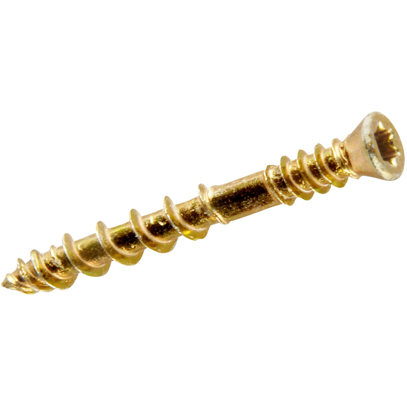

osprey Posted October 5, 2023 Author Share Posted October 5, 2023 Thanks all for replies. When people are saying 'glue' with chipboard, is that for just the t&g? I have read of people gluing the sheets to the joists as well... Those using OSB: I can only find 18mm t&g. Did you use t&g? I would have to add 4mm to the joists I guess. Any DISadbpvantage to using OSB? Chipboard seems to be the 'standard' even for (cheaper) newbuilds. What screws do people use? There are special ones for flooring chipboard, with a smooth part at the top, 'to make boards be pulled to the joists firmly'. Other people say fully threaded. Other suggestions: I don't have access from below. Interesting idea about punching nails down. Will think about it. Link to comment Share on other sites More sharing options...

SteamyTea Posted October 7, 2023 Share Posted October 7, 2023 Get the right type of screws. Link to comment Share on other sites More sharing options...
osprey Posted October 8, 2023 Author Share Posted October 8, 2023 (edited) I have seen that type of screw advertised, but I have not heard if they work. I have seen the theory that a screw with a smooth section above the thread helps in pulling the sheet to the joist firmly. I am not sure how the top thread in that screw works. Edited October 8, 2023 by osprey Link to comment Share on other sites More sharing options...
SteamyTea Posted October 8, 2023 Share Posted October 8, 2023 15 minutes ago, osprey said: am not sure how the top thread in that screw works The top thread stops the floor board/sheet moving, while the lower thread locates it on the joist. If there is a gap, the board/sheet cannot move downward. The 'squeaky board' sound is rubbing on the screw/nail shaft, not wood on wood, usually. You can get a similar effect using bolts, rather than screws. Just need to drill a clearance hole and make sure the heads are larger diameter so that they don't pull through. 1 Link to comment Share on other sites More sharing options...
Onoff Posted October 8, 2023 Share Posted October 8, 2023 2 hours ago, osprey said: I have seen that type of screw advertised, but I have not heard if they work. I have seen the theory that a screw with a smooth section above the thread helps in pulling the sheet to the joist firmly. I am not sure how the top thread in that screw works. Yes they work. I used Spax floorboard screws. They're excellent. 22mm chipboard floor. As solid as, no squeaks. https://www.screwfix.com/p/spax-tx-countersunk-self-drilling-flooring-screw-4-5mm-x-60mm-300-pack/88716? 1 Link to comment Share on other sites More sharing options...
osprey Posted October 20, 2023 Author Share Posted October 20, 2023 (edited) Thanks, intereting they work, but I am not sure how. The e.g. Spax screws have two different threads. I assume the lower, coarse one bites into the joist first. The screw then goes into the joist until the fine thread reaches the chipboard. The next couple of turns of the coarse thread would be sufficient to pull the board in tight, but the fine thread would be 'travelling' more slowly (taking maybe four turns to travel the same distance). Would it not just rip its way through the chipboard? Edited October 20, 2023 by osprey Link to comment Share on other sites More sharing options...
