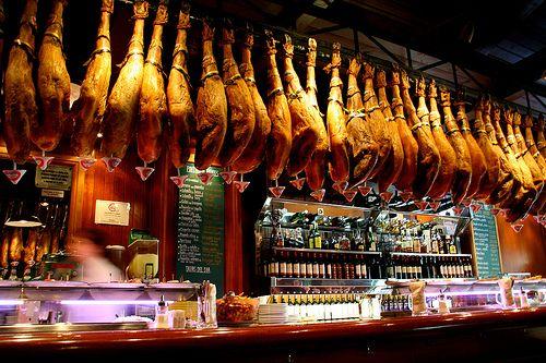

Doesn't need to be chilled. Unopened the fat and salt preserve it indefinitely.
Once started it is just drying of the cut surface that is the slightest issue. Note the standard picture in a Spanish bar.
