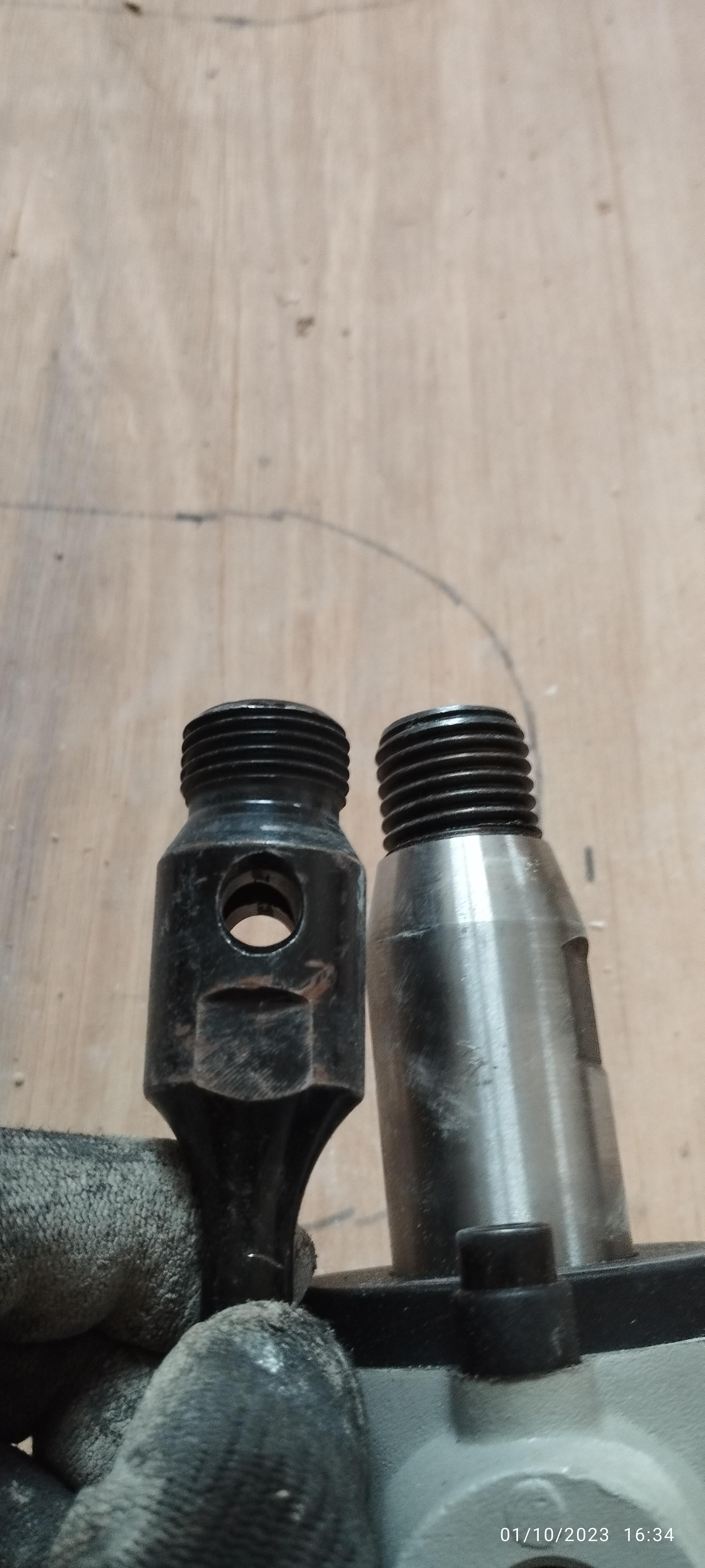

hbooth Posted October 3, 2023 Share Posted October 3, 2023 Hi, I'm trying to core a 152mm hole for my soil pipes and using pipe snugs to fit them. I have a 152mm Erbauer drill bit which will do the job but I managed to burn out my old drill when coring the hole. I purchased a more powerful drill from amazon but it a core drilling drill and the thread sizes of the drill and my drill bit are different. I think the diameter is not too much different but the spacing between the threads is way different. Is there an adaptor that I can buy so I can use my drill bit with the drill. The size on the drill is M22 apparently. The size on the dril bit is 1/2" according to screw fix website. I've attached a picture which shows the thread on the new drill(the silver one) vs the thread on the drill attachment for the drill bit(the black one). Any help would be much appreciated. Link to comment Share on other sites More sharing options...
markc Posted October 3, 2023 Share Posted October 3, 2023 Core bits, especially lager diameter ones really need a water supply to flush away the debris otherwise it collects at the face and puts a lot of strain on the motor, pulling out to clear the cutting dross every few mm helps if doing it dry. I have done lots of diamond drilling but dont recognise the mount on your new drill/motor, looks like it is missing a chuck Link to comment Share on other sites More sharing options...
SteamyTea Posted October 3, 2023 Share Posted October 3, 2023 Is the left one a metric fine thread? https://www.newmantools.com/tech/threadmf.htm Link to comment Share on other sites More sharing options...
saveasteading Posted October 3, 2023 Share Posted October 3, 2023 Are we talking of concrete here? Mag have steel in it? I'd recommend hiring a specialist machine complete with corer. This will be diamond or tungsten, and do your core easily. So you will only need it for a day. Link to comment Share on other sites More sharing options...
hbooth Posted October 3, 2023 Author Share Posted October 3, 2023 The left one is the top of the adapter that would then fit into a standard chuck of a drill. This screws into my erbauer core bit which says it's 1/2" thread size on the scewfix website. The one on the right is the end of my core drill machine. The new machine is from Amazon and I stupidly assumed that the thread would just fit my existing core bits which obviously it doesn't. I'm trying to core through block and then brick, both 100m thick. there's the possibility of hitting wall ties too so I#m not sure what effect that will have on my attempt to core the wall. I was considering to hire a machine for a day but for a bit more money I thought I'd buy the new machine from Amazon so I then have it if I need it in the future. I'm sure the new machine is powerful enough to do the job but I need some way to use my core bits with it. The manufacturer has said it's "thread interface size is M22 specification (also known as Rc thread in GB/T 7306.2-2000 standard)" Which really means nothing to me. I'm just hoping I can find someway to use it. Otherwise it will have to go back and I'll just ed up hiring one. Link to comment Share on other sites More sharing options...

Tom Posted October 4, 2023 Share Posted October 4, 2023 The fitting in the right, where the core bit screws directly on to the drill without the need for a chuck, is common for a dedicated core drill - so I'm surprised the thread doesn't match the erbauer bit. Might be worth cutting your losses and just hiring a core drill for the day Link to comment Share on other sites More sharing options...

hbooth Posted October 4, 2023 Author Share Posted October 4, 2023 4 hours ago, Conor said: If you can source a 125mm bit, it will be a lot easier than a 152mm. I drilled half a dozen of these through 150mm thick reinforced concrete slabs with an SDS max drill. Would not reccomend. Used pros for the 200mm holes for the 4x MVHR ducts. I want to use the 152mm bit as this is the size required for the pipe snug to fit into the hole and the soil pipe will then jusy push through. I thought it would save some hassle of trying to point up the soil pipe etc. I'm thinking it probably would just be easier to cut the holes smaller and point them up. Thing is I've brought the core machine now and Ideally would like to use it. I just need a 152mm bit that will fit the M22 thread on the machine. Like Tom said above the fitting is common for a dedicated core drill so I too am surprised that the Erbauer core bits do not fit. I'm wondering if there is an adapter to convert the M22 to 1/2" thread and then I can use the erbauer core bits. Link to comment Share on other sites More sharing options...
hbooth Posted October 4, 2023 Author Share Posted October 4, 2023 @Tom Do you know where I could buy an 152mm core bit that would fit the machine? I figured the Erbauer bit would jsut screw directly on the machine but obviously not. Link to comment Share on other sites More sharing options...
Tom Posted October 4, 2023 Share Posted October 4, 2023 Hmmm, no idea sorry. If it was from Amazon I'd just try returning it. eBay often has used Marcrist drills which look bomb-proof Link to comment Share on other sites More sharing options...
SimonD Posted October 4, 2023 Share Posted October 4, 2023 7 hours ago, hbooth said: I'm wondering if there is an adapter to convert the M22 to 1/2" thread and then I can use the erbauer core bits. Yeah, you need an adapter. My Marcrist actually came with the adapter even though it's sold as needing one to be bought to use the machine. Link to comment Share on other sites More sharing options...
hbooth Posted October 5, 2023 Author Share Posted October 5, 2023 Ok it's going back to Amazon. Thanks for all the help so far. So next question, can anyone recommend a core drill that will work with a 1/2" BSP fitting and capable of drilling 152mm? I'd rather buy than hire but if needs must then I'll hire one. Link to comment Share on other sites More sharing options...

hbooth Posted October 10, 2023 Author Share Posted October 10, 2023 So I managed to core my three 152mm holes. I purchased a Makita 8406 core drill, which is capable of dry coring upto 152mm and it did them with ease. I figured I'll add it here as it may benefit someone else at a later date. I paid £240 for the drill, ok so I could've hired a drill for half the price but I still have a few more smaller holes to core and so it will certainly come in hand in the future. Thanks to all for the comments. 4 Link to comment Share on other sites More sharing options...
