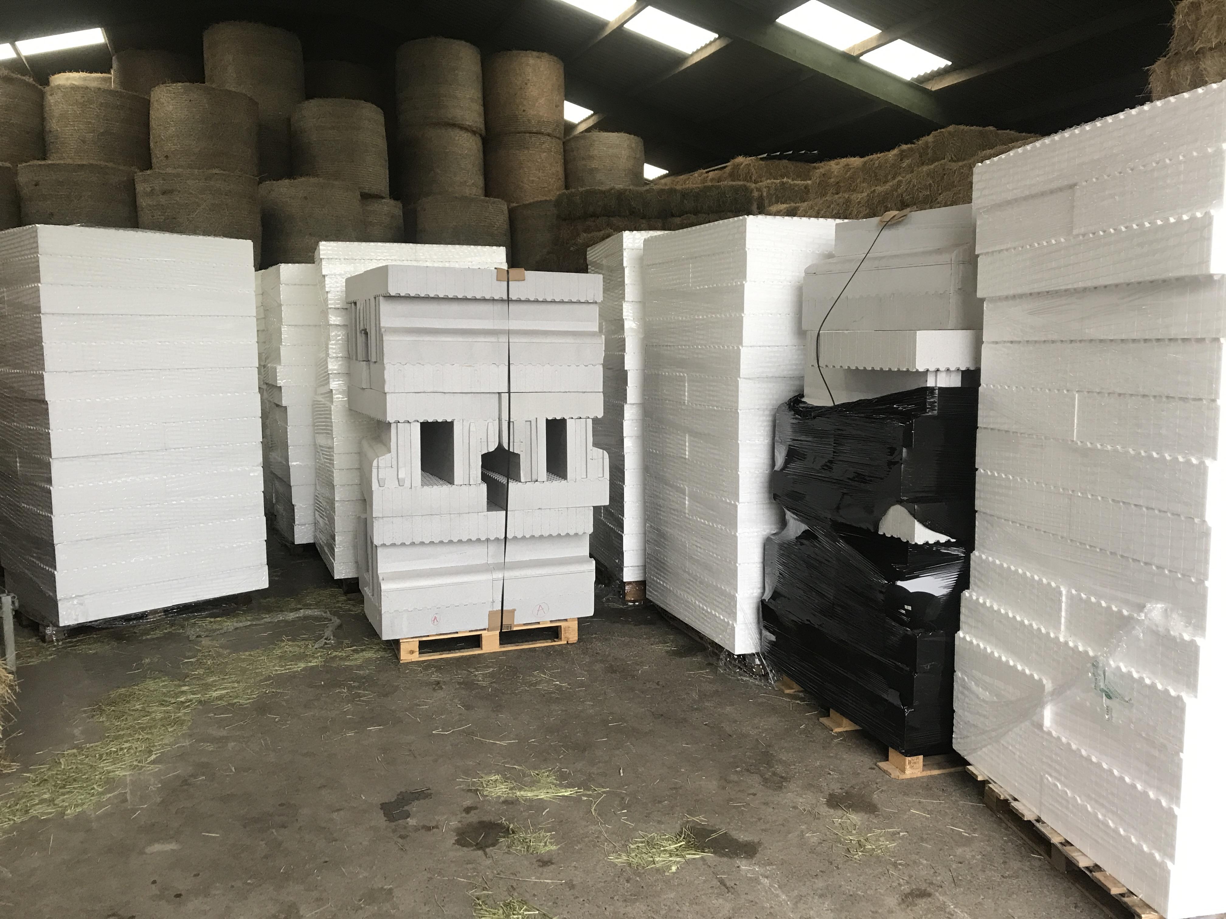

The isoquick should be arriving this week. I was hoping to get the slab finished before the end of October but the more I research the more work I find and details/levels to be found for the underground pipe work/ septic tank and rebar. It’s going to be a challenge I think. If I can get close to the end of October I’ll be happy, it would be helpful to not be pouring concrete in very cold weather.

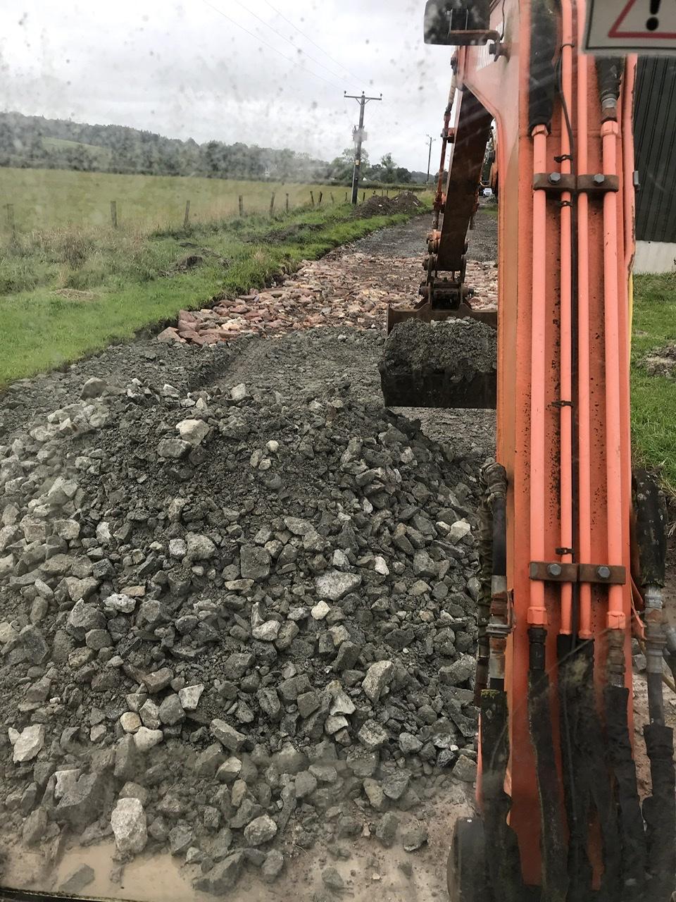

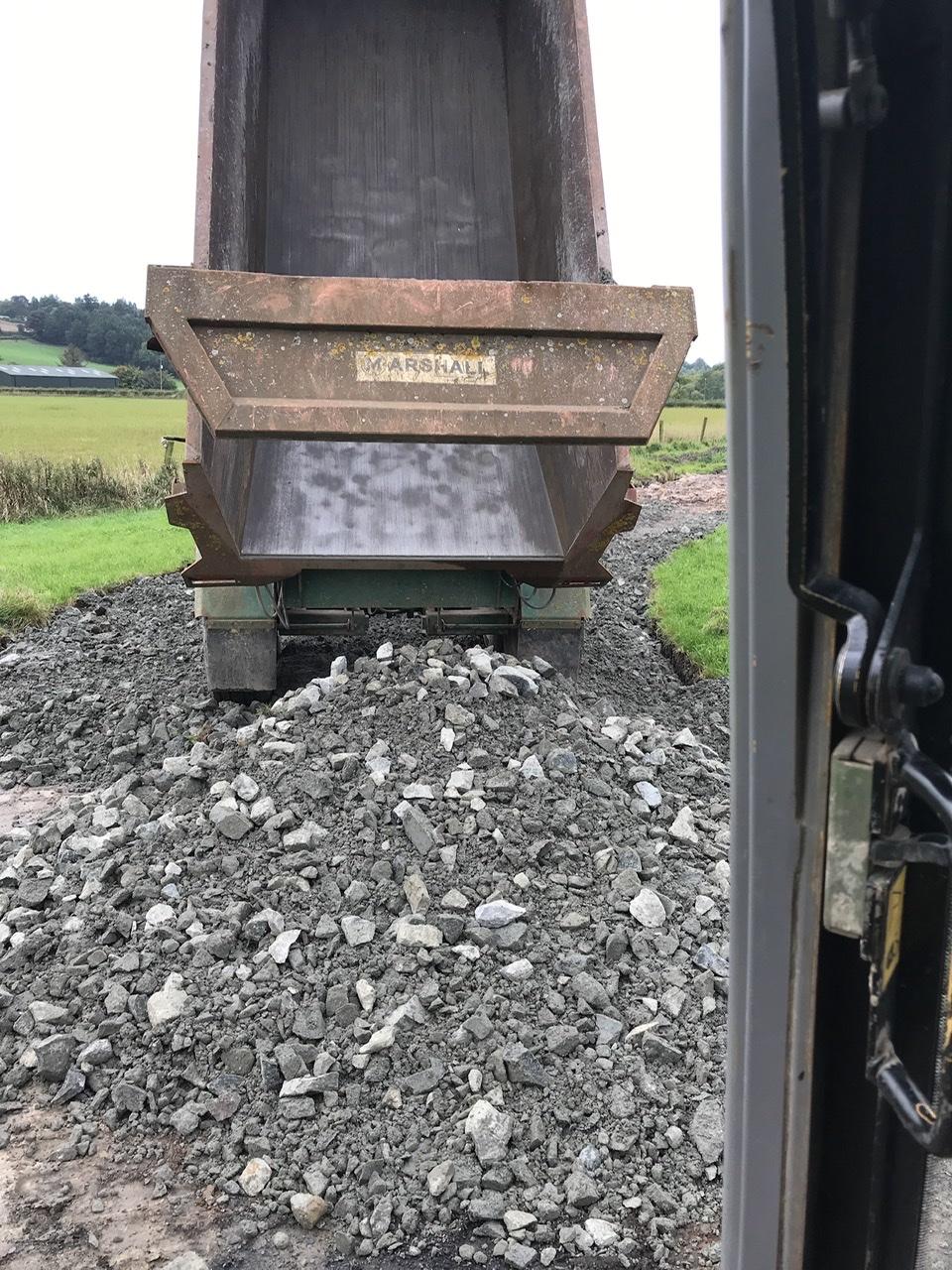

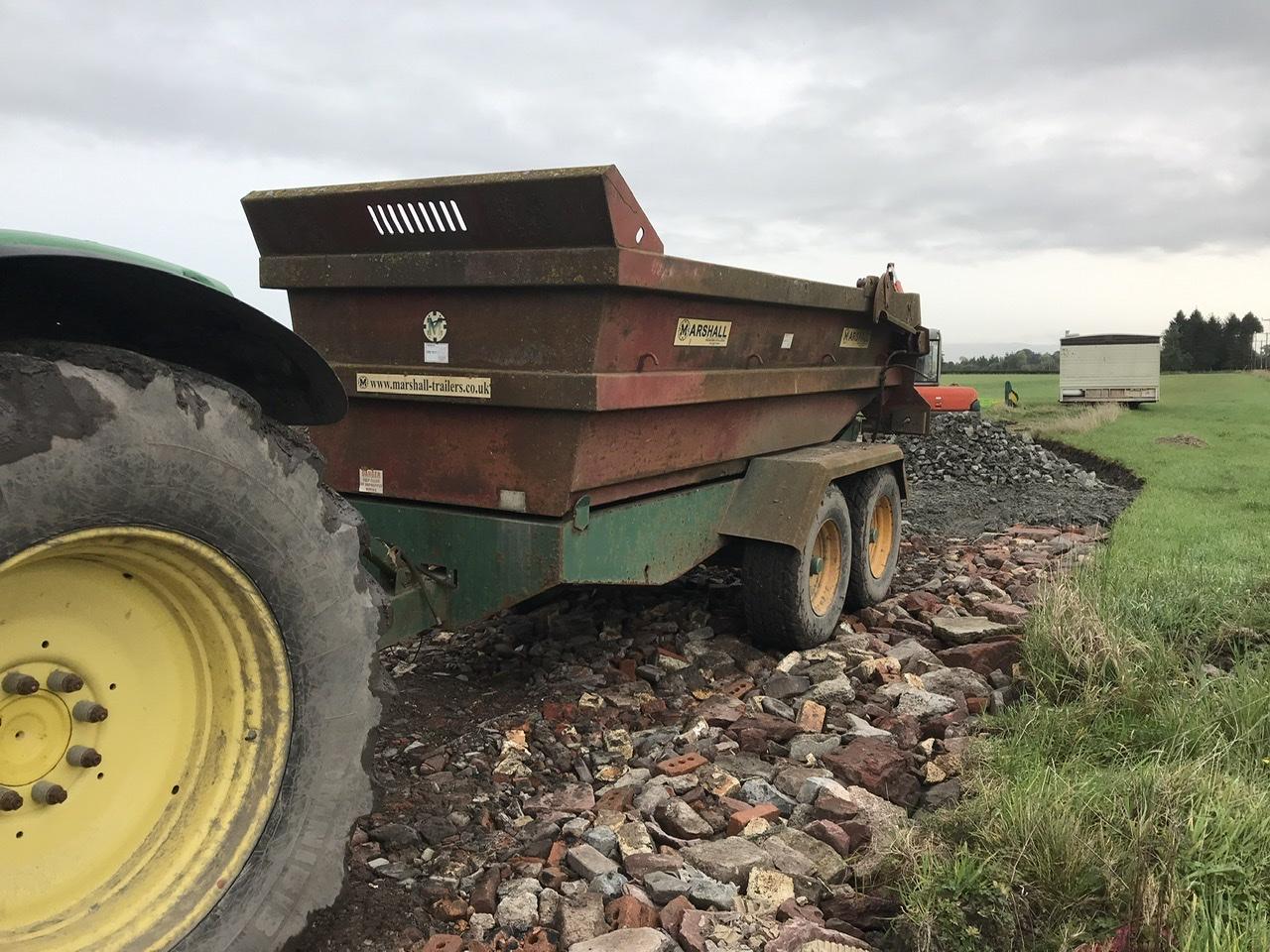

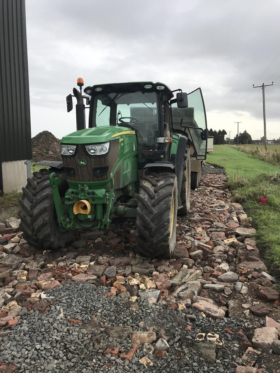

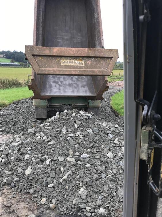

    First job was building a road down the side of the farm sheds for access of heavy traffic. Tractor’s long term, concrete Lorries in the short term.
Any reason you used isoquick over others? Interested as we're having a raft like this...
P.s. wish I had access to machinery like that, must make it easy!
Edited by Duncan62
No big reasons, the architect had used a few different companies and this was their preferred system. Personally I like the fact they had been around for a while and also the egg crate mechanism and dovetail joints on the blocks is pretty cool to lock all the insulation together.
Yes having machines and shed storage space is blessing and a privilege.

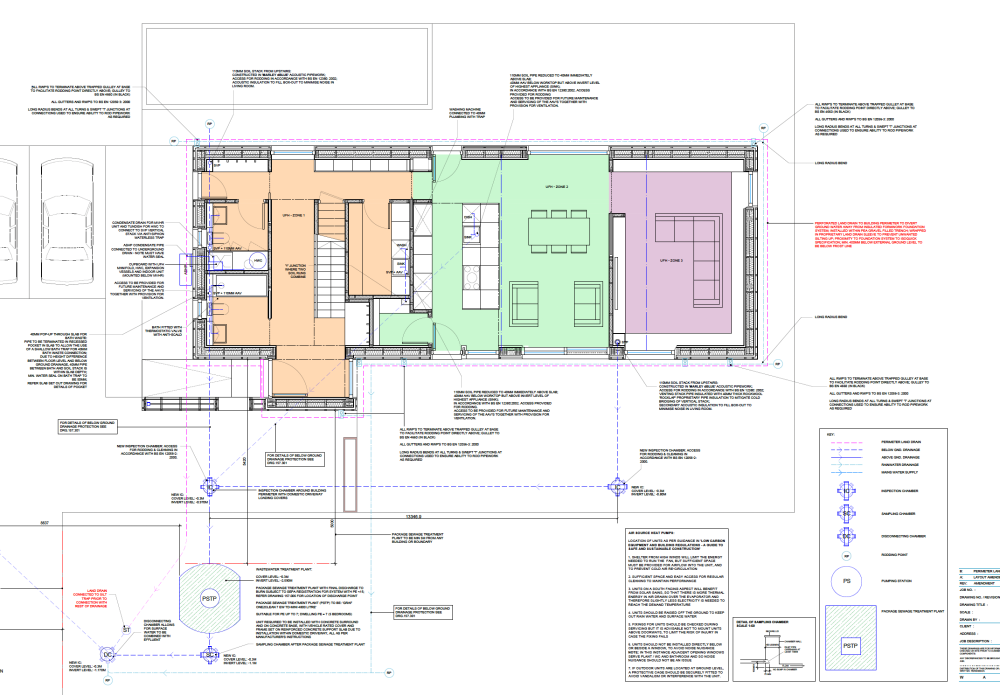

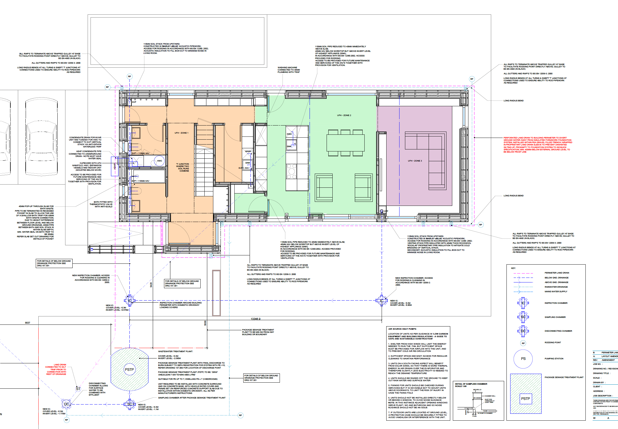

Trying to work out my soli pipe runs, the architect has run them like shown in the pic, reduces the number of inspection chambers but means running a lot more pipe under the slab. For repairability in the future would it make sense to bring all the 110mm soil pipes straight out of the slab, it would mean more inspection chambers as there would be a lot more changes of direction. I especially don't like the run on the left side of the house that picks up the three soil pipes, one from upstairs, toilet and bathroom. What would you do?
Edited by gavztheouch
I agree. I think all foul drains should go a short route out of the house, but also square to the building as it makes construction easier.  A shorter run at a steeper grade is best.
ICs aren't very expensive as long as away from vehicle loading.
Where does the rainwater go? If it is to a big soakaway or pond on your land , then OK.
Having a French drain all  around the house is OK if there is a problem,  but it should not drain your ground to mains or water courses,  which would be the opposite of flood mitigation.
The French drain will go into the river forth. Because I’m close to the river I shouldn’t be causing any flooding Issues other than raising the height of the river forth itself. I don’t know if that’s an issue. Do people build houses without French drains? If so what are the alternatives. My dads house about 200-300 years old goes not have drainage like this. My 1930 flat does not have a French drain. It might have a gravel drain.
The 110mm soil pipes need a 90 bend to pop up through the slab. I assume I don’t need a slow bend here and a normal 90 rest bend will be ok here? A slow bend will increase the depth of the pipe a lot more. A rest bend needs about 300mm to go from horizontal to vertical. It needs to be vertical before going through the Iso quick slab.
