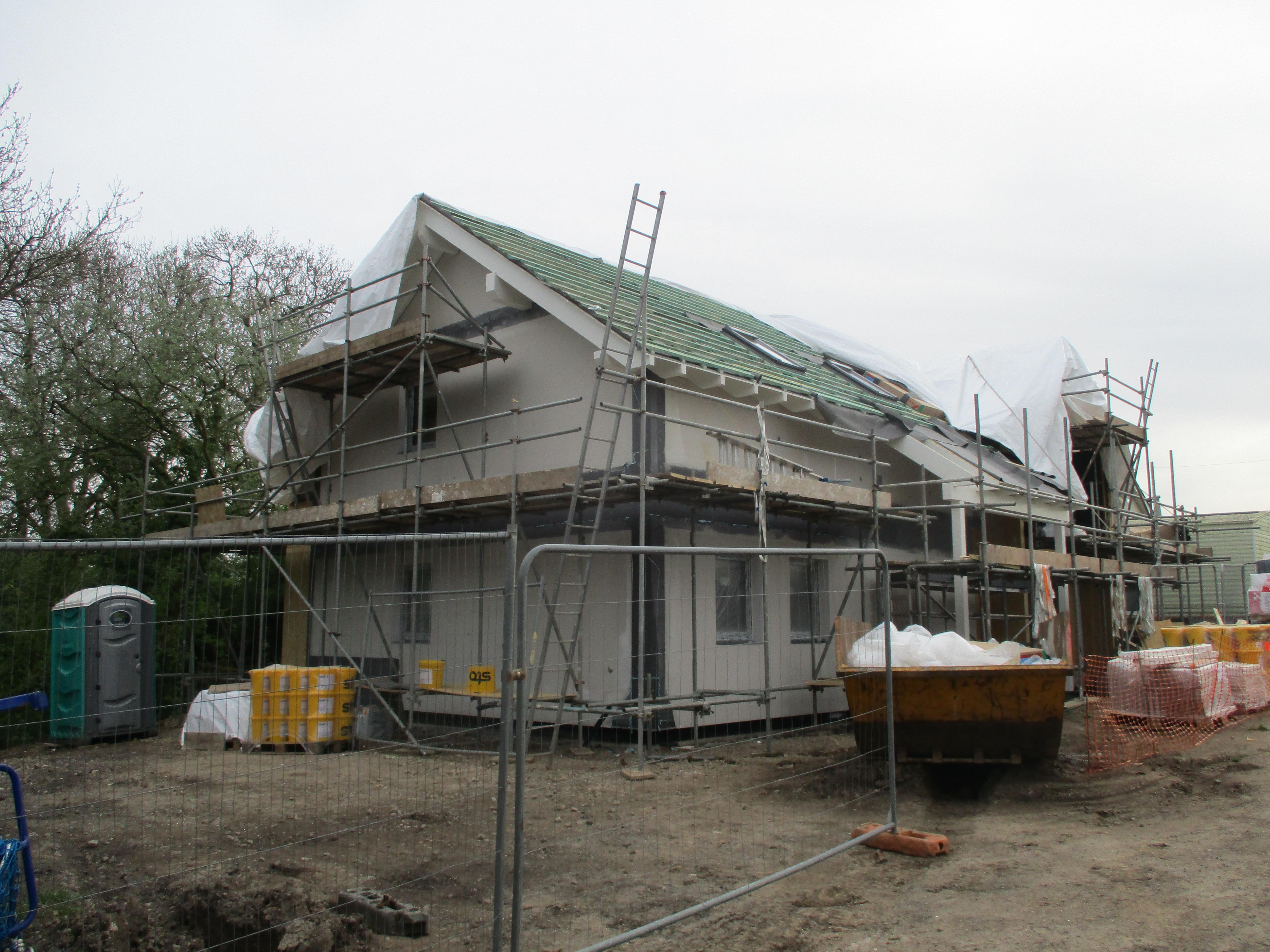

Well the perimeter was set by the vertical edge insulation. My ground workers used a laser level with a square of ply attached to their staff which they used to keep checking the concrete surface level, a little crude but it worked. The two pumping guys handled all that side of things so we could concentrate on the spreading, compacting and levelling. Yes pleased with the end result - probably no more than 10mm out of level looking at the subsequent rainwater on the surface.
We now have the attached sitting on it - that's four days work for six men and a crane.
