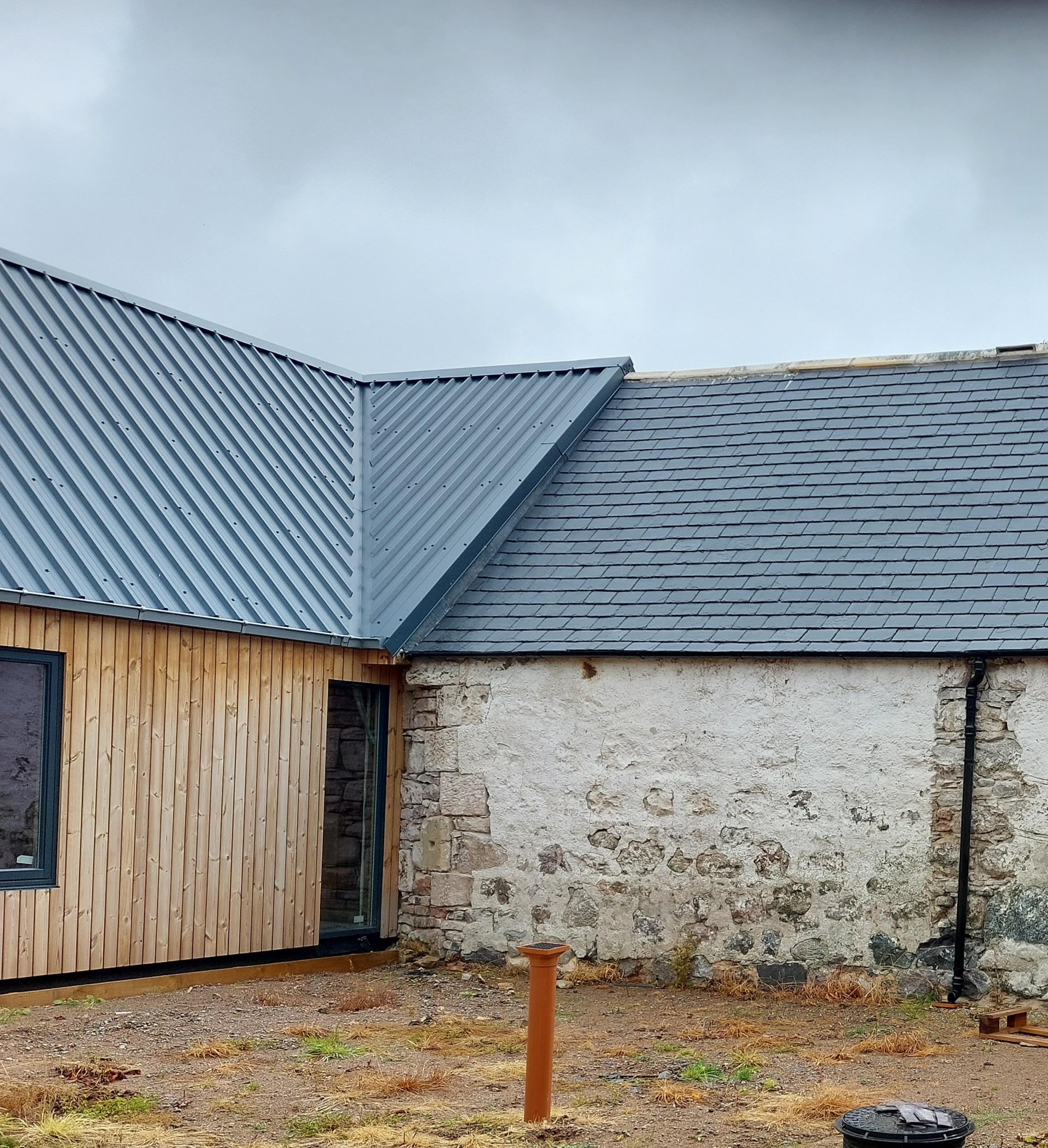

saveasteading Posted October 1, 2023 Share Posted October 1, 2023 This is ours 9 months after cladding. It won't rust or have swarf on it. It was done by our joiner who would have used a grinder but was instructed not to and watched. The hire companies didn't stock nibblers which shows how little they are used. This wasn't intended to resemble a zinc roof. If it had, we would have used a wider pan. I think £40/m2 probably covers it. Re another current thread, that's a Lindab gutter on the new build and refurbished cast iron on the original. 2 Link to comment Share on other sites More sharing options...
Rishard Posted March 28 Share Posted March 28 @saveasteading love the look of this roof. Who did you use for supply of the panels? Also, what make up did you use below it? Cheers Link to comment Share on other sites More sharing options...
saveasteading Posted March 28 Share Posted March 28 It's standard single skin from Colour Clad. It is on tile batten to allow an air gap and flow, then dpm on osb on rafters. Link to comment Share on other sites More sharing options...
