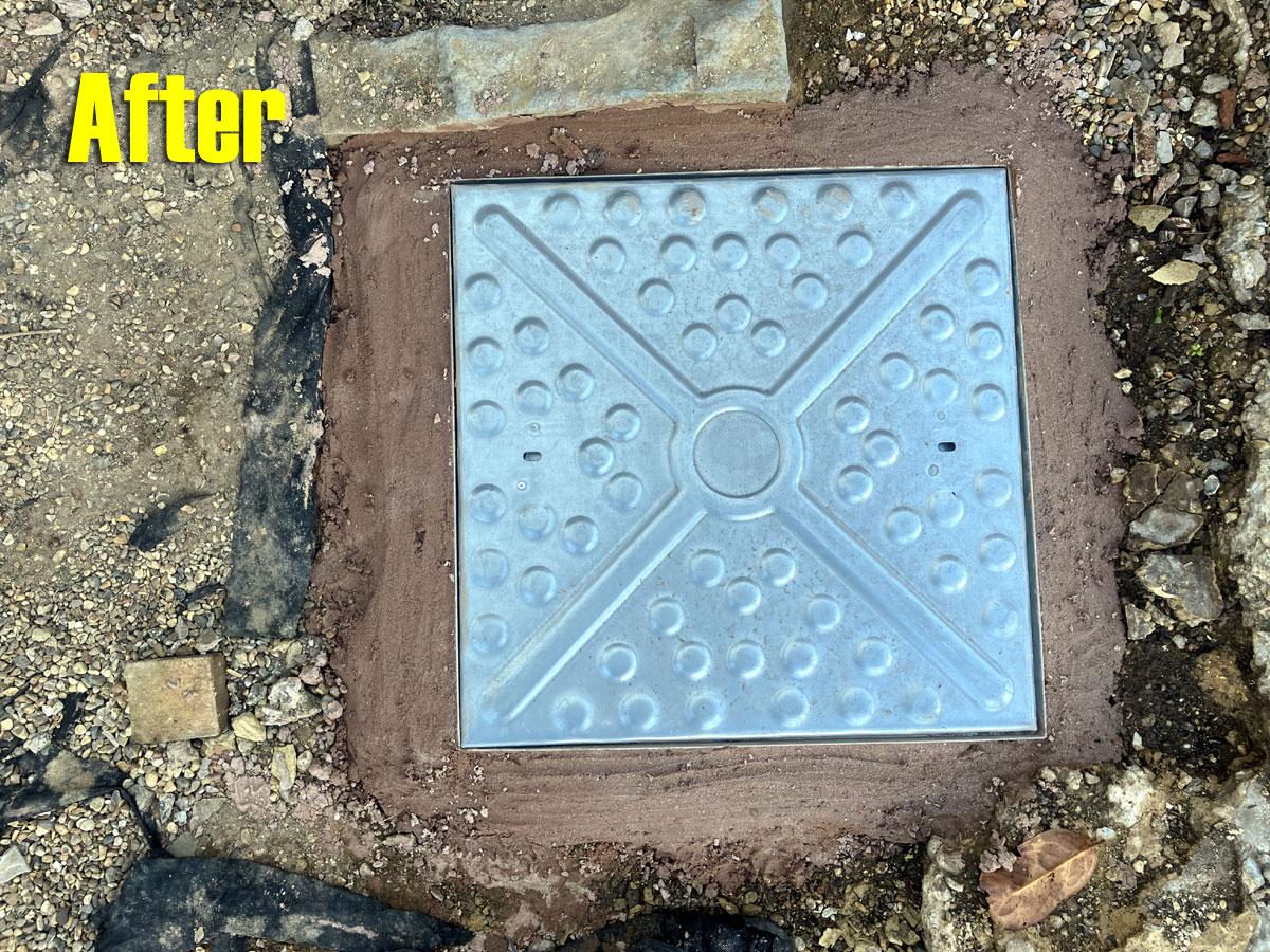

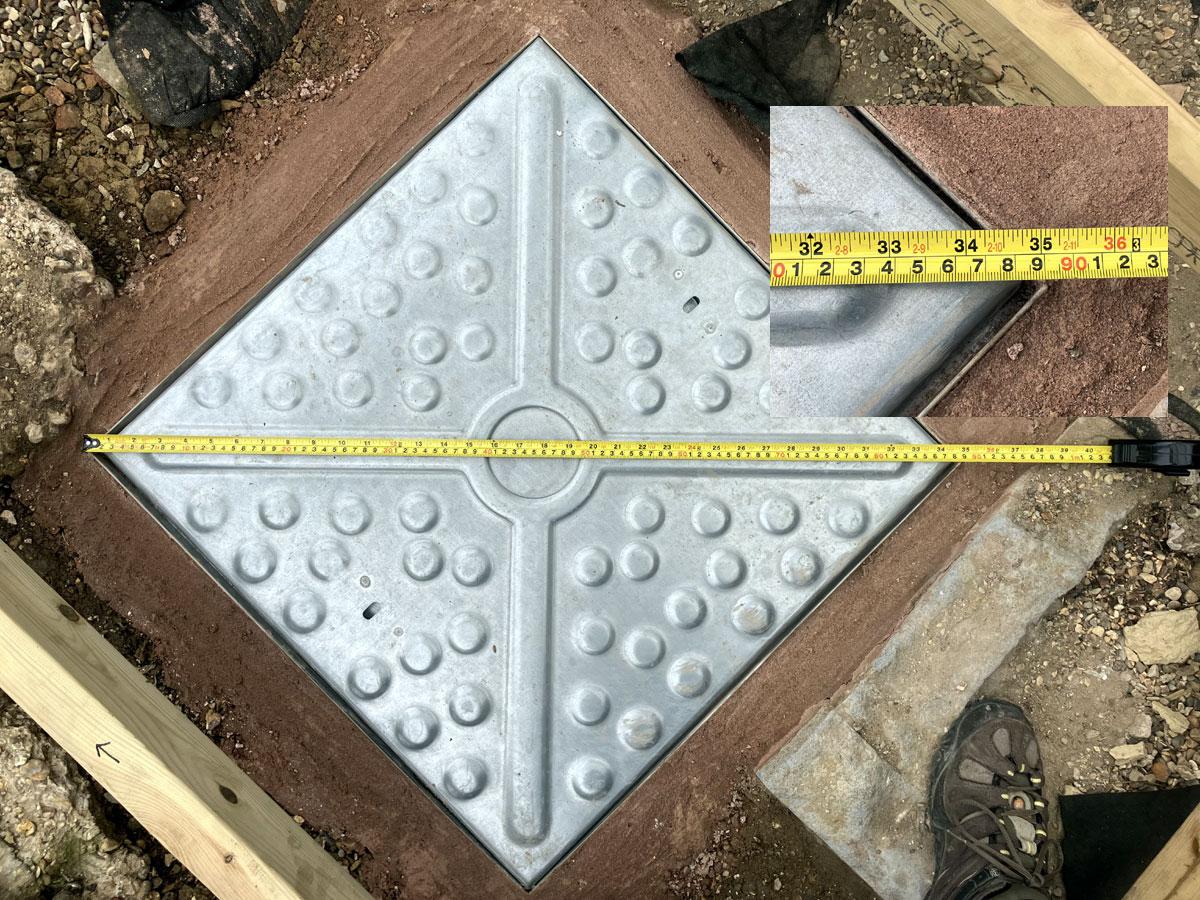

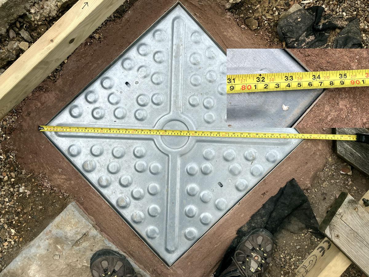

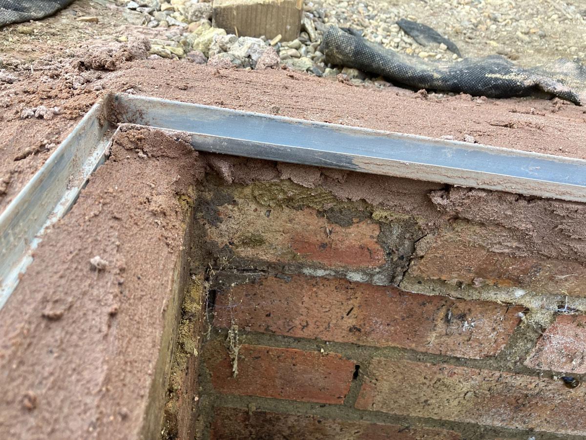

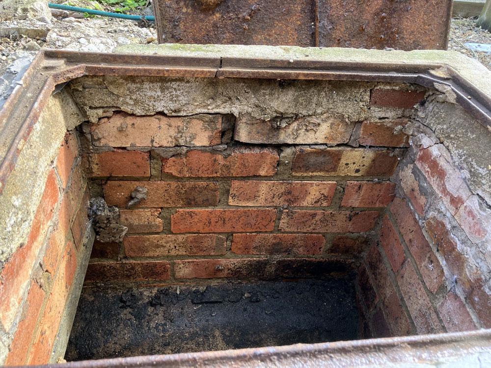

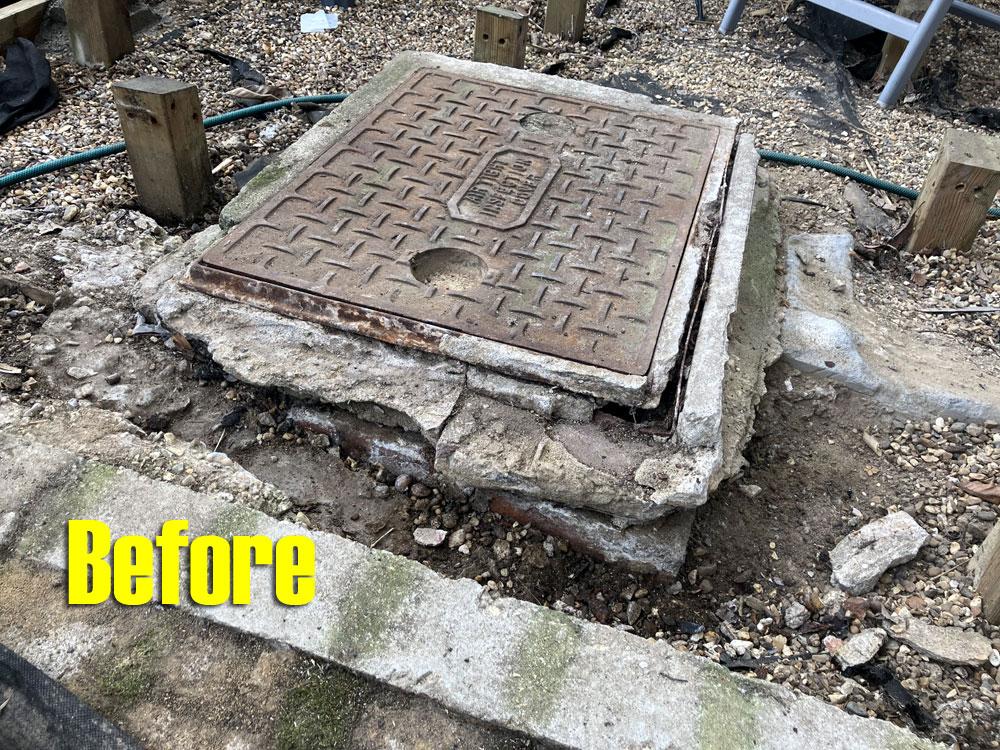

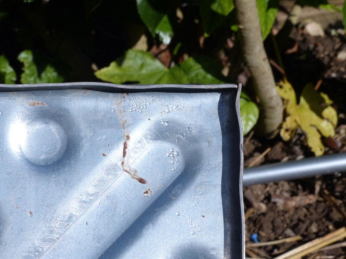

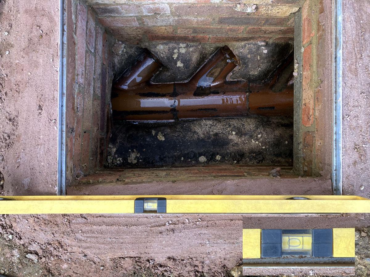

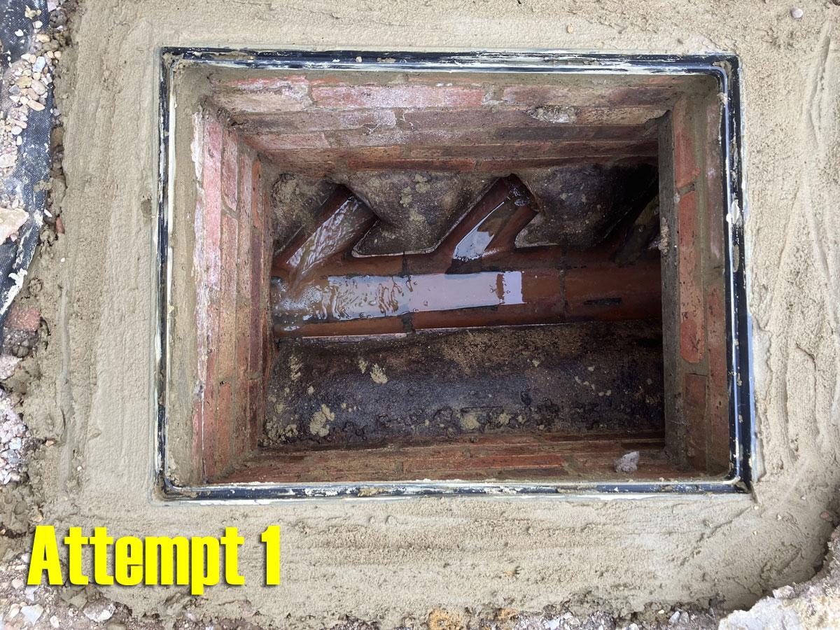

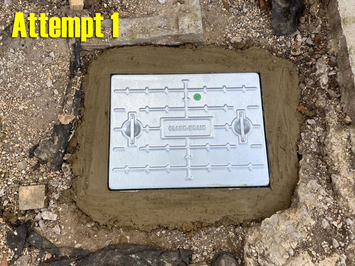

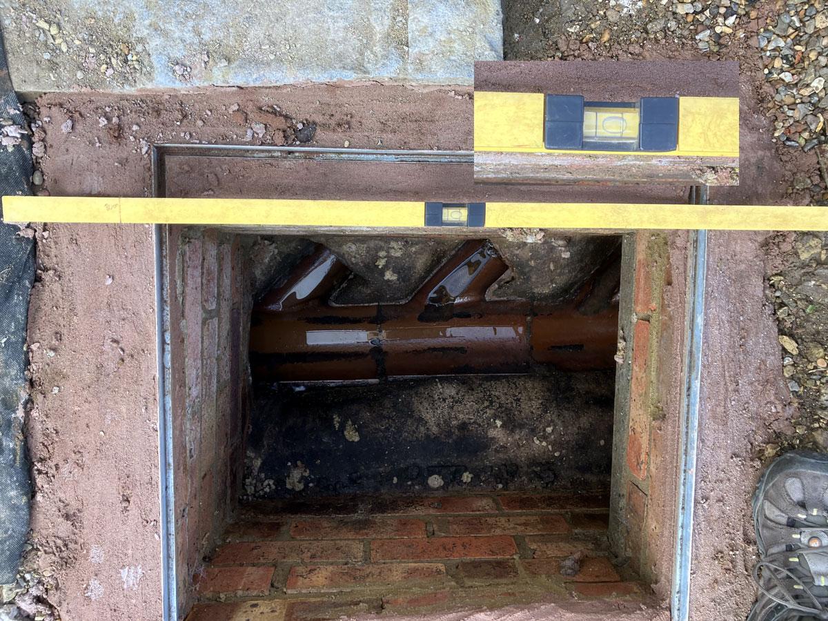

Almost Aviation Posted September 26, 2023 Author Share Posted September 26, 2023 (edited) As requested, I am posting some pictures to give an idea of the landscape. From a distance, this might look better than it did, but the devil is in the details. Aftermath: Edited September 26, 2023 by Almost Aviation Added another 'before' pic :) Link to comment Share on other sites More sharing options...
Super_Paulie Posted September 26, 2023 Share Posted September 26, 2023 looks ok to my non-drainage eyes. But if it stinks still then yeah its not ideal. But thats a £500 job tops surely. Link to comment Share on other sites More sharing options...
Carrerahill Posted September 26, 2023 Share Posted September 26, 2023 18 hours ago, Almost Aviation said: ...which is a shared line for the street. So it is a sewer? Why are you getting this work done then? Link to comment Share on other sites More sharing options...
saveasteading Posted September 26, 2023 Share Posted September 26, 2023 16 hours ago, TonyT said: I think you have no specification, so it’s your word against theirs. 17 hours ago, markocosic said: You have a cover fitted. That's the sum total of your arrangement. Now we have seen the pictures, I think there is an implied expectation of a replacement to the same quality and size, especially as this is a readily available product, unless they said they proposed the inferior options. So yes, you could reject their work. I'm guessing they were cash merchants and you've paid. Link to comment Share on other sites More sharing options...
