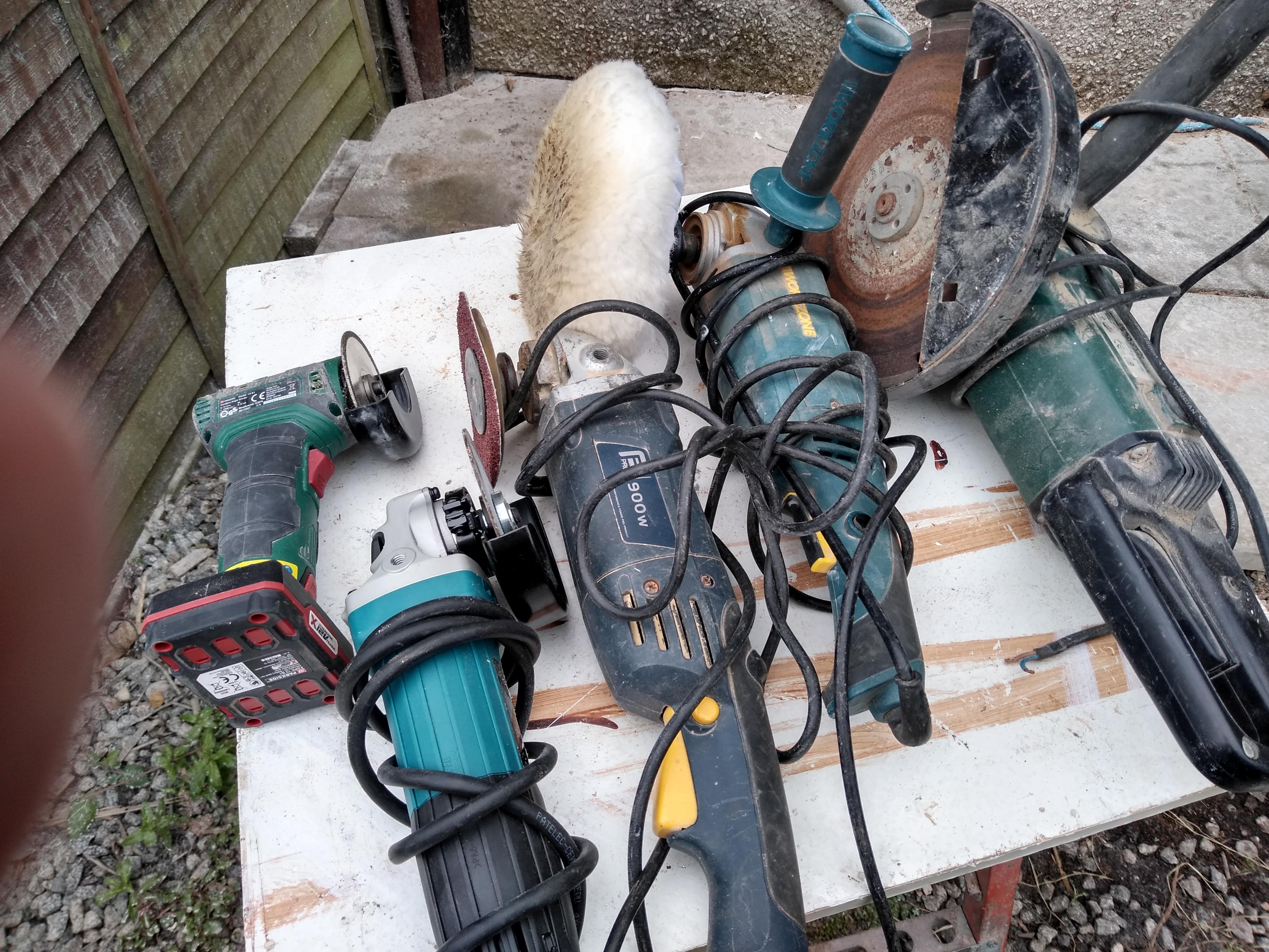

SteamyTea Posted August 29, 2023 Posted August 29, 2023 (edited) I have a selection of angle grinders, one small cordless, a small one, a medium one with speed control and a very large one. The big boy scares the hell out of me when slicing concrete slabs up. The little one, 700 W, is very easy to use as it can be locked on, means one handed usage. But don't try using one up a ladder, when a cutting disc grabs, there is a lot of inertia in the disk, and even 700W is like pushing 700 kg a metre, in one second. So if you weigh 100 kg, you will have moved over a metre before you even have time to realise what has happened. Edited August 29, 2023 by SteamyTea 1 1
