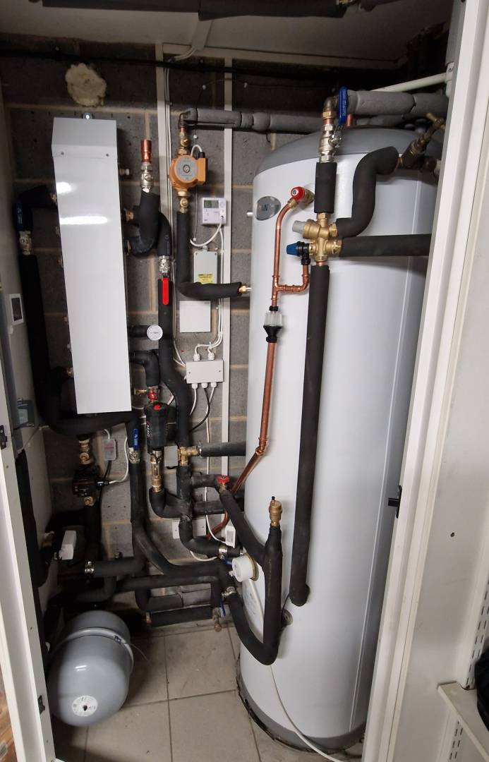

Beelbeebub Posted August 28, 2023 Share Posted August 28, 2023 How many litres of buffer/volumiser do you need? Grant do a nice small unit, about 11liters (tho g on the left) If you already have an indoor hydro unit, you coiod replace that with 2 or 3 of those for 35l or so. It has an immersion backup as well. With regards to the buffer not being in the loft. If the only objection is "it needs to be in the insulated envelope" (which sounds like an excuse) then slapping an insulated box around it would be pretty easy. Grant make a volumiser tank specifically for external mounting. Link to comment Share on other sites More sharing options...

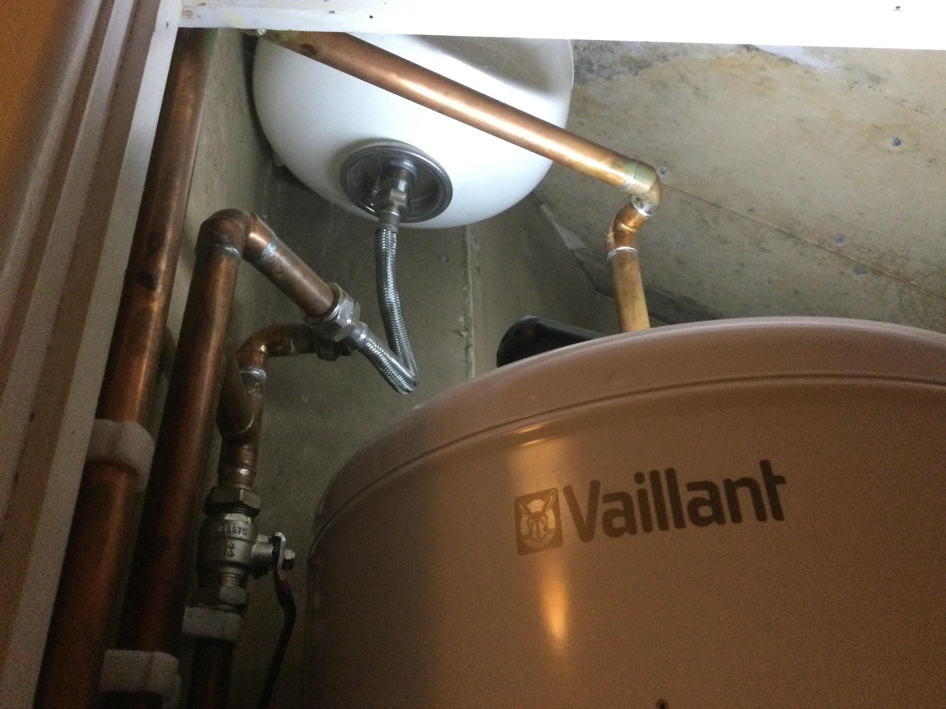

zoothorn Posted August 28, 2023 Author Share Posted August 28, 2023 And another question please chaps: I see some form of weird expansion white vessel/ tank, sitting atop the cylinder currently. Is this a buffer?? Link to comment Share on other sites More sharing options...

zoothorn Posted August 28, 2023 Author Share Posted August 28, 2023 @TonyT I gave some form of vessel above my cylinder here. It's about 1.5 basketballs in size. White, a tank. Is this a 'buffer'?? Link to comment Share on other sites More sharing options...

Temp Posted August 28, 2023 Share Posted August 28, 2023 (edited) 10 hours ago, zoothorn said: The idea refused in an email later, because it needs to be in an insulated place was their reason Tell them if they put it in the loft you will insulate at rafter level. You could always just put a box of insulation over it instead. Edited August 28, 2023 by Temp 1 Link to comment Share on other sites More sharing options...
sharpener Posted August 28, 2023 Share Posted August 28, 2023 12 minutes ago, zoothorn said: @TonyT I gave some form of vessel above my cylinder here. It's about 1.5 basketballs in size. White, a tank. Is this a 'buffer'?? No it is an expansion vessel. Link to comment Share on other sites More sharing options...

zoothorn Posted August 28, 2023 Author Share Posted August 28, 2023 2 minutes ago, sharpener said: No it is an expansion vessel. Urgh. No, I thought it wasn't likely a buffer. But its a white flaming bloody tank that holds presumably, water, which is presumably, what this white f*****g buffer tank also holds too. Link to comment Share on other sites More sharing options...
TonyT Posted August 28, 2023 Share Posted August 28, 2023 A buffer will have more connections. Link to comment Share on other sites More sharing options...
