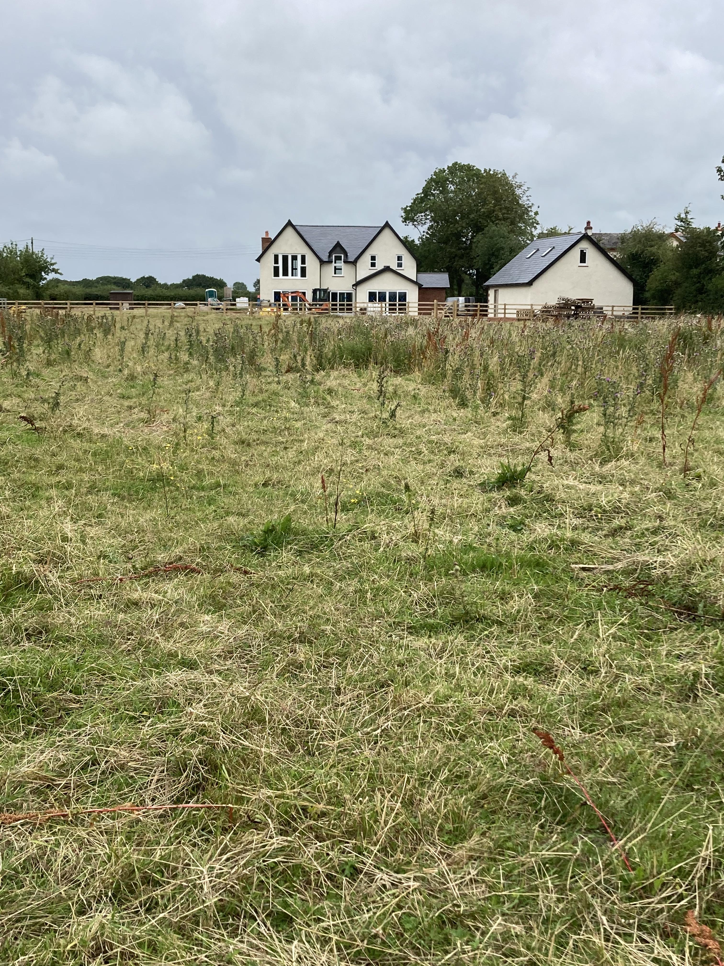

Dave Jones Posted August 27, 2023 Share Posted August 27, 2023 that change in roof pitch for the conservatory wouldn't pass my OCD test, would have had to warm parapet roofed it! Oh and cut your grass! Link to comment Share on other sites More sharing options...

nod Posted August 27, 2023 Share Posted August 27, 2023 1 hour ago, Dave Jones said: that change in roof pitch for the conservatory wouldn't pass my OCD test, would have had to warm parapet roofed it! Oh and cut your grass! Yeah 30 degrees Bit of a compromise but it is the back of the house You have to walk across our field to really notice it Link to comment Share on other sites More sharing options...
