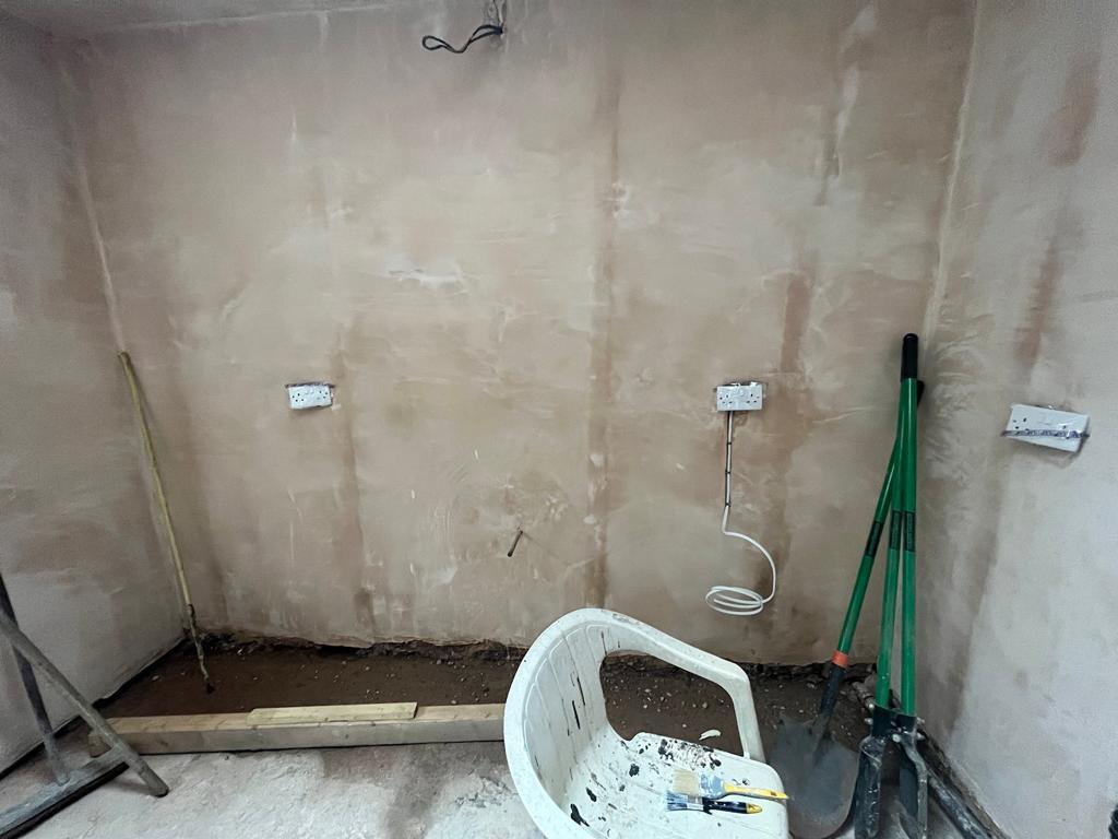

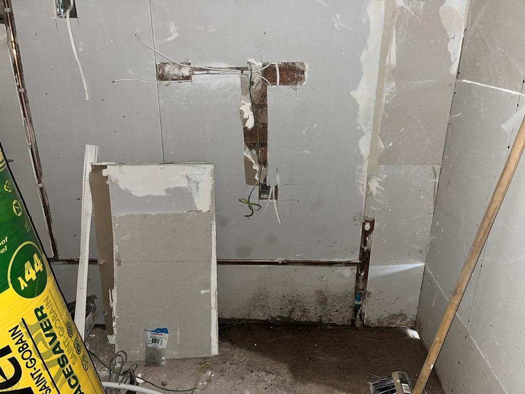

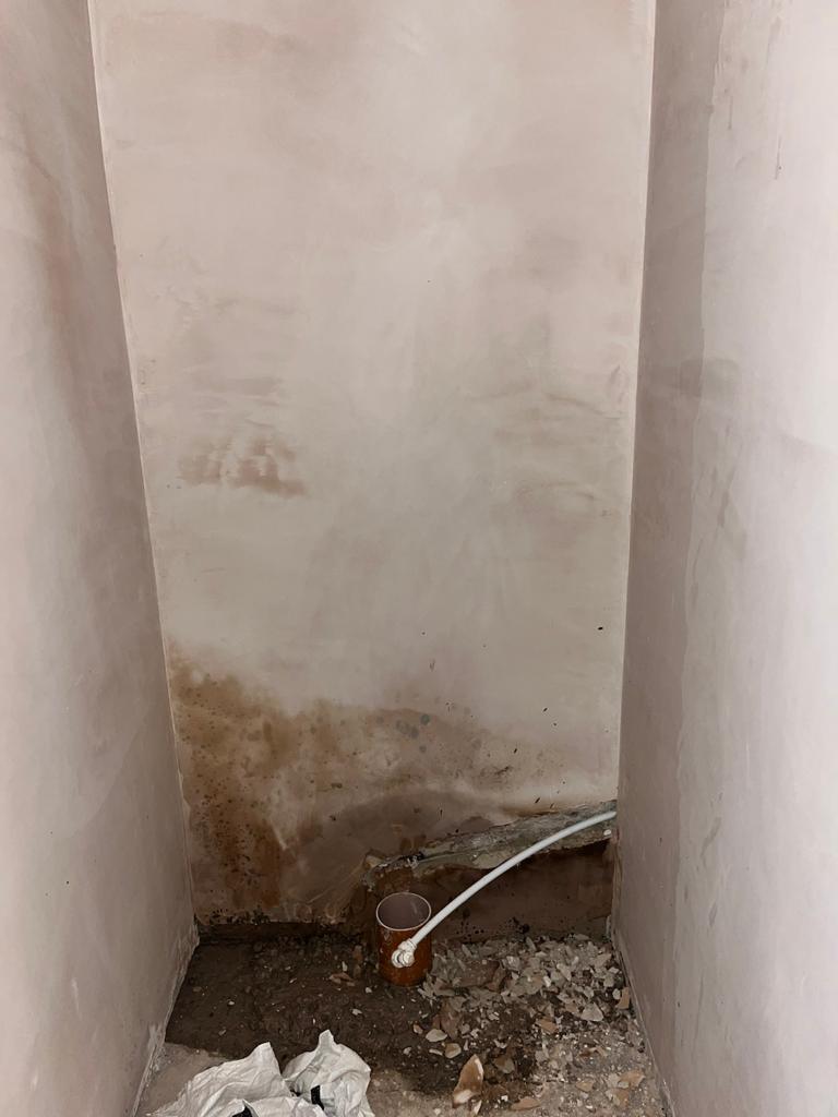

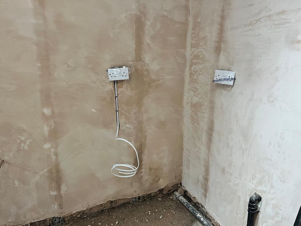

Aaron Posted August 23, 2023 Share Posted August 23, 2023 Hi all, the damp is on an exterior wall garage / extension. There was previous water damage from a leaking roof. The roof has been replaced, drainage sorted but 2 months after the plaster has been put on we are getting signs of water through again. The moisture meter says 75 but we are using a de-humidifer and that has reduced it to 62 within 4 hours. We had a damp report done back in March and that did not identify any signs of rising damp on the property but now are unsure about what to do next. Link to comment Share on other sites More sharing options...

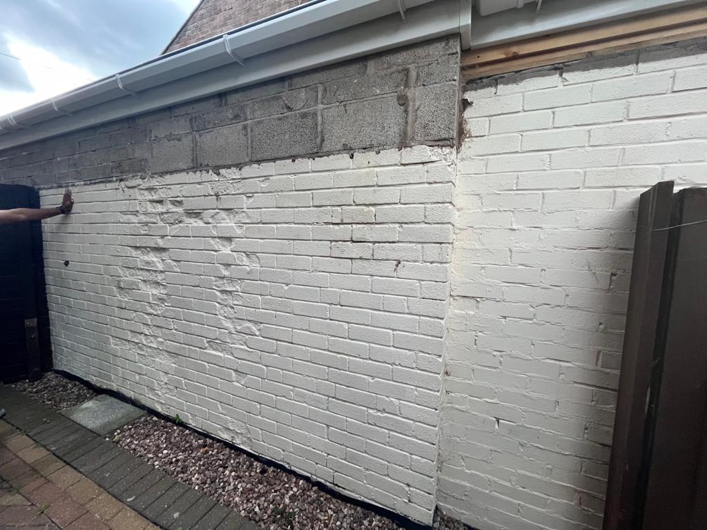

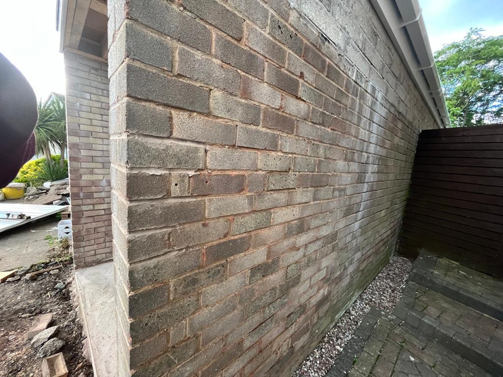

JohnMo Posted August 23, 2023 Share Posted August 23, 2023 Have you reviewed the level of the DPC compared to the outside ground level. You really need the DPC 150mm above the outside ground level. The second to last photo looks to have gravel way above the floor level. Do you have any insulation in the building? Link to comment Share on other sites More sharing options...
Aaron Posted August 23, 2023 Author Share Posted August 23, 2023 It is the neighbours property, when we did the floor of our property we did not find DPC. Do you know how we would go about installing it? We have put insulation in now, cavity wall and in the ceiling, and loft. It may be worth noting that the property has not been heated in quite some months. Link to comment Share on other sites More sharing options...
Dave Jones Posted August 23, 2023 Share Posted August 23, 2023 solid wall with paint on it. No cavity, no insulation. Does the wall even have DPC ? garages dont need one for regs. any temperature difference between inside/outside will immediately get that wall damp with condensation, a lot of which will be inside the wall. Strip of the plaster, stud and insulate then board and plaster again. Link to comment Share on other sites More sharing options...
markc Posted August 23, 2023 Share Posted August 23, 2023 I would say the water is coming in under the wall due to the outside ground level. If it’s on the neighbours side and you can’t dig and install a drain then you are looking at tanking or drainage membrane on your walls and floor to take the water away. Link to comment Share on other sites More sharing options...

JohnMo Posted August 24, 2023 Share Posted August 24, 2023 Not seeing a damp proof membrane either, is that going on the concrete floor before the insulation? Or is that the finished floor height? Link to comment Share on other sites More sharing options...

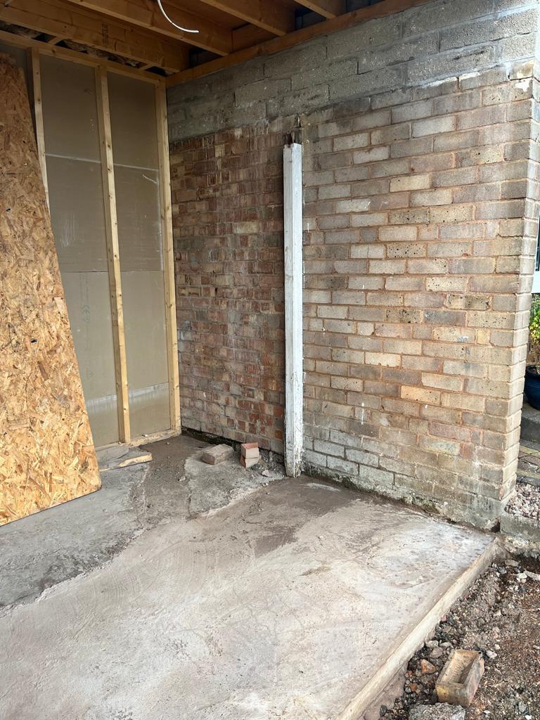

Aaron Posted September 22, 2023 Author Share Posted September 22, 2023 After having 7 different professionals come out, we have about 5 different opinions on how to tackle the problem. - Hack off the plaster to 1.2M above the internal ground level - Tanking membrane or tanking slurry (apparently better than DPC or DPM) along the length of the wall - Put damp course injections in at the height of the first block above ground level - Use Anti-condesnation paint by Permaguard - Put DPM down on the floor after concrete and self-levelling, before underlay and flooring I really hope this covers all avenues? We may have to render the outside wall or re-point and re-paint the neighbours side. Link to comment Share on other sites More sharing options...
ProDave Posted September 22, 2023 Share Posted September 22, 2023 So you have "converted" a garage just by plastering the inside of a single skin brick wall that may not even have a DPC, kept the original concrete floor without building up the level and adding insulation? and the outside ground level appears to be too high. Who has done this work, and more importantly who "designed" this conversion. Just about everything done is wrong. Strip off the plaster, then start again properly designing the conversion and getting it right this time. This forum will give much better advice how to do it properly than anyone that has been near it so far. Link to comment Share on other sites More sharing options...

ProDave Posted September 22, 2023 Share Posted September 22, 2023 I think generally most of us shudder when you say "Damp Specialist" They want to sell you their solution to solve the problem. How many will be blunt like I was (sorry if I offended you) and tell you that what you have is a total bodge, has been done completely wrong, and needs ripping out and starting again with a proper conversion of the building. That is not something some magic damp solving product will fix. It wants a fundamental re design and rebuild. If you did just adopt some damp specialists solution and continue as it was, you would still have a very substandard very poorly insulated, cold and expensive to heat room. Is that what you really want? Or would you like to do it properly and have a nice warm dry kitchen? 1 Link to comment Share on other sites More sharing options...

Mr Punter Posted September 22, 2023 Share Posted September 22, 2023 If you have a properly designed and installed type c drained cavity waterproofing system the room would be dry. It requires the membrane on walls and floor, a perimeter chanel plus a sump / pumps if you cannot drain via gravity. Link to comment Share on other sites More sharing options...
