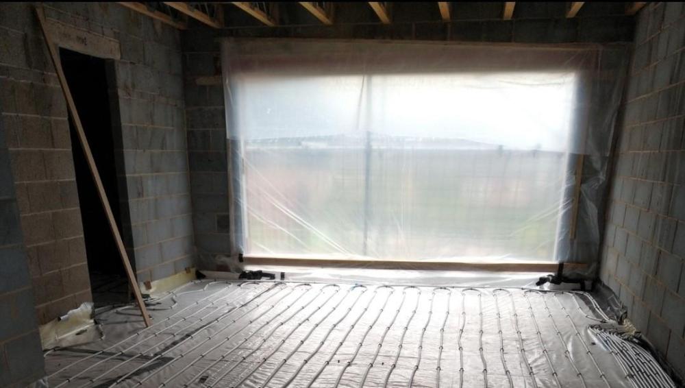

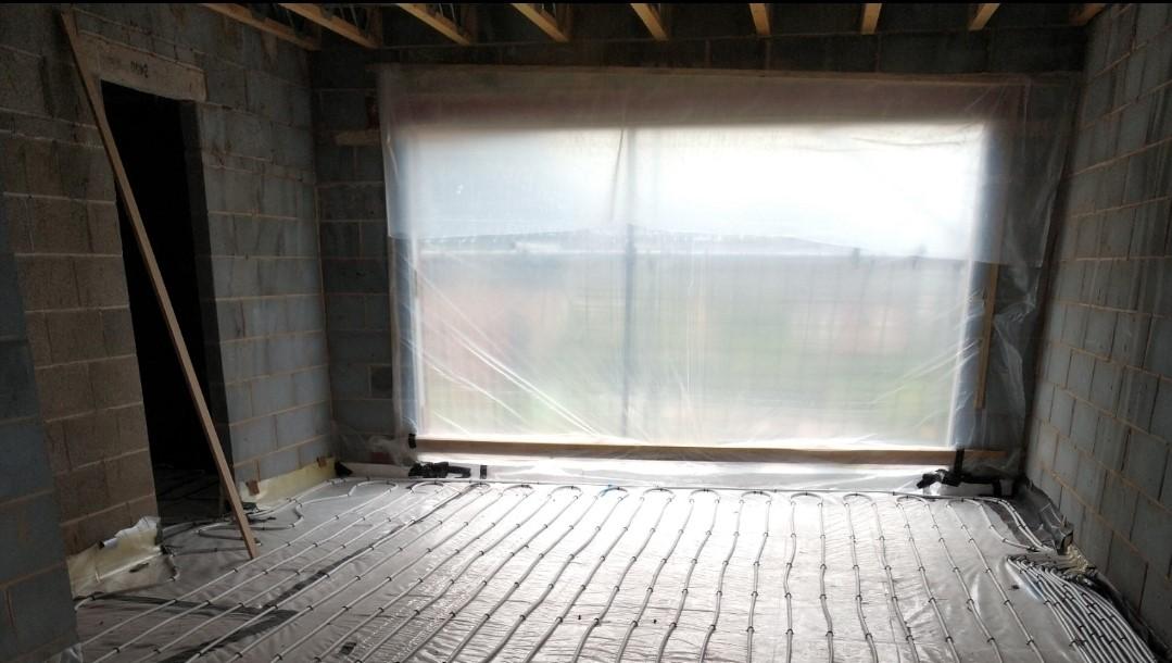

Blooda Posted August 18, 2023 Posted August 18, 2023 (edited) Temporary staircase the way to go. Worth ringing up your stair case provider to see if they have anything kicking around or ripping anything out. As @Bonner said leave a gap at the bottom, This was in as soon as the flooring went in upstairs. All the internal trades will appreciate it. And you can wait till the last minute to put your posh stairs in. UFH went in when the roof was on, windows were poly'd up. A new build down the road did their's when as soon as they were at DPC level and open to the elements. Edited August 18, 2023 by Blooda

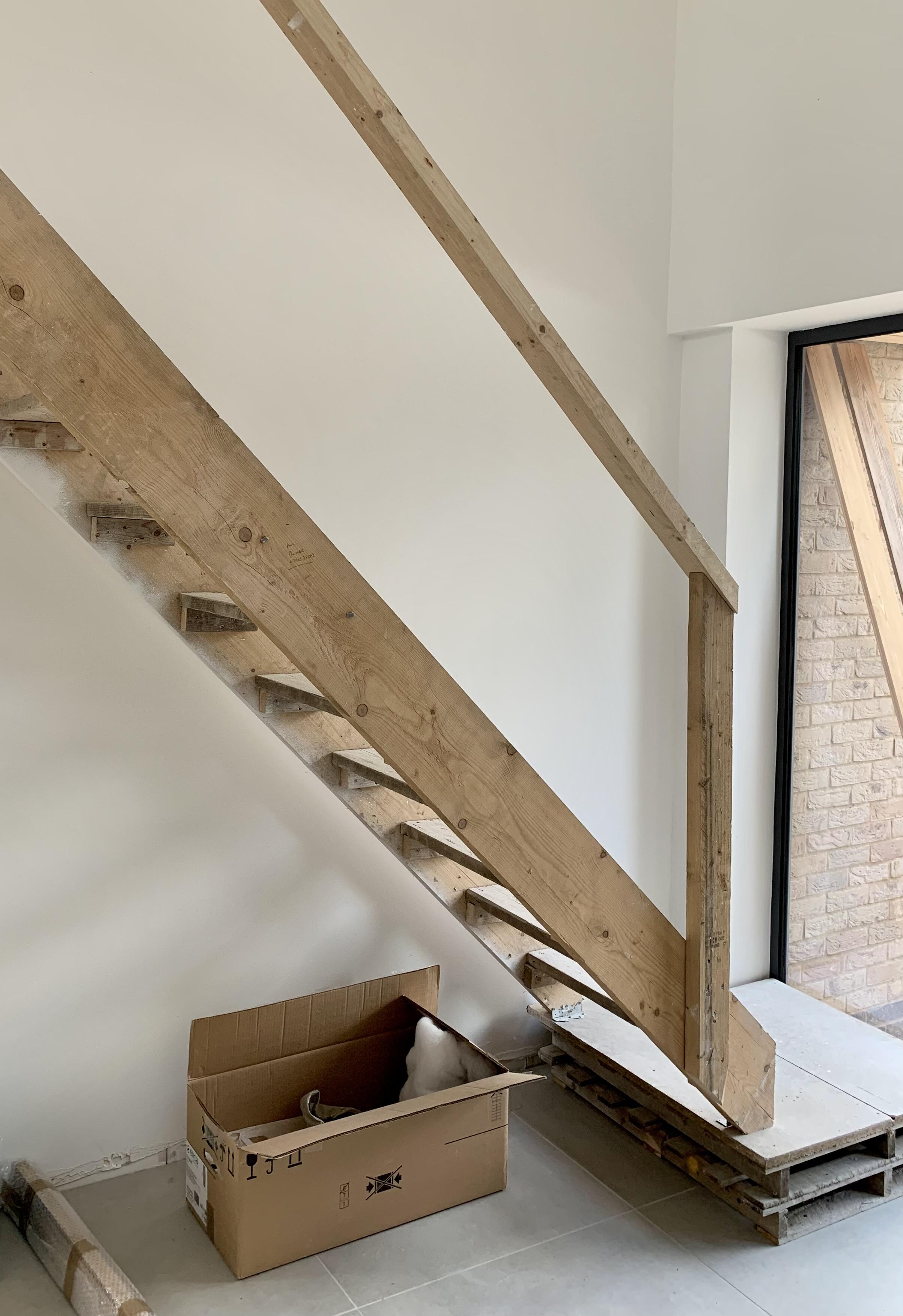

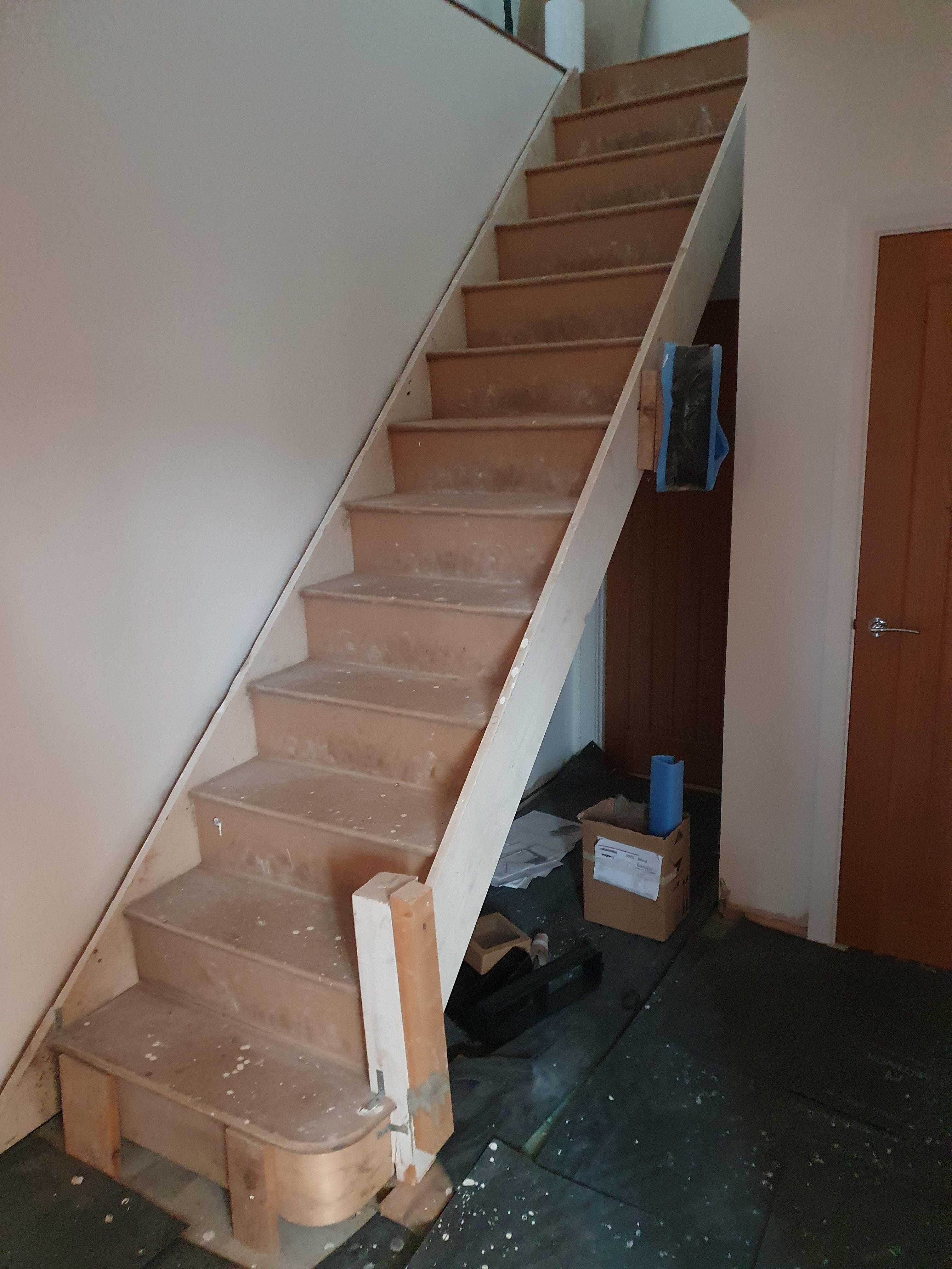

Thorfun Posted August 18, 2023 Posted August 18, 2023 we knew our temporary staircases (we have 3) would be semi-permanent and so bought cheap and cheerful from Stairbox. good enough to last a while as we save up for the final staircases.
eandg Posted August 18, 2023 Posted August 18, 2023 Our windows went in off a scaffold but in hindsight I wish we'd built a temporary staircase - would have made it much easier to move materials and a decent joiner could knock something up in jig time. And if you plan on carpeting or putting in a fancy tread on a shell staircase then you can make a well made one permanent.
