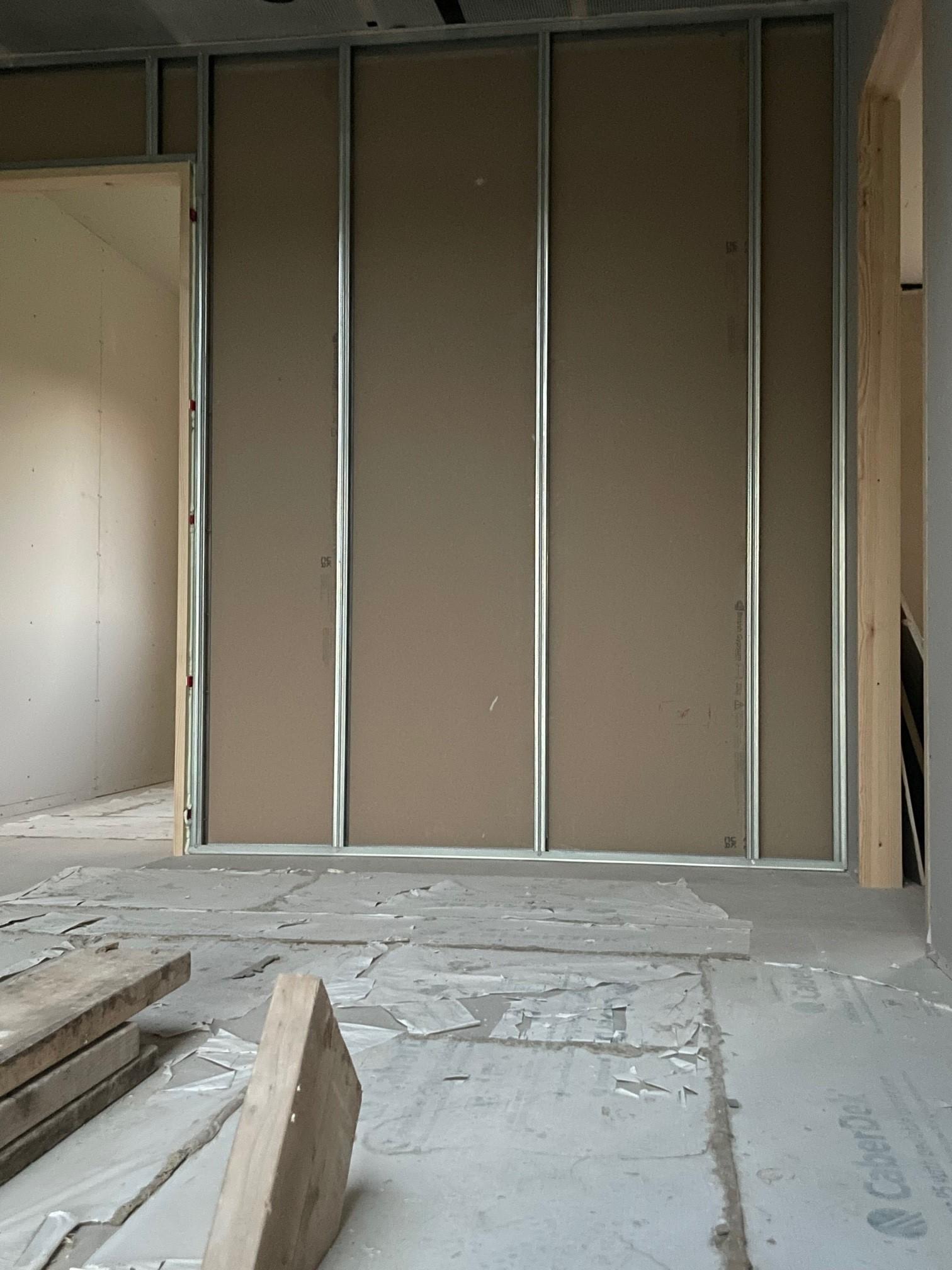

richo106 Posted August 16, 2023 Posted August 16, 2023 (edited) Hi All A very random question, I have started my first fix wiring. On my stud walls I have plasterboarded one side to allow me to wire, on the walls that haven't been boarded yet I need to get the cables in rough position. What is the best way to fix them to the inside of the stud wall so I can reach them when I cut my back box hole out? I should be ok for the sockets but switches/thermostats I need to fix the cables higher up the wall I know its a daft question but this will help me alot with my wiring I've attached a picture of my stud Many Thanks Edited August 16, 2023 by richo106
TonyT Posted August 16, 2023 Posted August 16, 2023 You get an adjustable metal bracket for fitting boxes too. https://www.tlc-direct.co.uk/Products/FXTWB16.html?source=adwords&ad_position=&ad_id=&placement=&kw=&network=x&matchtype=&ad_type=pla&product_id=FXTWB16&product_partition_id=&campaign=shopping&version=finalurl_v3&gclid=CjwKCAjw5_GmBhBIEiwA5QSMxNrsYt_g9-icT7e-CgMKXXdnRRINr4jPr9oSlZHA1uHPAqvj_ERA6hoCFB0QAvD_BwE you can also screw timbers in if you want
richo106 Posted August 16, 2023 Author Posted August 16, 2023 24 minutes ago, TonyT said: You get an adjustable metal bracket for fitting boxes too. https://www.tlc-direct.co.uk/Products/FXTWB16.html?source=adwords&ad_position=&ad_id=&placement=&kw=&network=x&matchtype=&ad_type=pla&product_id=FXTWB16&product_partition_id=&campaign=shopping&version=finalurl_v3&gclid=CjwKCAjw5_GmBhBIEiwA5QSMxNrsYt_g9-icT7e-CgMKXXdnRRINr4jPr9oSlZHA1uHPAqvj_ERA6hoCFB0QAvD_BwE you can also screw timbers in if you want Thank you @TonyT I can use the plasterboard/fast fix boxes on the sides that are already boarded and these on the open ones Many Thanks
ProDave Posted August 16, 2023 Posted August 16, 2023 Safe zones dictate cables either drop down (or up) in line with the accessory, or run horizontally. Either way it is easy to arrange temporary support for a cable so it is there waiting when you cut the hole for the box. When doing my own jobs, i cut the back box hole for the accessory before fitting the sheet of plasterboard which makes it even easier.

TonyT Posted August 16, 2023 Posted August 16, 2023 Not a fan of plastic fast fix dry lining box on new builds. you have access to the stud so I would put a 35mm deep knock out box in.. just me though
ProDave Posted August 16, 2023 Posted August 16, 2023 19 minutes ago, TonyT said: Not a fan of plastic fast fix dry lining box on new builds. you have access to the stud so I would put a 35mm deep knock out box in.. just me though Clearly you have never tried Appleby dry lining boxes? I dislike fitting back boxes on studs, then having the fun of cutting out the hole in the PB to match, then finding you would have liked it in a slightly different place etc. But very much personal choice. Anything in a stud wall is way better than cables chased into a solid brick wall. So glad not to be doing that any more.
TonyT Posted August 16, 2023 Posted August 16, 2023 Yep, tried them all. if there is the opportunity to add a dwang/noggin, it should be done and a metal box fitted as far as I’m concerned. flat plate accessories look better flat to the wall….
Mattg4321 Posted August 16, 2023 Posted August 16, 2023 Dry lining boxes look ok if the wall is to be skimmed and they are fitted beforehand so they finish flush to the surface. only downside to this is that sometimes when second fixing you can break off pieces of the multi finish, which then needs repairing. If it’s a taped finish or after the wall has been skimmed then that to me is an unsatisfactory finish as the box sits proud. If I have to use dry lining boxes then Appleby are probably the best, unless it’s double boarded, in which case they don’t work. Knockout boxes on noggings is the correct way of doing it in my opinion. You can detail PIR board around them better if necessary too imo.

crispy_wafer Posted August 18, 2023 Posted August 18, 2023 On 16/08/2023 at 15:04, TonyT said: You get an adjustable metal bracket for fitting boxes too. https://www.tlc-direct.co.uk/Products/FXTWB16.html?source=adwords&ad_position=&ad_id=&placement=&kw=&network=x&matchtype=&ad_type=pla&product_id=FXTWB16&product_partition_id=&campaign=shopping&version=finalurl_v3&gclid=CjwKCAjw5_GmBhBIEiwA5QSMxNrsYt_g9-icT7e-CgMKXXdnRRINr4jPr9oSlZHA1uHPAqvj_ERA6hoCFB0QAvD_BwE you can also screw timbers in if you want just had a look at these, what a great idea! Thanks for posting, its the sort of thing us mere mortals don't know existed till now, just like C stud infill timbers for doorframes. A question to the boarding gurus, you see things like waferhead screws on metal frame, and possibly the metal tabs on these brackets are likely to sit proud of the frame a little bit, is this likely to be a problem for plasterboarding, and finishing or not really, and this can be tolerated?
Dave Jones Posted August 18, 2023 Posted August 18, 2023 On 16/08/2023 at 15:04, TonyT said: You get an adjustable metal bracket for fitting boxes too. https://www.tlc-direct.co.uk/Products/FXTWB16.html?source=adwords&ad_position=&ad_id=&placement=&kw=&network=x&matchtype=&ad_type=pla&product_id=FXTWB16&product_partition_id=&campaign=shopping&version=finalurl_v3&gclid=CjwKCAjw5_GmBhBIEiwA5QSMxNrsYt_g9-icT7e-CgMKXXdnRRINr4jPr9oSlZHA1uHPAqvj_ERA6hoCFB0QAvD_BwE you can also screw timbers in if you want those metal boxes are crap, no strength to them at all. noggin wont move, ever.
