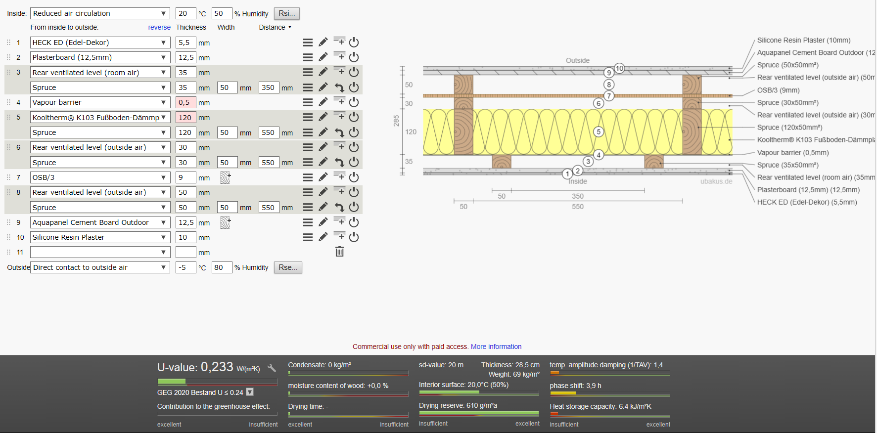

Ah bugger..................... Another Architect who has been taken out for lunch by the Kingspan salesman, shoved a little book with nice copy and paste details and told " this will solve all your problems".
They've left you with an expensive option and a non compliant U value ( unless you magically stop all air infiltration and convection inside the unventilated layers of air in the wall build-up).
I've written another post on this.
 Here's a quick calculation of the wall as proposed. It'll be worse in reality as the Kooltherm boards will certainly not be sealed 100% to the timbers and you'll get thermal looping (moving air inside the wall). They're very thin also at 285mm.
Architects tend to be very good at concept, usability and balance of designs but alas many fall down on the practicalities of actually building a house. I know this isn't what you want to hear but I'd be tempted to fix the design into something better on paper now before going any further down the building route.
Go for thicker walls and make sure all the structure is covered by a pitched roof, balcony included. Get rid of the parapet walls and the bay window. They're going to leak water and air and heat long term. Ensure that no element of the house cannot be easily brought in on a flatbed trailer and can be lifted into place without any large equipment.
Sorry if I'm being a killjoy but it annoys me to see professionals being so careless with their customers money. Do you have planning permission yet?

That is pretty much what we have done. We are adding an insulating layer on the inside to achieve current  standards, and it will also reduce temperature fluctuations in the service void.
We have modified our wall cavity design to be 50% pir and 50%  (ish) mineral wool. Practical and more likely to perform as intended.
I've not seen a technical assessment on thermal looping in this situation. I know it is an issue in windows and especially skylights.
In this situation I'm not immediately concerned , but happy to  be enlightened.

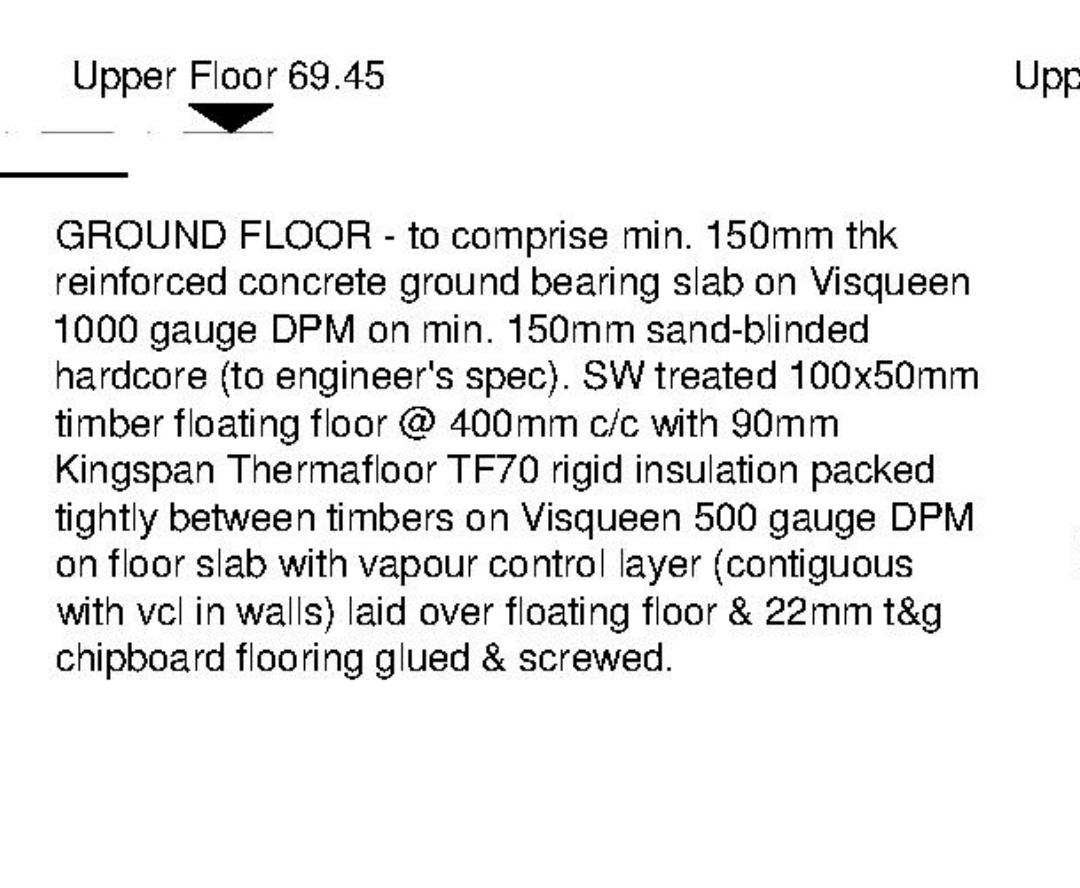

I see from the ground floor construction that you will be running 5 tonne forklifts. You might want to tell your people to try harder, or are they subsidising it?
90mm pir (kingspan again) is not nearly enough. Plus the floor is the easiest area to insulate so more here can offset the walls as they are.
some confusing description of the floor, but seems upside down.
then over the industrial slab you have a batten support system and then chipboard.
I feel I have missed something. Either that or it is a good time to change designer.

seriously about the slab. 150mm reinforced concrete is an industrial slab for forklifts and racking. Then you have have battens and chipboard?????
