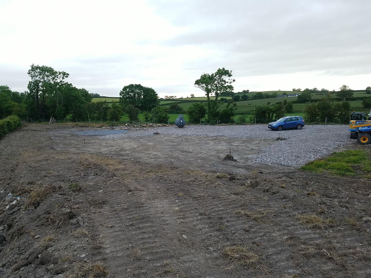

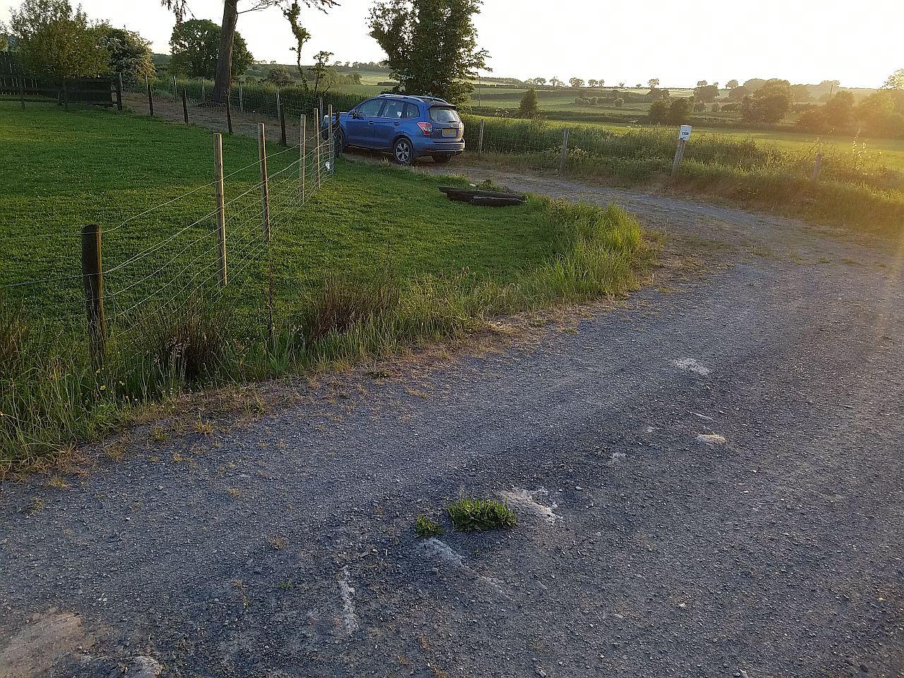

dpmiller Posted June 5, 2018 Author Posted June 5, 2018 So watching the lorry negotiate the corner from lane to driveway last week made me pause. Then a chat with our nice new neighbour, and following that an hour's work tonight. Result? a few quid for posts and much more room to turn. Excellent. 2

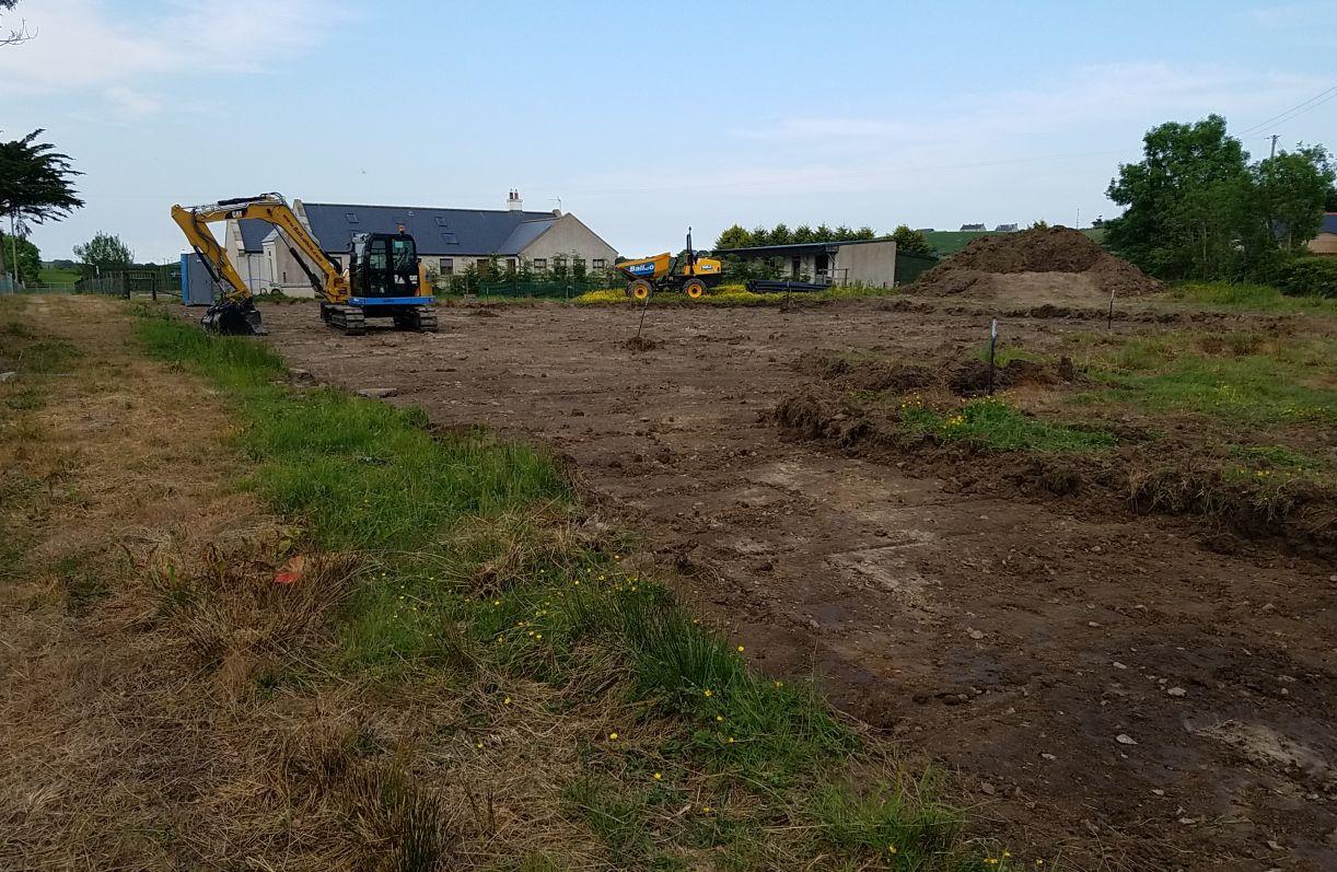

dpmiller Posted June 8, 2018 Author Posted June 8, 2018 Progress! Topsoil stripped off most of the site today, and much of it good to reuse. Full plans have gone in to BC so as son as TF guy confirms our baseworks drawings, we're good to dig footings. In the meantime there's land drain to do and crushed rubble to lay. 2

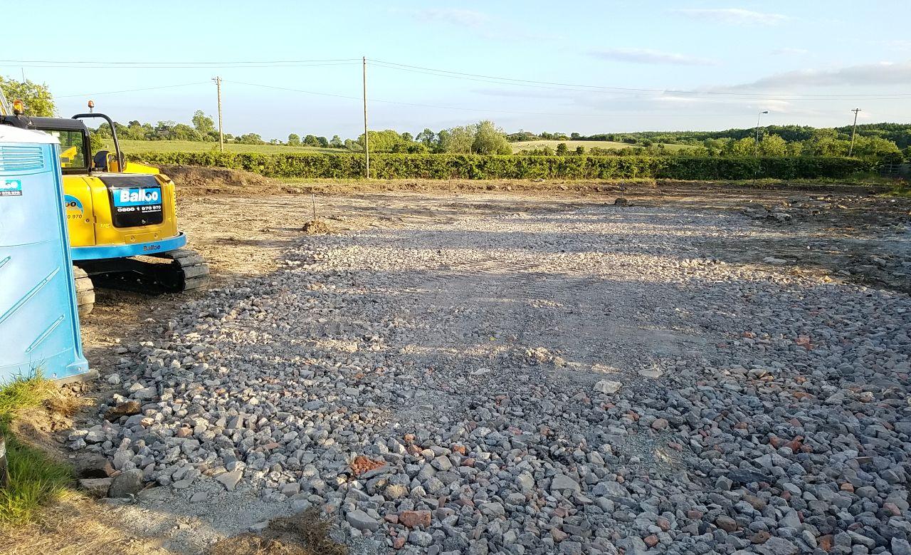

dpmiller Posted June 11, 2018 Author Posted June 11, 2018 Paul's been a busy boy. All the stripping is complete, a couple of loads of crushed are down (probably another three or four to go) so we'll have dry standing all round the footprint soon and for re-use later. £6/t with a cert, nice. Account opened with local quarry, just waiting on final prices. Rock hammer on standby at the Hire depot. What else is on the week's list then? Land drains to go in, big hole to dig for the treatment plant. Water pipe joint to bury in neighbouring field. Treatment plant to be ordered tomorrow, delivery before the weekend apparently. Oh, but any or all of that can wait if the base drawings arrive from the TF co. 1
dpmiller Posted June 13, 2018 Author Posted June 13, 2018 Now things are getting a bit busy. Quarry (Northstone) came though with prices for stone, blocks, and concrete, and very good they are too. NIE have finally quoted for the electric, and it's pretty palatable even. Treatment plant is en-route from Cork. Rubble all in place now. Paul is currently contentedly cleaning the back drain, dropping twinwall in and stoning over. Dunno if he'll get started on the other drain today or not. Had a call form BC yesterday to confirm address details and warning me they'd be requesting a breakdown of the cost estimate. Hmm. Why does it feel like they want to up their profits?

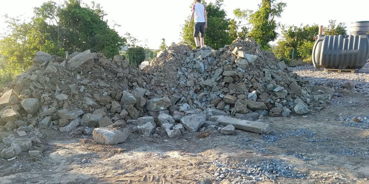

dpmiller Posted June 22, 2018 Author Posted June 22, 2018 Base drawings are in (finally!) so marking out and digging begins on Monday. In the meantime, here's the view from the top of the world (ok, topsoil bing...). 3

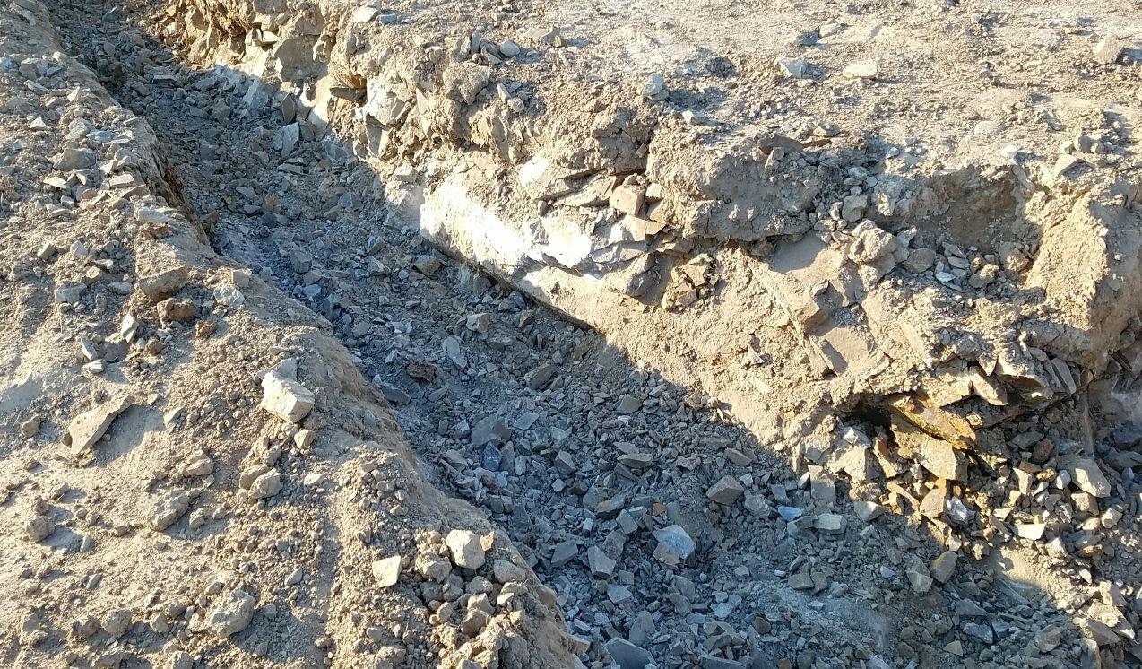

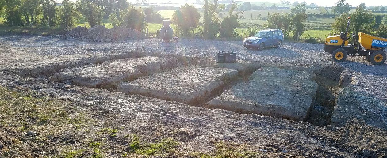

dpmiller Posted June 27, 2018 Author Posted June 27, 2018 (edited) And a few days of toil later, we have trenches. Yesterday morning started with us marking out, and then Paul decided which corner to start from. First time the bucket hit the ground, it found rock. The hammer (that has been booked for a fortnight) wasn't yet available- brand new digger, brand new hammer for it hadn't arrived. So he tentatively tried a different area with more luck and got a fair bit done; the hammer arrived thismorning. So now: Thankfully, that's all the spoil we have so far, a mix of a hardish grey basalt and a brown/blue mudstone shale. A lot has backfilled the back drain- and gained a tidy area in the process. Trenches just to tidy in the morning, BCO to inspect, then lay mesh and pour. Edited June 27, 2018 by dpmiller
