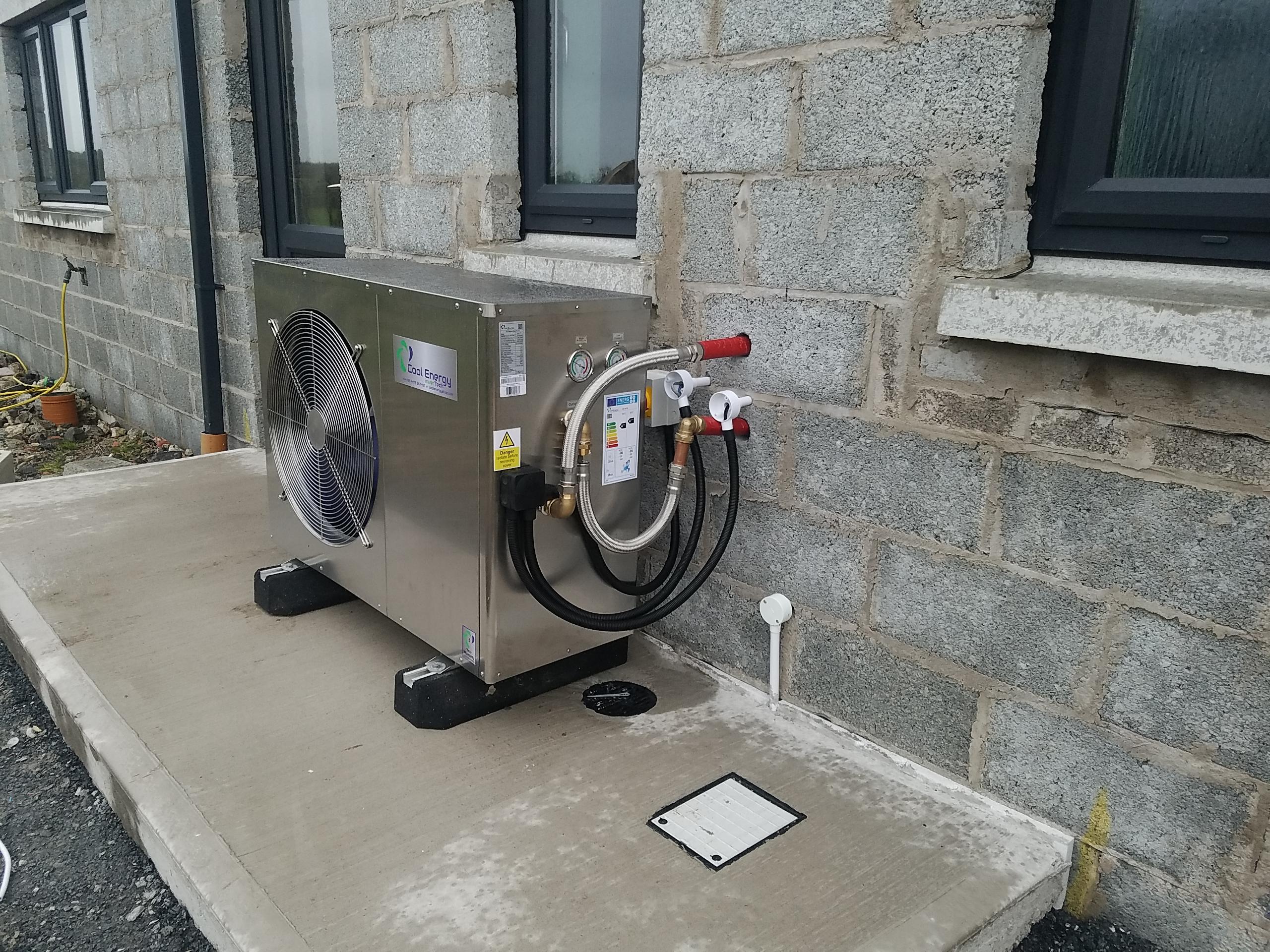

dpmiller Posted February 1, 2021 Author Posted February 1, 2021 @Declan52 It's a 270l tank, there's piccies upthread a bit. It was quoted as a very high recovery coil and that seems to be the case alright I'll get a photo of the unit installed later, but it's still a bit lashed-in for now, insulation to finish and the unit levelled etc. 1

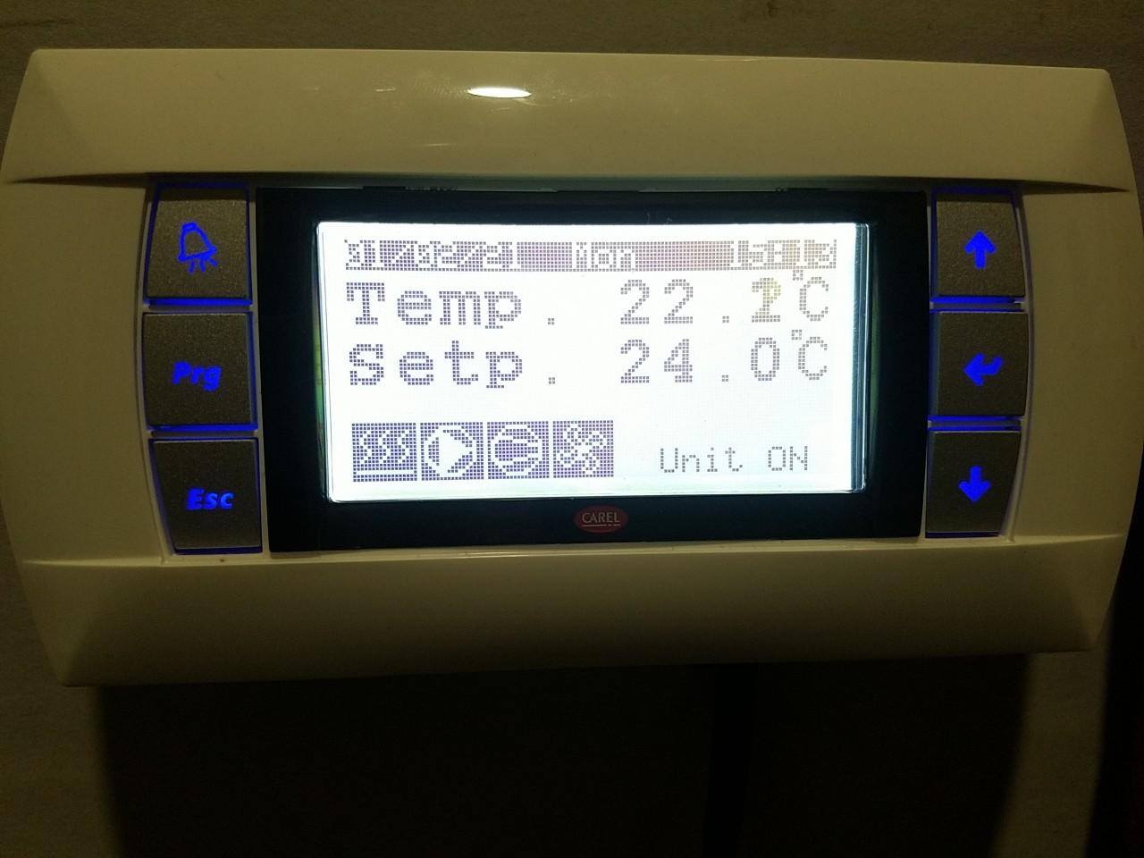

dpmiller Posted February 4, 2021 Author Posted February 4, 2021 a few days in and the screed is pushing out a shedload of water again, MVHR has gone into humidity override. Consumption is about 40kWh/day, slab at 22c/ GF 19c/ unheated FF bedrooms 17c. I'm currently running in series/buffer mode, so heatpump flow is going through the TS before heading to the UFH mixer, I've got the heating/buffer sensor strapped to the return pipe after the UFH and bypass, and the ASHP is controlling on that. Flow and TS are both 37c at a setpoint of 30c

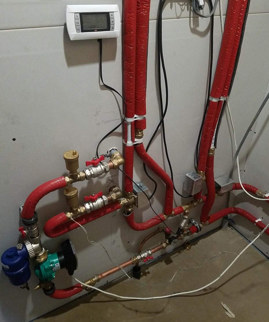

Declan52 Posted February 4, 2021 Posted February 4, 2021 So all you have is the flow and return to your thermal store, mains power from the switch on the outside wall and the 2 other cables. What are they for???
dpmiller Posted February 4, 2021 Author Posted February 4, 2021 the unit has an rj12 cable to go to the controller, plus two sensors- one for the hot tank and one for the buffer/ heating. You can run it like this using it's controller for time and DHW/flow temperature control, it needs nothing more. but... There are dry contact inputs for heat/ DHW/ cooling, and available outputs for aux pump, motor valves, immersion backup. I just pulled in a mains-rated multicore and a screened Cat5 to cover all eventualities; for now that's a pair of the cat5 to extend the sensor up to the tank, and in future two switch wires for heat demand and cooling. One thing I've noticed is that it's quite flow-sensitive. While the flowswitch will let the unit run quite happily at modest flow rates (flowsetter is stuck in Hermes somewhere, boo) the system will throttle the output to keep the flow delta under 10c. Raise the flow, and the power increases too...
dpmiller Posted March 31, 2021 Author Posted March 31, 2021 So, this heat pump thingy... One of the advantages of getting all the kit up and running is being able to monitor and if necessary reconsider things. And so after a couple of weeks running we came to the conclusion that the two bigger upstairs bedrooms- both North facing- did need radiators after all. Pipes were already laid in so a quick trip to Screwys for a pair of 600x1200 double convectors and... done. I raised the flow temperature from the ASHP to get meaningful heat and paradoxically this has improved economy. I'll probably need to explain that bit. So I'm trying to be all things to all men without using any fancy control strategies. Flow from the heatpump passes through the TS at all times. But when there are no demands the TS coil is gated/bypassed, to stem any convective losses. Return from the TS is available to both the UFH and rad manifolds. If neither of them demand, an autobypass ensures there's still flow. All the pumps stats and zone valves are on a separate RCBO to the ASHP so that in emergency/power outage the heating system can run off the TS- heated by the boiler stove. The ASHP controls on DHW tank temp, and also on buffer/ return temp. It has programmable hysteresis and overshoot for each. The upside of this and fitting the rads? Flow from the ASHP is naturally higher than return so more energy into the bottom of the TS. The ASHP setpoint is 32c (return) but the flow could be up to about 40c to get it there. Hence the TS now has enough energy in it to impart heat to the house. Nice. And the extra heat in the two upstairs beds means no cool air falling into the hall. Even nicer. TLDR: That extra energy means that the TS actually buffers, so the HP is running less and longer. Whole house is at an indicated 19c but the slab heat makes it feel much warmer. Almost too warm already... and that's at a consistent 10kWh/overcast day and cool night. Clear sun is already getting the top of the tank up to 75-85c on the diverter and on days like the the ASHP consumption is down at around 5kWh. And I've finally got the monitoring software set up for the PV. Yay! Took a while but we got there... 3

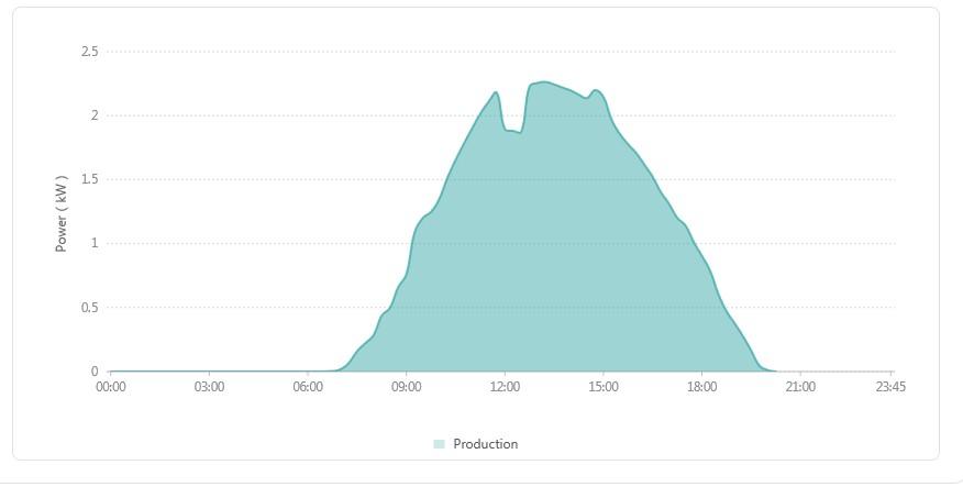

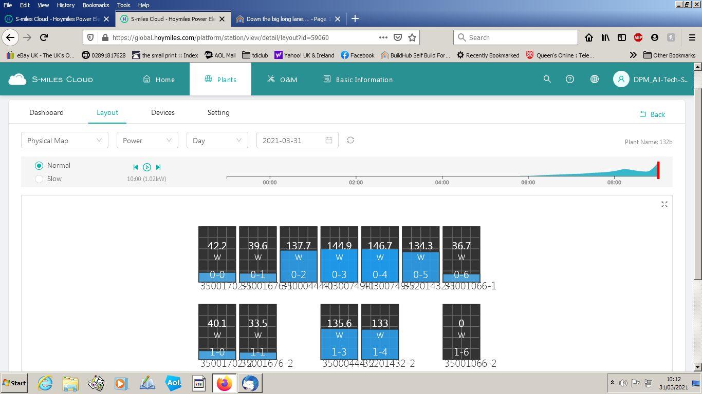

dpmiller Posted April 2, 2021 Author Posted April 2, 2021 so the East-West panel split seems to be working well. With apologies for the dip around noon, I've been having problems getting the DTU to receive from all the inverters happily. But I think I've found the sweet spot now...
Conor Posted April 2, 2021 Posted April 2, 2021 What's your panel setup? I'm going for 50% south, 25% east and 25% west.
dpmiller Posted April 2, 2021 Author Posted April 2, 2021 6 are SE, 6 SW, and one of those is shaded by a chimney which is the dip at 3pm. Plus sticky-out gables get in the way a bit too. But still, it's production the whole way from sunrise to sunset.
