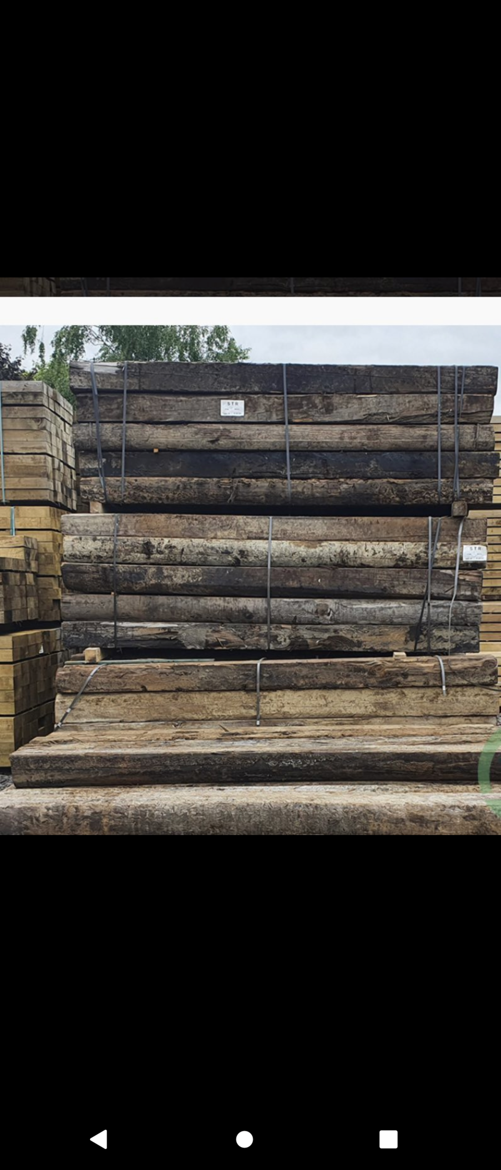

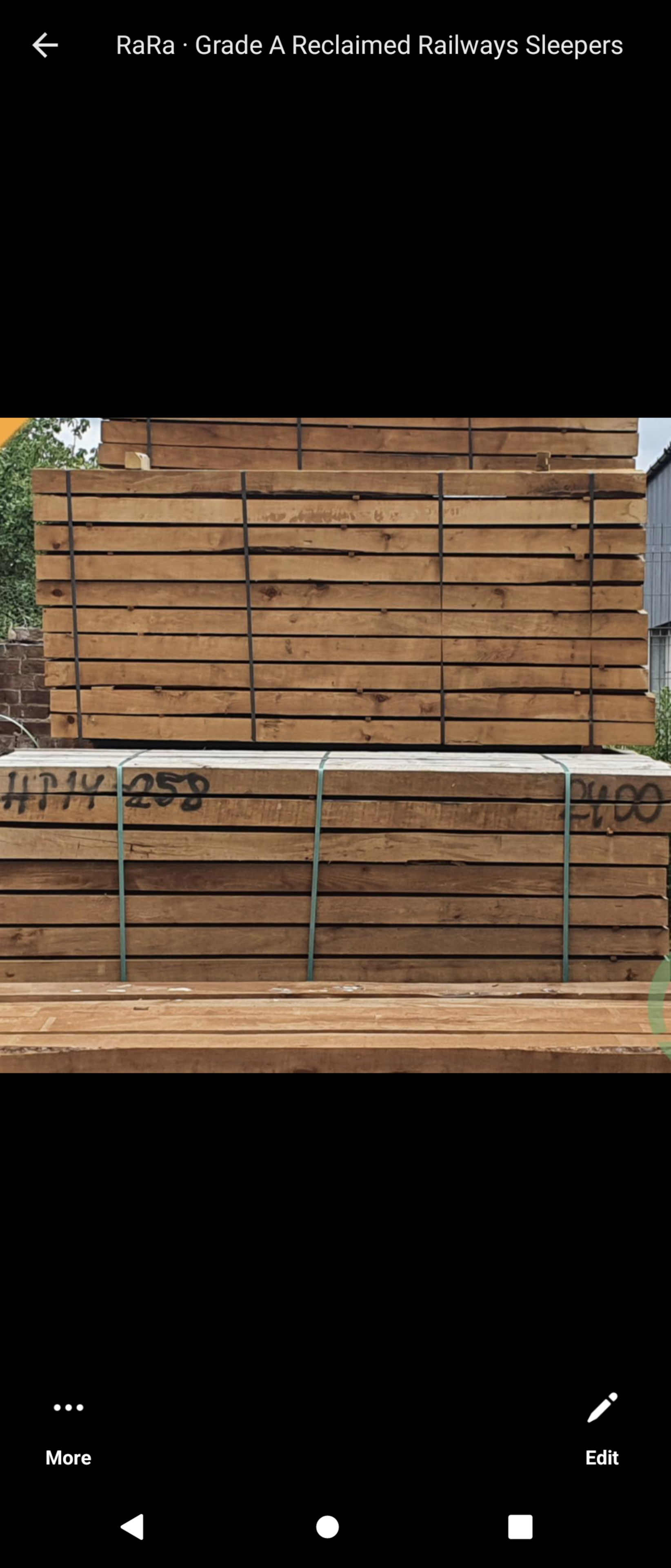

Fab, we actually have some on the old railway sleepers on the embankment where our motorway crash barriers are. I suspect from the old railway that was dismantled in the 60s and the fact they are still there and intact (but partly buried in places) makes me tempted to go with the reclaimed ones.
The place we have seen them have sent pics of reclaimed and hardwood.
