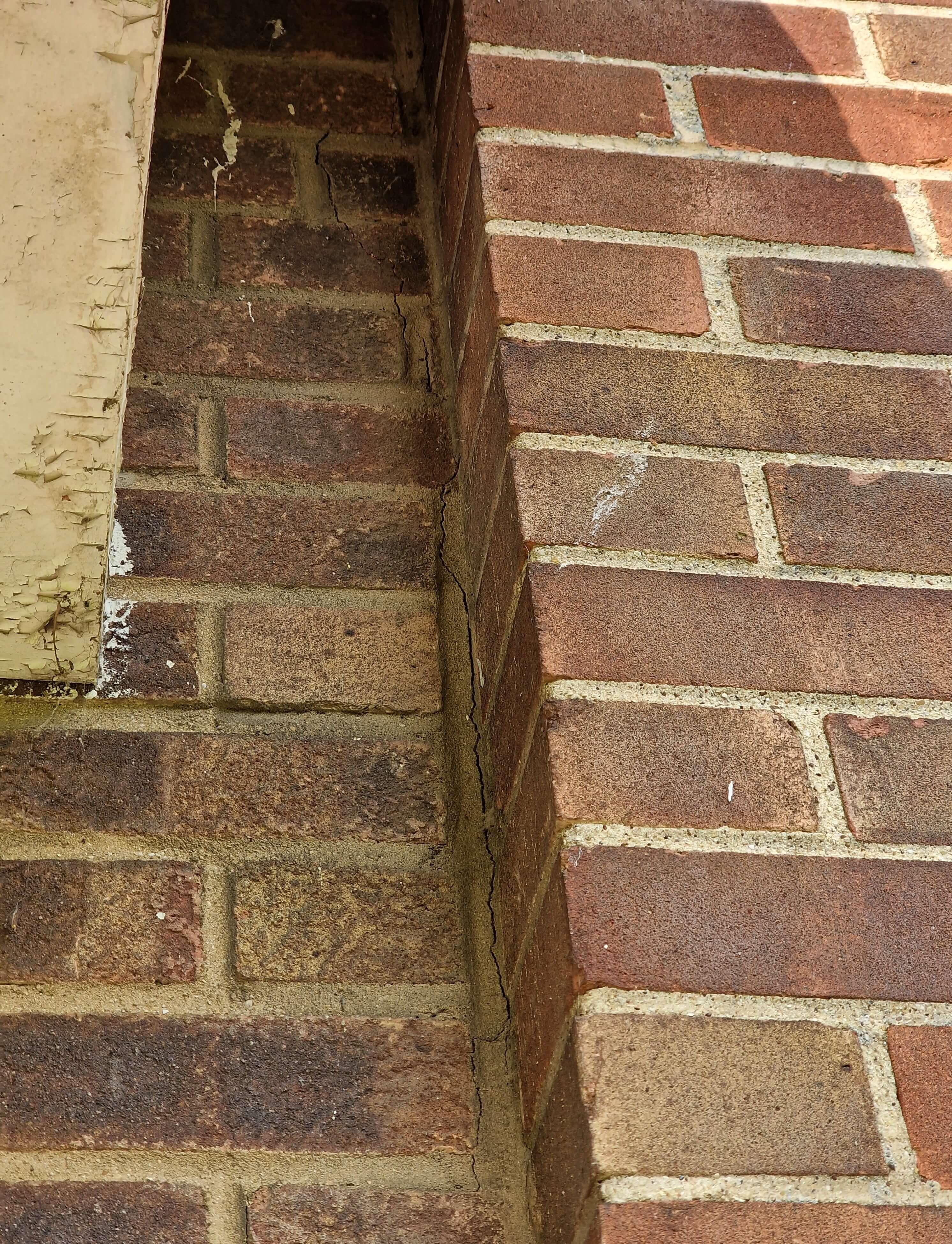

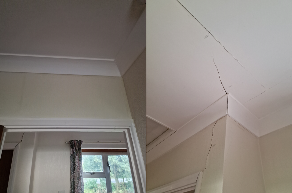

George Posted July 10, 2023 Share Posted July 10, 2023 (edited) Lets see these cracks. Cracks on old buildings is not unusual - it could well take a decade to settle down completely but crack stitching + underpinning might just mean more cracking. I try and reserve underpinning for actual subsidence (loss of soil support due to washout etc) or undermining/basement work. Tackling ground movement with underpinning is a sledgehammer to crack a nut. I'd certainly undertake the following prior to doing anything drastic: - trial pits to determine actual foundation arrangement - a programme of crack monitoring for at least 6 months, ideally 12, to determine whether it is seasonal movement or not - ground investigation to get accurate information on soil type, plasticity and water level Underpinning is a substantial upheaval to a building, let alone cost, and a few thousand on investigation work is well worth it. Slightly surprised the structural engineers didn't suggest this. Edit - good suggestion regarding wall ties. This would normally effect the outer leaf but it would not be unknown for inner leaf corrosion to be noticed first, especially if the outer leaf had been repointed in (relatively) recent history. Edited July 10, 2023 by George 2 Link to comment Share on other sites More sharing options...
Mike Posted July 12, 2023 Share Posted July 12, 2023 On 10/07/2023 at 23:19, George said: Underpinning is a substantial upheaval to a building, let alone cost, and a few thousand on investigation work is well worth it. Agreed; the underpinning needs to be designed to suit the specific building and circumstances. On 10/07/2023 at 23:19, George said: Slightly surprised the structural engineers didn't suggest this. Presumably just a pre-purchase visual inspection? Link to comment Share on other sites More sharing options...

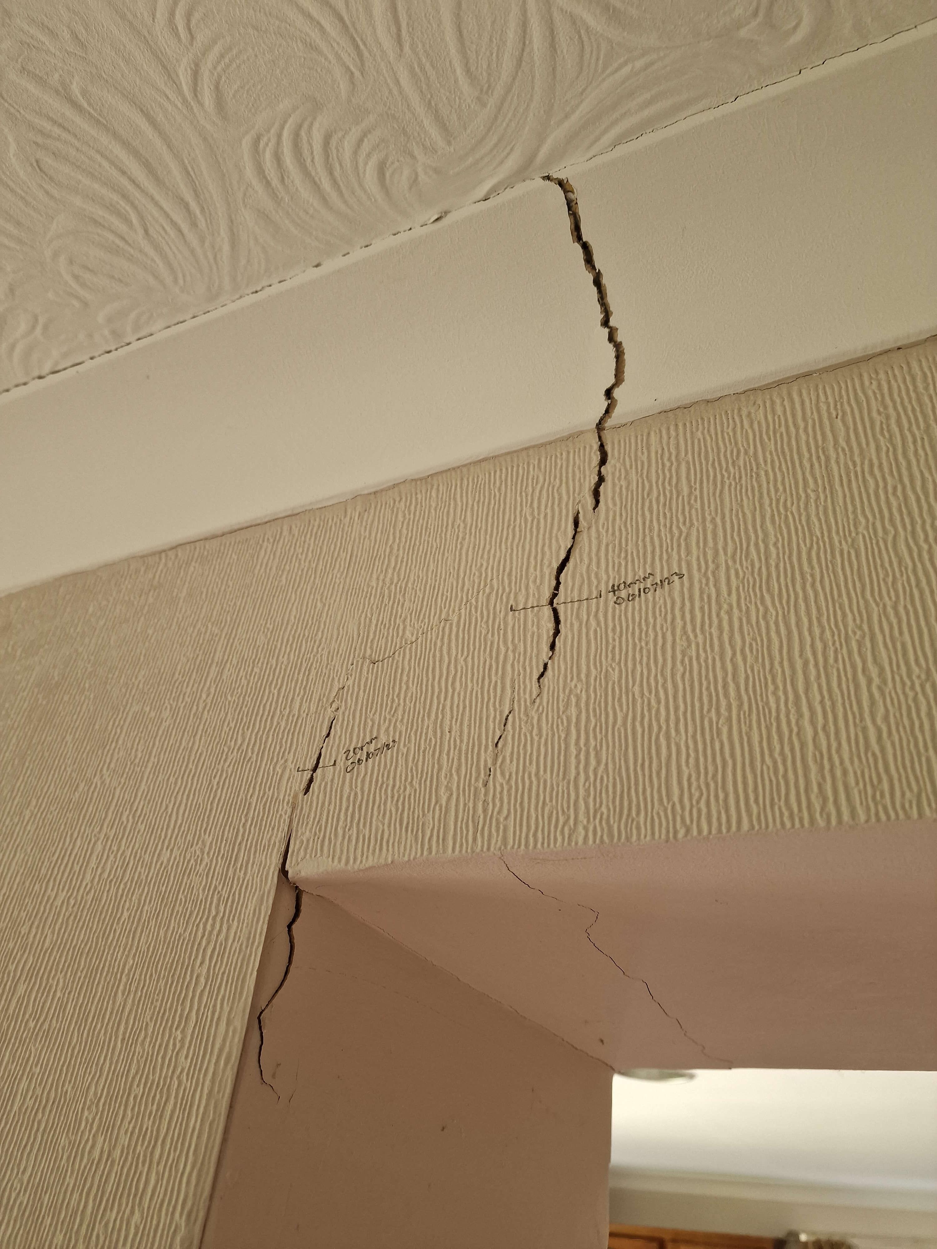

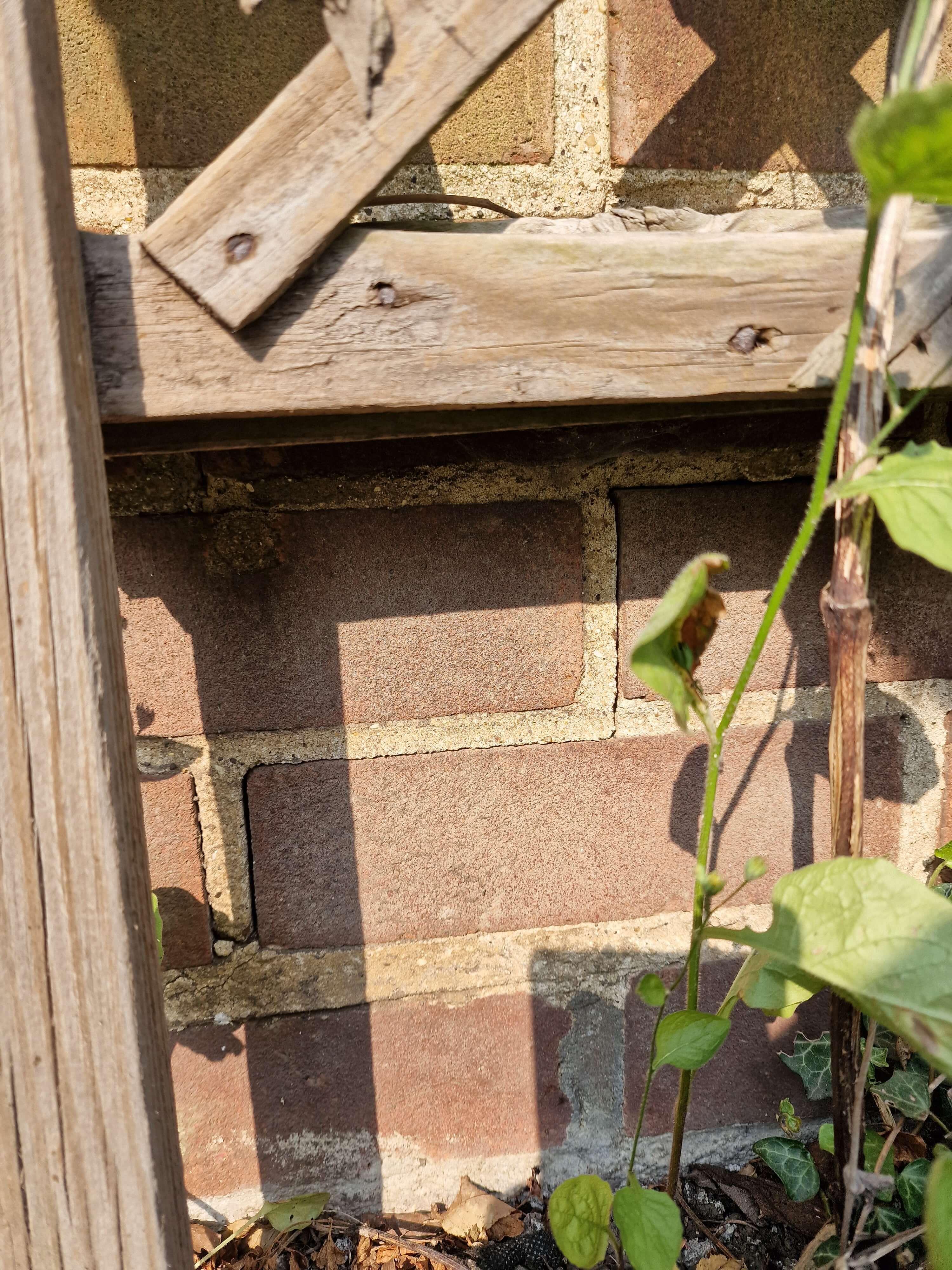

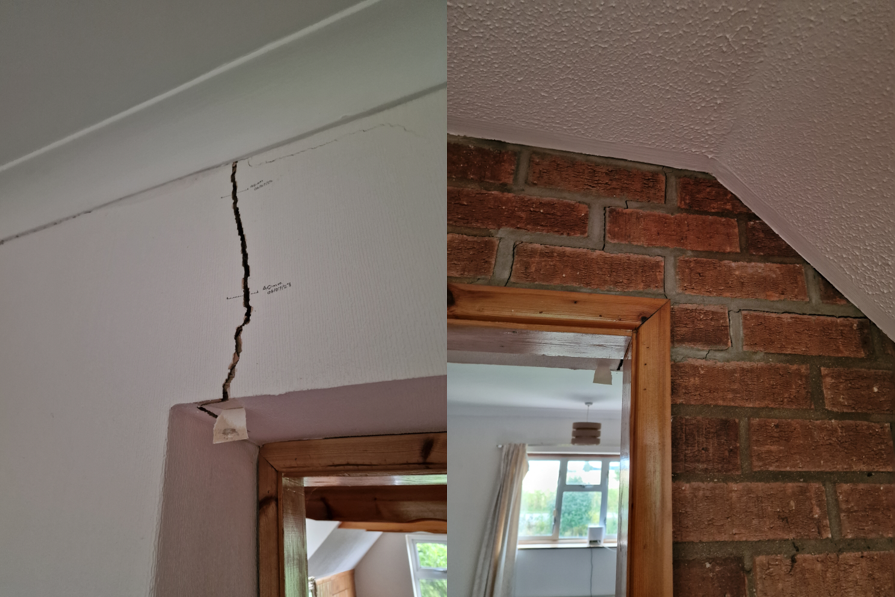

alfaTom Posted July 13, 2023 Author Share Posted July 13, 2023 On 10/07/2023 at 23:19, George said: Lets see these cracks. Ok - as requested pictures below. Internal cracking looks to be worse than external. I've yet to have wallpaper/plaster off to check behind as had been waiting for a specialist to see it before I hack the plaster away. Above is cracking on the doorway between old house and the extension. Below is the external join. This one is towards the bottom of the property in the front left corner of the property where there seems to be the most drop. It's also next to a gutter downpipe where the soakaway has failed. There are other cracks throughout the house that generally suggest the house has sunk along the front aspect. As mentioned previously the structural engineer said he did not feel the roof was being stressed too much and the only reason he'd say it was suffering from ongoing movement was due to the fact the internal cracks had not been covered. We've had TPs and SIs done as well as drainage surveys and I had the info through today, although I am not yet fully understanding of the info. The soil lab results for TP1 (which was completed close to the extension join) is below: There is other data for me to go through, or if people wish for me to upload it I can look to do so, but didn't want to dump it all on you. @Mike the initial structural engineer visit was just a GSI for the whole property, although this was from a proper MIStructE fella. I had to clear out the drains yesterday as they had become blocked from debris, that plus some misaligned drain pipes and the failed soakaways would suggest some soil washout in addition to the previous desiccation via nearby trees. As you'll note from the first image I've started a basic monitoring across some of the cracks, although I do not believe they have gotten worse over the past 6 months. I wouldn't be too concerned about external cracks along mortar lines as we have had some very hot weather to allow for some seasonal changes, but I am less keen on the cracked brickwork and the internal cracks. The ground slab has also dropped and sloped towards the corner referenced from picture 3, but I've not investigated it yet to know the composition below. I will have to look into some cavity wall tie investigation work as that is a good shout. I know the house was originally built by the owner, and the construction itself does seem to be pretty good (some good detailing around the joist pockets on internal walls and not loads of crud left under floors etc), but I guess they didn't foresee the tree/ground issues. Link to comment Share on other sites More sharing options...
twice round the block Posted July 13, 2023 Share Posted July 13, 2023 (edited) The cracks above the doorway don't look that bad. Hack off the plaster and see what lintel is over the opening. Cut out a couple of bricks where the extension meets the original build and see if it's tied in properly. I would say it's tied in with some frame fixings or similar to the original part of the house. Lift up the carpets at the front of the property if that's where you think it has dropped and see if there is a gap between the bottom of the skirting and the floorboards. Do a ball test on it and see if the ball rolls down hill, towards the skirting. Samples from the bore holes don't look too bad, little bit of sand and gravel but not excessive. When the property was built by it's owner the building regulations we're poles apart from where they are now. so tieing in the extension with galvanised frame fixings every 6 course's, and thin prestressed concrete lintels over doorways we're passable then especially with lax planning departments. Edited July 13, 2023 by twice round the block Link to comment Share on other sites More sharing options...

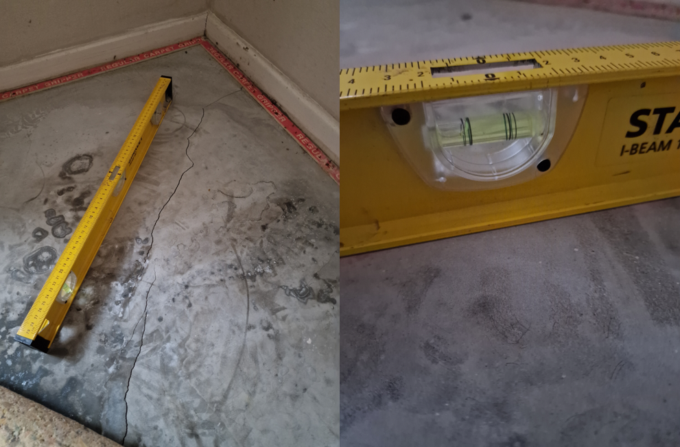

alfaTom Posted July 13, 2023 Author Share Posted July 13, 2023 Will make that a weekend job to do a bit of discovery, cheers for the suggestion. It's definitely dropped as there is a significant slope. A lot of the floors in the house are uneven, but the plan was always to have them up and insulate + UFH so as long as the underlying (no pun intended) problem is resolved we should be ok. A few more pictures of other sections: This is above the doorway crack, as you can see the plaster side has cracked a bit more dramatically than the side without plaster. You can also see where some remedial work has been done in the past. This is the upstairs landing where it has cracked from the doorway in the front bedroom (right image). This crack runs along the ceiling to the bathroom door, but as can be seen in the left image there is no cracking visible from this side: Finally; the downstairs dining room floor. Whilst the floor meets the skirting still, there is a fair decline to the corner. This is the corner referenced in the outside picture of my previous post. I'll be moving the large rose bush at the weekend from it and clearing the rest of the vegetation around it to see what state the ground/drainage is in. I may also try to cut out a section of the ground slab to see what the construction is like beneath it. We always expected to redo the interior walls/floors/ceilings, but we just want to make sure the movement isn't ongoing before we start work. Link to comment Share on other sites More sharing options...
twice round the block Posted July 13, 2023 Share Posted July 13, 2023 Because your house was a self build by the previous owner, you don't know what his skill set was, or if he had any. Looks like the ceiling boards didn't have scrim joints to open like that. Yet another crack above a doorway with an unknown type of lintel. Did you ever get a price from a kit house company so you know where you're maximum renovation budget should be? Gutting this house and renovating it could cost nearly as much as a well insulated, modern new build. Fact. it is faster to demolish a property and build new than it is to renovate an existing one. Link to comment Share on other sites More sharing options...

Mike Posted July 14, 2023 Share Posted July 14, 2023 5 hours ago, alfaTom said: A lot of the floors in the house are uneven, but the plan was always to have them up and insulate + UFH Underpinning methods vary, but it's very likely that the floor along at least one side of the internal walls, and quite possibly the perimeter of all the ground floors, would have to be broken out anyway in order to undertake the underpinning, so it's a good idea to replace them entirely. You also need to be sure that the new floors aren't going to move; movement in a floor with UFCH pipes embedded in it could eventually be very problematic. Link to comment Share on other sites More sharing options...
markc Posted July 14, 2023 Share Posted July 14, 2023 You also need to be sure that the new floors aren't going to move; movement in a floor with UFCH pipes embedded in it could eventually be very problematic. this is a very good point and one overlooked too often with renovations and building changes. a guy who works for us recently asked me to take a look at his parents new conservatory that is sinking away from the bungalow. It’s not! The conservatory builder has seen the poor ground and slope so dug very deep footings onto solid ground but the 50’s bungalow is sitting on top of the clay and moves with it, so it’s the bungalow moving and the conservatory staying still. 1 Link to comment Share on other sites More sharing options...

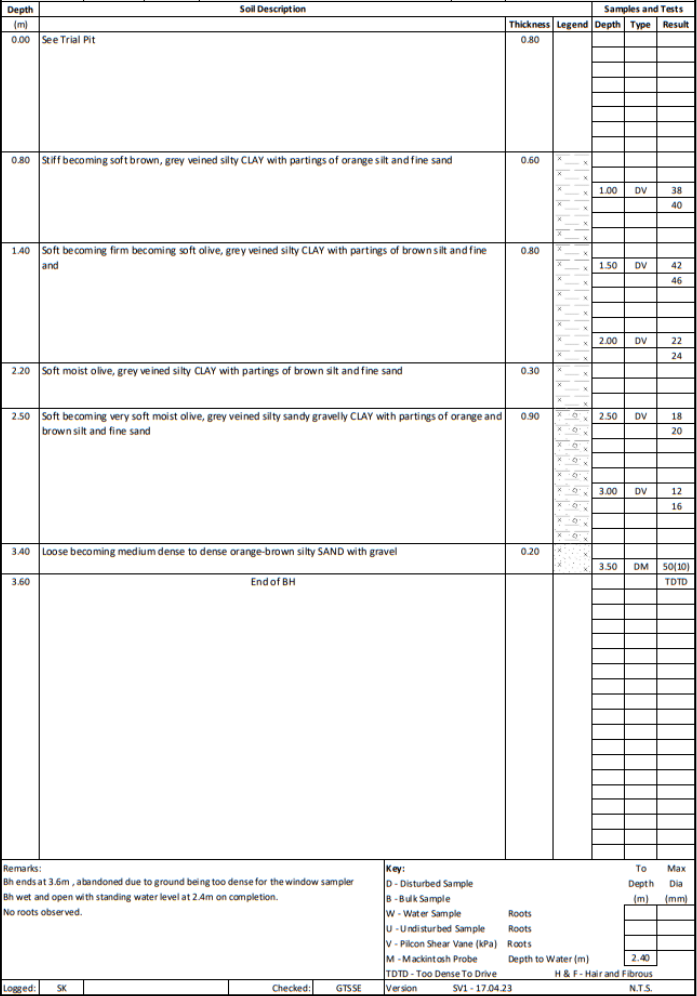

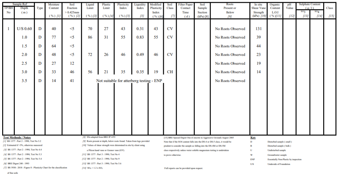

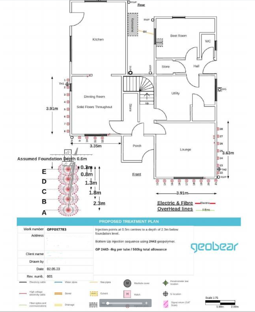

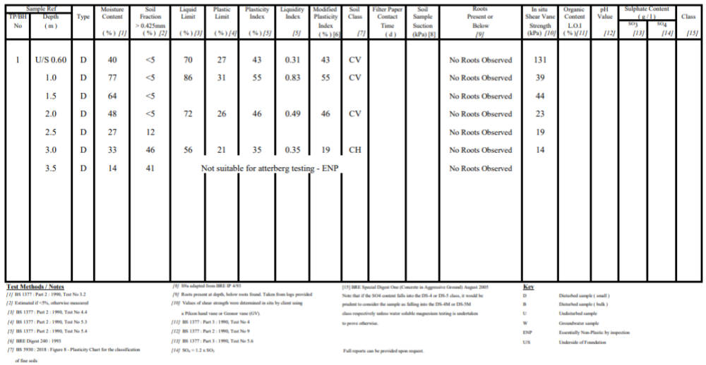

alfaTom Posted July 14, 2023 Author Share Posted July 14, 2023 Lots to unpack here from yesterday and today's replies... First off thanks to all that have responded, it's appreciated and the wealth of knowledge here is astounding. So the previous owner who built it was a builder by trade and he's built a few houses in the village. I know he built the bungalow next door and that has been underpinned with no further movement apparently but no details on the rest. @Gus Potter wow - those are some detailed responses there! To answer your questions: The 2-storey part of the house came first. The 1.5-storey extension came after, believed to be completed late 1970's just before the chap passed away. The underpinning company we have been talking to is Geobear, who do a resin-injection form of underpinning rather than traditional mass concrete. This was after the SE said that the resin injection may help to stabilise the house & lift the ground slab. Below is their suggested works, which involve resin injection across the majority of the front elevation as well as around the gable ends. Total cost works out about £30k inc VAT I honestly did not know about the "upside down" ground aspect and this is something I definitely need to look into more, especially as we'd rather use that cash on other parts of the property if the underpinning is going to cause issues with the rest of the property. The use of shadow gaps and hiding expansion points is a great idea, and one I had already been thinking about when it comes to replacing the front porch. There will be some non-load-bearing walls going as well as some load-bearing walls. We are looking to extend the utility bit into the Store/hall area as shown on the above map and extend out to the west from the dining room (this is a gable end so hopefully not as much load on it) Plans should be back from the architect soon at which point we will be able to have some informed discussions with SE on the best approach for what we are looking to do. There is a chance the foundations for the Kitchen and boot room extensions are not deep enough for a 2-storey build so they'd both have to go which would give us a chance to tie it into the rest of the property in a more sympathetic manner to work with the movement. 51 minutes ago, markc said: a guy who works for us recently asked me to take a look at his parents new conservatory that is sinking away from the bungalow. It’s not! The conservatory builder has seen the poor ground and slope so dug very deep footings onto solid ground but the 50’s bungalow is sitting on top of the clay and moves with it, so it’s the bungalow moving and the conservatory staying still. These stories plus Gus' explanation of the movement are definitely making me think twice about the footings/underpinning aspect. I had thought solid = better but I can see now that perhaps we need a better solution. Whilst the SE originally surmised the ground had dried out to cause the subsidence initially I am not sure if the soil survey backs that. Perhaps some light reading tonight once finished with work! Are there SE's that would specialise in this sort of soil or should all chartered Se's be good for working out the correct loading and understanding of the soil? p.s. Happy Friday! 1 Link to comment Share on other sites More sharing options...
George Posted July 14, 2023 Share Posted July 14, 2023 Quote Whilst the SE originally surmised the ground had dried out to cause the subsidence initially I am not sure if the soil survey backs that. Perhaps some light reading tonight once finished with work! When they say 'dried out' they don't mean literally dry. The water uptake from the tree roots will have reduced the moisture % in the clay soils causing volume change. The soil report doesn't appear to test for plasticity but they are clays and silty clays. Given the area of the country, medium to high plasticity is likely (medium to high volume change). However... from the photos of those cracks, I think underpinning / soil injection will not be high on the list of options. My plan would be - repair drains! Washed out soil will need to be backfilled - trial pits to inspect foundations around the building - to determine the various depths and width of the different parts. Say, one on each elevation - at the join of old & new - monitoring of the cracks externally & internally using crack monitor gauges - hack plaster off and have a look at the internal cracks properly - consider movement joints if there is a step in the building superstructure and or foundation You may still get fine cracking for the lifetime of the building but if I could do all the above for £10k, bank the £20k and just reapply caulk and paint every 5 years I'd be happy. Link to comment Share on other sites More sharing options...
