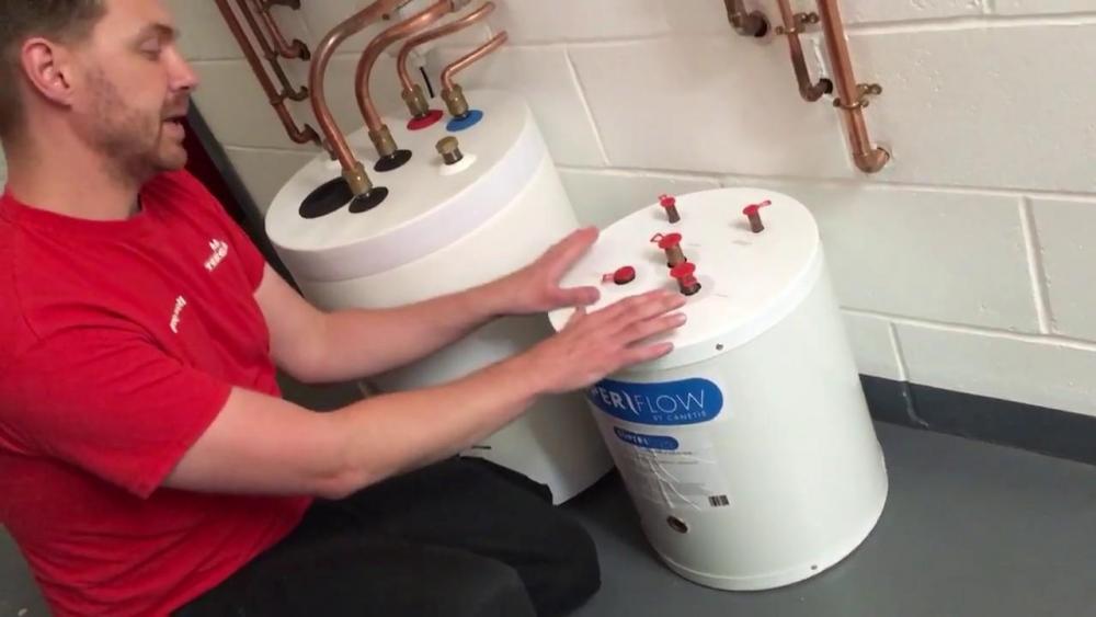

JohnMo Posted October 11, 2023 Share Posted October 11, 2023 26 minutes ago, DazRave said: One thing I hadn't heard of before is using a pre-heater BEFORE a combi boiler. I'm going to have to deep dive into that a bit more for sure. From experience combi pre heat is great. You can get huge flow rates if done correctly. Ideally you have a diverter valve, to bypass the combi if water is hot enough to go direct to the tap, plus you need by pass flow and combi flow to go through a mixing valve to stop excess heat going to the taps. Alpha boilers use them as a factory option, I have an Atag boiler that works well with and is designed to take preheat water - not all boilers will, so don't assume it will be ok. Link to comment Share on other sites More sharing options...
DazRave Posted October 11, 2023 Author Share Posted October 11, 2023 (edited) 13 minutes ago, JohnMo said: From experience combi pre heat is great. You can get huge flow rates if done correctly. Ideally you have a diverter valve, to bypass the combi if water is hot enough to go direct to the tap, plus you need by pass flow and combi flow to go through a mixing valve to stop excess heat going to the taps. Alpha boilers use them as a factory option, I have an Atag boiler that works well with and is designed to take preheat water - not all boilers will, so don't assume it will be ok. Thanks for the heads up. Am I right in thinking a faster water flow will also help with running more than 1 hot tap and/or shower etc at the same time? We have always had this problem but our Boiler is pretty beefy and my gas engineer said it's mainly down to the thin water feed into the property and the fact we're on a hill. EDIT: A quick google search of my Intergas ECO RF 36 combi boiler and it looks like I can pre-heat on them. I'm just not sure if my specific model is accepted yet. Edited October 11, 2023 by DazRave Added boiler Link to comment Share on other sites More sharing options...
JohnMo Posted October 11, 2023 Share Posted October 11, 2023 Basics of my system are a borehole pump feeding an accumulator. So I do get good flow. Pipe from boiler is 15mm to a manifold. Water then goes to each wet room. Could with a bit of fine tuning run 3 showers just. You can flush the loo while in the shower with no affect in the shower. One thing you need to do - remove the flow restrictor at the cold water inlet to the boiler. This restricts flow when it's winter and by default in the summer. Intergas was on my list originally, most Dutch combi boilers seem ok for pre heat. Couple of things to read attached the photo is the preheat cylinder sold by Alpha boilers (25 and 50L). You can add an immersion to the 50L.Canetis-SuperFlow-Product-Sheet-WE-050318.pdfCombi-SuperFlow-White-Paper-v1-2-4.pdf 1 Link to comment Share on other sites More sharing options...

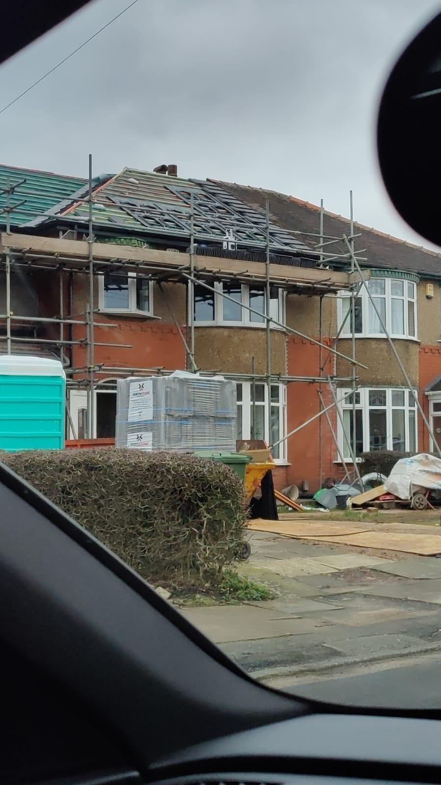

DazRave Posted February 6, 2024 Author Share Posted February 6, 2024 Installation Update So as my previous post had mentioned, I ended up going down the MCS approved route. After starting the installation yesterday then getting hit by heavy rain today, the install team are picking back up next week to finish everything off. I've not actually seen the progress with my own eyes yet as I'm living off site, however I've attached a photo sent to me by my Missus who passed in her car after the first day. So what did I end up with? 8x Black 420w PV panels (mounted 'in-roof') 3.6kW Hybrid invertor 8.2kWh battery Including the paperwork, registering and fitting it cost me just shy of £10k. **Insert Gasp Here** Yeah, I made that noise too. Although we've not finished the installation yet, let me just explain a few reasons why I went down this route and what I'd do if I did it again in the future. In the end I was hit by 2 storms during our build whilst already 2 months behind schedule. To make matters worse the roof installation got pushed along so much that it was split in half by the festive period with absolutely dire weather on top of the storms. My original plan was for my roofer to install the trays and for myself (with my electricians help) to install the panels. My electrician would then crack on with the other parts of the install that are inside the house. The problem is the timelines were all completely knocked out of sync. I didn't have the time to do my part due to work commitments and my electrician isn't due for another week on site. The roof, while exposed and not even felted yet, was then battered in the storms (A bit of wood nearly speared itself through my neighbours car!). So, I was forced to get a company involved which removed the burden from my other tradesmen who were already quite literally under the weather. Would I do it differently? Absolutely. Yes. I've still got a sour taste in my mouth because I'd have been able to save around £3k from my calculations if I was to do it all myself. I'd have then used that money to install a immersion tank to pre-warm water going through my boiler and reduce my gas bills (something I've planned space in for as a future upgrade). It was a tough pill to swallow going down this route but we're nearly there now I suppose! Hopefully these posts help others in the future much like everyone's replies have helped me. If I remember, I'll be back with an update once the system is all up and running to give any final verdicts! 3 Link to comment Share on other sites More sharing options...
