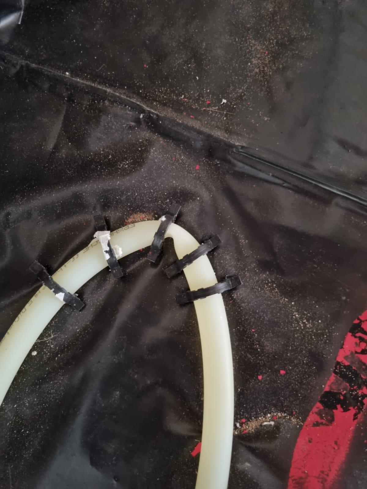

I have started installing my UFH pipes and typically on my longest and most complicated run I put the worlds largest kink in it that I not happy with. It’s only 5m from the manifold
I have read on here that people have repaired there UFH pipes with a straight coupler
Would people take the whole loop out and replace it or replace a small section with a coupler? If so could you recommend any at all? Would plumbers merchants sell them?
It’s for my first floor heating and is the fix from below method on spreader plates

Our plumber did this. With  his permission we removed the kink with vice grips  and eased the pipe hack to a proper curve..
Found a pic.  Obv would have restricted the flow.
The screed was next day, I found this, and another like it.
the plumber wasn't interested in coming out to help. It straughtened nicely* and I trust this more than a splice. The ufh has run for about 3 solid days subsequently so seems OK.
* removed the clips and eased it to a smooth curve. Then crimped the dent back to tube shape . Eased the curve some more then clipped it down.

I did the reforming with the vice grips myself as nobody else had confidence to do so.  I was surprised how well it went back to shape, and with no signs of damage
This photo was of a twist through incompetence I think. The rest was better and could be walked on.

My main concern is that the plumber allowed it...an insufficiently skilled oppo used to lay it, then no inspection. And a lack of concern when  informed.
If undetected, it would have been like a valve almost turned off.
