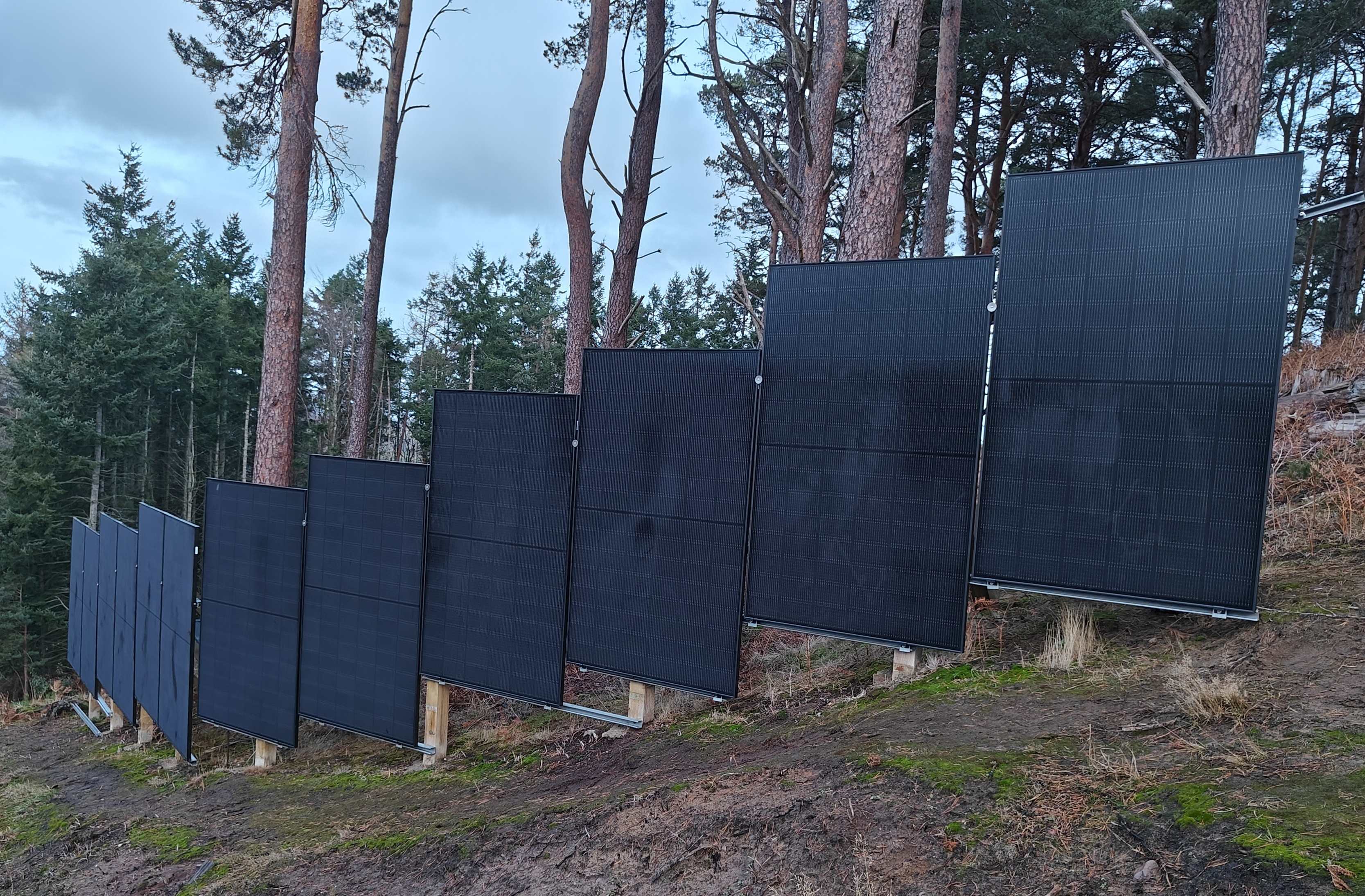

JohnMo Posted December 20, 2025 Author Posted December 20, 2025 Panels now upgraded, photos tomorrow. Day one, took 12 panels off the hill Day two, very windy, modified the steelwork for new panels Day three, new panels lifted up hill and installed, reused all old wiring without issue. Switched it on and all worked fine. Materials 2x 6m lengths of 41mm galvanised channel 12 panels 28x 30mm panel end clamps. 4 1
JohnMo Posted December 21, 2025 Author Posted December 21, 2025 Steelwork modified, using 41mm square channel, two panels in place. New array 1
ProDave Posted December 21, 2025 Posted December 21, 2025 What channel did you use? Unistrut? Where did you get long lengths locally?
JohnMo Posted December 21, 2025 Author Posted December 21, 2025 Unistut copy from local electrical factors (Medlock), comes 6m lengths. 1
sgt_woulds Posted December 22, 2025 Posted December 22, 2025 Good old unistrut! Its what we used 25 years ago before the MCS licencing nonsence came in. Did you check the clamping zones for the panels? They will be under a lot of stress in windy conditions in an exposed situation like that. Even if they dont fly away in the night, the stress may induce micro fractures in the cells and glass laminates. It looks likes half the panels face a slightly different direction to the others. Have you wired in two strings?
JohnMo Posted December 22, 2025 Author Posted December 22, 2025 Clamping areas are the same as the last panels they were ok in 80mph+ winds. Yes two strings to independent MPPTs.
