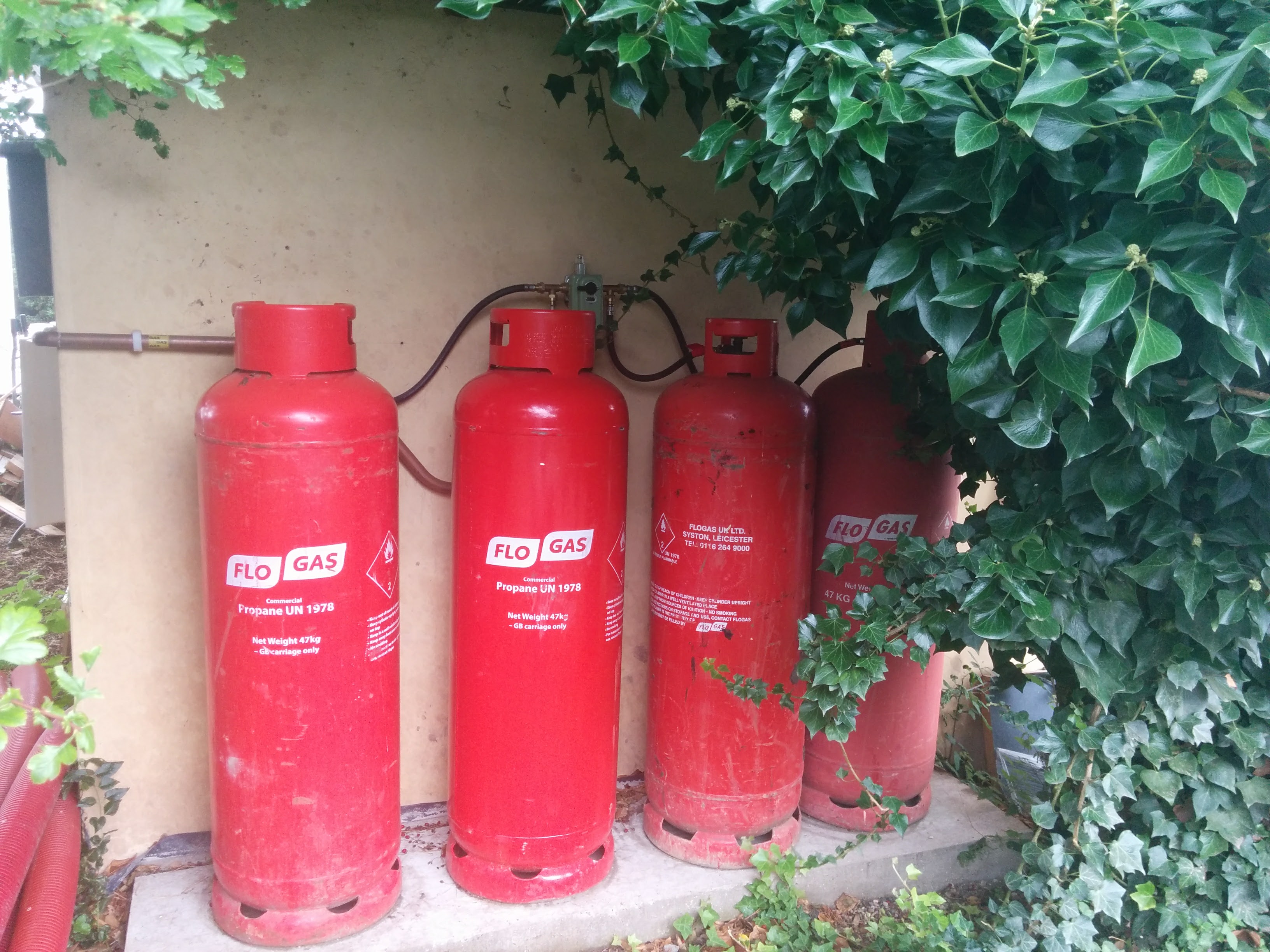

Couple more points:
  • depending upon your situation you might want to consider simply making use of 47kg propane bottles instead of a tank. That's what we use against the shed wall (although its not for everyone, I agree). Every few months a bloke drives up in a lorry and replaces two empties with two fools. Here in Essex current price is about £55 per cylinder. I cant give you accurate figures, but without heating, one bottle lasts four of us about two months.
  • finally you didn't mention cooking. If you prefer cooking with gas, say no more. Long thread about that here also :-)
