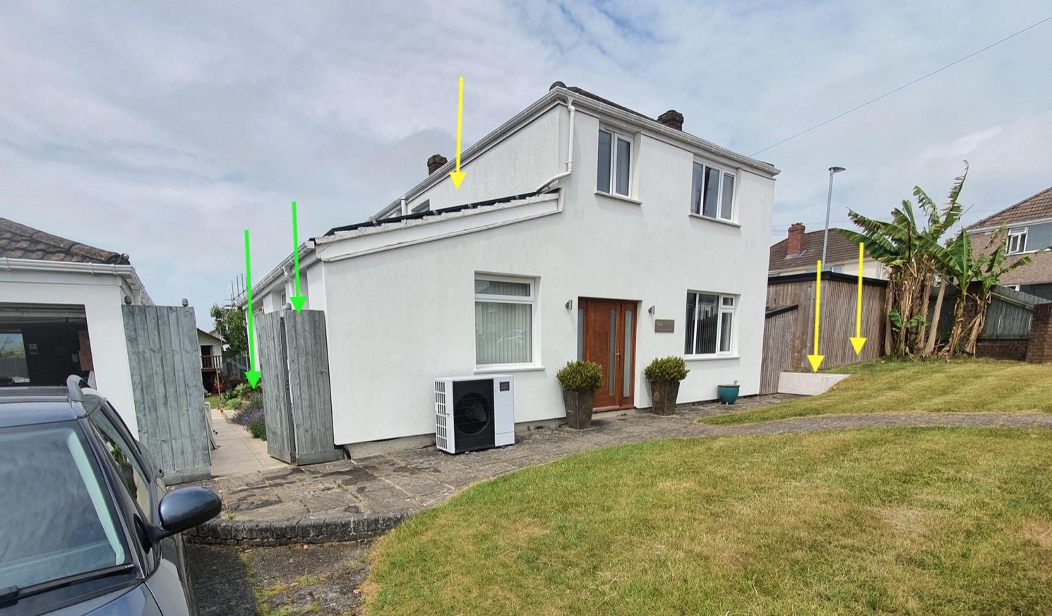

Conor Posted June 11, 2023 Share Posted June 11, 2023 14 hours ago, eniacs said: We are planning an extension that would encompass that space... Its also more of a hassle for the piping there i think Is there an opportunity to incorporate a position for the heatpump during your extension works? You'll be ripping stuff open and there might be a more suitable location. As some have said, wall mounting is an option. You've a garage, plenty of other walls... Front of the house would be worse case scenario for me. Have you done / doing renovation / upgrade works? What's the context of the install? Digging a few trenches and some new pipework might be relatively small comapred to your bigger plans. Link to comment Share on other sites More sharing options...
RichardL Posted June 11, 2023 Share Posted June 11, 2023 Some suggestions; Green arrows - just behind that fence - cant see if it's doors or windows - assume worst case lift the existing flowerbed and put it there instead? Yellow arrows - right hand side of the path @ 90 degrees to the house? or on the front of that timber building? or first floor near the back of the property? Can you share more pics of the side of the house and/or plans for that area? As much as there's nothing wrong with infrastructure technology; personally I wouldn't stick it by the front door. Obv. not my house so take that with a pinch of salt. Link to comment Share on other sites More sharing options...

ReedRichards Posted June 11, 2023 Share Posted June 11, 2023 Personally I would dig up that flat featureless lawn and make a flower bed with an evergreen shrub in front of the heat pump so it isn't visible unless you are right in front of it. 2 Link to comment Share on other sites More sharing options...
Dave Jones Posted June 11, 2023 Share Posted June 11, 2023 that looks a rough install. dropped on the slabs, drain to it ? It needs to go round the side of course, which begs the question why was it dropped in front ? Link to comment Share on other sites More sharing options...
eniacs Posted June 11, 2023 Author Share Posted June 11, 2023 6 hours ago, RichardL said: Some suggestions; Green arrows - just behind that fence - cant see if it's doors or windows - assume worst case lift the existing flowerbed and put it there instead? Yellow arrows - right hand side of the path @ 90 degrees to the house? or on the front of that timber building? or first floor near the back of the property? Can you share more pics of the side of the house and/or plans for that area? As much as there's nothing wrong with infrastructure technology; personally I wouldn't stick it by the front door. Obv. not my house so take that with a pinch of salt. HI Richard, Thanks for taking the time to help. The green arrows are a good place, but under a bedroom window there and would block the alley space between garage and house too much. The bins live there and we run a business from the garage so access is pretty important. Stock is often stored here too. Mounted on top of the roof or to the house wall would shade part of the solar panels fitted here. The yellow arrows to the right are a good spot, however only undesirable because of the long pipe run. Adding probably 2x 10m bits of pipe to be buried. I've ordered some black wrap to test wrap one of the steel panels. Possibly this will make it stick out less like a sore thumb... Im inclined to leave it and see how we get used to it. LIke you say with infrastructure, its necesary and usually ugly. Like the myriad of grey/green/black street boxes with various BT gear in and the huge poles they put up everywhere to hang wires from. Link to comment Share on other sites More sharing options...
eniacs Posted June 11, 2023 Author Share Posted June 11, 2023 7 hours ago, Conor said: Is there an opportunity to incorporate a position for the heatpump during your extension works? You'll be ripping stuff open and there might be a more suitable location. As some have said, wall mounting is an option. You've a garage, plenty of other walls... Front of the house would be worse case scenario for me. Have you done / doing renovation / upgrade works? What's the context of the install? Digging a few trenches and some new pipework might be relatively small comapred to your bigger plans. HI Conor, Its possible it would be a better location once the extension is done, however its years away i think. Weve done a complete replumb inside of the heating system, all new fan coil radiators and large bore piping. No other refurb of the house at the moment, it was refreshed about 8 years ago so mostly ok. 1 Link to comment Share on other sites More sharing options...
JohnMo Posted June 11, 2023 Share Posted June 11, 2023 2 hours ago, ReedRichards said: Personally I would dig up that flat featureless lawn and make a flower bed with an evergreen shrub in front of the heat pump so it isn't visible unless you are right in front of it. That's the best idea so far, hide in plain sight. Move it to the middle of the plain wall, near the green gateway, where the path is quite wide, so should get away without changing that. Make a slightly raised bed in the rounded off grass area get some evergreen shrubs, sorted. Do the bed first, then no-one will notice anything after. Link to comment Share on other sites More sharing options...

AChristie Posted June 22, 2023 Share Posted June 22, 2023 Don't ASHP have to be a min of 1metre from neighbouring boundary?? Link to comment Share on other sites More sharing options...
joth Posted June 23, 2023 Share Posted June 23, 2023 9 hours ago, AChristie said: Don't ASHP have to be a min of 1metre from neighbouring boundary?? They do for installation under permitted development, but I don't see the OP is at risk of violating that On 15/06/2023 at 16:11, Bob77 said: First I have heard of that. Mine is mounted to the front wall of the house under the kitchen window but will be screened from the road by shrubs when the landscaping is finished. Nobody mentioned planning requirements to me when siting it, and it was part of a major extension project with planning officers' involvement. So long as it's not a listed building, conservation area or world heritage site, there's no restriction on placing it in front of the house / towards a highway under PD. There's a general PD rule that siting should minimise impact on external appearance and amenity so far as practicable, have fun interpreting that. Link to comment Share on other sites More sharing options...
DanDee Posted June 23, 2023 Share Posted June 23, 2023 3 hours ago, joth said: They do for installation under permitted development, but I don't see the OP is at risk of violating that So long as it's not a listed building, conservation area or world heritage site, there's no restriction on placing it in front of the house / towards a highway under PD. There's a general PD rule that siting should minimise impact on external appearance and amenity so far as practicable, have fun interpreting that. @AChristie 1m from the boundary not from any neighour, I doubt in this example that the front of the house is within the boundary. All parts of the air source heat pump must be at least one metre from the property boundary https://www.planningportal.co.uk/permission/common-projects/heat-pumps/planning-permission-air-source-heat-pump Link to comment Share on other sites More sharing options...
