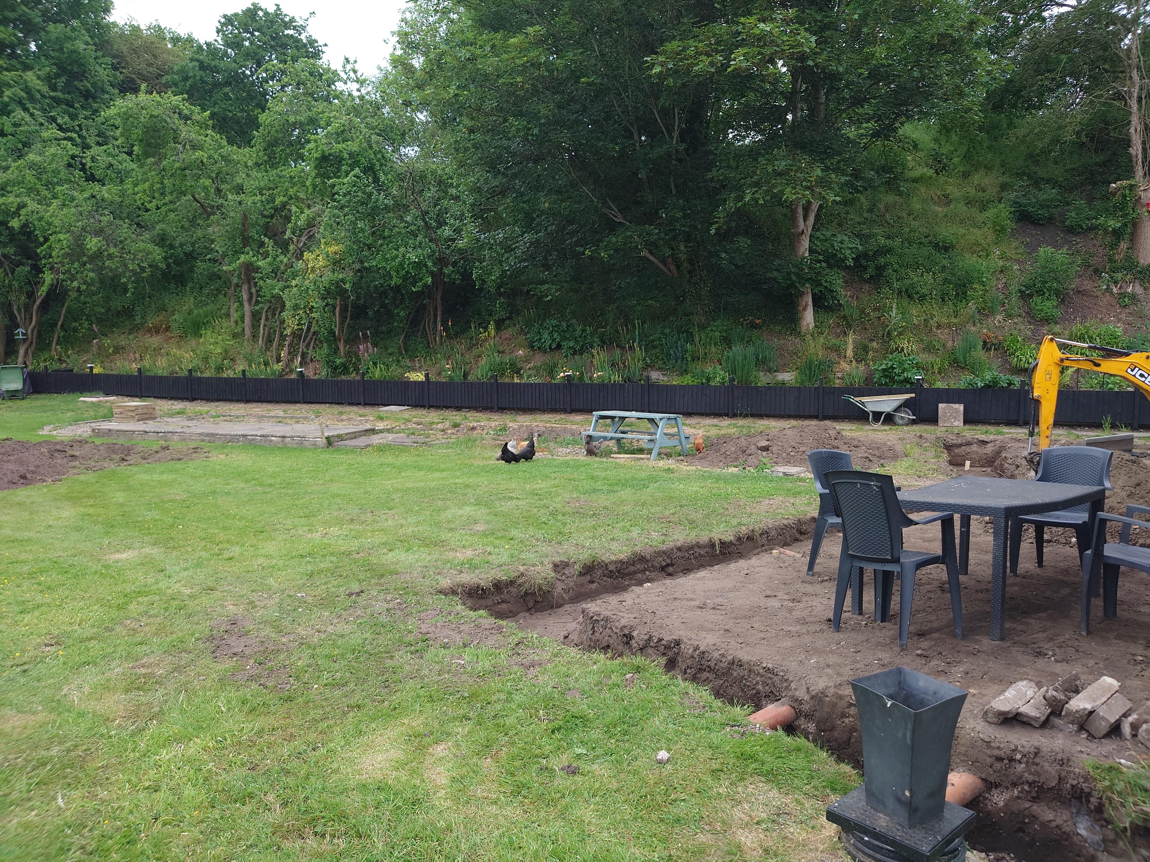

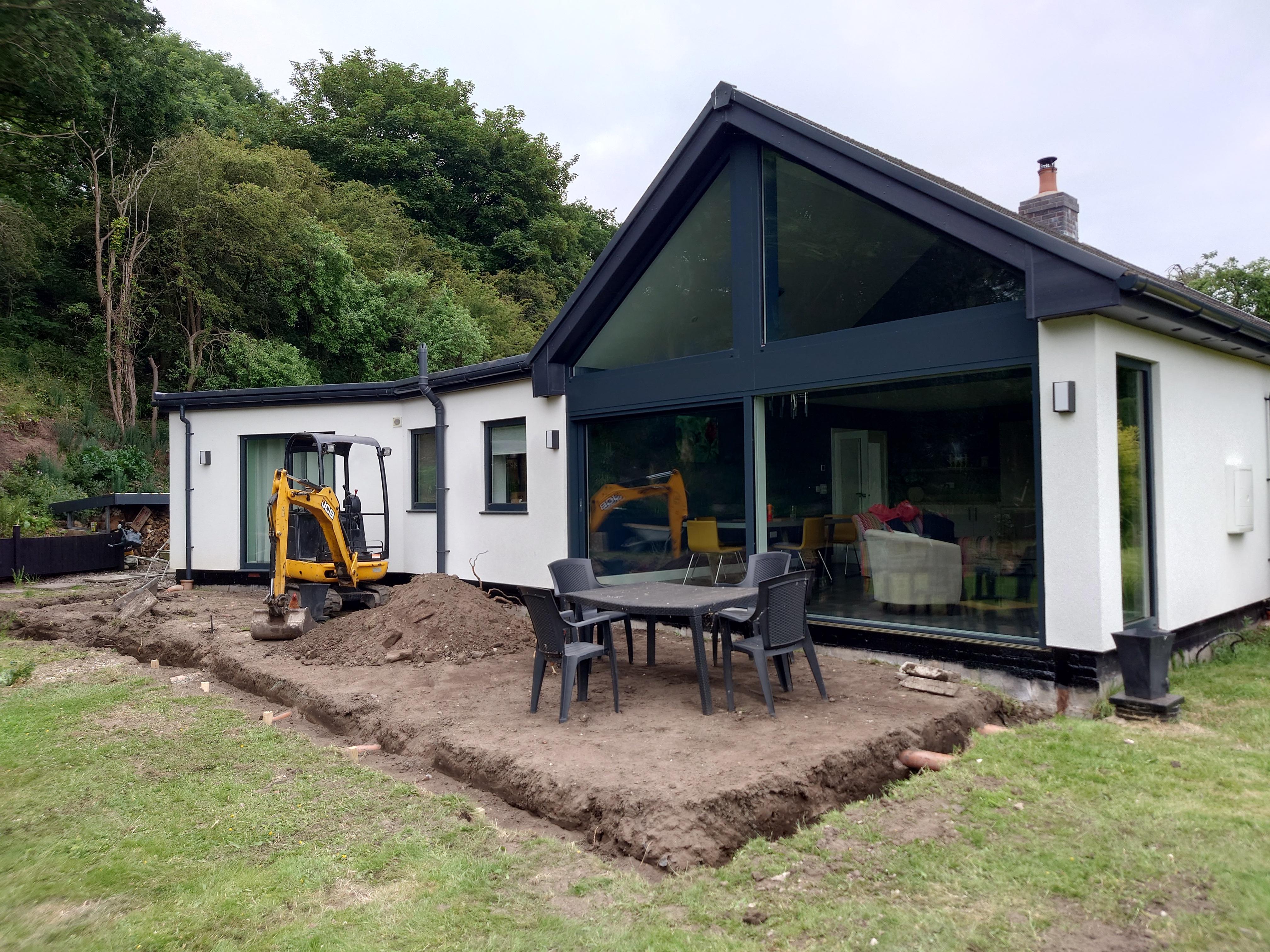

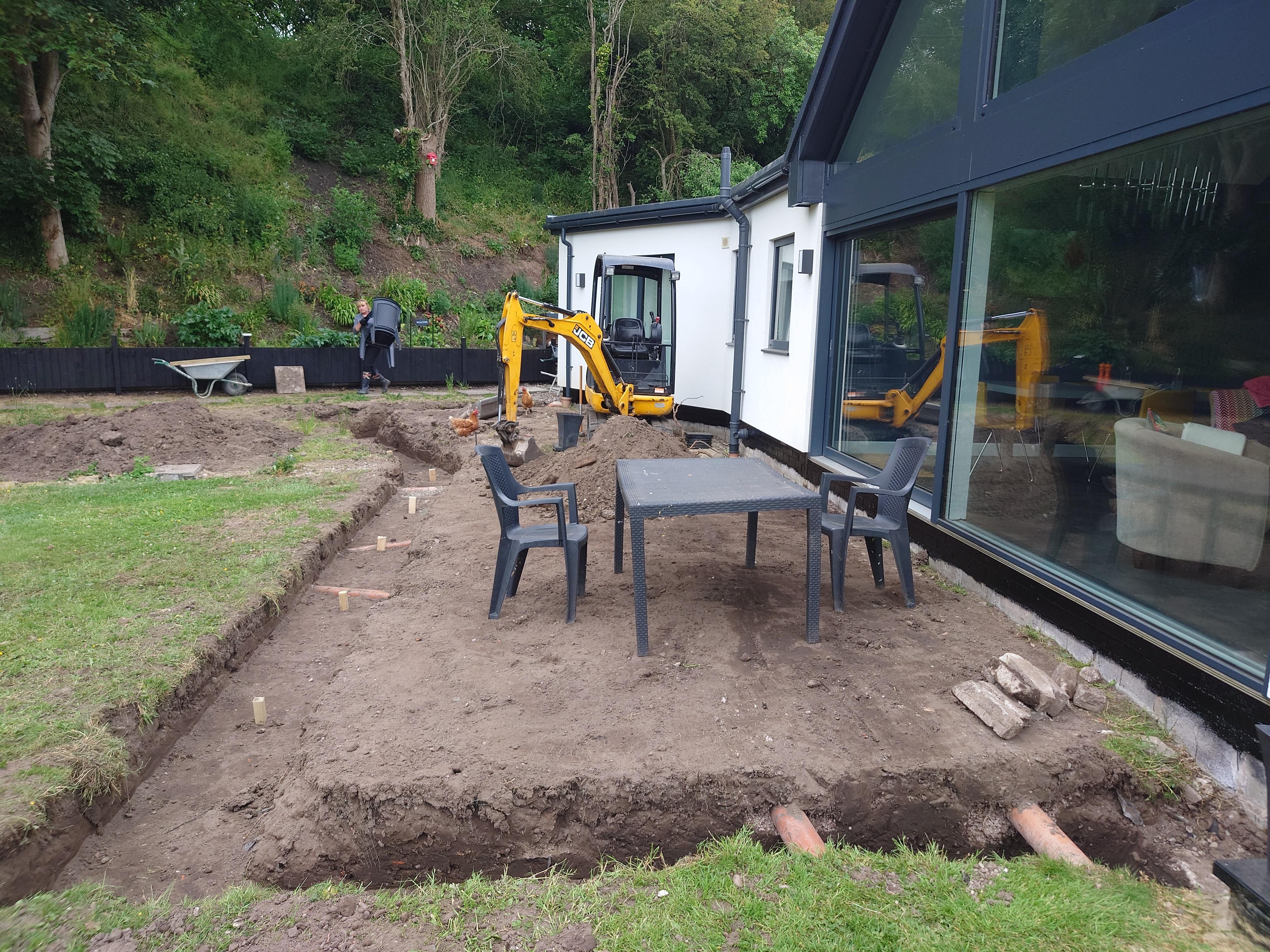

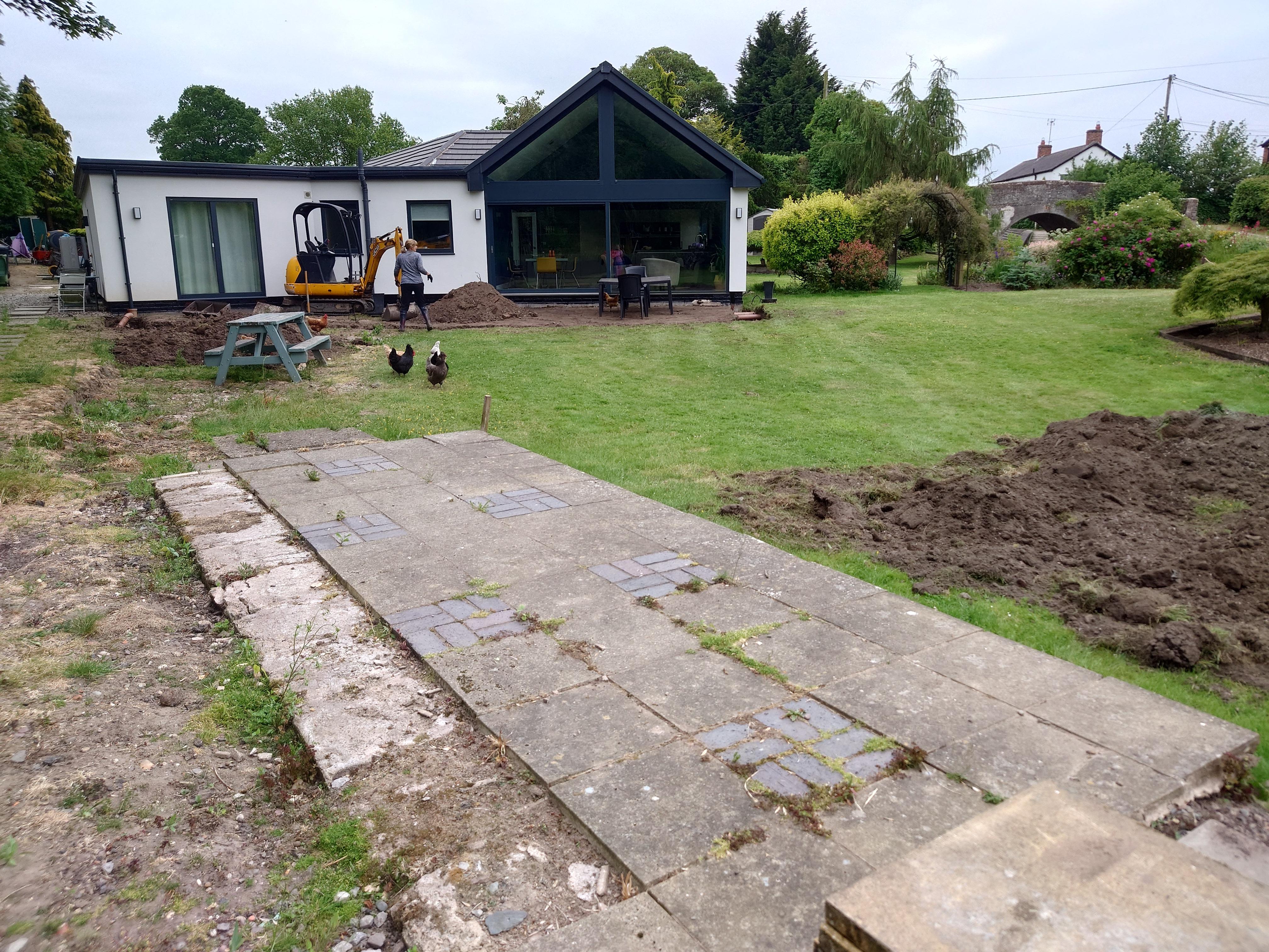

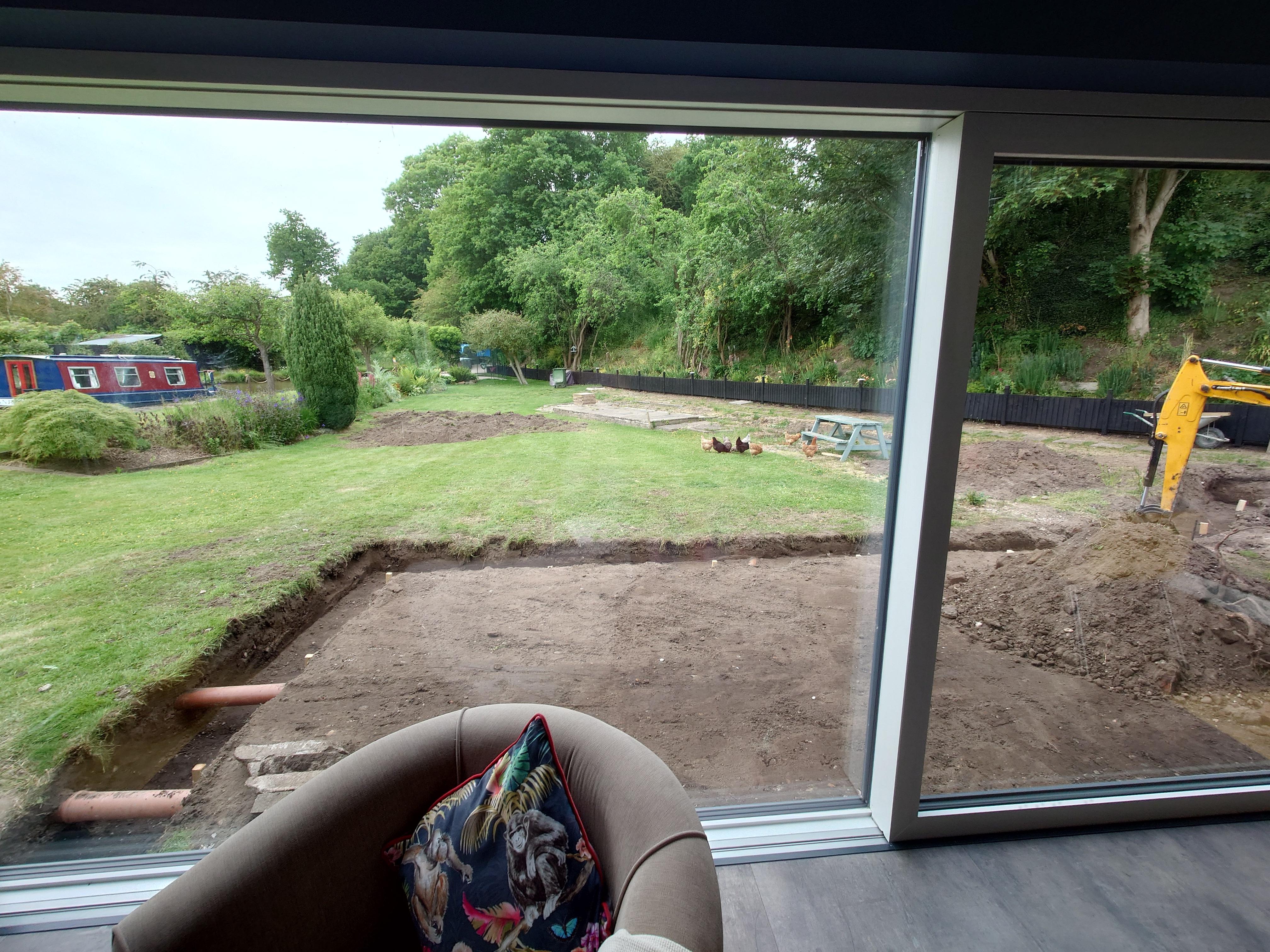

canalsiderenovation Posted June 6, 2023 Share Posted June 6, 2023 (edited) I'm having a bit of a wobble about our patio and the sizing. Need some opinions please. The length isn't an issue as it spans the length of the sliding doors of the kitchen/dining and bedroom/ensuite/office. It's the width I'm having issue with and I don't know if it's just because the footings are dug and it looks smaller! From the doors to the start of the footings is 3.3m. I think originally we had it down as 4ish metres of patio plus the planter but I think the builder took it as 4ish metres WITH the planters and I can't make up my mind if it's too small. From the kitchen looking out; Side view It isn't our only seating area as we will have a path going to this other bit which will have a gazebo and extra seating which will be around 14ftx16ft (it's our old septic tank now not in use). This area is more of a sun trap and is nice to directly look out onto the canal facing forward rather the patio in front of the sliders looks down the garden to the canal on the side rather than front on. With the price of porcelain we don't want to have more patio for the sake of it but at the same time it needs to be practical and obviously we have the length so wouldn't just have seating just where the sliding door is (the other side is our guest bedroom/ensuite which will also be an Airbnb room). Edited June 6, 2023 by canalsiderenovation Extra info Link to comment Share on other sites More sharing options...
joe90 Posted June 6, 2023 Share Posted June 6, 2023 I think it all depends on what you want to use the space for, your table and chairs appear to fit nicely! And you have the other area to use as well. Too big can look out of place (and costly). 1 1 Link to comment Share on other sites More sharing options...
canalsiderenovation Posted June 6, 2023 Author Share Posted June 6, 2023 On 06/06/2023 at 18:31, joe90 said: I think it all depends on what you want to use the space for, your table and chairs appear to fit nicely! And you have the other area to use as well. Too big can look out of place (and costly). Expand The other half is playing around with furniture. Yes as we have the other space which will have the gazebo and space around it I don't want it to look too heavy on the porcelain and a path will connect both areas and with the rendered planters it may be ok. I think I'm just struggling to visualise it. Link to comment Share on other sites More sharing options...
joe90 Posted June 6, 2023 Share Posted June 6, 2023 On 06/06/2023 at 18:34, canalsiderenovation said: I think I'm just struggling to visualise it. Expand A common problem that I found with customers when I was working, luckily I can visualise stuff like a 3d image in my head 🤯. Link to comment Share on other sites More sharing options...

Bonner Posted June 7, 2023 Share Posted June 7, 2023 IMHO it looks a bit tight. Think circulation space around your table, do people need to squeeze past the window or planter side when those chairs are occupied? I would add another 1m to the width. 2 1 Link to comment Share on other sites More sharing options...
canalsiderenovation Posted June 7, 2023 Author Share Posted June 7, 2023 On 07/06/2023 at 05:40, Bonner said: IMHO it looks a bit tight. Think circulation space around your table, do people need to squeeze past the window or planter side when those chairs are occupied? I would add another 1m to the width. Expand We tested it and could get around OK but that's what I was thinking too. Hmm, decisions. Link to comment Share on other sites More sharing options...
crispy_wafer Posted June 7, 2023 Share Posted June 7, 2023 On 06/06/2023 at 19:25, Big Jimbo said: On another note, your house and setting looks fantastic. Expand Was just going to say that, look's lovely. Bet the chook's love the freshly dug soil! In terms of patio, I'm going with about the same at the back of ours, so 3 - 3.5 * 13m and down the side where the evening sun hits, will be 5*10m. 1 Link to comment Share on other sites More sharing options...
canalsiderenovation Posted June 7, 2023 Author Share Posted June 7, 2023 On 07/06/2023 at 06:03, crispy_wafer said: Was just going to say that, look's lovely. Bet the chook's love the freshly dug soil! In terms of patio, I'm going with about the same at the back of ours, so 3 - 3.5 * 13m and down the side where the evening sun hits, will be 5*10m. Expand The chooks love it, and the builders gave them lots of treats too. The patio outside the sliders is partly north facing so we don't get sun until afternoon. Your size of 3.5*13 is very similar to us. I think I may speak to the builder this morning. My main concern is if it looks proportionate to the house and too small. I think I'd be happer with an extra 1 metre max. The old septic tank area is in the sun all day (it faces the side of our boat so it's a nice area to sit and watch the boats go past). At 14ft*16ft that is quite a bit of space. @crispy_wafer 5m X 10m as an additional patio? That sounds huge! Link to comment Share on other sites More sharing options...

Marvin Posted June 7, 2023 Share Posted June 7, 2023 Hi @canalsiderenovation IMHO the patio size will be too narrow to have people comfortably around the table. I personally don't like the thought of a chair backing on to a window! .Would you design this inside - to have a chair backing on to a full height window? Even your soft sofa chair in the picture is further away. You could extend only the patio area for the table as a compremise? Good luck M 1 Link to comment Share on other sites More sharing options...

canalsiderenovation Posted June 7, 2023 Author Share Posted June 7, 2023 Decision made - when the builders get here we are going to ask them to extend it by 1metre width and hope this will be doable. That should give us enough space to comfortably walk around the table. I think that extra metre will make all the difference and look more proportional. In fairness this is what we had marked initially (around 4.3m plus the planter not including the planters)! 1 Link to comment Share on other sites More sharing options...

Conor Posted June 7, 2023 Share Posted June 7, 2023 On 07/06/2023 at 08:37, canalsiderenovation said: Argh the concrete is due today and en route, mesh all being done now 😕 but actually the width is slightly more than 3.3m at 3.6m as the porcelain will be slightly overhanging than the soil end. It's not a metre more but it's almost a chair width more. I'm hoping it will be ok. We are going to make the other patio area slightly larger than originally planned so there is additional options here - the gazebo and extra space for table chairs at the side. Expand When we were designing our house we were faffing around with room and spaces sizes. Our architect gave us som basic guidence for min spaces for different uses, we followed them and it's worked out brilliantly. The min comfortable width of a dining / socialising space with enough for circulation is 3.2m (1m table, 0.6 each side for chairs, 1m for circulation). You've got it bang on. 1 Link to comment Share on other sites More sharing options...
canalsiderenovation Posted June 7, 2023 Author Share Posted June 7, 2023 On 07/06/2023 at 09:05, Conor said: When we were designing our house we were faffing around with room and spaces sizes. Our architect gave us som basic guidence for min spaces for different uses, we followed them and it's worked out brilliantly. The min comfortable width of a dining / socialising space with enough for circulation is 3.2m (1m table, 0.6 each side for chairs, 1m for circulation). You've got it bang on. Expand Thanks for that, it's helpful. We were playing with table sizes and looking at our dining table. As we have the other patio area too I think I need to relax a little! Link to comment Share on other sites More sharing options...

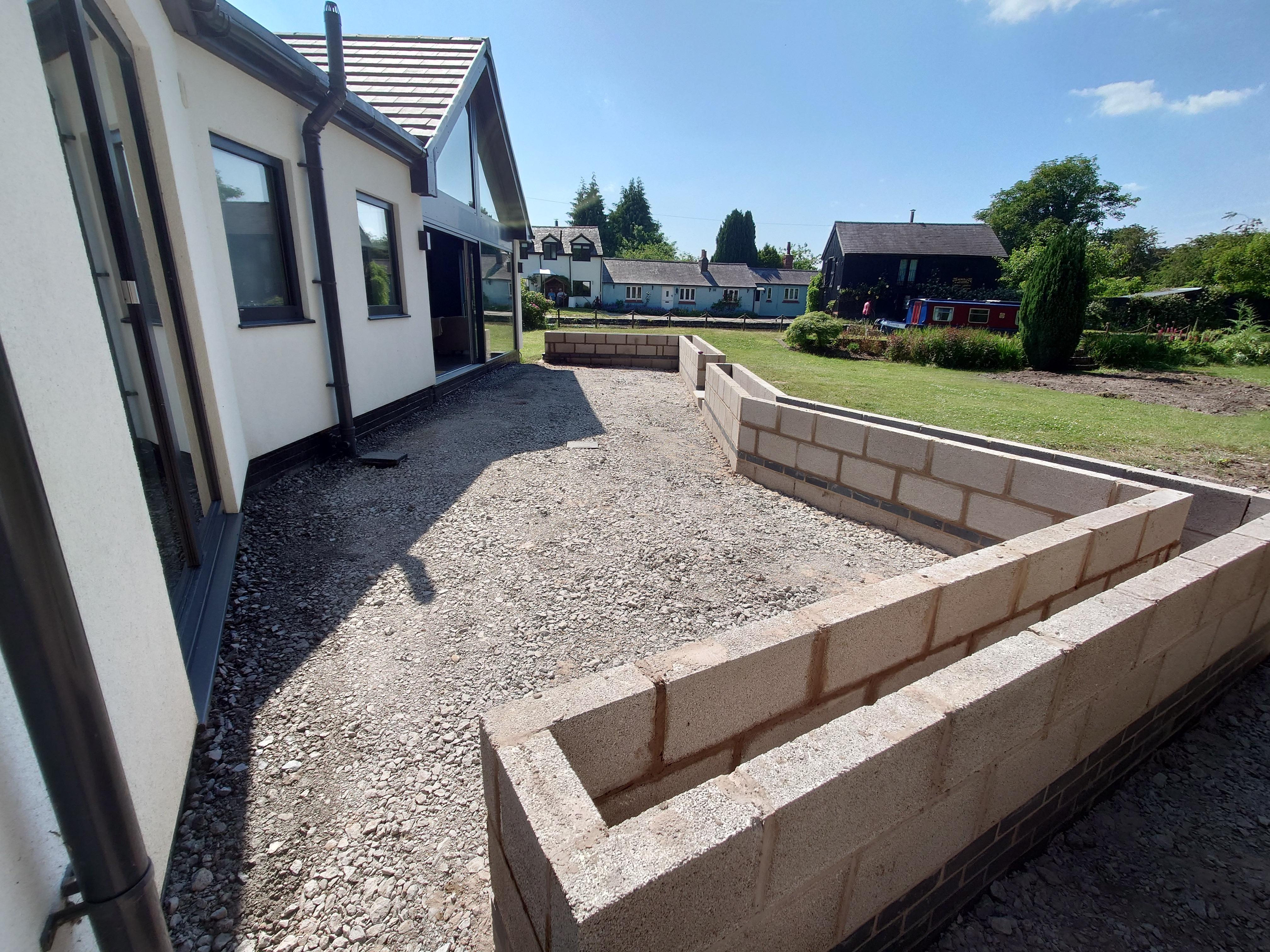

S2D2 Posted June 7, 2023 Share Posted June 7, 2023 Thinking about this also and I've come across a few paver sets that are designed to be laid 3.6m deep, so I think that will be a good size. How tall will the planter walls be? 1 Link to comment Share on other sites More sharing options...

canalsiderenovation Posted June 7, 2023 Author Share Posted June 7, 2023 On 07/06/2023 at 10:47, S2D2 said: Thinking about this also and I've come across a few paver sets that are designed to be laid 3.6m deep, so I think that will be a good size. How tall will the planter walls be? Expand TBC yet, but it will only have lavender in it so not massive. This was sort of how we are hoping they will look (not with steps, just an opening). Bricking is starting tomorrow. Link to comment Share on other sites More sharing options...

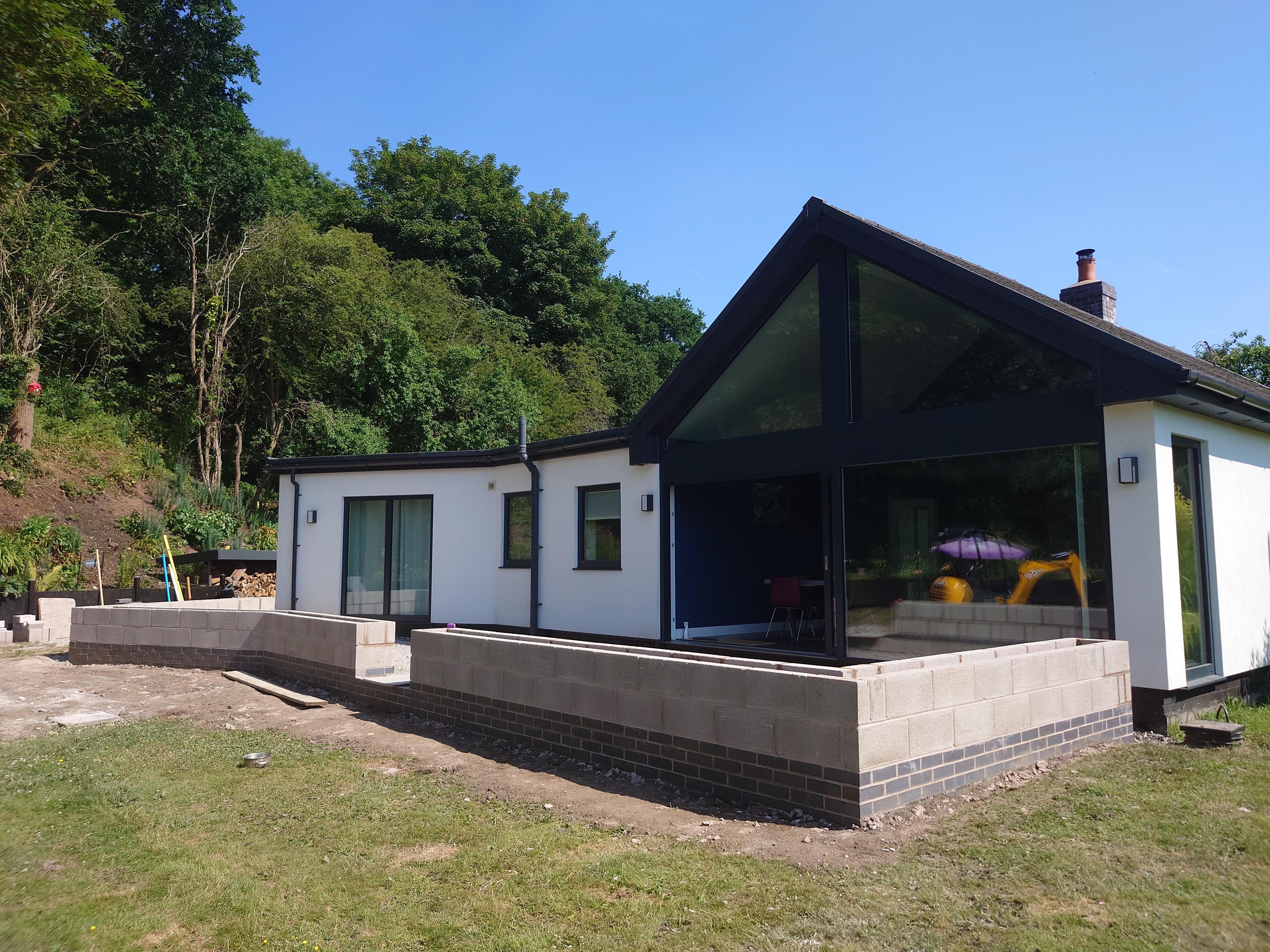

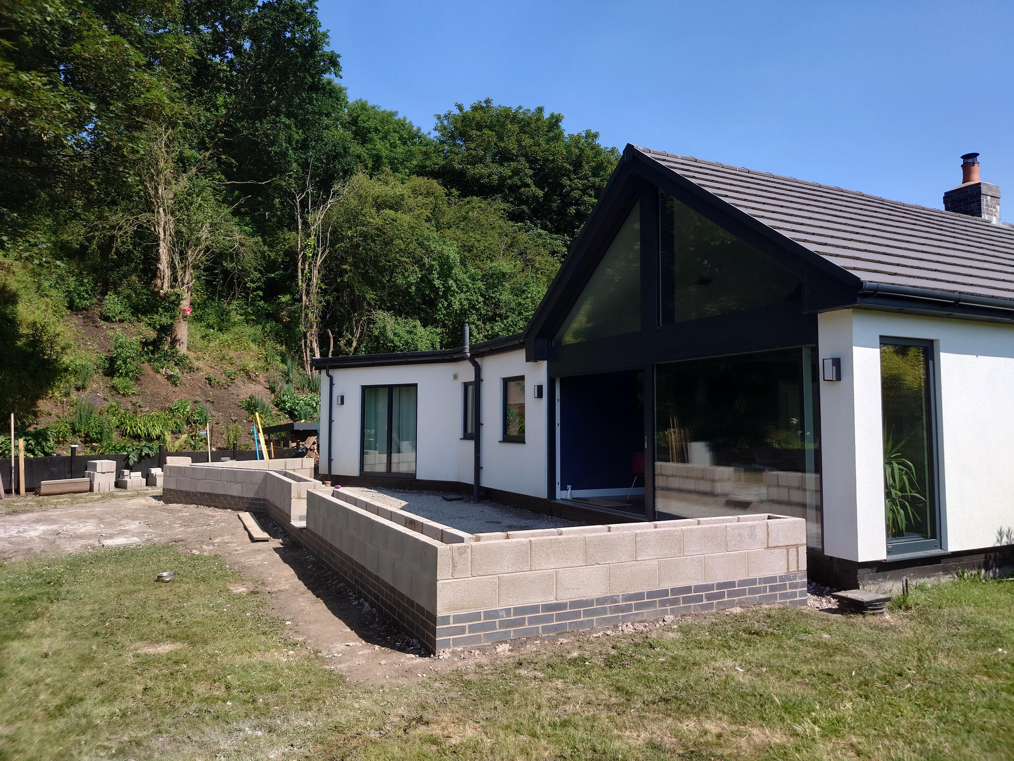

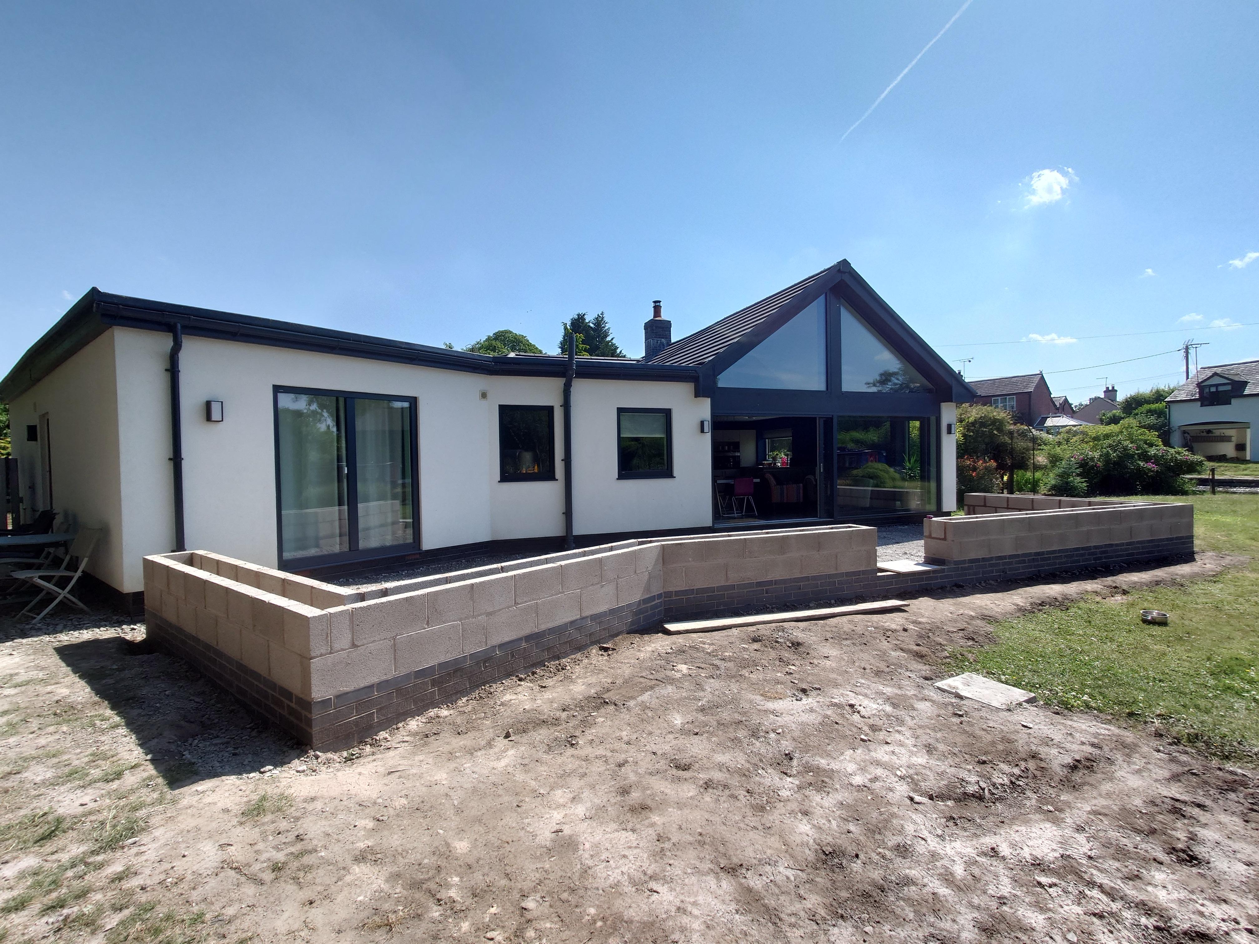

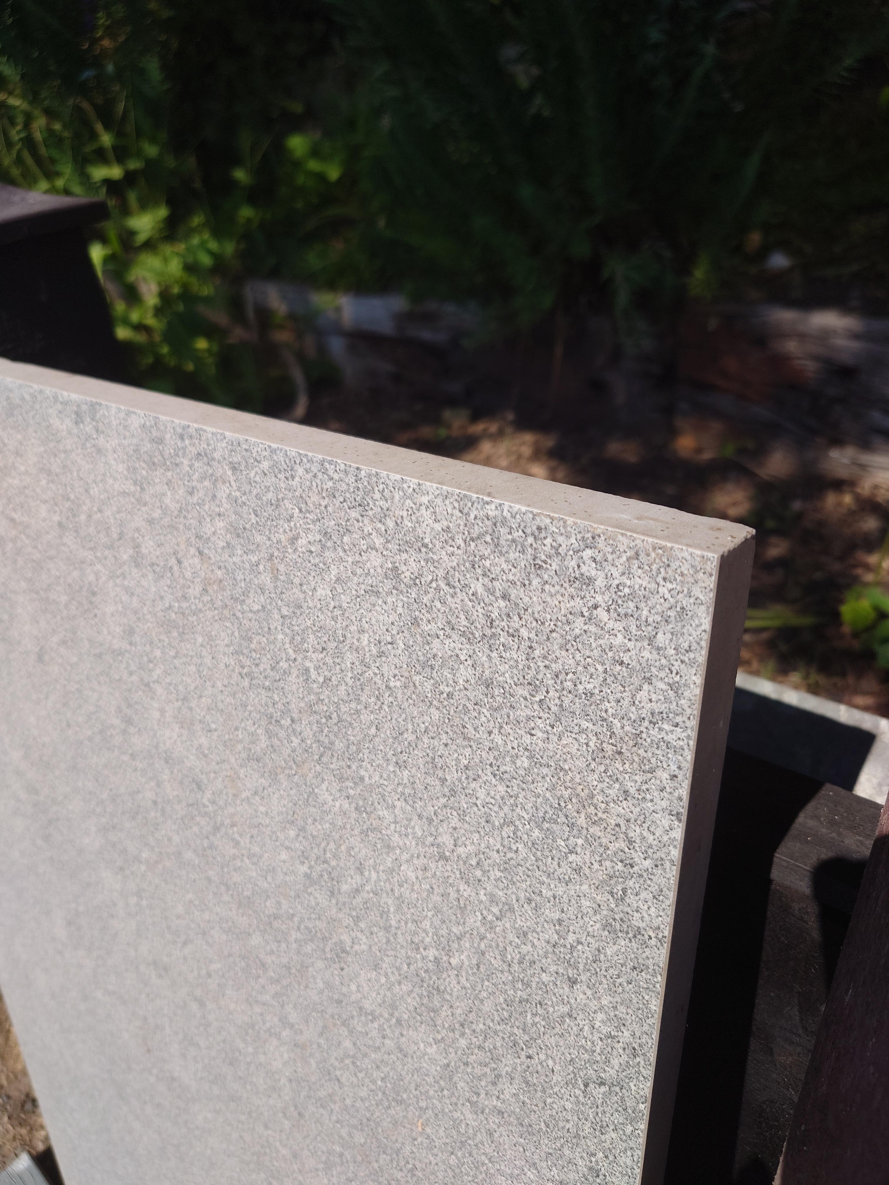

canalsiderenovation Posted June 15, 2023 Author Share Posted June 15, 2023 (edited) @S2D2 we haven't got the porcelain laid yet but it will be below the blue brick inside and the height will be 50cm from the bottom of the blue brick. Ground needs building up levelling outside planters and the white render will match the walls yet but here's some pics. We also sorted our porcelain. All 100m2 of it with 'a bit extra thrown in' for £2200 (we are having another patio area with gazebo). It's like a smooth almost granite like effect. Edited June 15, 2023 by canalsiderenovation 2 Link to comment Share on other sites More sharing options...
