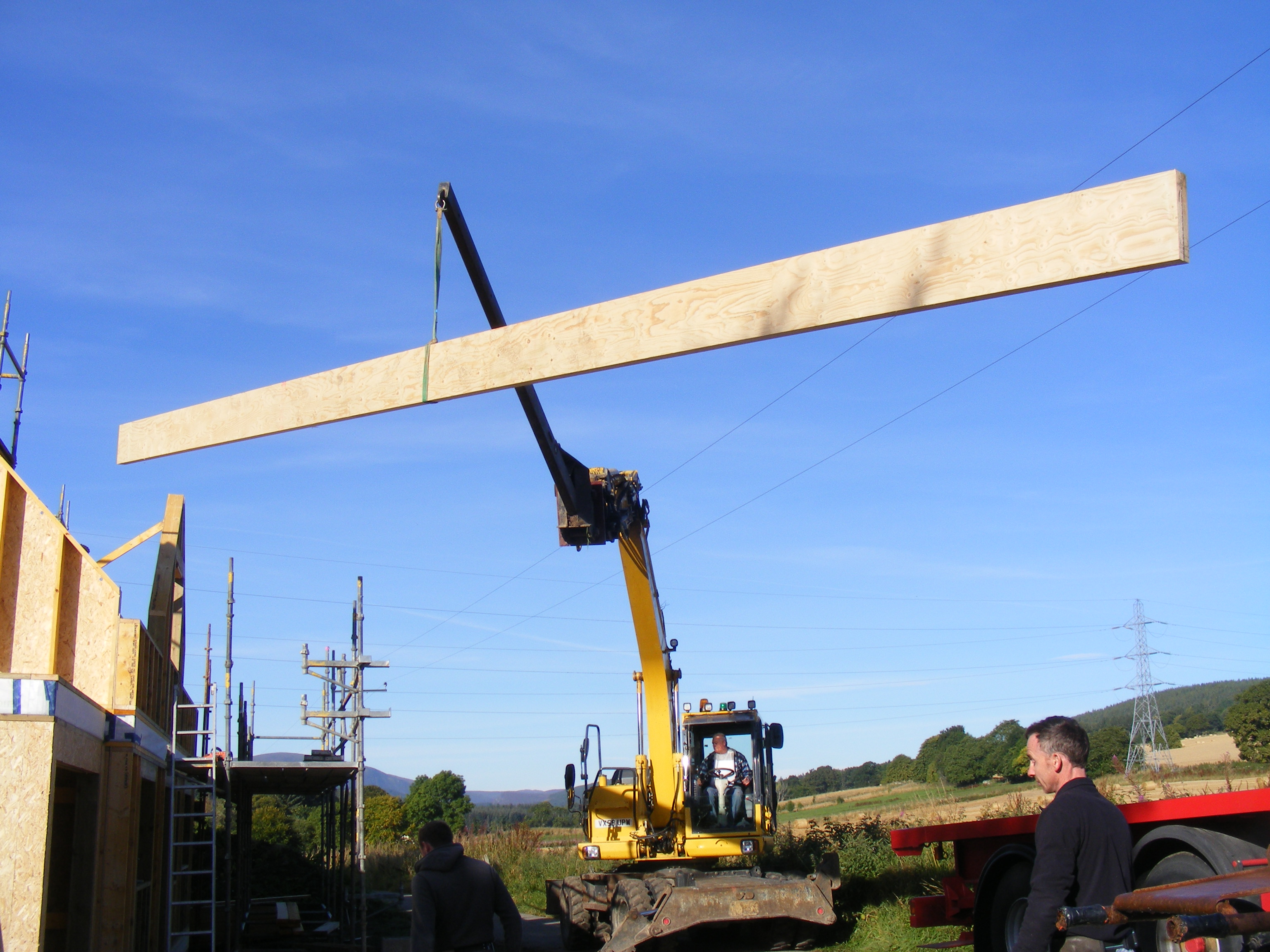

ProDave Posted June 24, 2016 Share Posted June 24, 2016 Watch for lifting big loads at full reach, and then turning sideways and whoops the digger falls over. I was impressed with the 13t digger our builders used. A 360 degree digger but on wheels not tracks so it is road legal (but more prone to getting bogged down on site) As well as loading forks, it also had a long "boom extension" that just fitted to the quick hitch. It was just a long bar with a hook on the end. They use if for lifting timber panels and beams into place. In spite of it's length, and only being attached to the quick hitch in place of a bucket, it did seem very smooth, which is both a complimet to the mechanics of the digger, and the skill of the driver. Here it is lifting our big ridge beam. Link to comment Share on other sites More sharing options...
PeterW Posted June 24, 2016 Share Posted June 24, 2016 OK - problem with lifting anything is reach, and a digger no matter how big has a finite ability to reach and place as your lifting point is the bucket. On a B&B floor you will need to pick up a beam at mid point and lift it to mid point of the floor - unless you have a full side run, you need to get the machine swing over the site from a single point and it just won't work. The other issue is loading on the arm - at full stretch, a 5 tonne machine will struggle with over a couple of hundred KG - an offroad telehandler would be ok at 12m with the same load but its designed to do a job. Link to comment Share on other sites More sharing options...
Vijay Posted June 24, 2016 Author Share Posted June 24, 2016 Access all around is no problem as I have a 3.5m no build zone at the sides of the house. But can a digger lift a 5m beam when the digger is straight with the arm at 90 degrees (so the arm is reaching into the house from the side but the digger itself is facing forward). Looking at the specs of the 5t digger, full reach is 6m Link to comment Share on other sites More sharing options...
Declan52 Posted June 24, 2016 Share Posted June 24, 2016 (edited) With the bucket of it might but def not side on or you will tip. You will end up setting them on the walls at the start, maybe 2/3m in and walking them to where they need to be. Lifting with forks is not easy and when it goes wrong it goes tits up very quickly. You will blow a check valve or end up on tipped over before you have a chance to do anything. Edited June 24, 2016 by Declan52 Link to comment Share on other sites More sharing options...
Vijay Posted June 24, 2016 Author Share Posted June 24, 2016 I'd be happy with even setting them on the wall and getting mates to help me for the day in moving them into place. Plus I've got a pallet lifter Roger440 generously let me have which I'm sure will help (or even trolley jacks on wood running boards) Lifting with forks is off the cards, last thing I need is any stupid accidents What's the score with tracks and how long they typically last? How long would tracks with 40-50% left last? A quick check at replacements and they are £800 a side Are they DIY fitting or specialist? Link to comment Share on other sites More sharing options...
