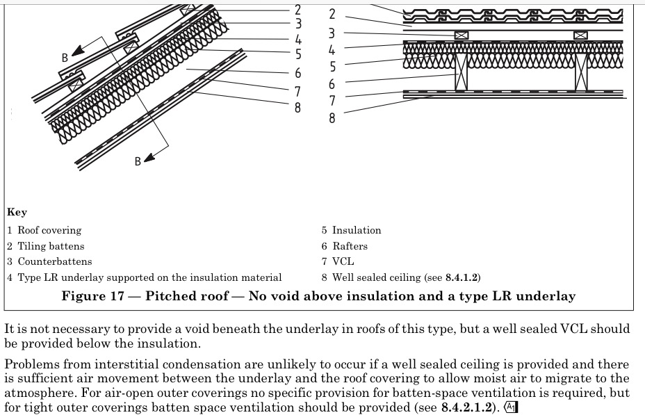

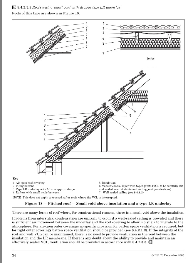

PeterW Posted August 13, 2017 Posted August 13, 2017 So the definitive answer on this should be the BS5250 recommendation. This is the detail on roof construction where there is either a small void above or no void above the insulation. if following either of these the key is that there is a fully sealed VCL below the insulation and no ventilation required if using a full breather membrane.
Pocster Posted August 13, 2017 Author Posted August 13, 2017 1 hour ago, PeterW said: So the definitive answer on this should be the BS5250 recommendation. This is the detail on roof construction where there is either a small void above or no void above the insulation. if following either of these the key is that there is a fully sealed VCL below the insulation and no ventilation required if using a full breather membrane. Ok! So for me then ; I can overlap my membrane across the ridge because it's breathable. Was going to VCL the PIR underneath anyway. Lol!; wonder what my architect will say
PeterW Posted August 13, 2017 Posted August 13, 2017 Architect can spec what he wants ..!! Building Control will only sign off what is correct so they are the ones to consult. If you say you are building it to the detail as shown in BS5250 as per the BBA certificate for the product then you can't exactly go wrong ..!!! 1
Pocster Posted August 13, 2017 Author Posted August 13, 2017 2 minutes ago, PeterW said: Architect can spec what he wants ..!! Building Control will only sign off what is correct so they are the ones to consult. If you say you are building it to the detail as shown in BS5250 as per the BBA certificate for the product then you can't exactly go wrong ..!!! LOL! You think BCO will even look?; trust me he won't!. But yes following that spec seems the way to go!. Get ready for photo's!
Ian Posted August 14, 2017 Posted August 14, 2017 (edited) @pocster @PeterW I think there may be a misunderstanding here on what the British Standard is recommending. When it refers to "air-open" and "tight" coverings it is referring to the final roof finish - IE are you using a "tight" fitting interlocking roof tile or an "air open" loose fitting slate. In my view If you have tight fitting interlocking roof tiles in the scenario that you've described then you do need batten space ventilation. I know your architect has specifed a tightly sealed VCL on the warm side of the roof as well as a very high quality LR underlay however its still possible to get situations where you get condensation on the underside of the roof tiles - IE in warm humid summer weather - when you get a sudden drop in temperature such as during a thunderstorm you get sudden cooling of the roof tiles with condensation occurring within the roof void. In a situation where you have tight fitting roof tiles its best to have a ventilation gap to allow this condensation to rapidly evaporate. Ian Edited August 14, 2017 by Ian
