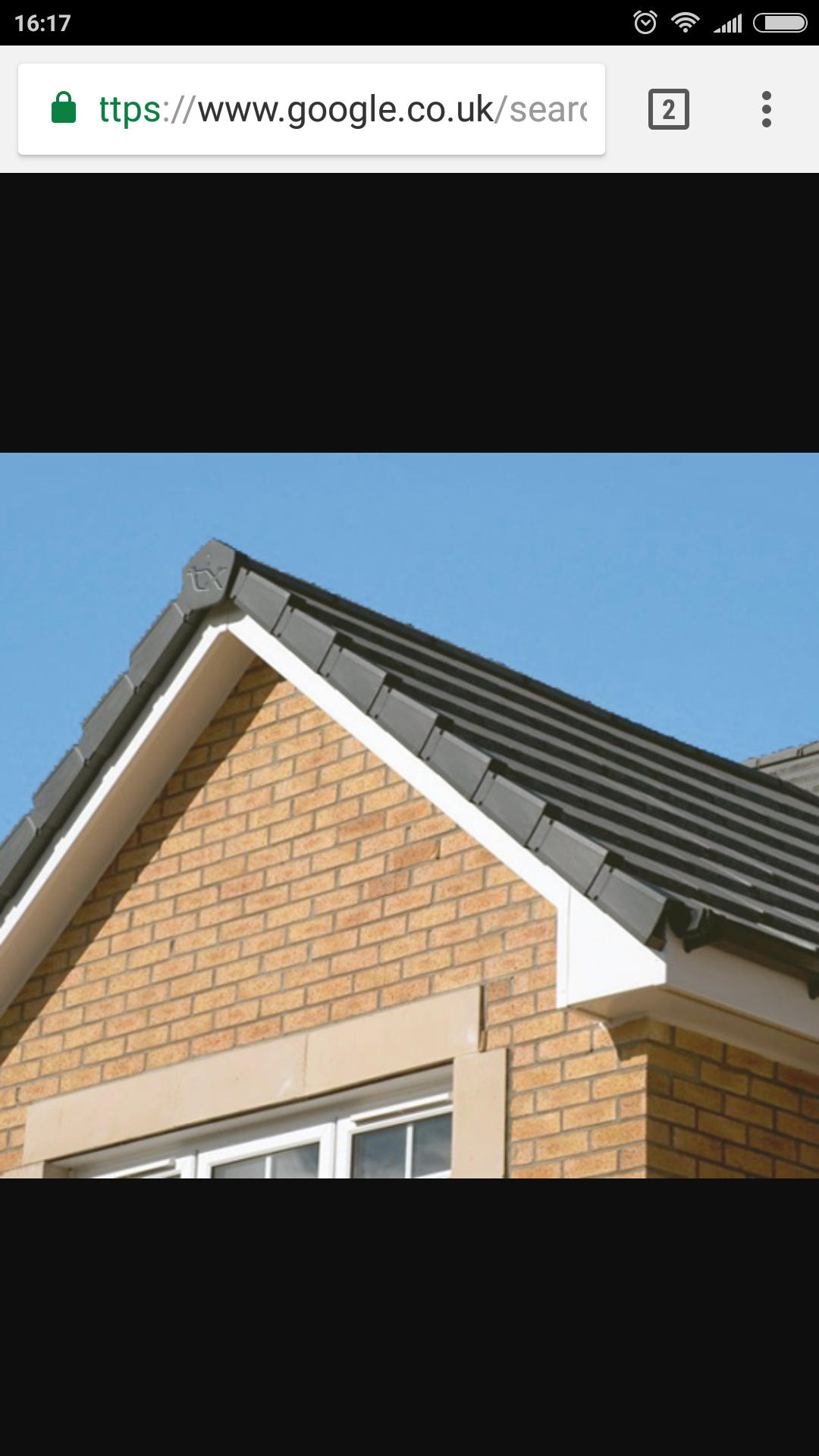

Pocster Posted August 10, 2017 Posted August 10, 2017 Hey all, Be prepared for lots of noob questions!; all help appreciated!! Guys have finished the timber frame and it looks AMAZING! - almost like a real house The roof confuses me (no sh*t). I understand on the main 'sides' it should be quite simple. Felt, batton with over hang at sides to allow for plastic fit verge things. I appreciate I need to get the spacing of the battons correct so the gauge is correct and also they ultimately over hang the fascia enough for the gutter. It's the front detail that confuses me. I have this hip thing! (not because I am cool!). SO!; the dry fit hip is fine for a continuous row along the apex of the roof - seems simple enough. But what happens when I meet the 'hip' and the hip tiles go in different directions? There will be a gap between the meeting point of the 3 hip tiles. Also when the 2 separate runs of hip meet the dry verge how does that marry up? Equally; assuming fascia is tacked onto fascia wood and tiles over hang edge and dry verge screwed to batton ends (assuming thats all correct) what happens when the angled verge meets the straight run at the base of the hip ? does it just run under the tiles that over hang the front? Appreciate lots of my questions aren't perhaps clear! So some photo's! Final 2 photo's show lots of strips the roofing company sold me (typically!); what are they for? All help appreciated as usual! - this thread might get quite long! 1

Gone West Posted August 10, 2017 Posted August 10, 2017 We had those fitted on our roof. Cut like this at the roof angle, ideally straight cuts. Covered with something like this: https://www.roofingsuperstore.co.uk/product/marley-modern-plastic-hip-apex-cap-for-36-45-degree-pitch-grey.html More help: https://www.roofingsuperstore.co.uk/user/u/files/marley-dry-fix-brochure.pdf

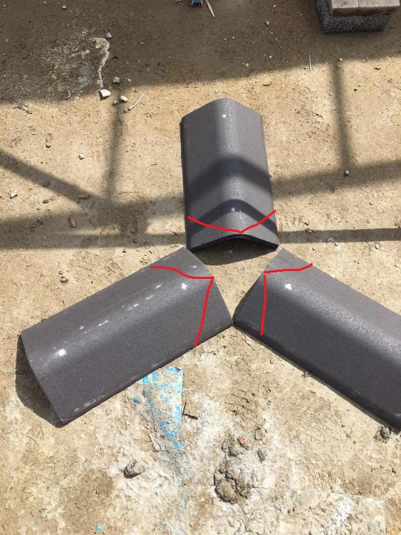

Barney12 Posted August 10, 2017 Posted August 10, 2017 (edited) 7 minutes ago, PeterStarck said: We had those fitted on our roof. Cut like this at the roof angle, ideally straight cuts. Covered with something like this: https://www.roofingsuperstore.co.uk/product/marley-modern-plastic-hip-apex-cap-for-36-45-degree-pitch-grey.html More help: https://www.roofingsuperstore.co.uk/user/u/files/marley-dry-fix-brochure.pdf That's exactly how our gagare roof is cut for the hip. Also if mortar bedded you'll need a hook iron at the ends: https://www.roofingsuperstore.co.uk/product/galvanized-hip-iron-300-x-100-x-25-x-3mm.html edit: sorry just re-read and noticed you mentioned a dry ridge. Edited August 10, 2017 by Barney12
Declan52 Posted August 10, 2017 Posted August 10, 2017 For when you get to the ridge with the plastic edges you need another end cap to suit your tile. It sits over the edges coming up the roof and hides the join. Not sure what the other small bits are, hard to make it on your pic.
Temp Posted August 10, 2017 Posted August 10, 2017 1 hour ago, pocster said: Equally; assuming fascia is tacked onto fascia wood and tiles over hang edge and dry verge screwed to batton ends (assuming thats all correct) what happens when the angled verge meets the straight run at the base of the hip ? does it just run under the tiles that over hang the front? Yes. The verge facias and the facia at the bottom of the hip are all in the same vertical plane. One thing I found difficult was setting the height of the top of the facia - it supports the bottom tiles at the correct angle to match the rest of the roof.
Pocster Posted August 10, 2017 Author Posted August 10, 2017 (edited) 57 minutes ago, Barney12 said: That's exactly how our gagare roof is cut for the hip. Also if mortar bedded you'll need a hook iron at the ends: https://www.roofingsuperstore.co.uk/product/galvanized-hip-iron-300-x-100-x-25-x-3mm.html edit: sorry just re-read and noticed you mentioned a dry ridge. https://www.roofingsuperstore.co.uk/product/marley-modern-plastic-hip-apex-cap-for-36-45-degree-pitch-grey.html AHHHHHHHHHHHHHHHH!!! This is what I need for that 'messy' 3 way angle. I did speak to a roofing supplier and they said 'just chuck cement in there' - which seems rather crap. I guess the issue is getting all the angles right..... Edited August 10, 2017 by pocster
Pocster Posted August 10, 2017 Author Posted August 10, 2017 44 minutes ago, Declan52 said: For when you get to the ridge with the plastic edges you need another end cap to suit your tile. It sits over the edges coming up the roof and hides the join. Not sure what the other small bits are, hard to make it on your pic. This is the other end of the build for me. This is easy (ignoring the height!) I got this bit sorted in my head. Special bit of plastic to 'tie' the 2 verge angled runs together!
Pocster Posted August 10, 2017 Author Posted August 10, 2017 31 minutes ago, Temp said: Yes. The verge facias and the facia at the bottom of the hip are all in the same vertical plane. One thing I found difficult was setting the height of the top of the facia - it supports the bottom tiles at the correct angle to match the rest of the roof. SO! (Assuming I understand!). The front verge plastic stuff goes up under the front 'end of hip tiles' ? I can see the issue getting the 'sides' and hip flat tiles (not the ridge) to line up. Because my roof tiles are laid right to left I'm starting on that particular side i.e. at the front - then I can check my hip stuff before I entire an entire side of the roof!

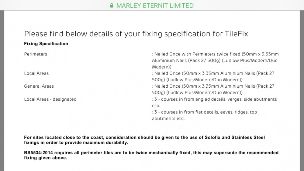

Pocster Posted August 11, 2017 Author Posted August 11, 2017 (edited) A question! One video showed that the felt should stop 30mm short of the top. I'm using roof shield and in their spec you lap over the apex (same from other side) by 150mm. Assume I should follow roof shields spec - but why be 30mm short anyway?; surely best to go up and over the apex??? Though I then see it *should* be 30mm short because it's a vented dry ridge..... Edited August 11, 2017 by pocster
Temp Posted August 11, 2017 Posted August 11, 2017 Yes. If it's a cold roof (insulation between rafters) then you need 50mm ventilated air gap between membrane and insulation.... unless the membrane is vapour permeable. If membrane is vapour permeable or it's a warm roof (insulation above rafters) you can run it over the ridge as no ventilation required (normally).

Pocster Posted August 12, 2017 Author Posted August 12, 2017 9 hours ago, Temp said: Yes. If it's a cold roof (insulation between rafters) then you need 50mm ventilated air gap between membrane and insulation.... unless the membrane is vapour permeable. If membrane is vapour permeable or it's a warm roof (insulation above rafters) you can run it over the ridge as no ventilation required (normally). Yeah this where I get confused I'm using roof guard which is a breathable membrane . Will sag 10mm between trusses to allow water run off . Insulation will be between trusses not above ceiling . So I'm guessing I still stop the membrane 30mm short of apex ; perhaps it's irrelevant for a breathable membrane ? cheers
