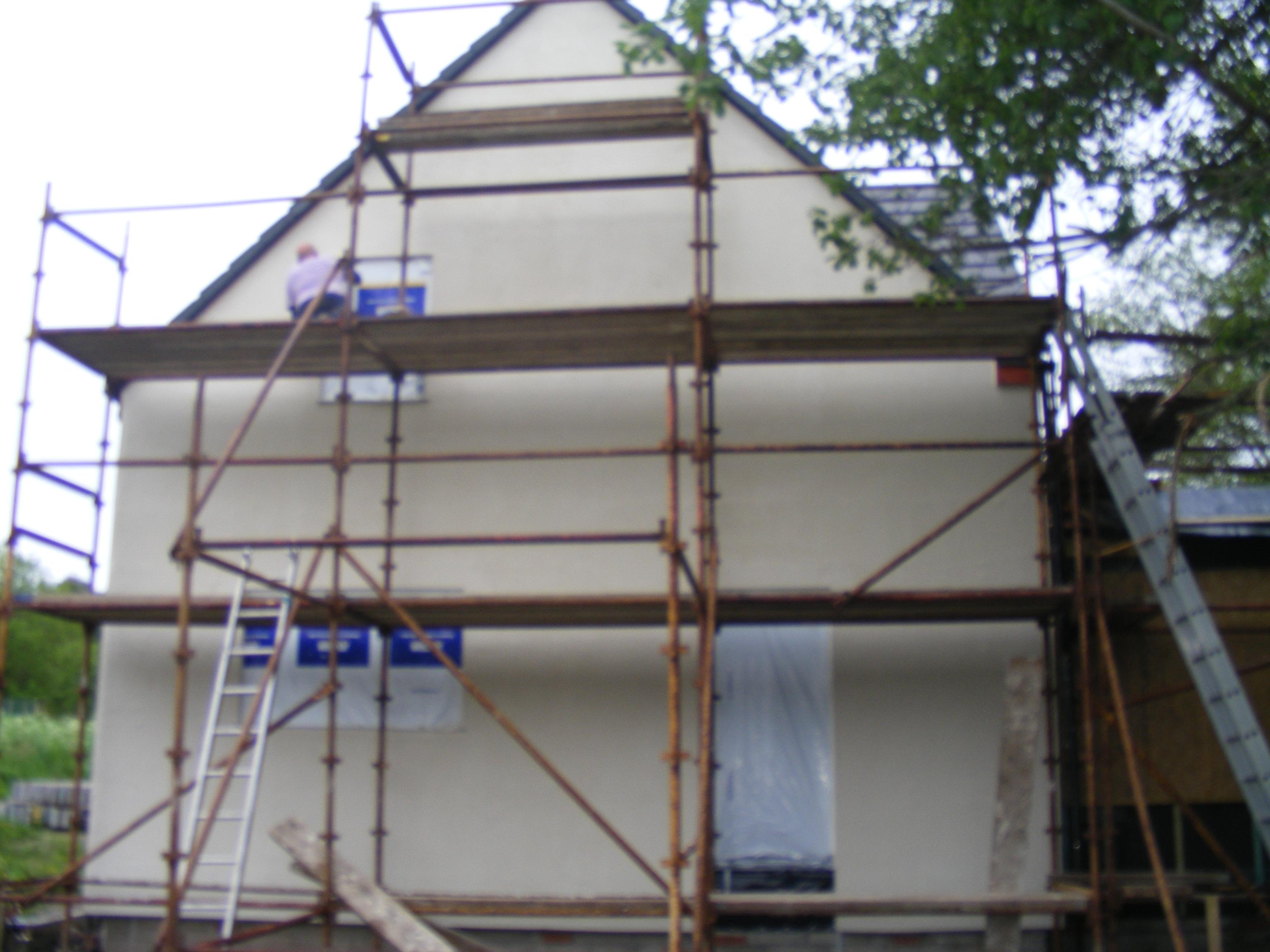

ProDave Posted May 25, 2023 Share Posted May 25, 2023 If you are going to buy scaffold, then buy one of the system scaffolds like Kwikstsge or Cuplock. Whatever is available. They are really a scaffold tower system where you can join as many towers together and build whatever height you are likely to need for a self build. Very simple to erect and change about. For inside use you can build a single tower and put it on wheels just like a scaffold tower and move it about. It is so useful that at the end of the build, I did not sell it all, I kept enough to scaffold one wall of the house. It is just so handy to have when you need it. 1 Link to comment Share on other sites More sharing options...

Dave Jones Posted May 25, 2023 Share Posted May 25, 2023 8 hours ago, ProDave said: If you are going to buy scaffold, then buy one of the system scaffolds like Kwikstsge or Cuplock. Whatever is available. They are really a scaffold tower system where you can join as many towers together and build whatever height you are likely to need for a self build. Very simple to erect and change about. For inside use you can build a single tower and put it on wheels just like a scaffold tower and move it about. It is so useful that at the end of the build, I did not sell it all, I kept enough to scaffold one wall of the house. It is just so handy to have when you need it. zero guarding, no bracing. hope H&S lock you up. 1 Link to comment Share on other sites More sharing options...
Mr Punter Posted May 25, 2023 Share Posted May 25, 2023 1 hour ago, Dave Jones said: zero guarding, no bracing. hope H&S lock you up. The diagonals are bracing. It could do with an additional horizontal rail at each lift and a toe board but not an immediate hanging offence and if I was the only one working on it I probably wouldn't bother. Link to comment Share on other sites More sharing options...
