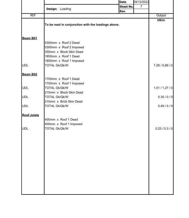

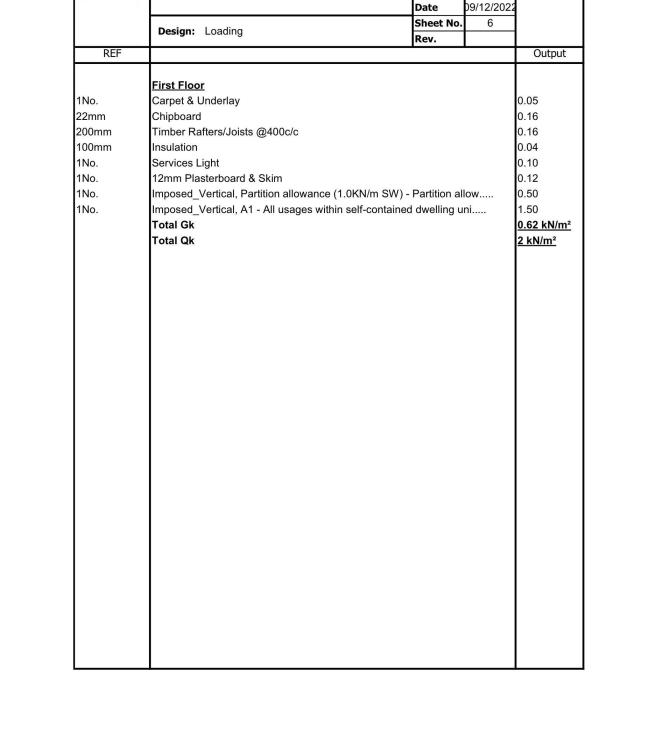

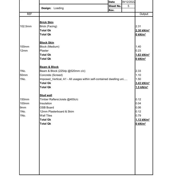

saveasteading Posted May 25, 2023 Share Posted May 25, 2023 On 23/05/2023 at 04:29, Sophiae said: What does it mean? This appears to be still unanswered. In the hope that it helps you set this aside as a matter to accept and stop worrying about, here is an explanation. Each line is the weight of a material bearing onto the beam. The known weight per m2 or skin or m , as appropriate, is multiplied by the area, length etc. This provides the weight that the steel has to support, then the correct section of beam can be specified. There is then a choice from a selection of standard beam sections. Tall and narrow beams are more structurally efficient (less steel) but take more height. Chunky beams take up less height but use a lot more steel so are more expensive. Pad stones are standard. They cost about £25 each. They are high strength concrete blocks from any builders merchant and replace wall blocks where the beam sits. They spread the very concentrated load from the ends of the beam so that the normal (weaker) blocks can take the load without breaking. Builders, architects , engineers, bco all should know this. A solution to the height issue is often to build the joists into the side of the beam instead of on top. Most of the beam is then lost in the ceiling space. I suggest simply telling whoever is responsible to find a solution. Then post it here. I agree that a new thread, with a simpler challenge, may help. 2 Link to comment Share on other sites More sharing options...
Sophiae Posted May 26, 2023 Author Share Posted May 26, 2023 @BadgerBadger @saveasteading Thank you both very much. I took about half a day off or so from brainstorming. I had a meeting with another structural engineer (a consult) to explain to me how the loads are calculated. Then I shared the SE’s calculations with him and he pointed out where the excess load came from. I believe the extra load was from the roof. He put a much bigger load forgetting that the roof sits on other walls too, hence the confusion. I have been given about 4 options and need to spend time this weekend doing the financial maths to see what choice would be feasible. i will start a new Thread and keep posting as I am sure I will need all of your wisdom and advice for everything to come. 5 Link to comment Share on other sites More sharing options...

MJNewton Posted May 27, 2023 Share Posted May 27, 2023 20 hours ago, Sophiae said: I had a meeting with another structural engineer (a consult) to explain to me how the loads are calculated. Then I shared the SE’s calculations with him and he pointed out where the excess load came from. I believe the extra load was from the roof. He put a much bigger load forgetting that the roof sits on other walls too, hence the confusion. What size beam does he believe should've been specified? Link to comment Share on other sites More sharing options...

Sophiae Posted May 27, 2023 Author Share Posted May 27, 2023 12 hours ago, saveasteading said: Is this a windup? Consider it successful. The majority of Civil Engineers end up in general management, many outside of construction. SE is a subset of CE. Perhaps you have only met the ones who are proposed by architects. The likelihood in this case is that the SE had a very limited brief and low fee....as set by client or their agent. In my case, the SE was chosen not by price, he was the closest to the property with excellent reviews. He named his price and I didn’t even negotiate, he even asked for £200 extra to give his opinion on the flat roof. He attended to the property, spent time taking measurements and pictures, spoke about my needs and hopes and he had open access to contact me with any queries. A few days later, he returned back with the final design and calculations and silly ignorant me thought he delivered what was needed to make our dream of space come true with no hiccups. No consults, no conversation, no choices, no options. Just one design. Link to comment Share on other sites More sharing options...
Sophiae Posted May 27, 2023 Author Share Posted May 27, 2023 12 hours ago, MJNewton said: What size beam does he believe should've been specified? He gave me 2 options : 203X203X71 UC with steel bearing plates on the sides 305X165X54 UB. 1 Link to comment Share on other sites More sharing options...
