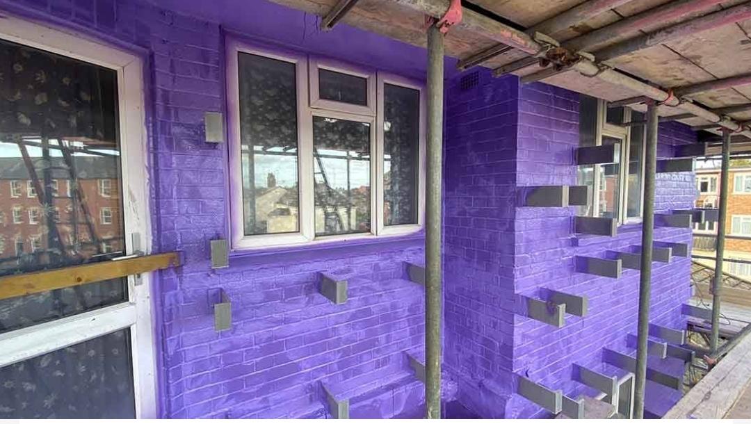

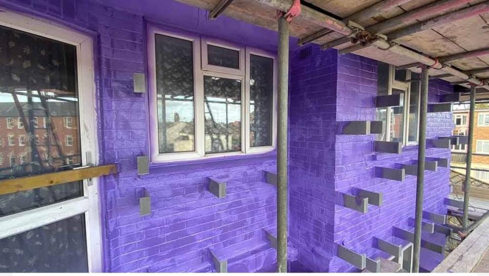

Iceverge Posted May 19, 2023 Share Posted May 19, 2023 (edited) 7 hours ago, rsimon said: replace the roof with insulation etc. We will certainly struggle with air-tightness. This is the rescue for me. Airtightness won't be an issue if you do it externally to the current skin of the house before EWI with a parge coat or membrane or paint on sealer. You can likewise build the new roof as a hybrid/warm roof and use a ply/OSB layer fully taped as your airtight layer. External airtightness is more straight forward than internal anyway. Given the roof hasn't been done extend it to give as much of an overhang as possible and you can then have enough insulation to make the build a passivhaus too. Edited May 19, 2023 by Iceverge Link to comment Share on other sites More sharing options...
Iceverge Posted May 19, 2023 Share Posted May 19, 2023 https://passivehouseplus.ie/news/marketplace/passive-purple-used-to-seal-beattie-passive-enerphit Here's an example of an Enerphit where they did just that. Link to comment Share on other sites More sharing options...

Iceverge Posted May 21, 2023 Share Posted May 21, 2023 9 hours ago, rsimon said: our current air-tightness approach is external with a parge coat (using the EWI adhesive) as you have rightly suggested, but the purple paint is an interesting option. I'll certainly check it out. Another frustration is that our current approach specifies that we fill the cavities to really guarantee airtightness and I found out recently that there is batt insulation in some of the walls which requires specialists to get it out. I'm not sure if this is a must if the purple paint is used. Do empty cavities contribute to air leakage? The roof is also going to be warm with the approach you have mentioned with an airtight OSB deck. Normally if you were to retrofit cavity wall insulation like EPS blown beads or mineral wool then the supplier would insist on removing the existing cavity wall insulation to be able to guarantee against water ingress. However in the situation where you have EWI they should be happy to just top up the existing. Do you have any pics of the house as is? It must be relatively modern if there's mineral wool batts already in the cavity. Airtighess and insulation are separate things entirely unless you use something like closed cell foam or open cell foam/cellulose in a timber frame. Any pics/cross sections drawings of the house would help. Is it detached? What kind of roof do you have? How sticky are the authorities about external alterations? Link to comment Share on other sites More sharing options...
