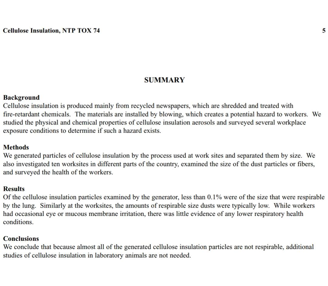

May 8, 20233 yr Author 1 hour ago, Iceverge said: Have you done much research on this or is it just hunches? Gut feelings can be pretty unreliable when it comes to building, partly because we're at the recieving end of a century of commercial interests presenting their product as the newest and greatest. If you really want to get informed then you'll need to dig beyond any "opinions" of professionals and infomercials. If you don't you're going to overpay for a substandard house. For instance here's a report about cellulose toxicity with a screenshot of the summary. TOX-74: Cellulose Insulation - National Toxicology Program https://ntp.niehs.nih.gov/go/tox074 While the cellulose itself may not be harmful I'm concerned about the Borasic Acid and Ammonium sulfate that it's treated with. I'll think I will stick with rockwool for the roof and hemp for the walls. Thank you for suggesting it though.
May 8, 20233 yr 2 hours ago, The Reverend said: Have you done much research on this or is it just hunches? Hunches for me, but based on a lot of experience and also considering each new product as it is introduced, discounting most. My concern re old newspapers cellulose is that it may have been finding a use for a waste product, rather than a genius new product. Paper gets wet and soggy and slumps. Insects and rodents like soft sheltered nests, buildings have flaws. I foresee papier mache at the bottom of a void.

May 13, 20233 yr On 08/05/2023 at 15:59, The Reverend said: While the cellulose itself may not be harmful I'm concerned about the Borasic Acid and Ammonium sulfate that it's treated with. I'll think I will stick with rockwool for the roof and hemp for the walls. Thank you for suggesting it though. Did you get a chance to read that report, or even skim it? Alternatively why not woodfiber batts or hemp/flax batts or blown woodfiber insulation to keep the embodied energy as low as possible. If you're dead set against borates these may be contained within too. Mind you most mineral wool has formaldehyde so you pays your money, takes your chances.... Taken from the excellent greenspec.co.uk website. I really like natural insulants but the only one which my cheap ass would(did) pay for is cellulose. Edited May 13, 20233 yr by Iceverge
