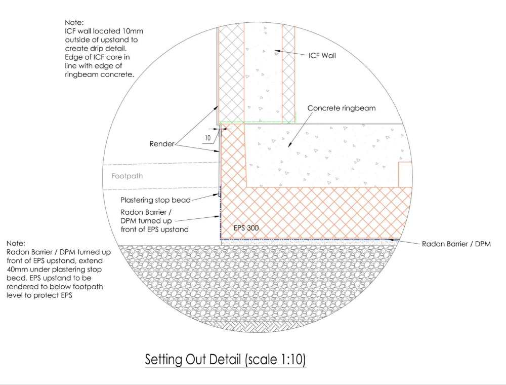

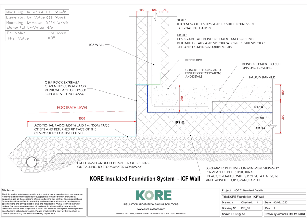

Jenki Posted May 9, 2023 Posted May 9, 2023 11 hours ago, saveasteading said: Has anybody suggested bolting your footings to the rock? Depends on the depth of course, but there is little point in breaking out granite and replacing with concrete. I'm sure when the final spec comes back from the certifier there will be rebar in the rock, I'm unsure how they think around 45T of concrete can be blown of its foundation of rock but that's what they said, the detailing of the radon becomes more and more difficult 😔
SteamyTea Posted May 9, 2023 Posted May 9, 2023 57 minutes ago, Jenki said: the detailing of the radon becomes more and more difficult Can you put a sump and air blower in?
Jenki Posted May 9, 2023 Posted May 9, 2023 41 minutes ago, SteamyTea said: Can you put a sump and air blower in? It's only a low risk area so only require barrier, but rebar connections from footing to bedrock and footing to ICF mean I'll have to seal the barrier and rebar🙈 12 hours ago, saveasteading said: Has anybody suggested bolting your footings to the rock? Depends on the depth of course, but there is little point in breaking out granite and replacing with concrete. I'm sure when the final spec comes back from the certifier there will be rebar in the rock, I'm unsure how they think around 45T of concrete can be blown of its foundation of rock but that's what they said, the detailing of the radon becomes more and more difficult 😔
SteamyTea Posted May 9, 2023 Posted May 9, 2023 3 minutes ago, Jenki said: but rebar connections from footing to bedrock and footing to ICF mean I'll have to seal the barrier and rebar An interesting engineering problem. I wonder if you could cast/encapsulate the appropriate parts in an airtight resin. I think radon barriers are thick polyethylene, which is a bugger to adhere to, but there is generally a way around joining dissimilar materials. I am only thinking aloud, and not knowing the details it is hard to imagine the problem. But it is only an engineering problem, and as Ken Tyrell said "An engineer is only someone that does for a penny what any damn fool can do for a quid".
saveasteading Posted May 10, 2023 Posted May 10, 2023 10 hours ago, Jenki said: I'm unsure how they think around 45T of concrete can be blown of its foundation of rock It will be overturning rather than lift-off. Still seems wrong, but let's await your design. I have seen rock being broken out for concrete. Not a design error, just rock encountered early and nobody stopping to think. Radon barrier. I expect there will be a stage where this will be easier than directly onto the rock. On top of hardcore probably, also acting as your dpm. Direct venting, if necessary, would not require fans, just ventilation.....you have enough wind.

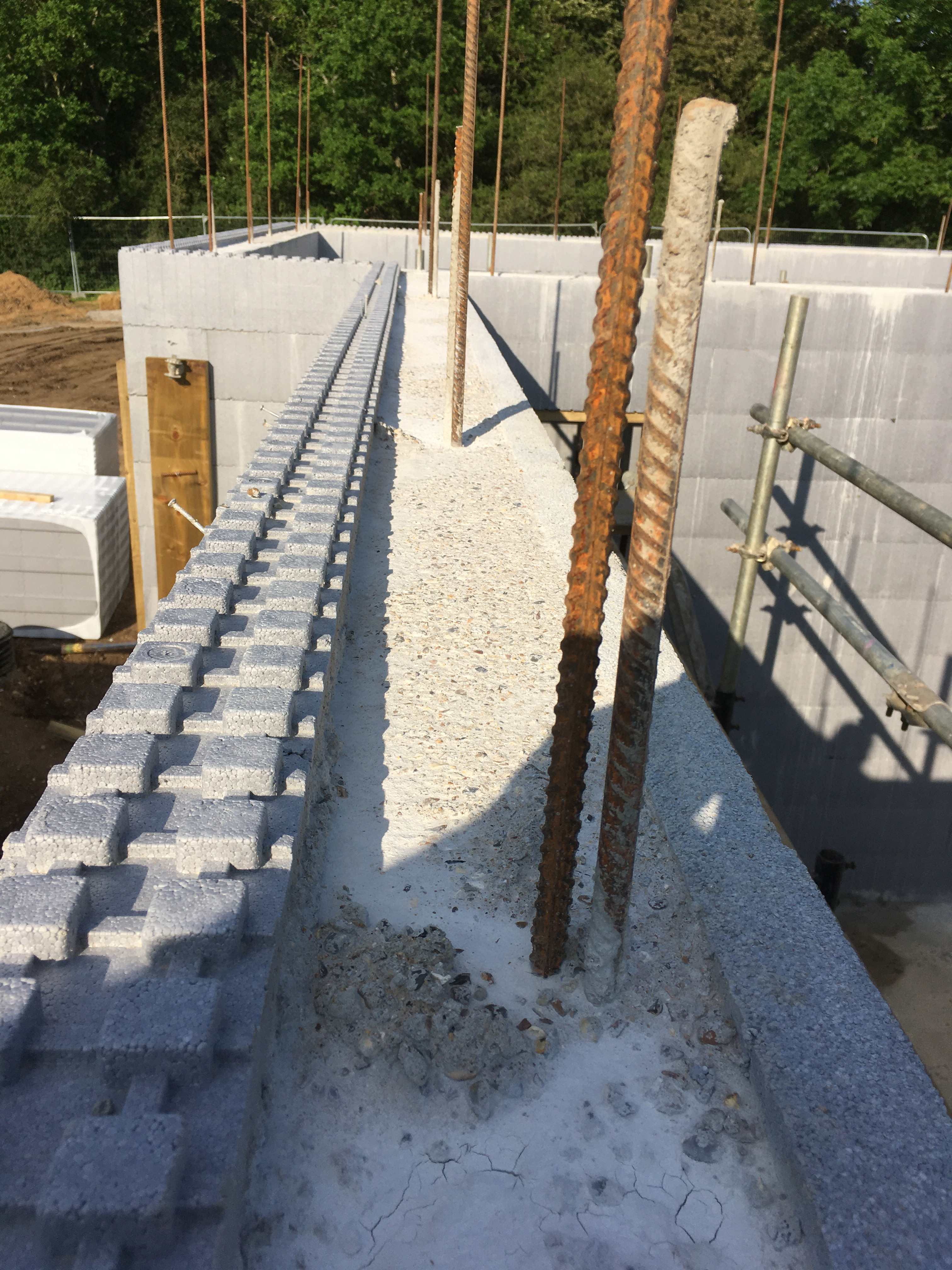

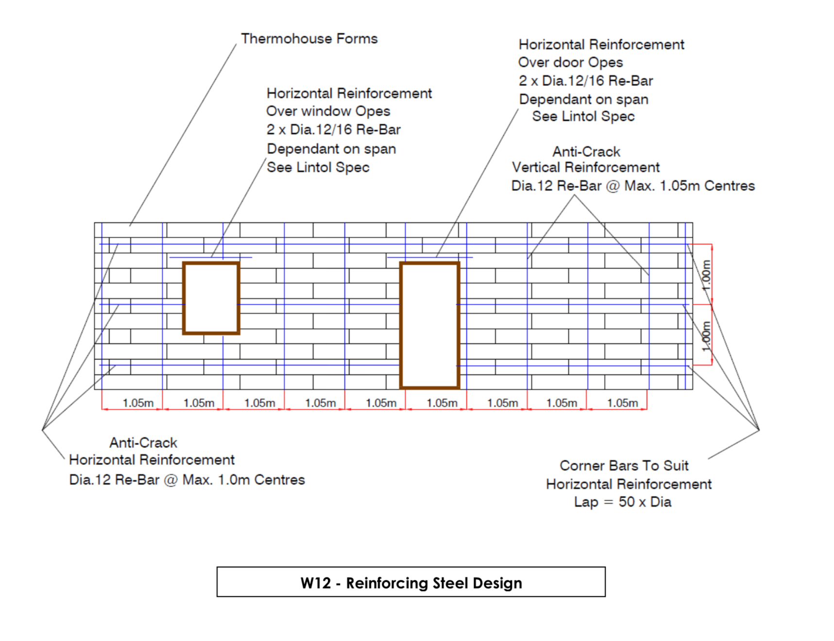

Iceverge Posted March 2, 2025 Posted March 2, 2025 On 22/05/2023 at 09:58, JohnMo said: Yes at each corner, above and to side of each opening and in middle of rear wall. Your structural engineer needs to design the rebar. Every build is different. Loads of rebar in foundation also. Resurrection of a dusty thread here. Do you have any sketches/snaps of the overall rebar quantities in your wall? I'm basing my ICF knowledge on EPS systems that seems to incorporate Yangtze dam levels of steel. Here's What's in my head.

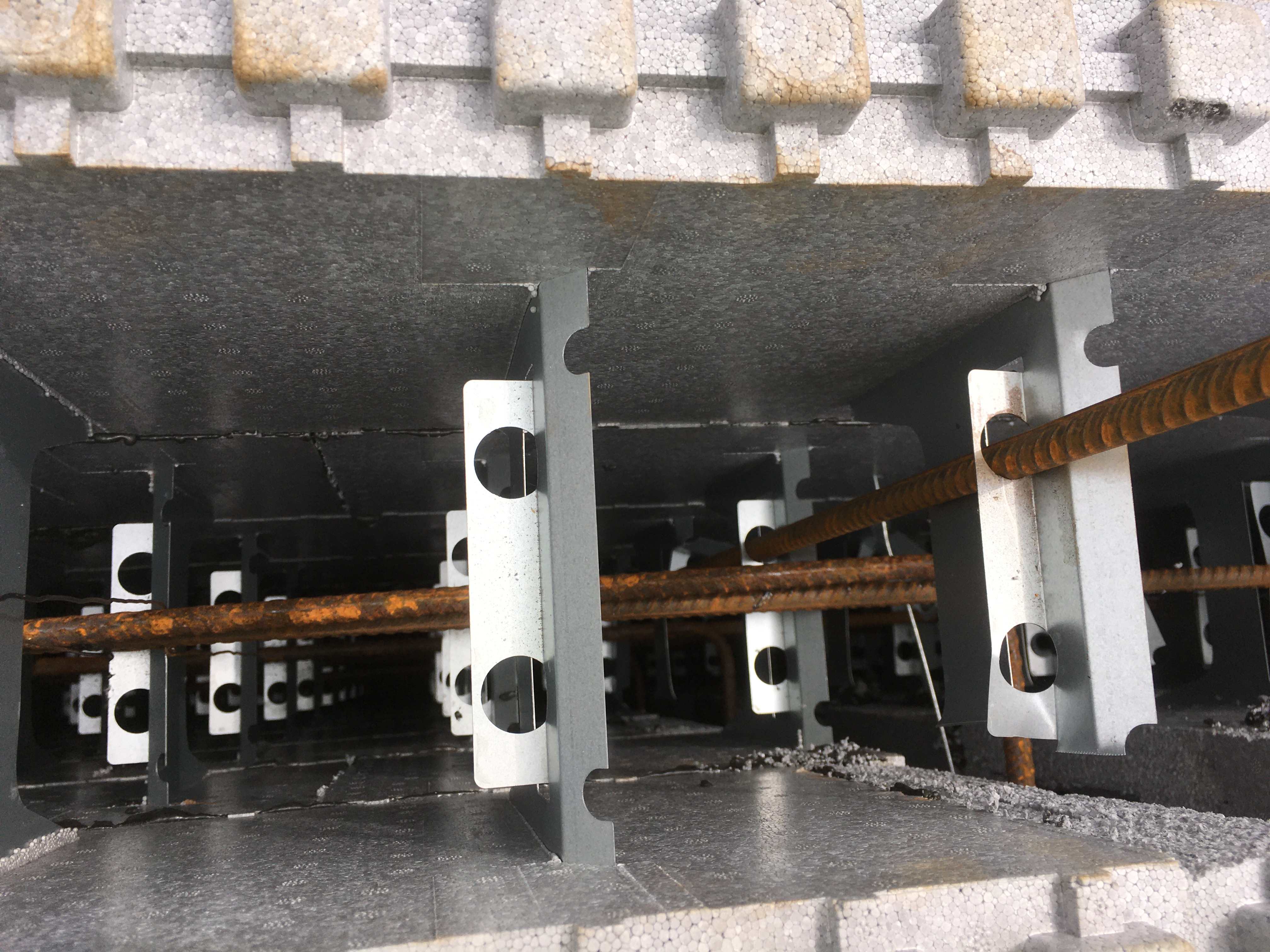

Nick Laslett Posted March 2, 2025 Posted March 2, 2025 Thermohouse ICF wall rebar requirements. Horizontal bar every metre, vertical bar every metre.
Nick Laslett Posted March 2, 2025 Posted March 2, 2025 Looking straight down a section of wall before pour. 1

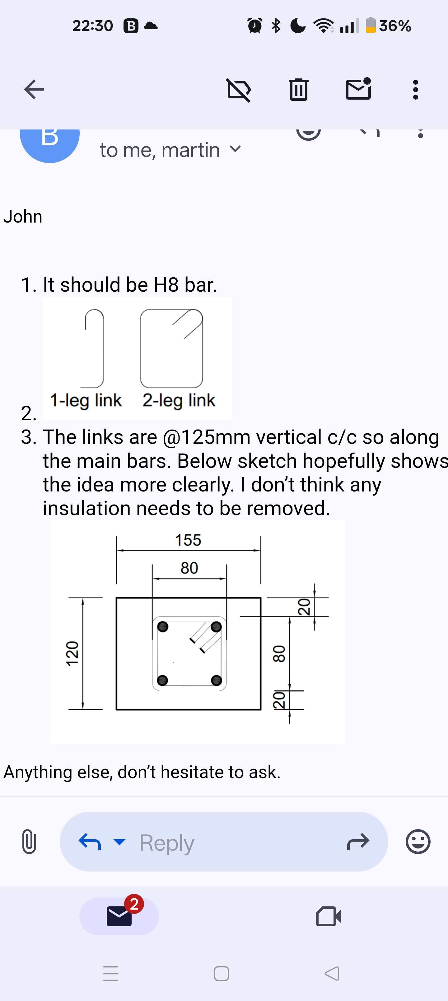

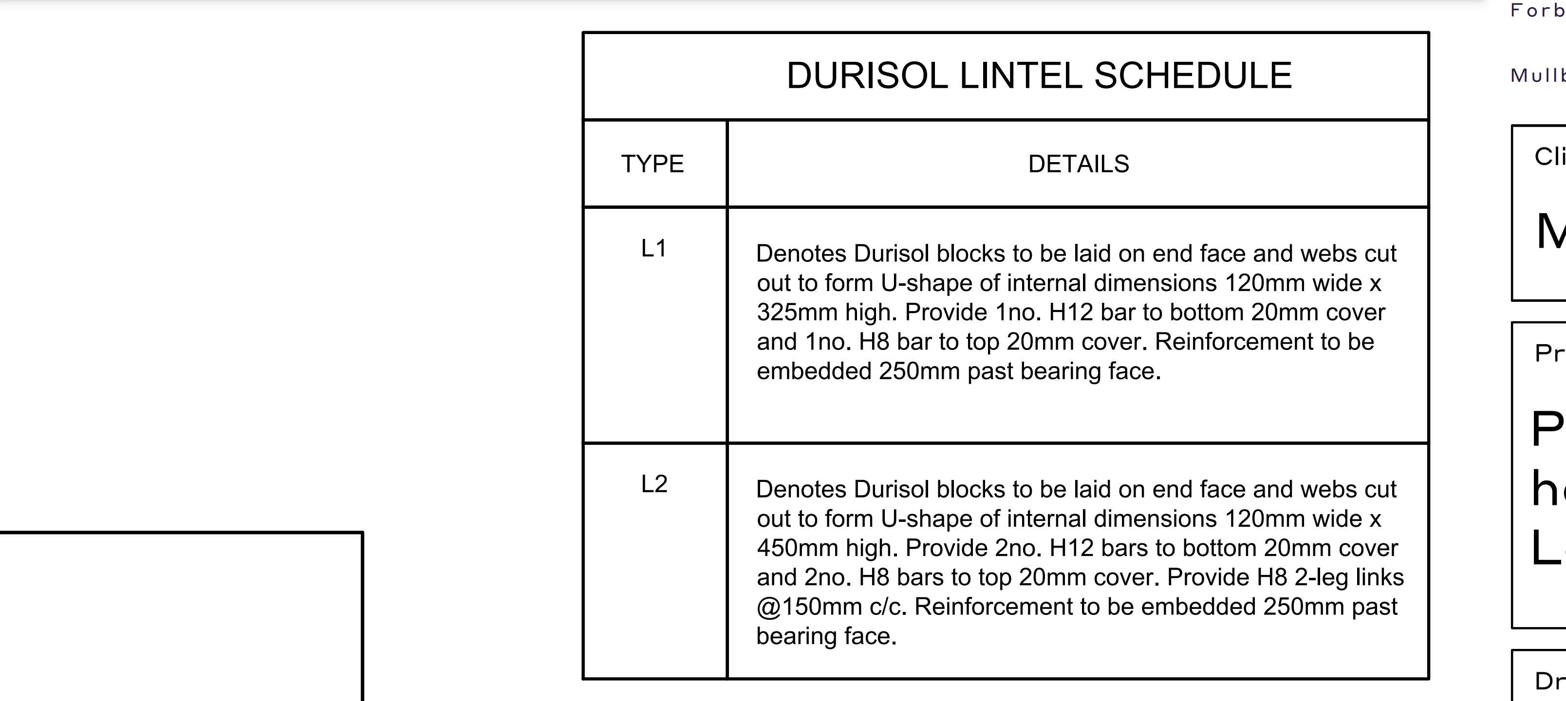

JohnMo Posted March 2, 2025 Posted March 2, 2025 My rebar was limited to lintels at doorways and window plus vertically at doorways and a wind post rebar midway along back and end walls. So not much at all. Lintel detail The wind post
Russell griffiths Posted March 3, 2025 Posted March 3, 2025 The problem with icf over her is a lot of stuff is cut and pasted from American or Canadian regs. they have earth quakes and other severe weather, we get very few major weather incidents. my structural engineer said to me that you wouldn’t put re bar in a block built wall, so why is it needed in a concrete one with less joins. the only reason I see the need for reinforcement of a basic straight short wall would be if it was holding back a load, like a semi basement, or any roof load pushing outwards onto it. 1 1
saveasteading Posted March 3, 2025 Posted March 3, 2025 2 minutes ago, Russell griffiths said: you wouldn’t put re bar in a block built wall, Because you can't. But in a hollow block wall you can, and fill with concrete, depending on the need of course. Hollow concrete aren't as strong as solids. Eps obviously isn't strong at all. Don't reinvent the system. 2
Nick Laslett Posted March 3, 2025 Posted March 3, 2025 1 hour ago, Russell griffiths said: The problem with icf over her is a lot of stuff is cut and pasted from American or Canadian regs. My choice to go with Thermohouse ICF blocks was a combination of many factors. The roof and floor solution were a big part of it. The fact that at that time they would build the superstructure. This greatly simplified the whole build, one company would do the structural engineering, construct the house, engineer and install the steel work, the roof etc. For me this combined the advantages of a timber frame kit built, with the characteristics of ICF concrete walls. I liked the fact that Thermohouse used the newer Neopor EPS technology from BASF. I even liked the origin story that Mike Cronin the owner of Thermohouse was looking for a way to utilise more concrete production from his main business, producing concrete. In Ireland they even recycle the EPS, because it is easy to ship it back to the factory. I believe that the Thermohouse system is licensed from and developed with BASF, so it is actually more Ireland focused in it’s attributes, to building regs compared to a lot of other ICF systems. I’m sorry if this sounds like I’m shilling for the company, but I had a genuinely positive experience on my build. If you are going down the ICF route, you need someone with good experience of the system you are going with. It looks simple, but there are a lot of small steps, that stop things like blowouts, bulging walls, etc. The bracing system brackets are an integral part of facilitating a good concrete wall pouring process as they create the platform you use whilst guiding the pump truck hose. They spent more time bracing my walls, than actually assembling them. Anyway, I could ramble for hours about ICF, I’ll stop now. 😉 1
Iceverge Posted March 3, 2025 Posted March 3, 2025 I think I actually worked for a company that his company eventually bought, but that's neither here nor there! Are those metal webs the same as the ones @Jenki has?
